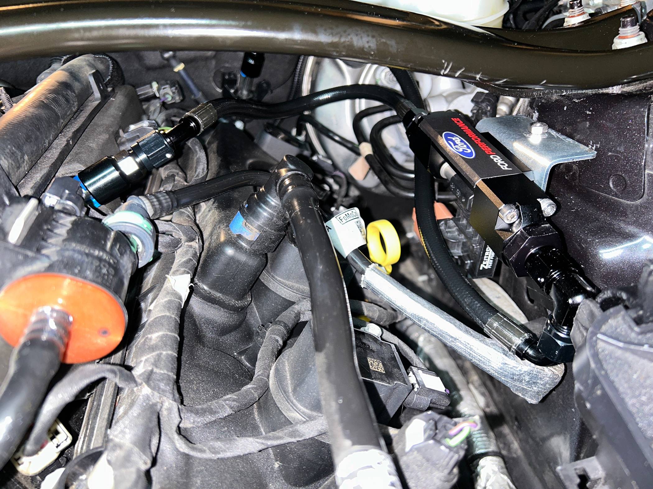

Here’s a pic of my hose routing with the teflon hoses. Eventually I’ll make custom hoses to fit a little bit better. i know they’re popular but i cannot recommend Fragola fittings. I have cracked three in the past year including one on this project. Ended up switching to a mix of Russell and cheap Amazon fittings called “evil energy” which actually worked the best.
Thank you for posting your pics. I won't do E85 until I break in my whipple stage 2 system on 93+ Boostane Profesional.
