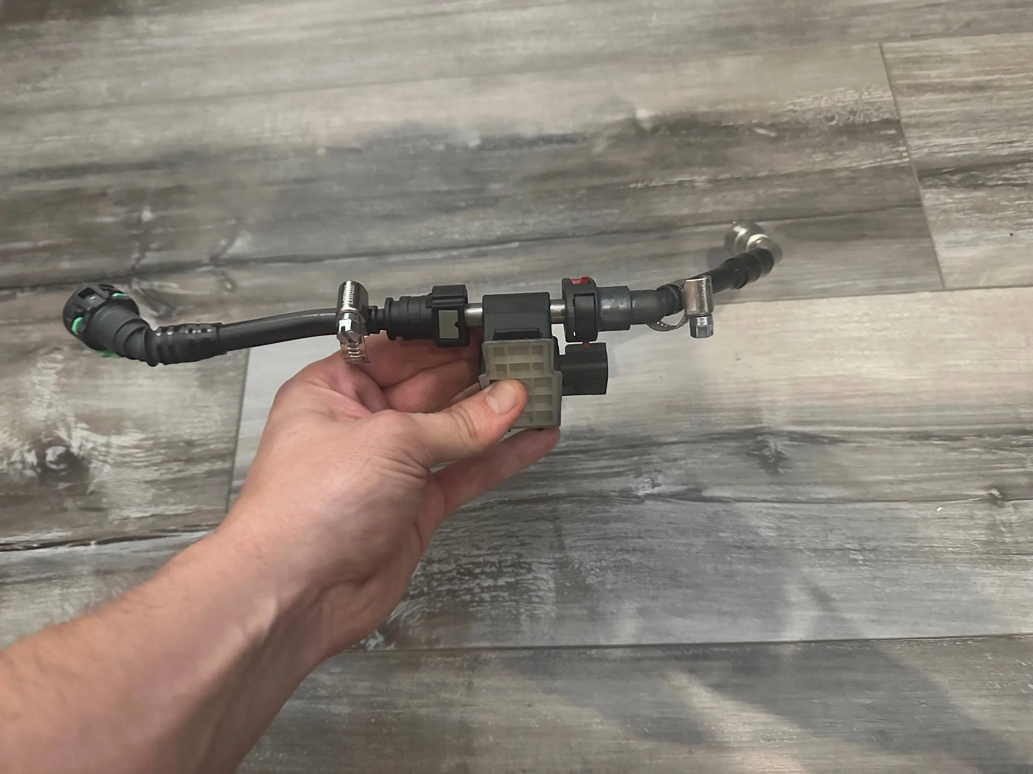

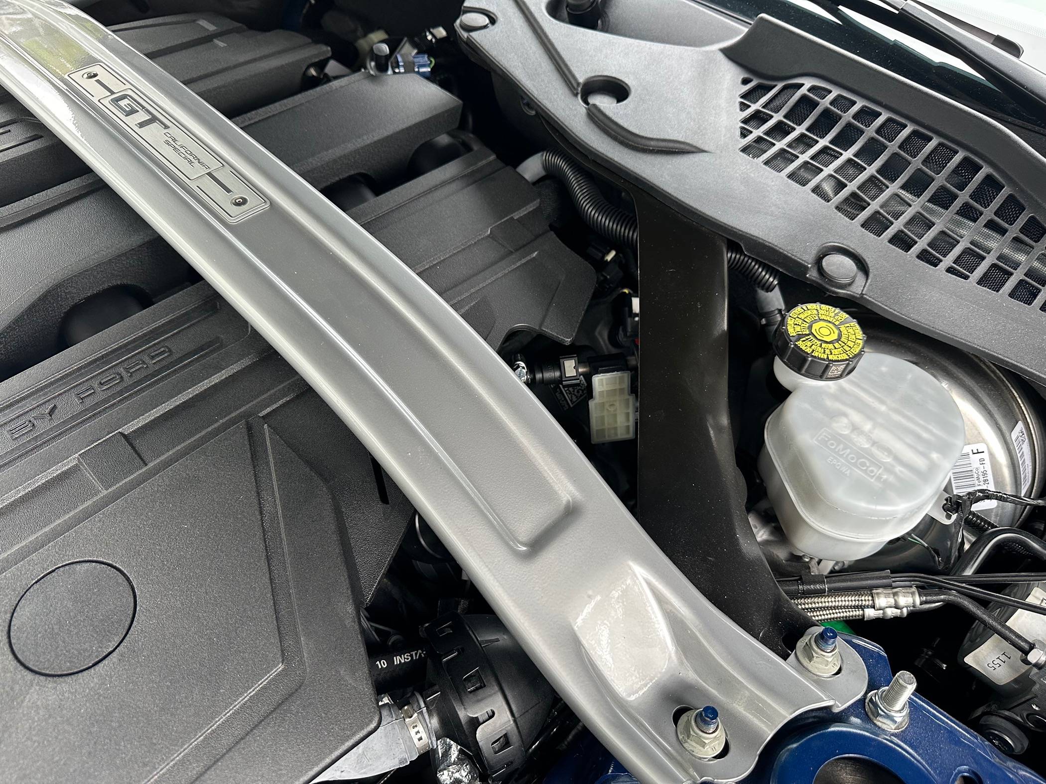

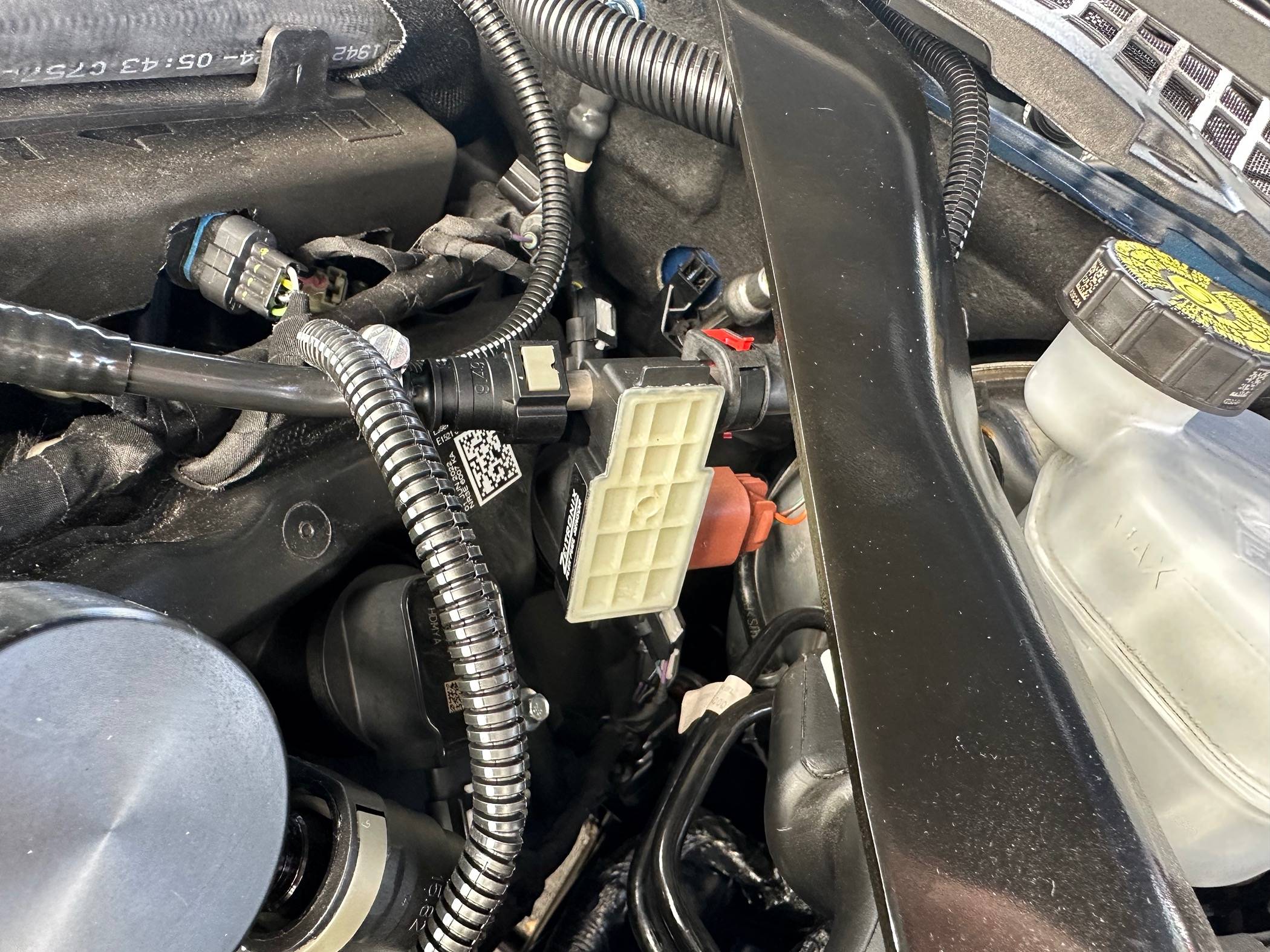

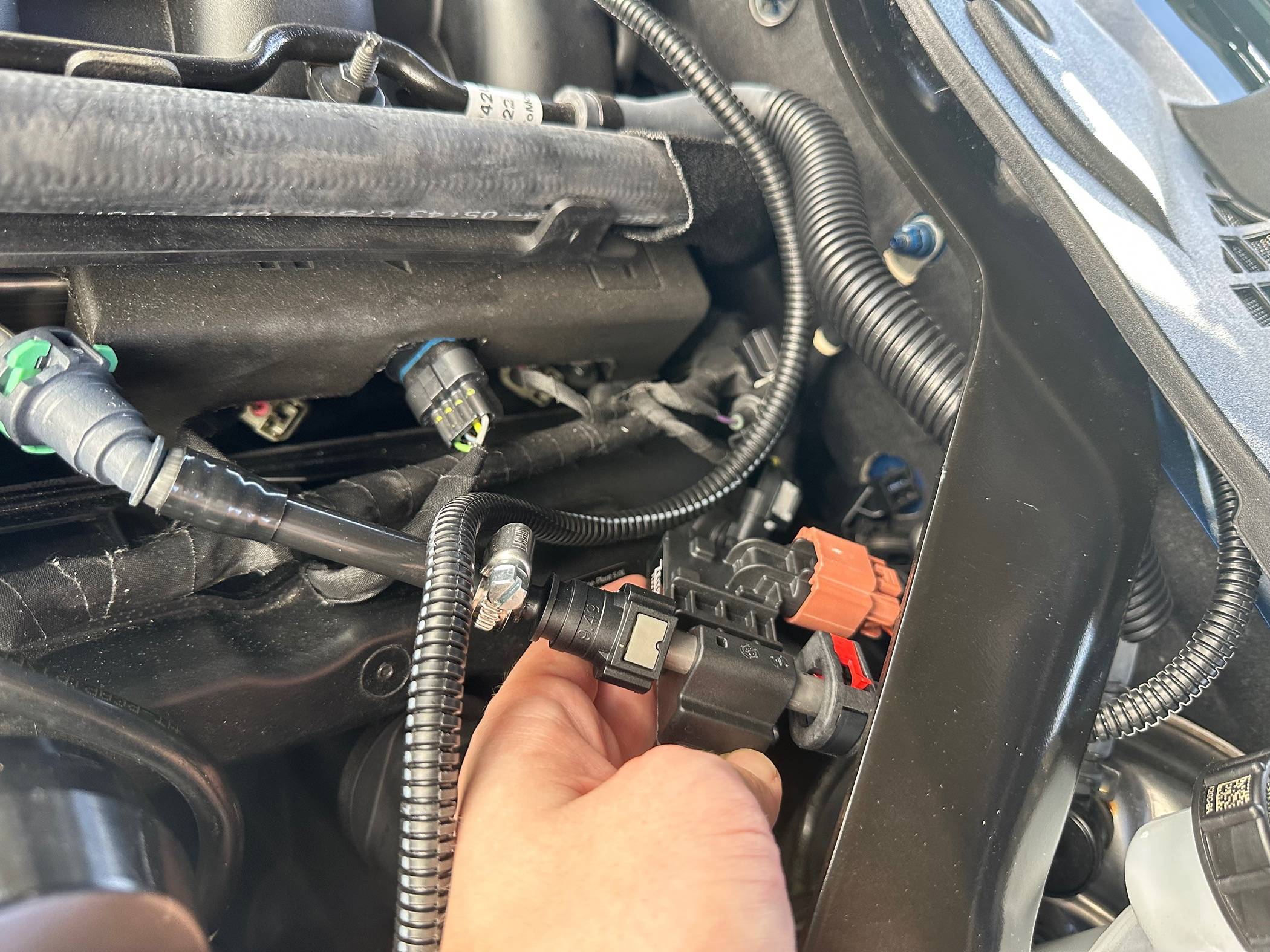

Yes I have that set-up. Bought a stock fuel line for $50 and spliced into it to install a Zeitronix ECA-2. I have the user-flex tune from Lund. My car is N/A. If you want to do this with boost you will need a bypass for the sensor to prevent it from creating a bottleneck in your fuel lines.
Here are some pics of me installing it. No pics of inside the car cause I just haven’t gotten around to taking any:

Do you recall was the ID of the factory fuel line is in that section? I have heard 3/8 but I popped mine off and it looks more like 5/16

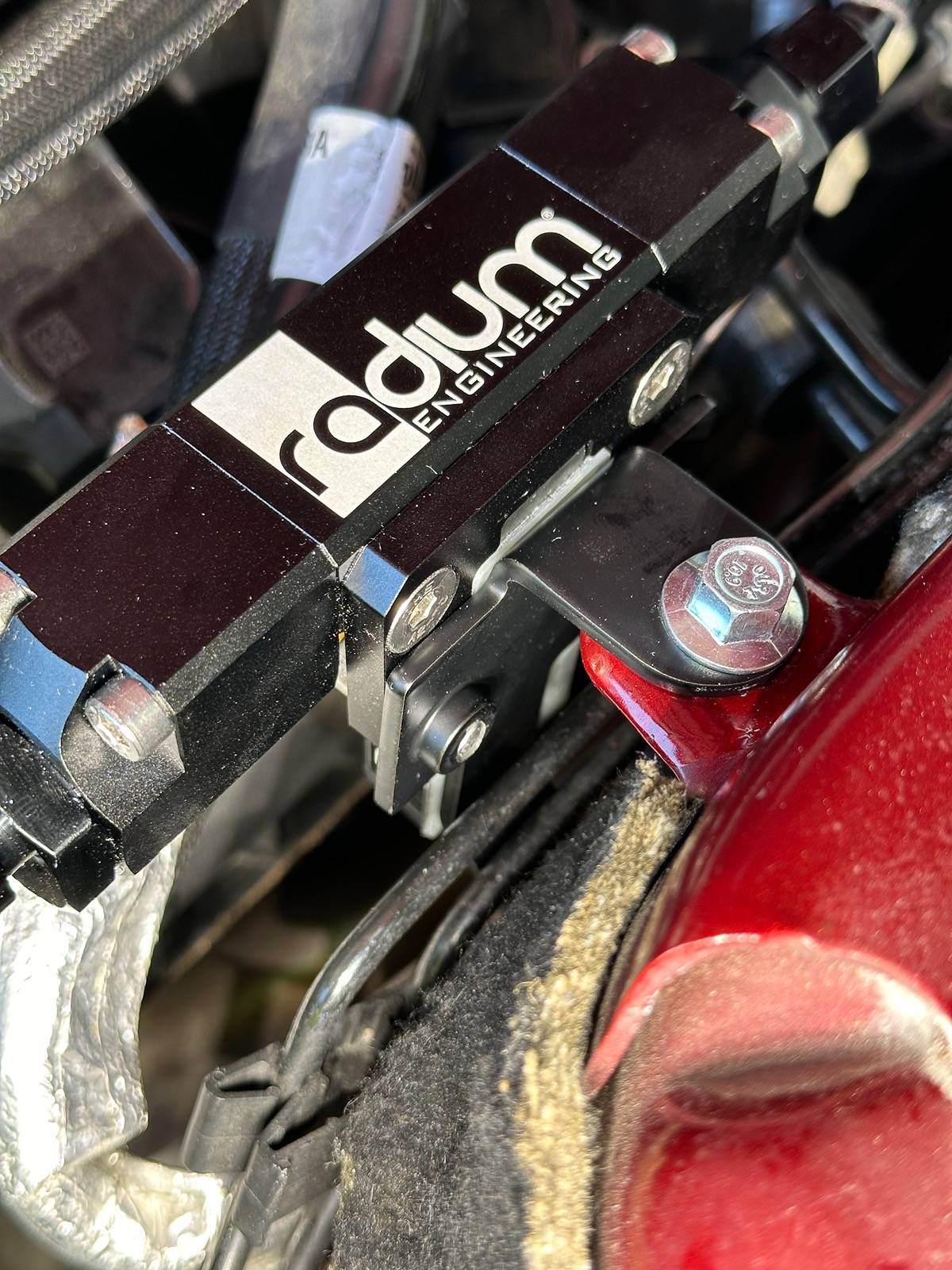

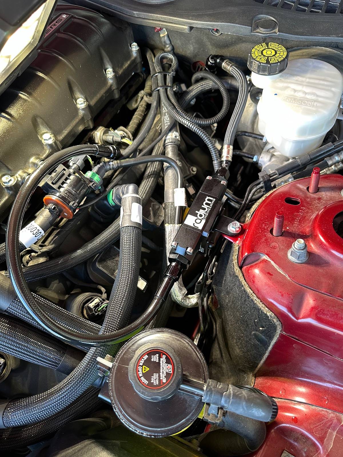

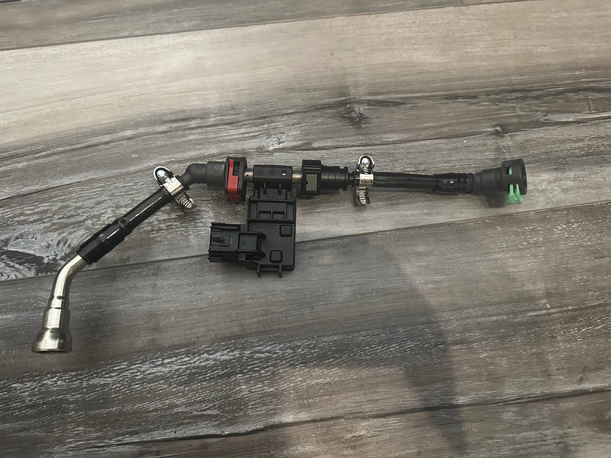

I’m running the Zeitronix ECA-2 wired into the CAN bus and using the PCMTEC CAN bus flex fuel logic. I have the sensor in a Radium bypass mounted with a bracket I designed and had made. I’m not the biggest fan of the outlet line, but the engine moves under acceleration so I didn’t want to risk damaging that line. I also realize I have two different looking lines on the inlet and outlet. When I was putting his all together I ordered a few pre-made lines from a couple different manufacturers to find what I liked and what fit. This is how it ended up for now.
I currently have the gauge just sitting in my glove box, but I intend to design and 3D print a mount so I can just open it up quick to see the ethanol content.

Good looking setup. I ordered the same bypass to do the same thing. Do you have the part numbers for the hoses and adapters you used to connect to the factory fuel system?

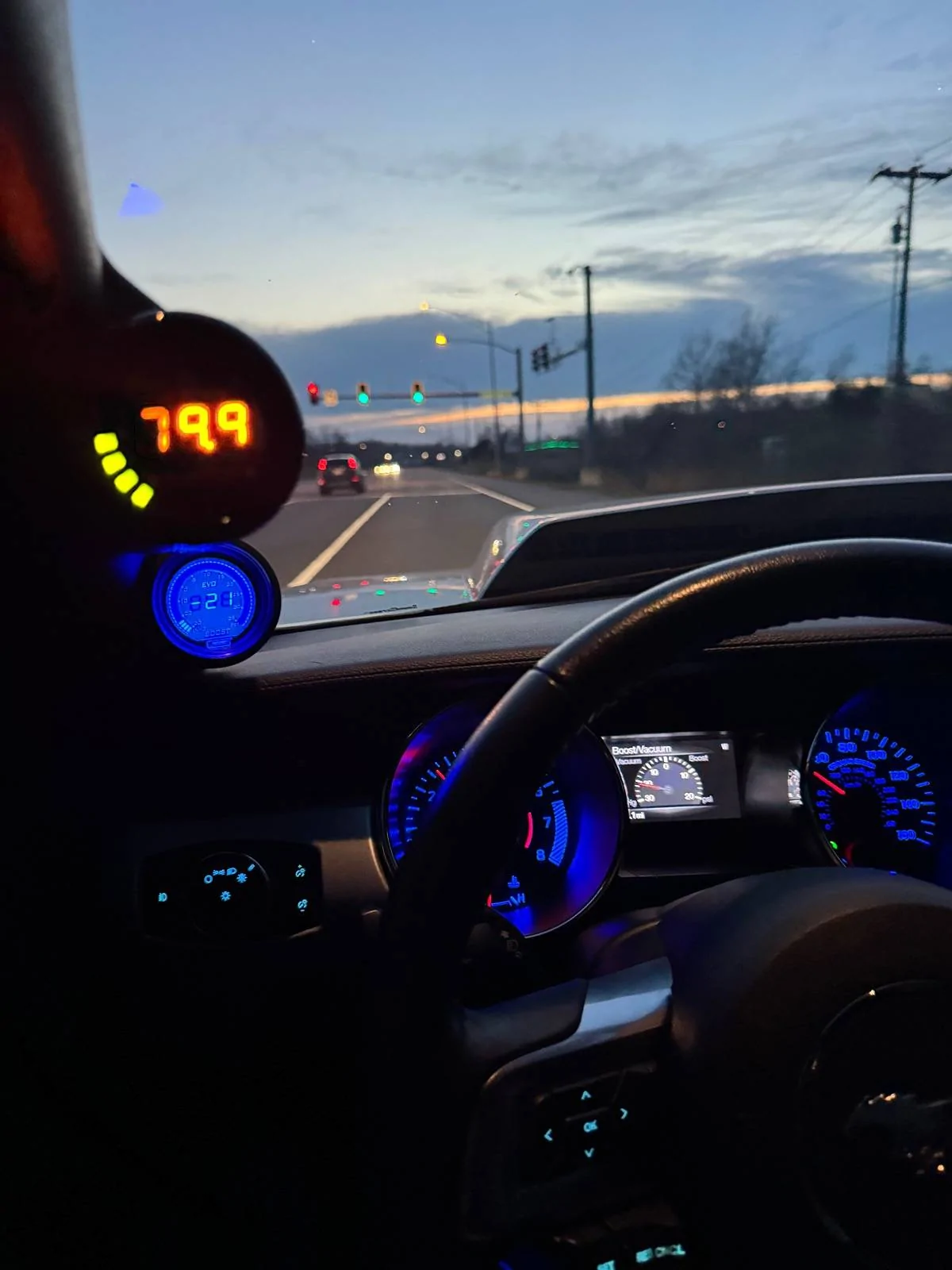

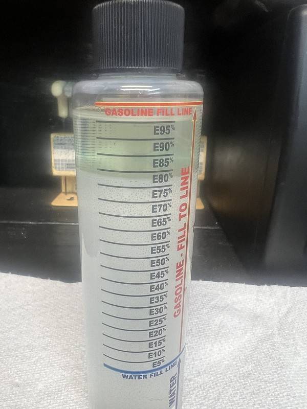

Here is my gauge, $12.95 from Amazon. It sucks to do science when getting fuel but the car is not a daily. Only 6600 miles in 4 years.

Looks like winter blend.
I don't think ive ever tested E that low where I fuel up.
