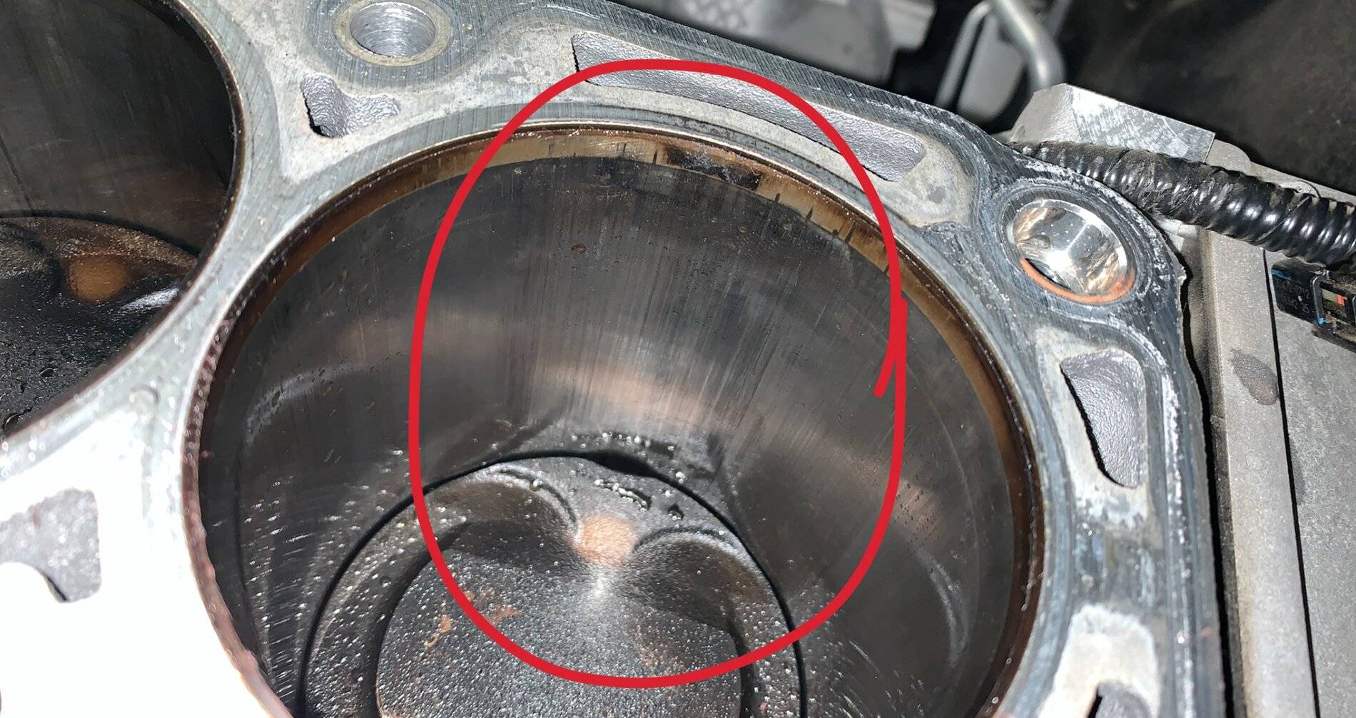

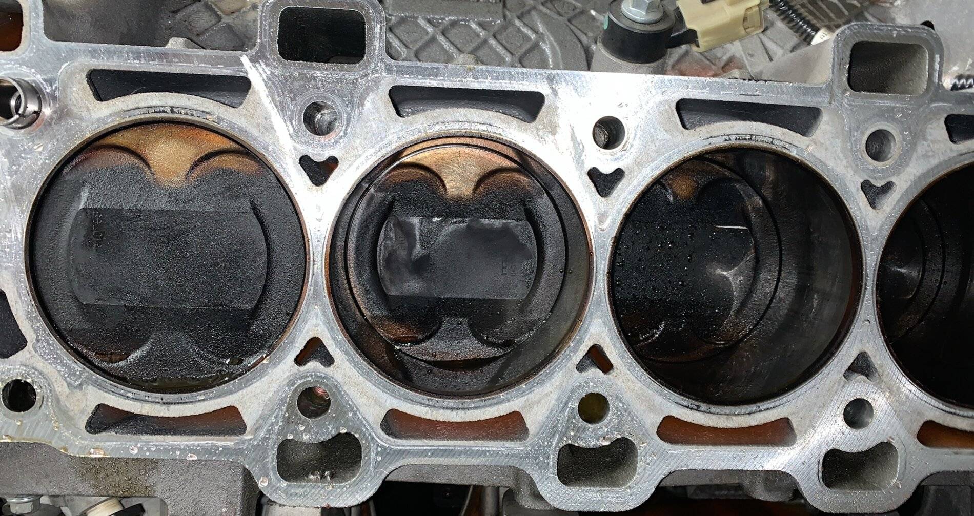

So, what do you think... detonation?
Dealer say the ford racing tune is dumping too much fuel and washed out the oil from the cylinders
Also pistons seems pretty dirty for 22k miles

Typical heated ring land failure. It wasn’t too rich, your piston tops would be much more washed that that.

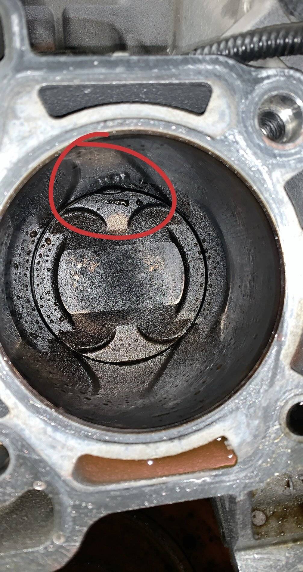

That seems to be where they break. My #8 ring land cracked on the intake side like yours. You cracked the top surface of the piston, mine broke at the ring land under the top compression ring.

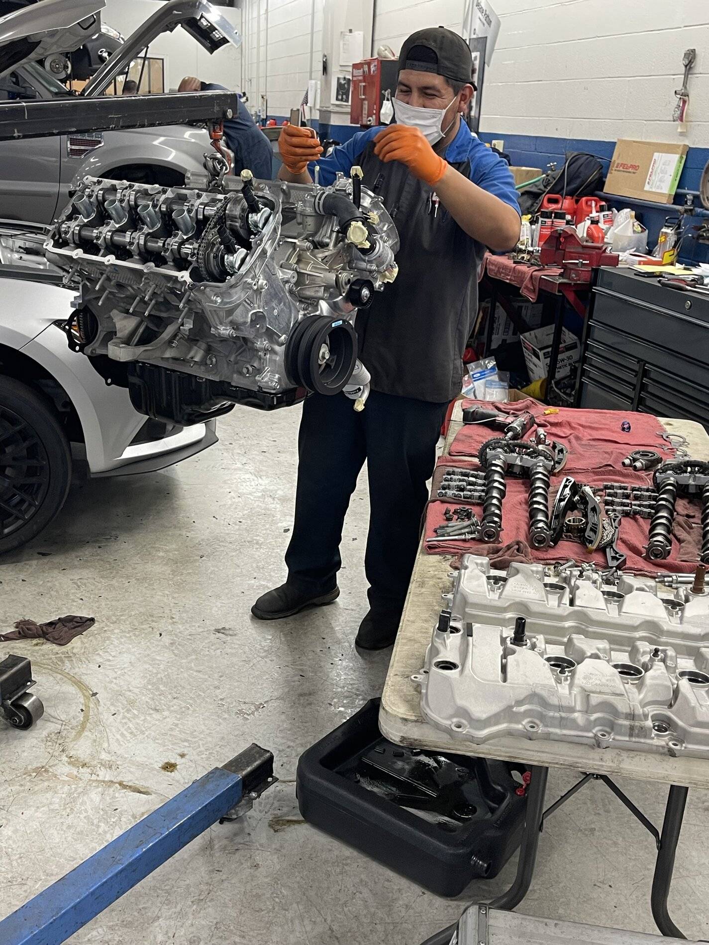

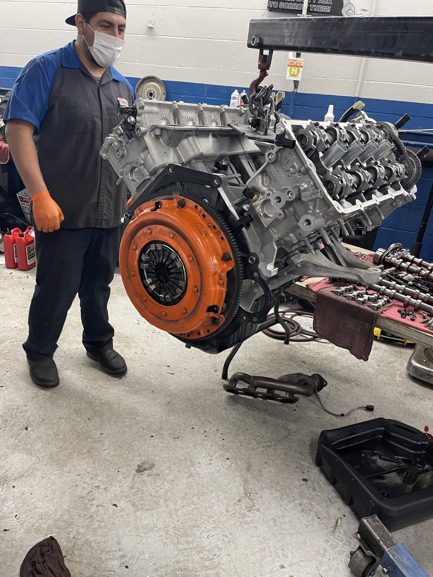

My new long block being assembled

Notice the aluminum Valves covers and oil lines at the back of the other engine

I'd agree, especially looking at the upper quench space between the top of the piston and the valves. It got real hot. Seems that 91 just wasn't cutting it.
