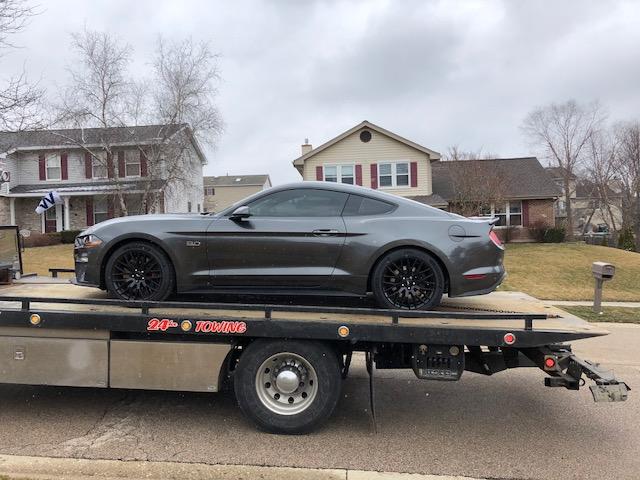

Bad day for my new Mustang. I've had it for 2 months and put about 550 miles on it. Went to take it out yesterday to run an errand. Got about a block away from my house and was turning a corner at almost idle and the whole car shuddered and the engine died. I tried to restart it and it sounded like a tin can full of bolts being shaken, and died again. Next try, nothing.
Had it towed to my dealer today and just heard back from the Service Director. They drained the oil and found about a quart of coolant mixed in with it. And, "chunks of metal" came out while draining the crankcase. They are calling it a "catastrophic engine failure" at this point, and he suspects it will need a new motor. He said their next steps are to follow protocol with Hot Line and Prior Approval for how Ford wants them to proceed. Really hoping it will be a whole new motor as opposed to just a long block. I guess it will depend on what Ford says, but I suspect they will want the entire motor to determine what happened to it. Hopefully will know more soon, and I will post an update.

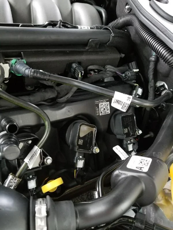

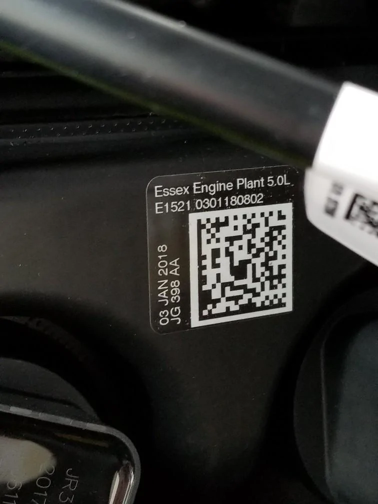

Look at the driver door frame. There is at least top left of sticker the month and year of the manufacturing date.
Also toward the rear of the driver side valve cover there is the exact engine manufacturing date. However you need to remove the engine cover to see it.
Here is mine ! January 03 2018, Essex plant
My built date was suppose to be January 4. I can understand why it was only finish like the 8
