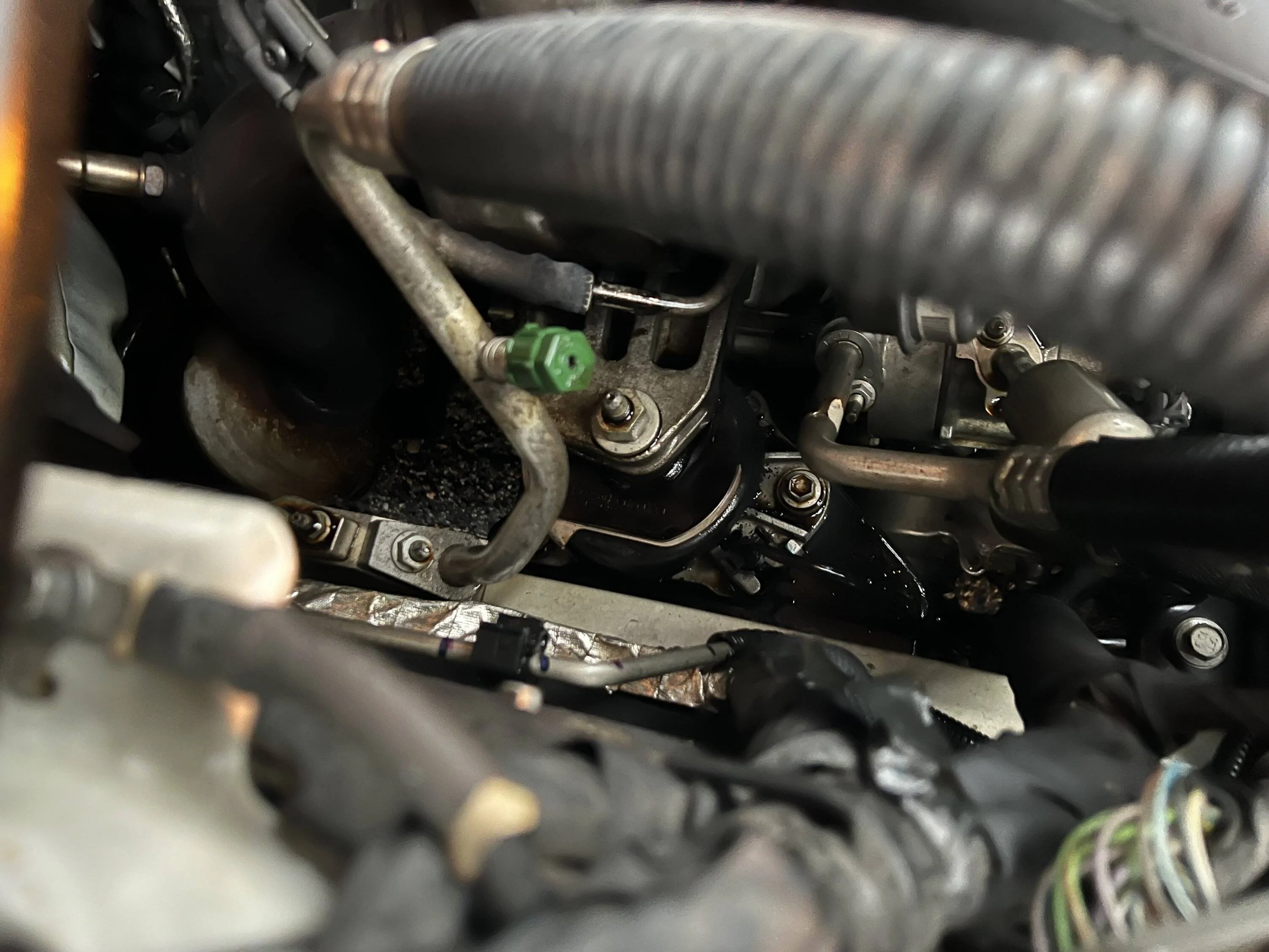

Oil was sprayed all over the passenger side of the engine bay as well - I’m not sure how the oil supply passages are set up in the 2.3 block, but it could be something like that happened too. When I was watching it idle after the failure, there were lots of oil droplets flying around - escaping from the hole in the block.

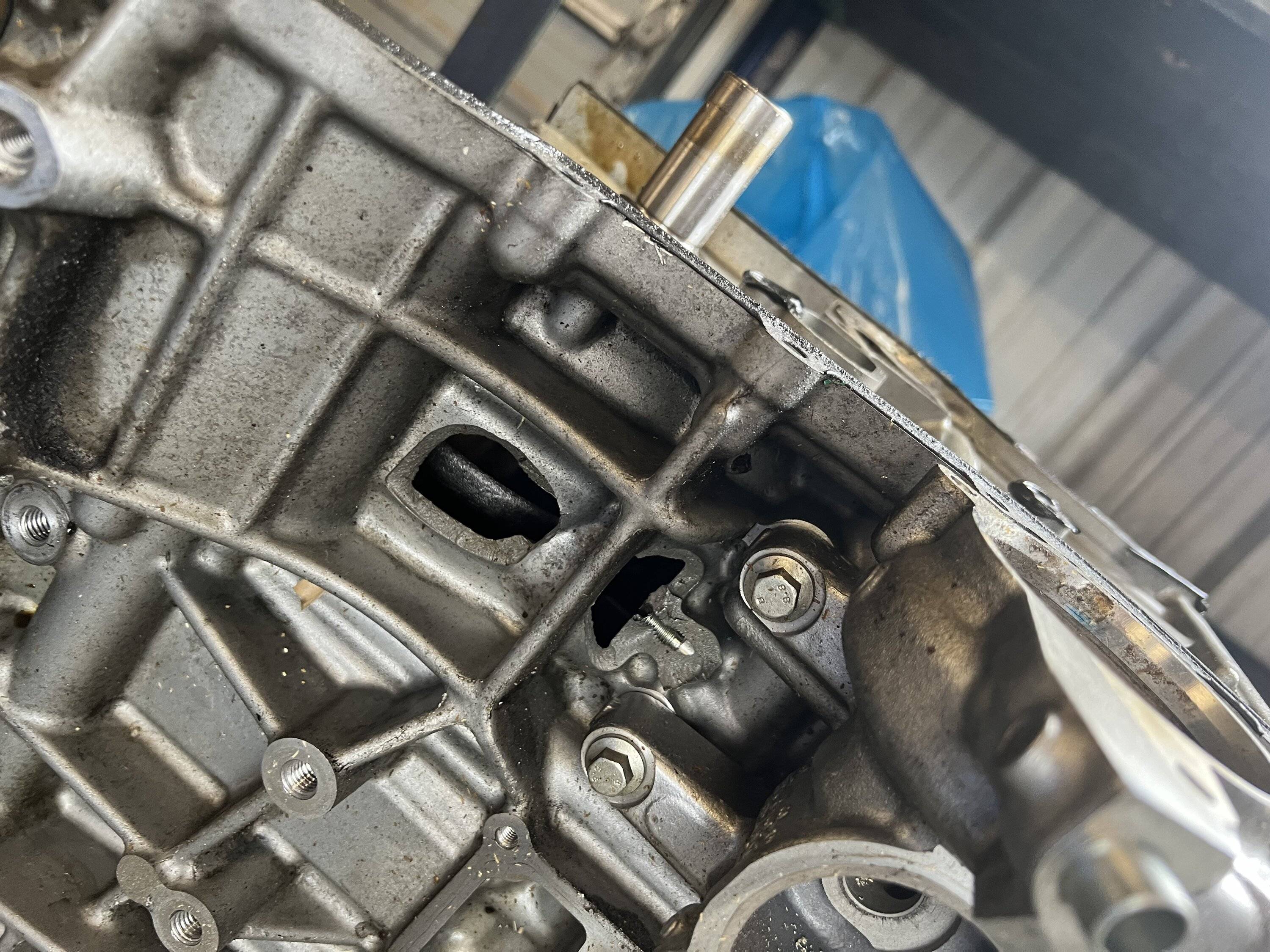

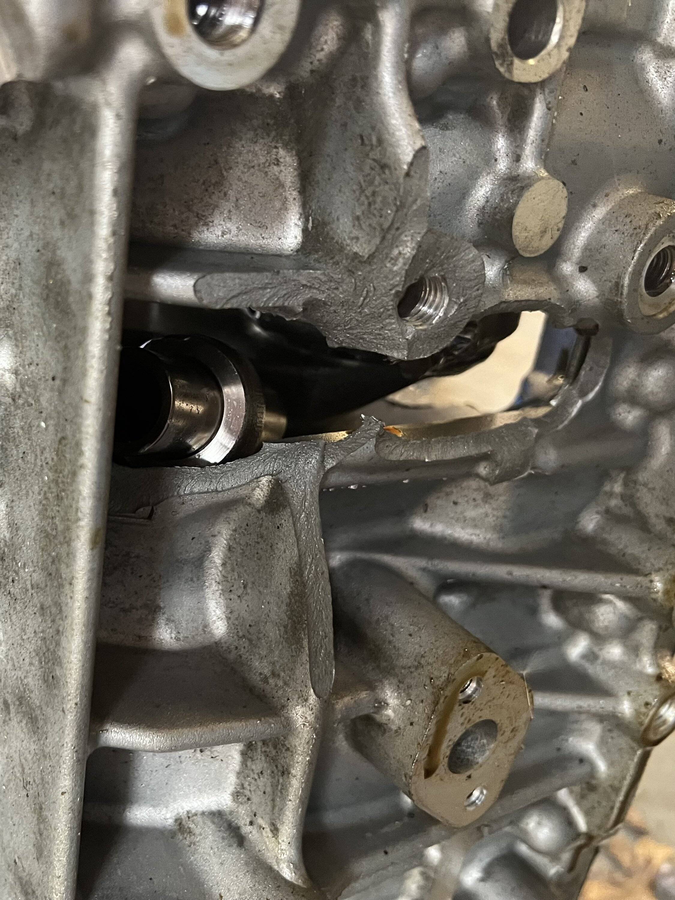

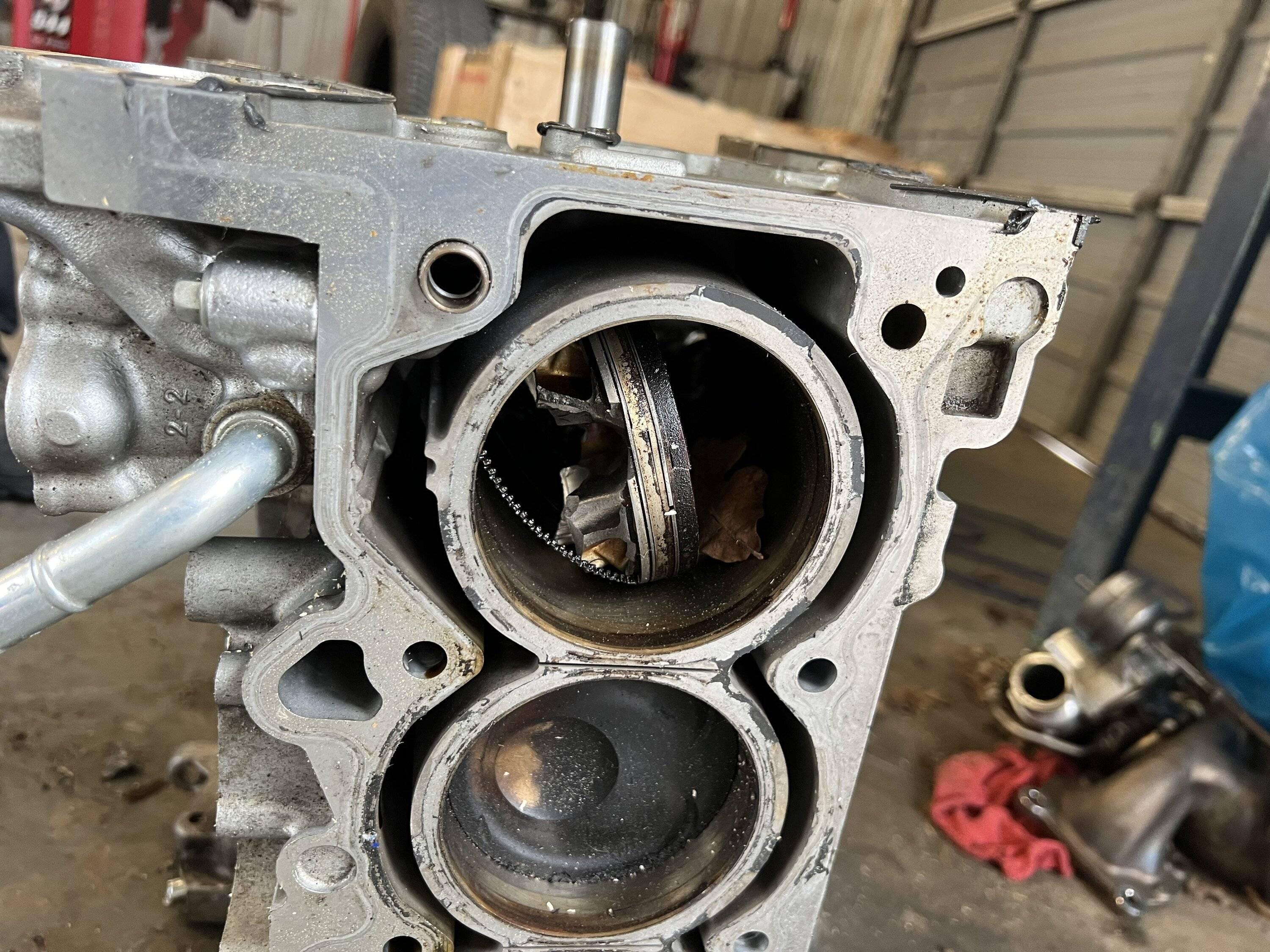

Got a couple pics jd the dead engine before I left the dealership. Holes in both sides of the block, and the #1 rod was in more than one piece. Tech said that a hole in the block was not enough to convince the warranty folks, so they had to pull the head. If they needed more evidence, #1 piston provided a bucket load…
Congrats on getting the vehicle back and that it was covered. Was the FP tune ever blamed or were they just dragging their feet?

Thanks, I missed my girl... They didn't seem to care about the tune, which is 99% of the reason I went with the FP tune vs. any other tune in the world. The warranty folks really did seem to care about documenting as much damage as possible before budging on approval, and that doesn't seem productive. I get why they do it, but it sure seems like some failures are pretty obvious. The dealership had some labor issues that really dragged out the timeline, though.
