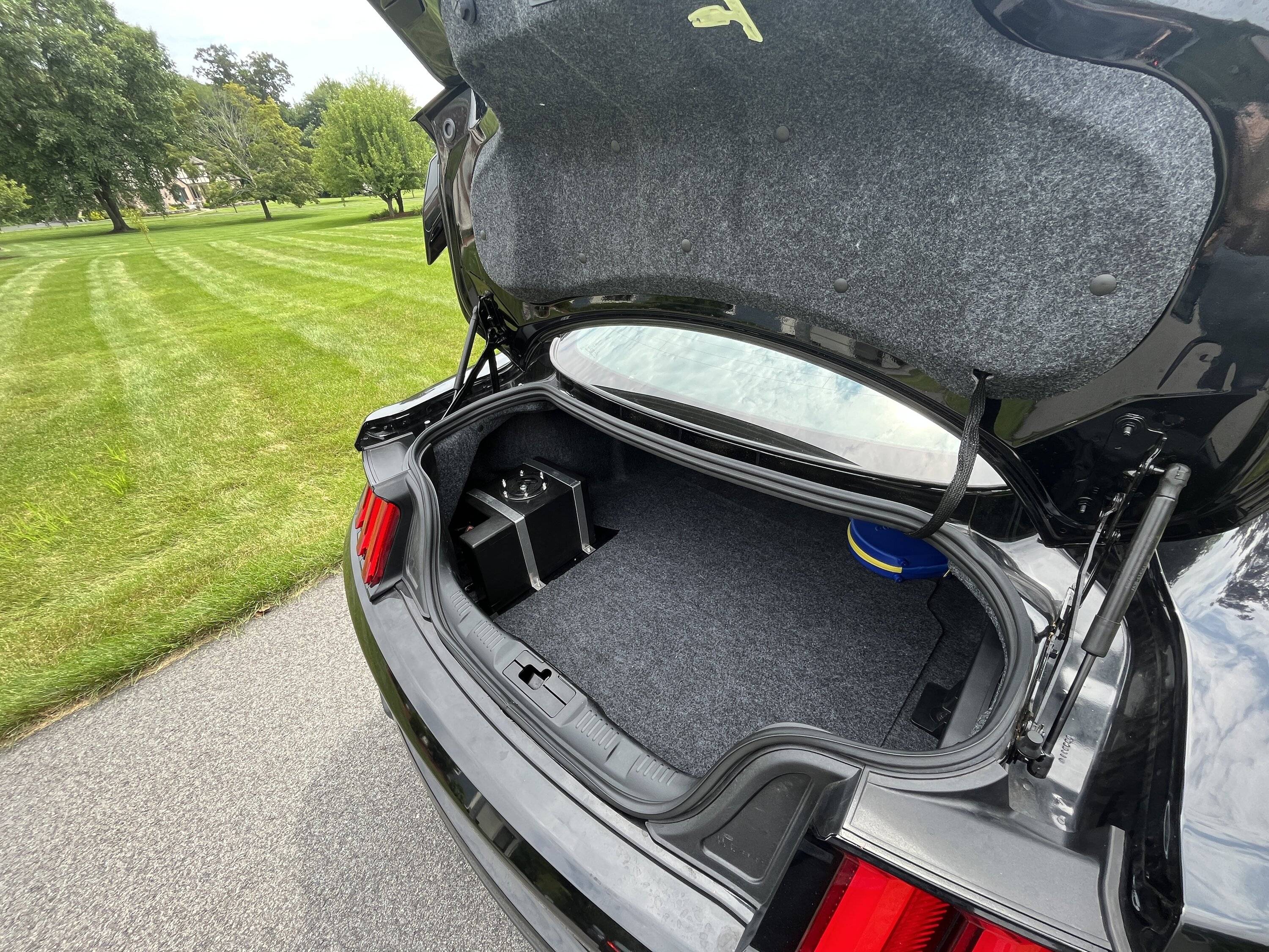

I did a lot this weekend, I took a video recapping everything but it was just 5 minutes of me complaining about how I don't have e85, how this install sucks, how hot it was, how humid it was, and how much I hate wiring.
All that's left is:
  • mount the tank
  • Run a trigger wire (blue wire from reverse camera)
I don't know how I'm going to actually mount the tank, its the same width as the mounting plate so there's no easy way to bolt down the straps. I may buy the actual tank it's made for because its only $60. Then figure out this nice tank at a later date. Might be the move.
Things I did this sunday:
  • Run LED wire
  • Run CAN bus wires
    • solder them into the main harness
  • Wire up things to the main controller connector
    • Pump, dual wires for current capability (high side switching)
    • pressure sensor (power, ground, and signal)
    • flow sensor (power, ground, and signal)
    • solenoid (high side switching)
    • LED
    • power (3 wires)
    • ground (4 wires)
  • Fix the injection plate
    • needed to clearance the nozzle holders
CAN bus wires are some twisted pair I pulled out of an ethernet cable, should work mint for only $7.
I'm so close, just a few more things...
