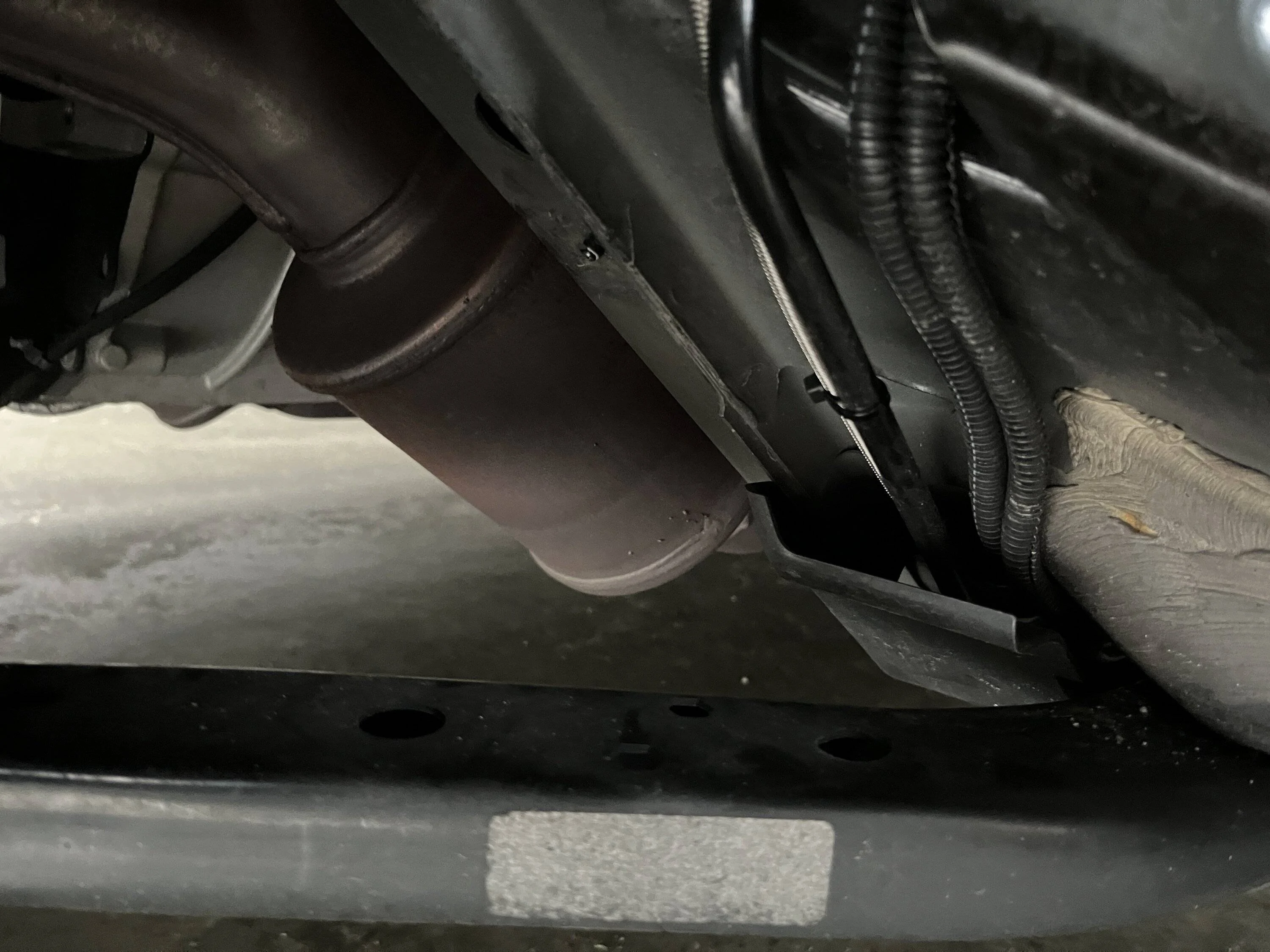

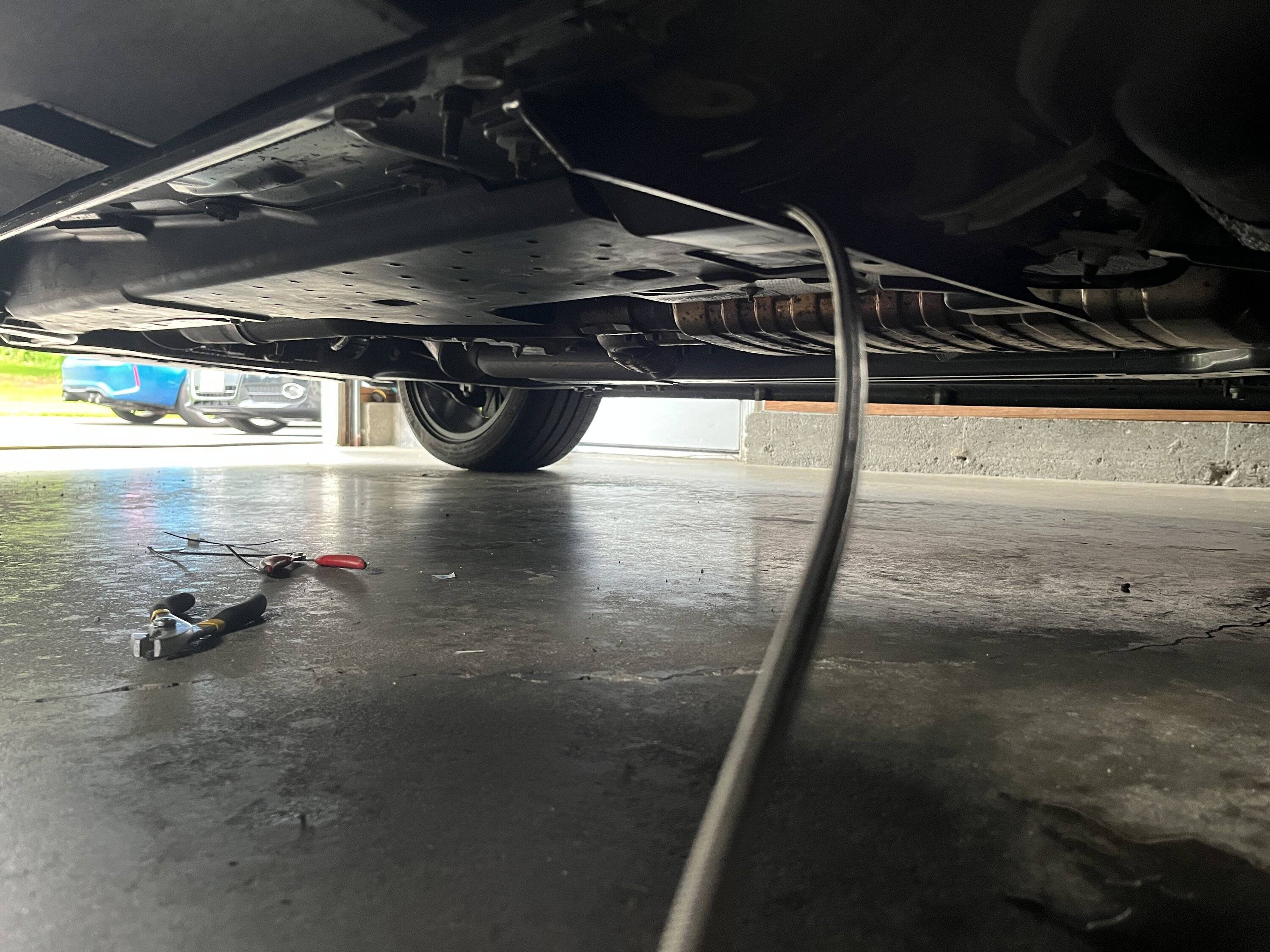

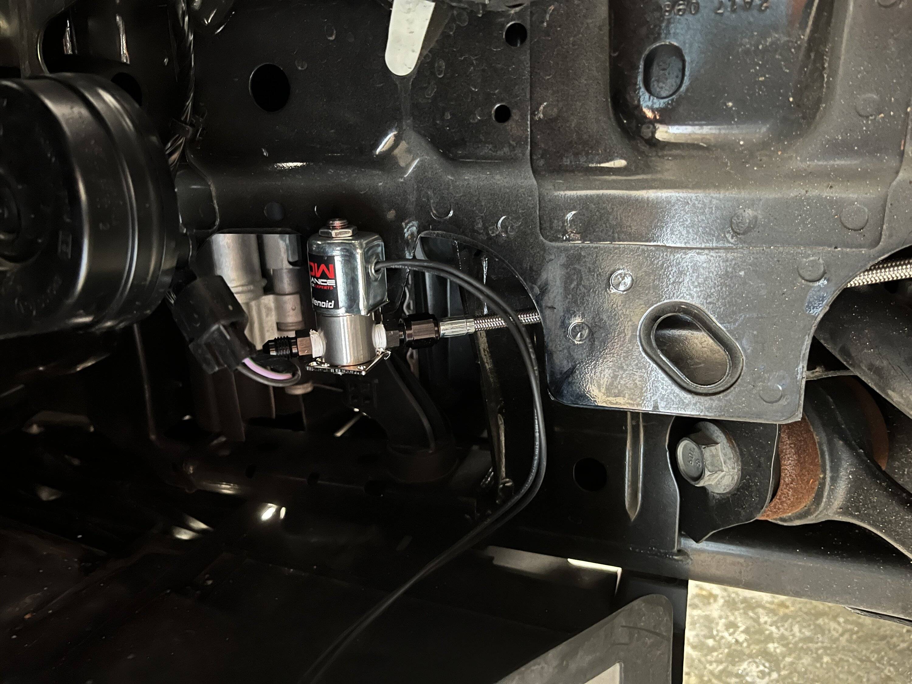

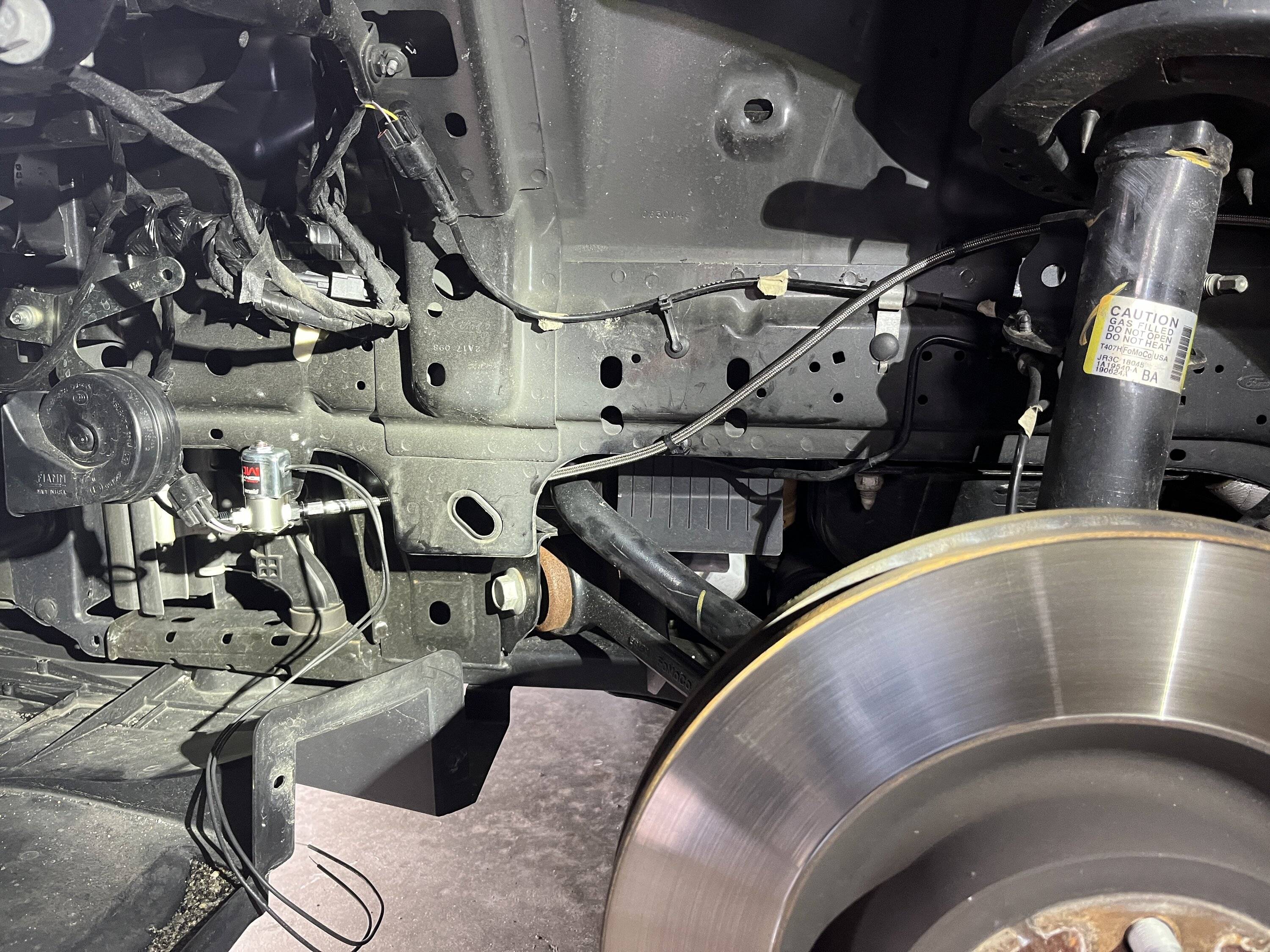

Methanol line and solenoid installation
a few notes
  • The solenoid is mounted behind the driver's side front fender liner to pair of unused holes on the body. Its secured in the big open area under the headlight, so it will be shielded from direct water/salt spray.
    • Initially I was going to run it on the passenger side but the driver side ended up making more sense.
    • This will require me to extend the control lines from the passenger side over the motor to reach the solenoid but that's manageable.

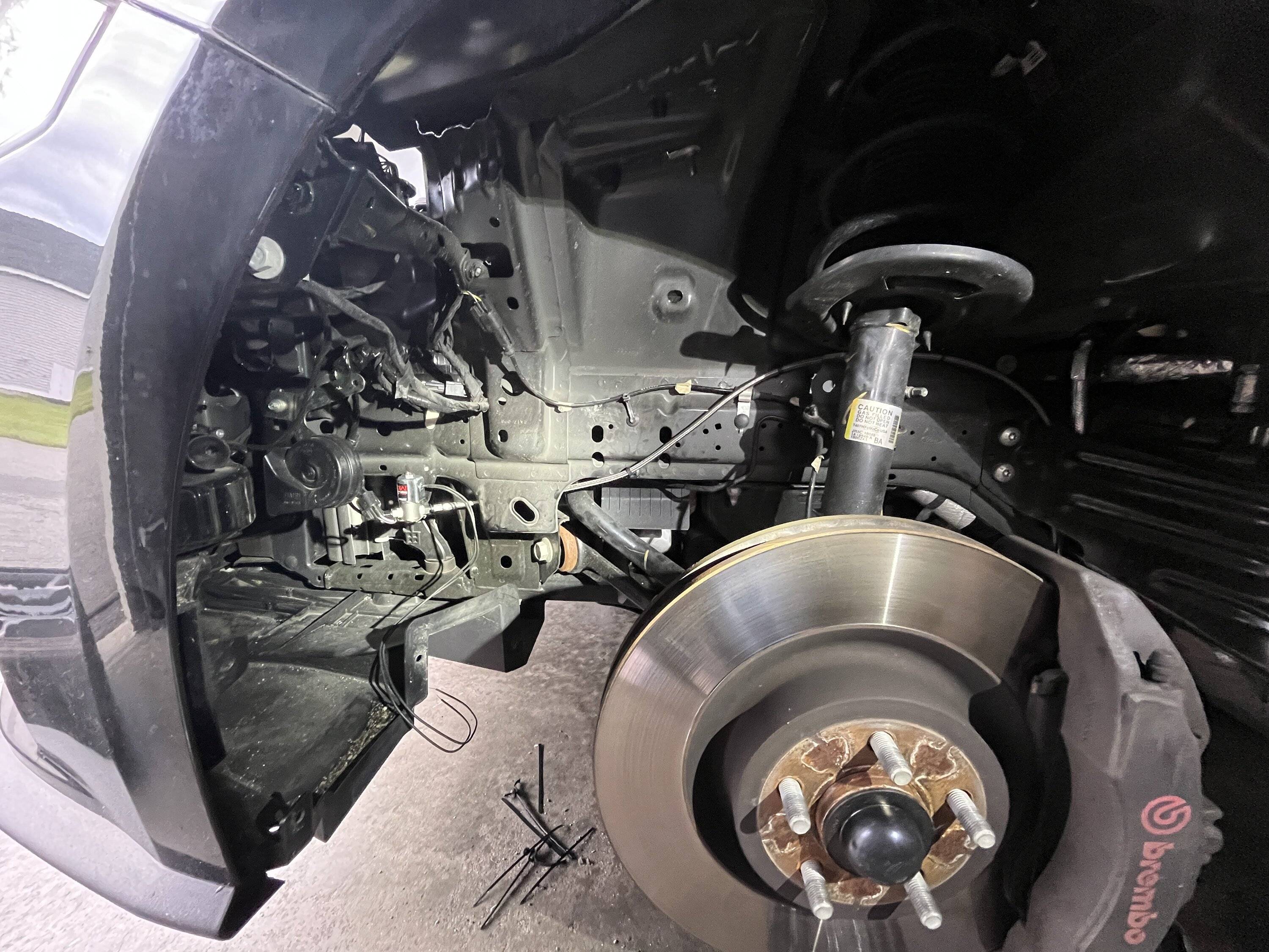

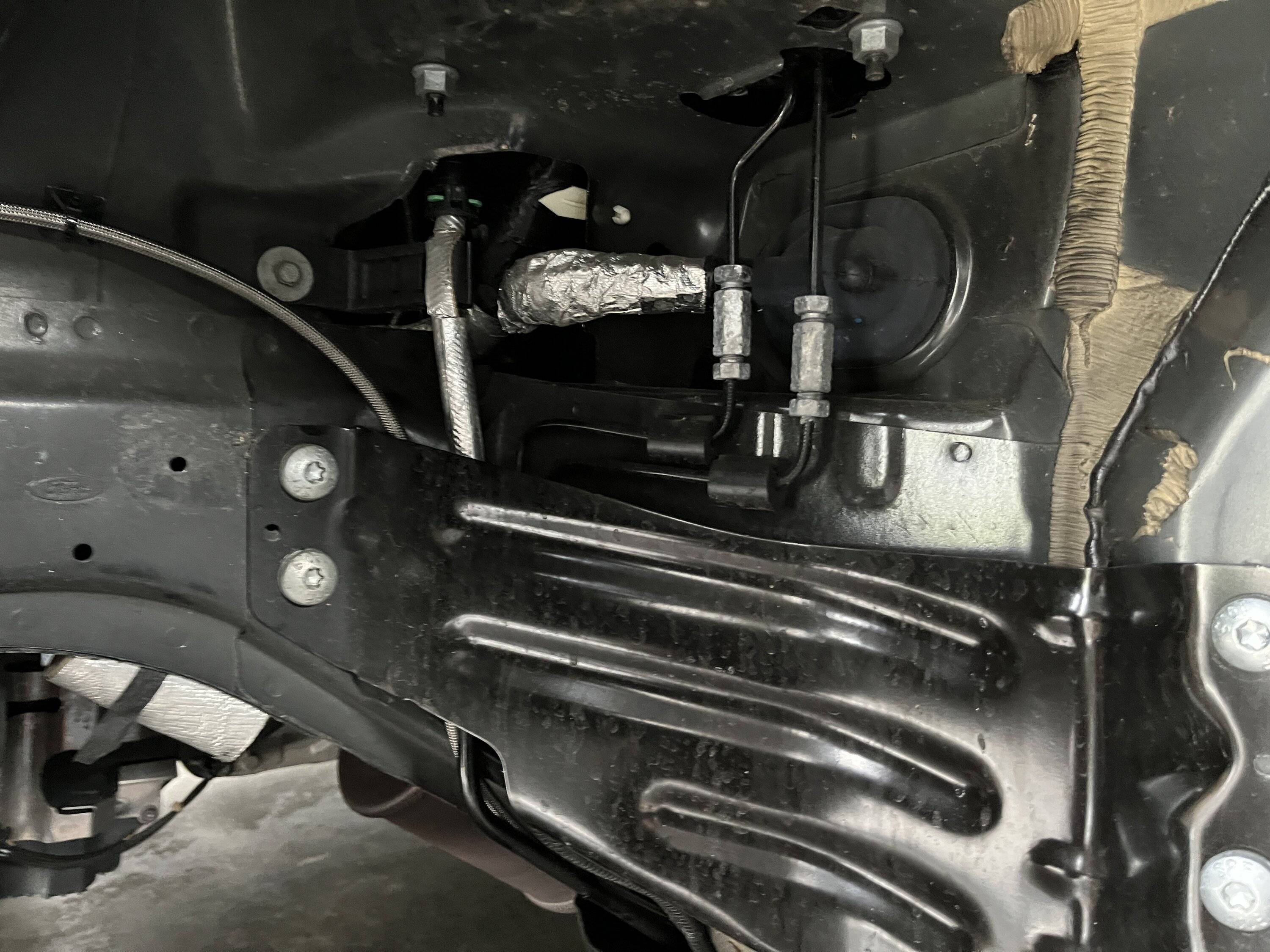

  • The methanol line is run next to the fuel lines, there is an extra hole in the plastic hangers that was a perfect spot to run the line.
  • The line hasn't been routed inside the car into the trunk yet, I'm waiting on a handful of extra parts for that, namely, a -4AN bulkhead.
  • I used a combination of sticky zip tie squares and zip tie Christmas trees to hold the line. We will see how it holds.

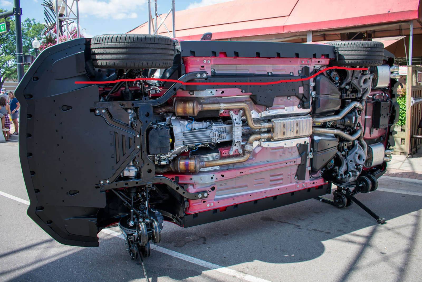

I stole this diagram from a 2018 promotional photo, its kind of hard to visualize where the lines are unless you've already spent time under this car. So this photo makes it more clear.
Also in case it isn't clear, the lines run over the suspension components in each wheel well lol.
Here is the solenoid mounting:
Up close:
Here's a handful of pictures of how the line is run, I don't have one showing it in the hangers but this should give you a good idea:
This is where it pops out at the back:
And then no pics of the rear wheel routing unfortunately, but I'll be back in there again to install the bulkhead so I'll get photos then :handsinair:
The routing is pretty clean overall, I can't stand badly routed wires and hoses (as is probably already obvious) so I wanted this to be really well secured and out of direct view. I think I achieved that well.

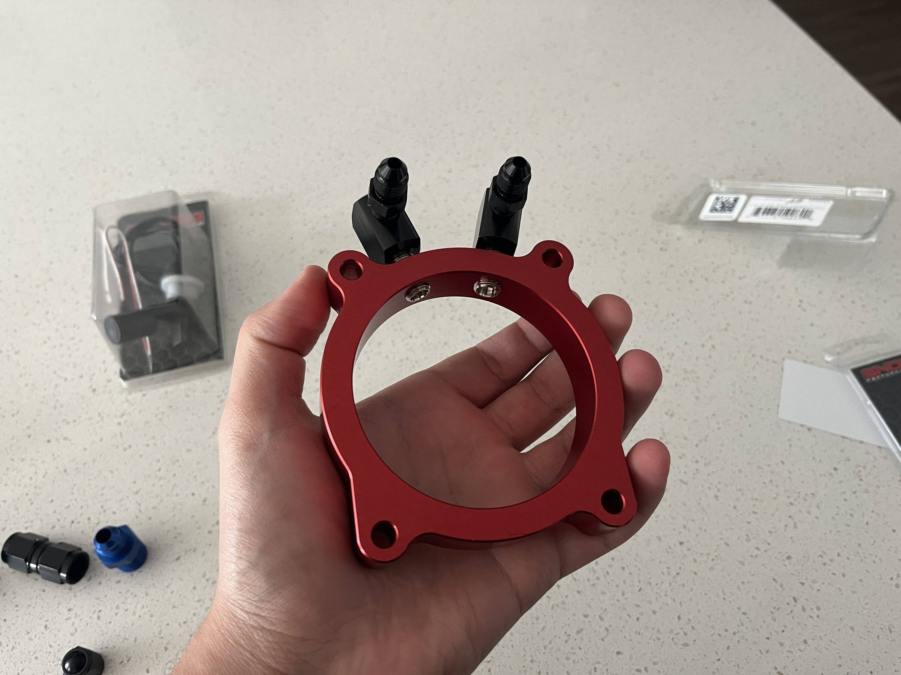

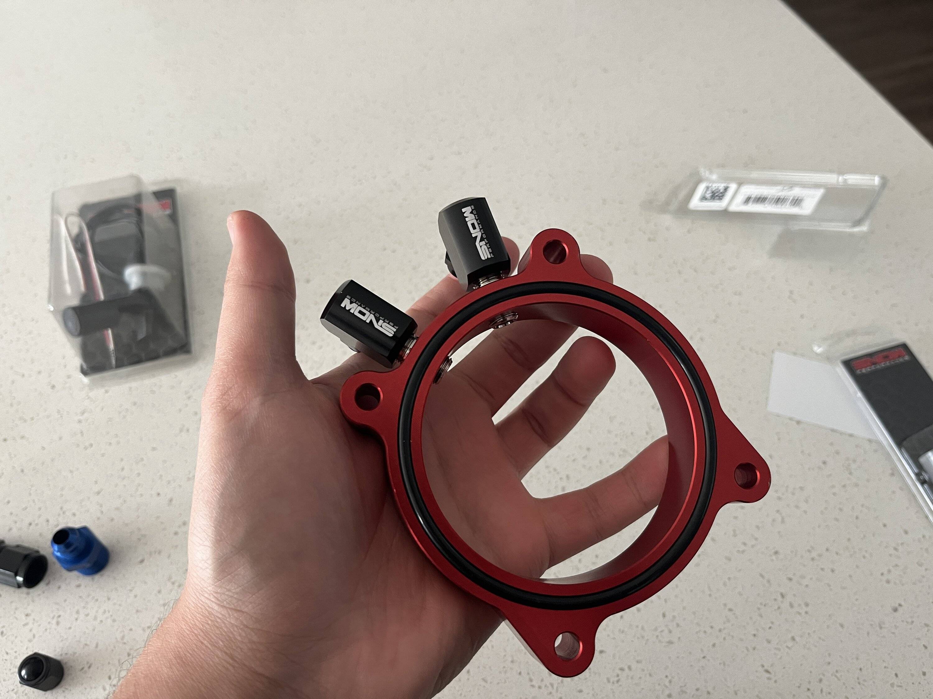

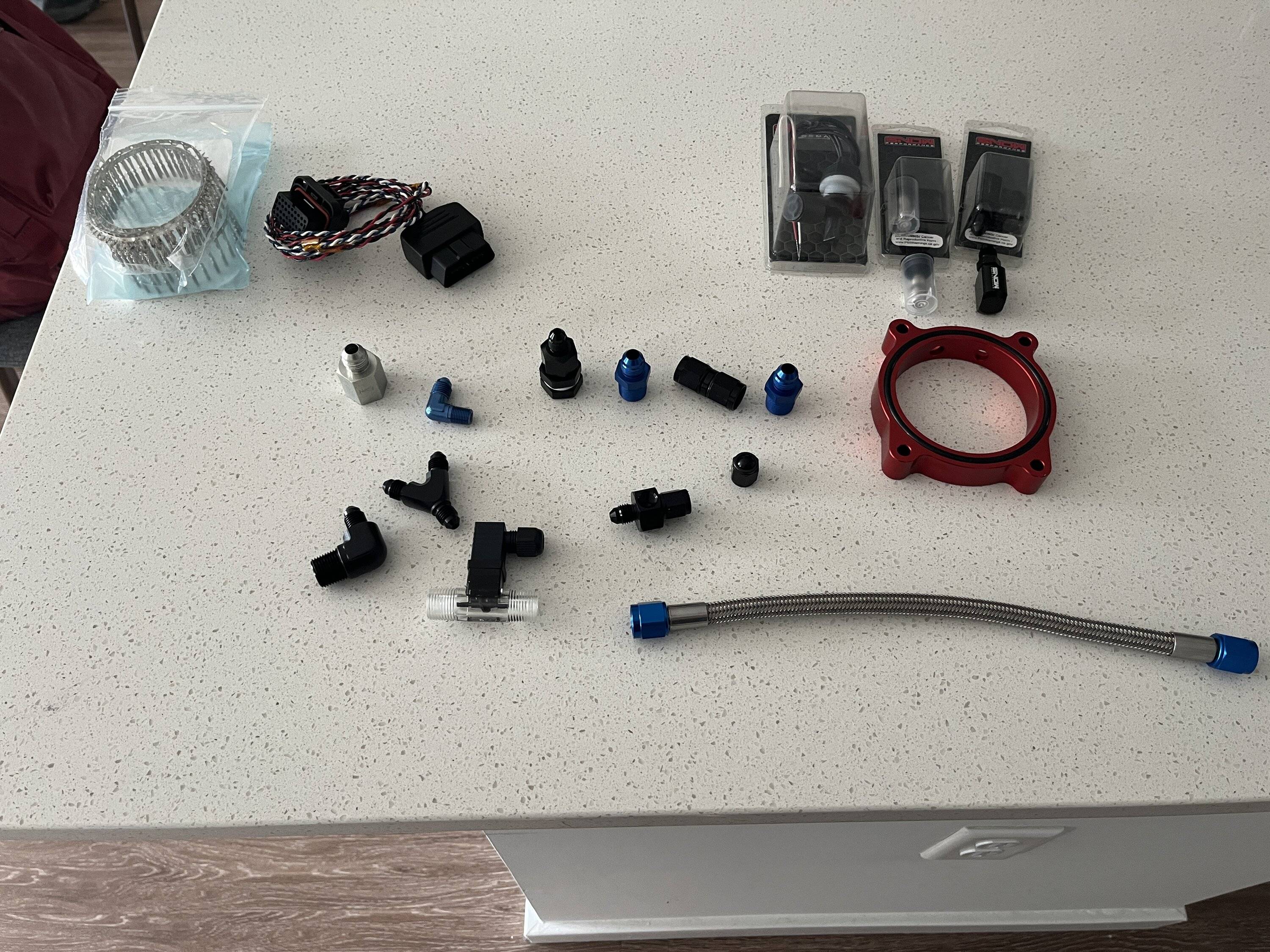

Then on the same day more parts arrived!
An fittings are not cheap, but they are very nice to work with and very easy to service.

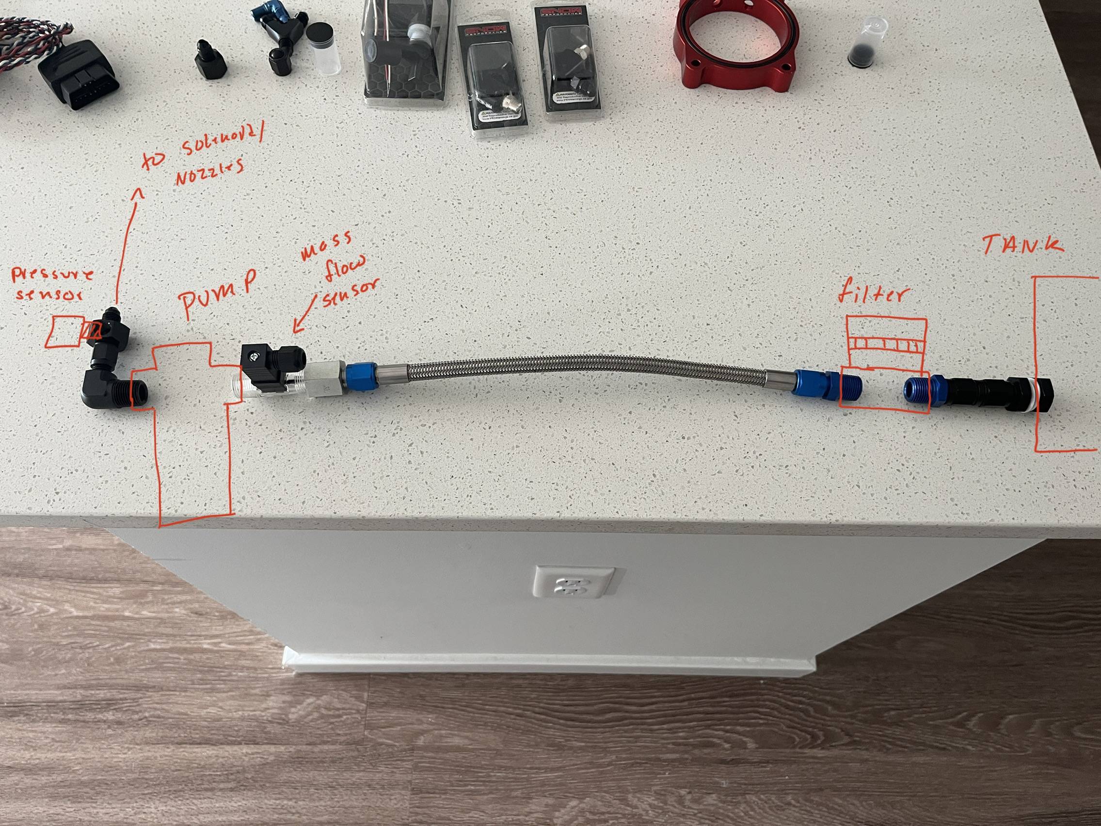

Here's how the plumbing around the pump and tank will be:

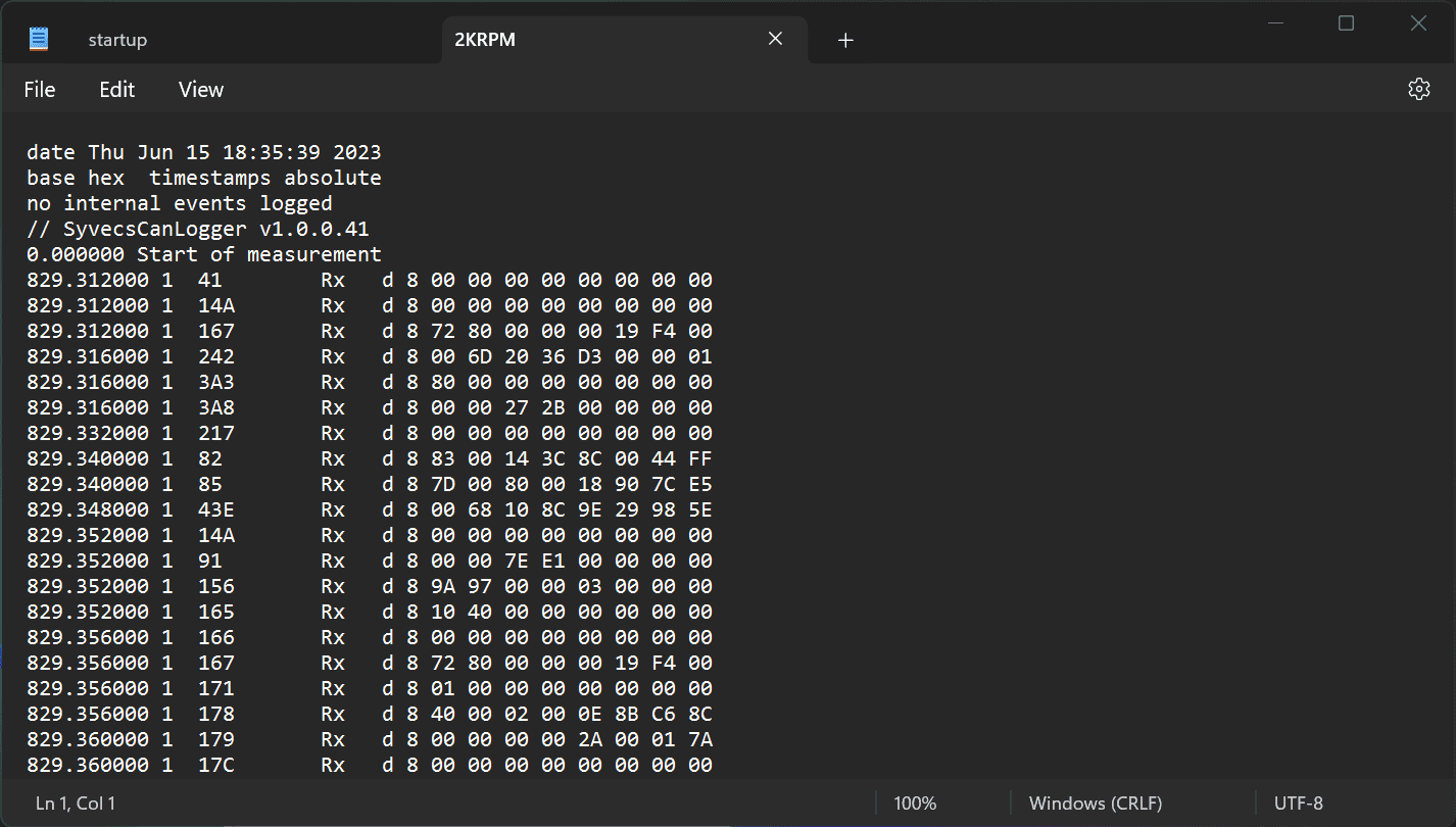

WMI controller is in!
also relocated my radar detector
CAN logging is beginning immediately, hopefully the guys at Syvecs can use this to get the 2 way communication going to the ECM.

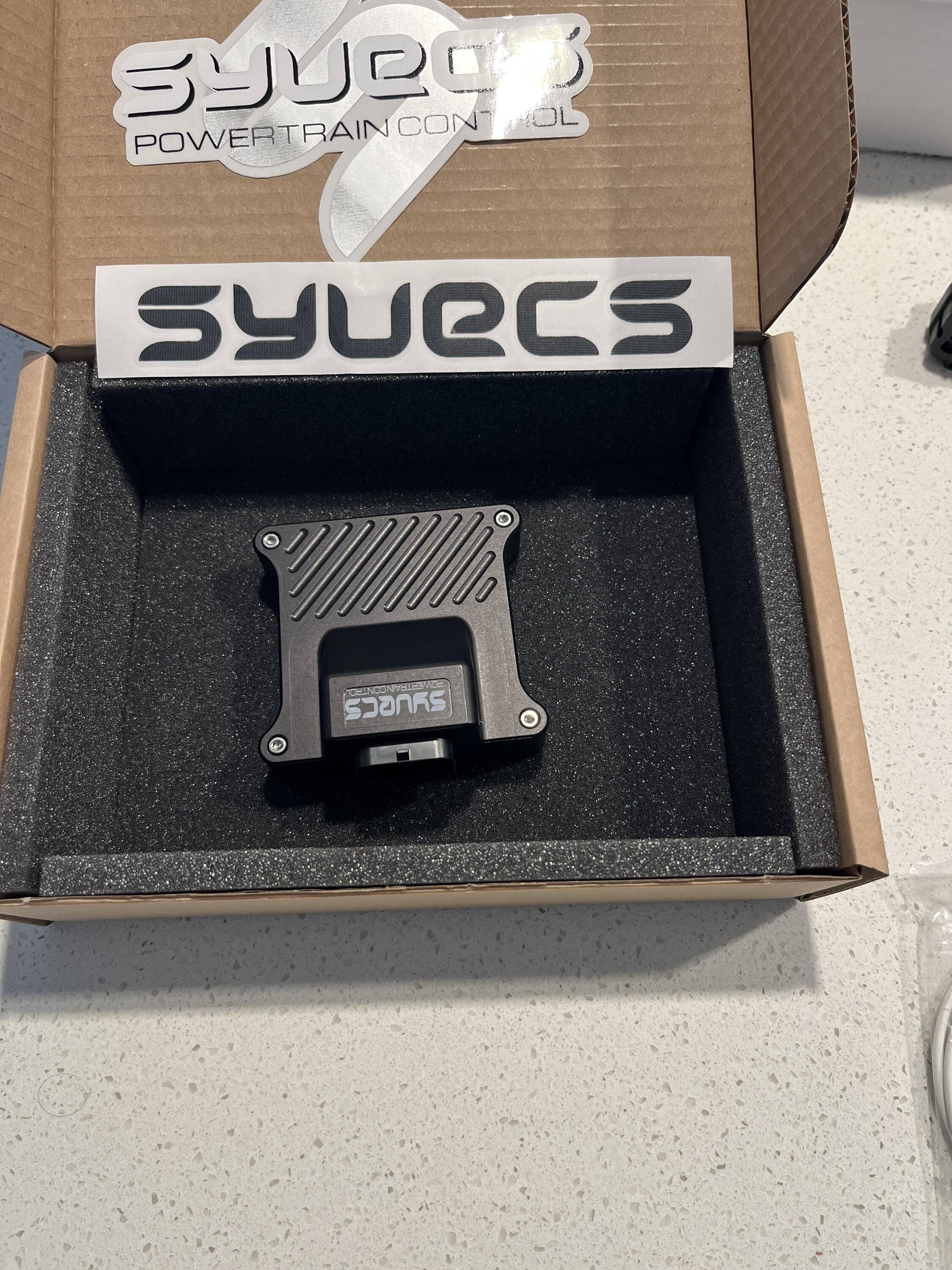

NOTE for anyone planning on using this standalone:
Syvecs calls out the connector wrong in their description, manual, and literature.
Wrong connector: 2-1437285-3 (34 position)
Correct connector: 1473416-1 (26 position)
The picture in the manual shows a 26 position connector, however the part number they give you is a 34 pin connector, the product description says "34 pin connector". This is wrong its the 26 pin connector.
However, the silver lining is that they give you a connector in the box, so you won't need to worry about buying it at all.
