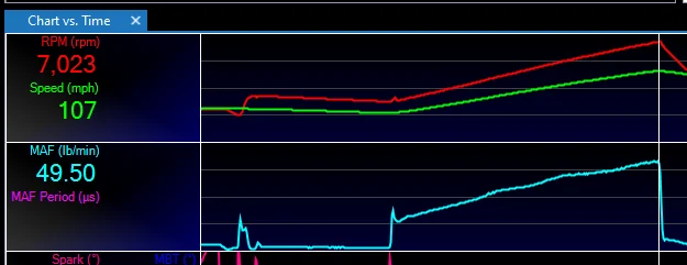

We've heard time and time again that a motor is an air pump, what is typically left out of that definition is that a motor is a pulsed air pump. Air enters the motor in pulses, and exhaust exists the motor in pulses. This is a critical parameter to understand in a naturally aspirated application.
What does this mean? This means that things like the diameter of the intake runners, the length of the intake runners, the diameter of the exhaust headers, and the length of the exhaust headers all play a role in when the motor makes its power. These things effect the resonant points of the system, which is to say these items effect when the system will operate with the least losses and in turn create the most crank torque. This is where a lot of confusion begins to appear. The stock headers and intake manifold do not restrict airflow to the motor. See the plot below:
The light blue graph shows the data coming off the mass airflow sensor. This pull was done on a particularly cold day with nice dense air, as a result we are seeing just shy of 50 lb/min of airflow. This airflow mass is enough to theoretically support horsepower in the high 400's, if we used our general rule of thumb we would (wrongly) assume that this car is making 490hp with proper fuel. We know in practice that this is not true. A more realistic airflow mass (on a warmer day) is more like 47 lbs/min.
The takeaway is that we're flowing enough air through the motor on stock hardware to make significantly more power than the stock motor makes. The setup used during this pull is a fully stock Gen3 coyote with a K&N panel filter.
The stock intake manifold and exhaust headers are tuned in such a way that they provide good performance over the entire rev-range. When we do things like switch to longtubes, or ported manifolds, we are not removing a restriction, rather we are changing the resonant point of the system to be at a higher RPM. This allows us to make more power at the top of the rev-range, but is often at the expense of low RPM fuel consumption or power. The IMRC in the OEM manifold gives the stock setup two resonant points, one at low RPM and one at high RPM. A feature that's been in German cars since the early 2000's and attempts to get the best of both worlds.

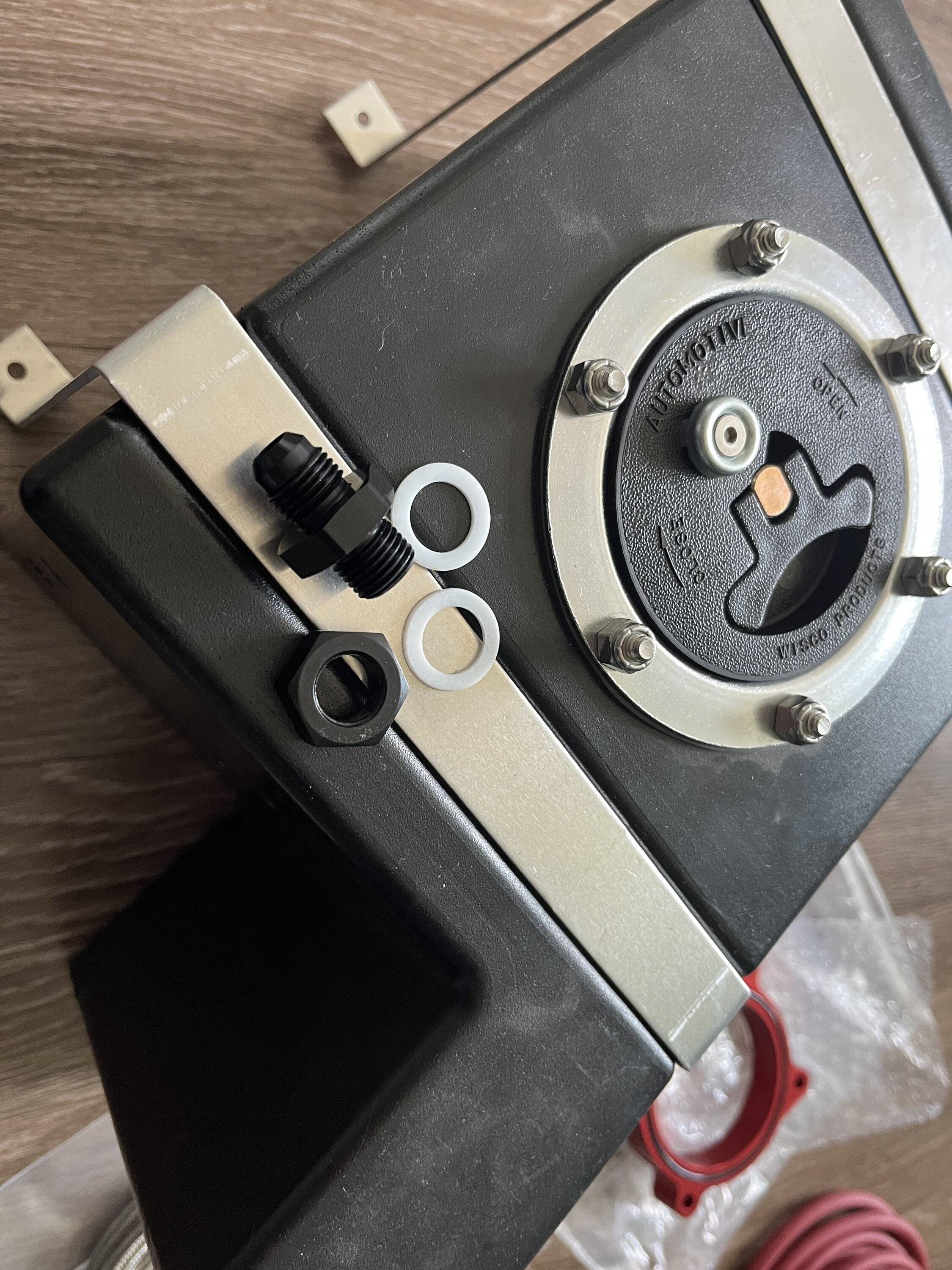

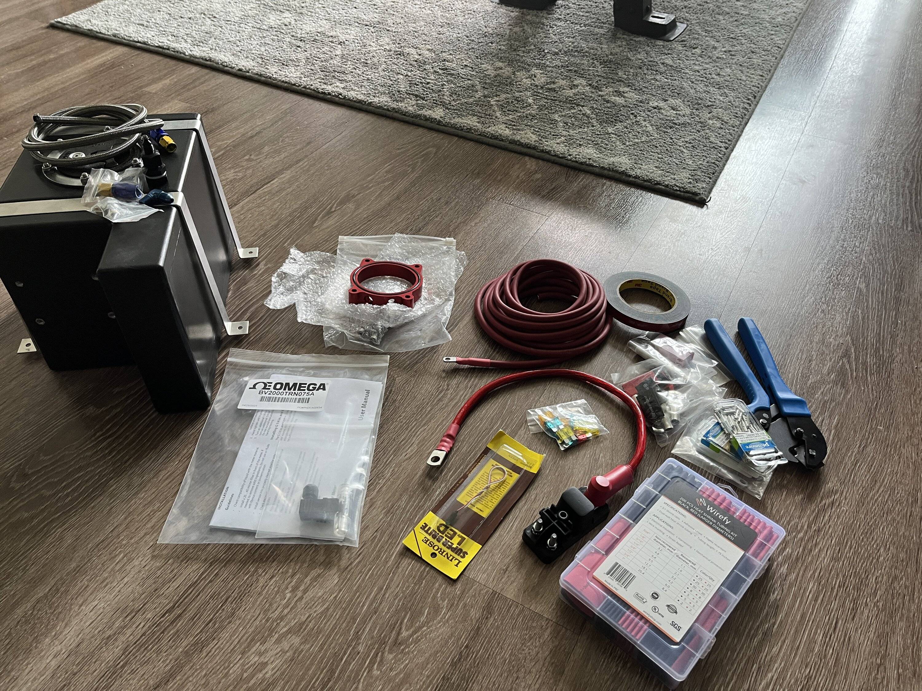

WMI hardware:

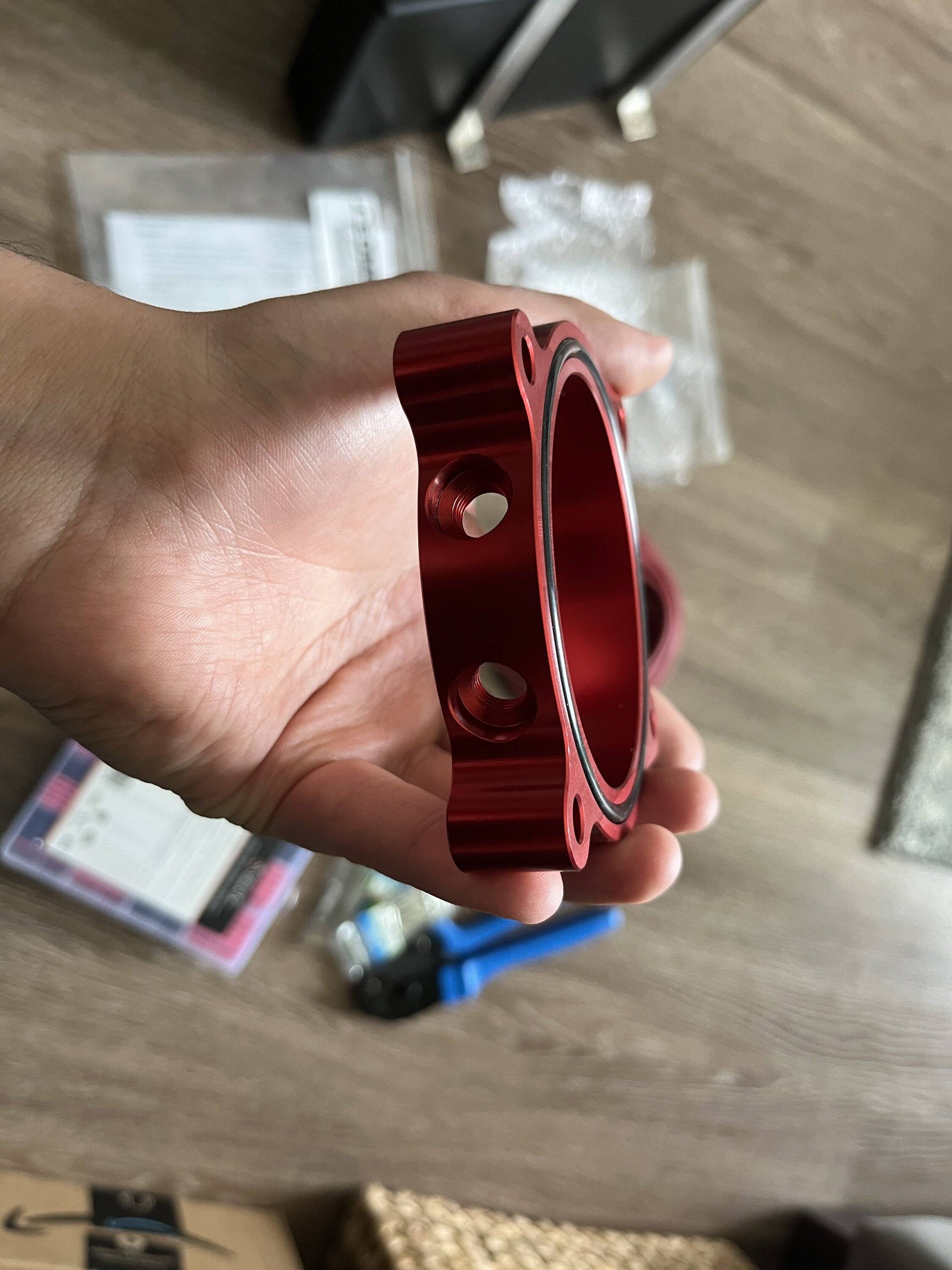

im not using a kit I’m pricing this setup together myself. Here is what I have so far:
devils own 2.25gal meth tank with -6AN bulkhead

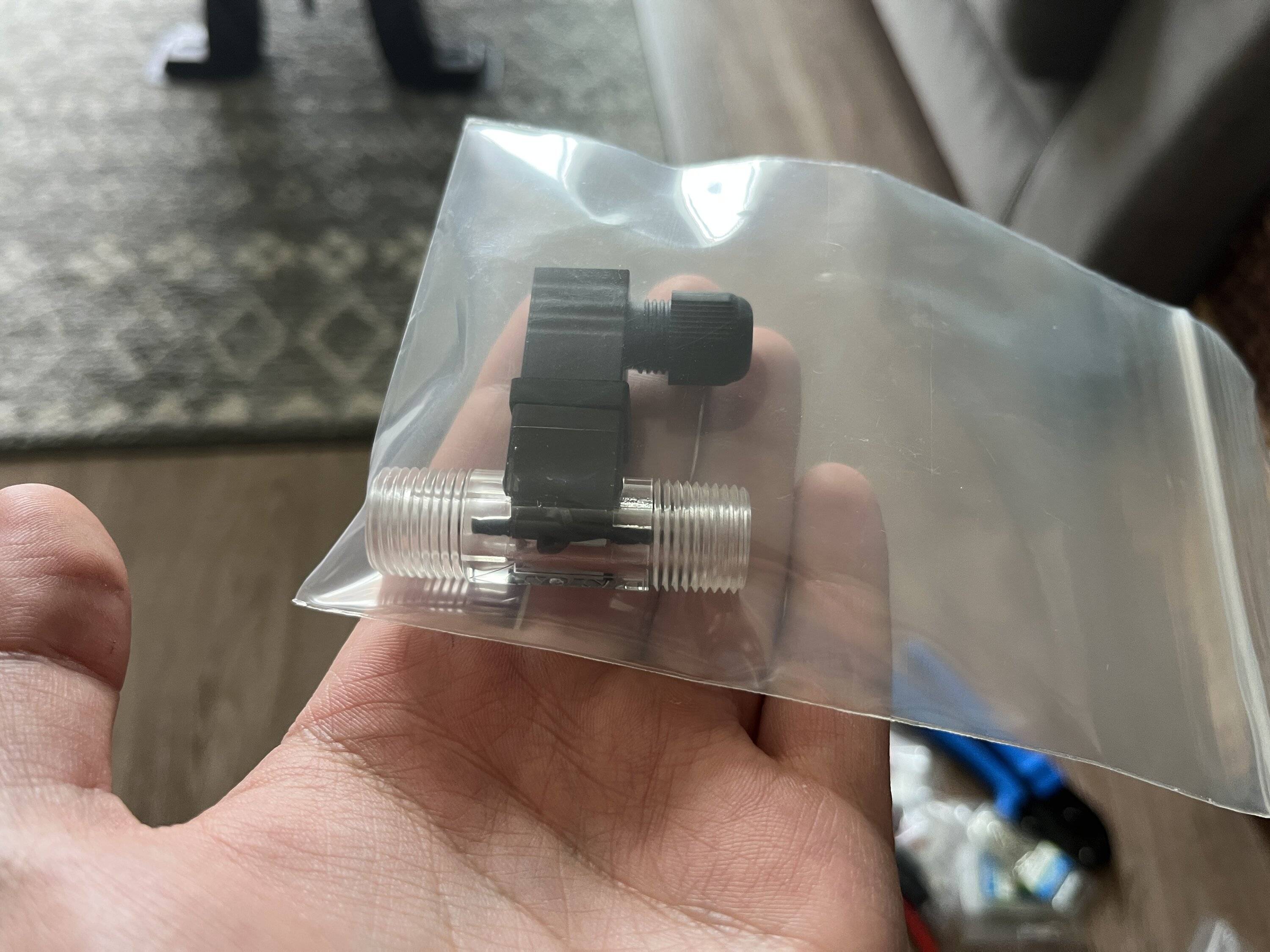

BV2000TRN075A turbine flow meter from Omega ($100 for this sensor alone ☹)
eBay special throttle body spacer with 2 ports

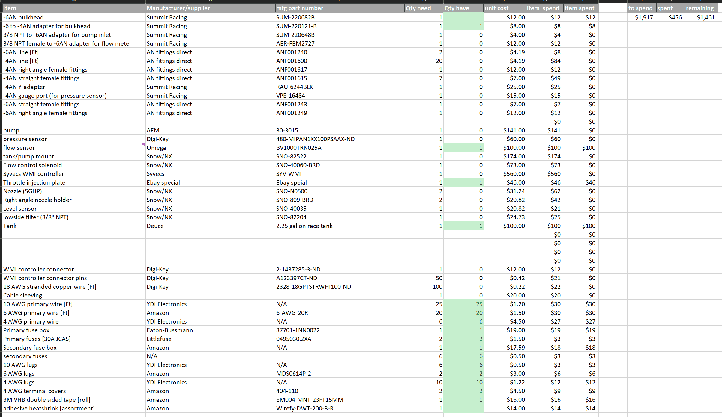

here is a snapshot of the whole buysheet with costs, suppliers part numbers and quantities:
This is not at all a cheap build its very much a money-no-object setup.

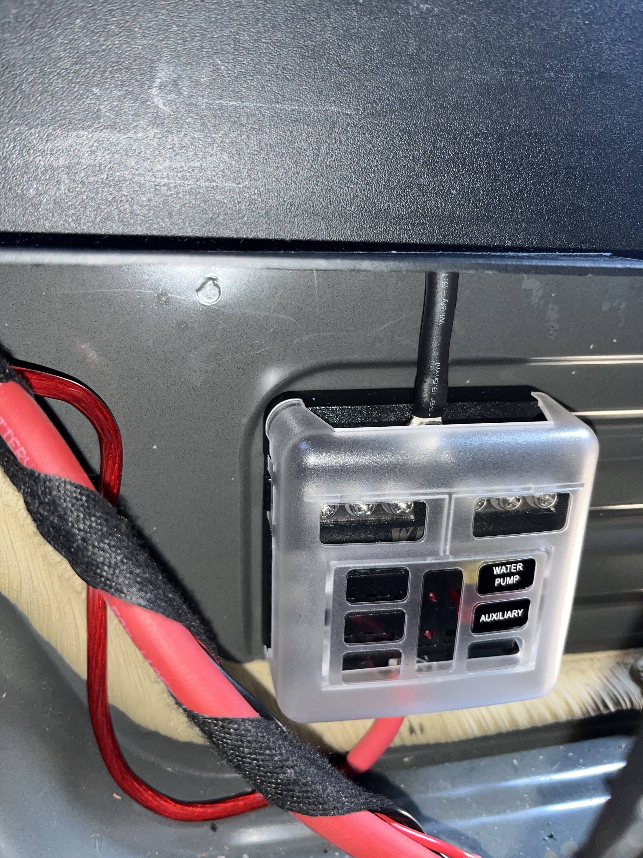

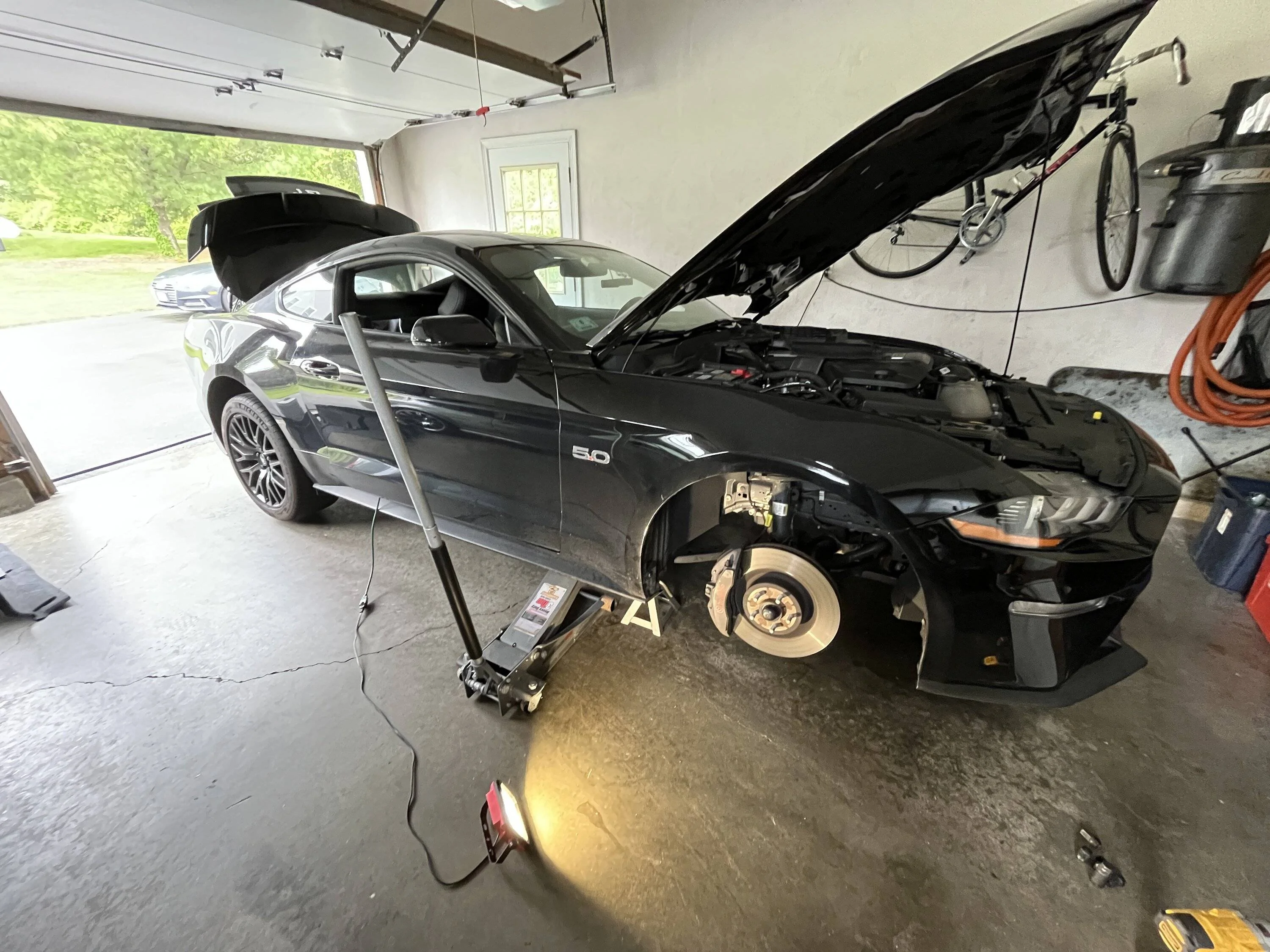

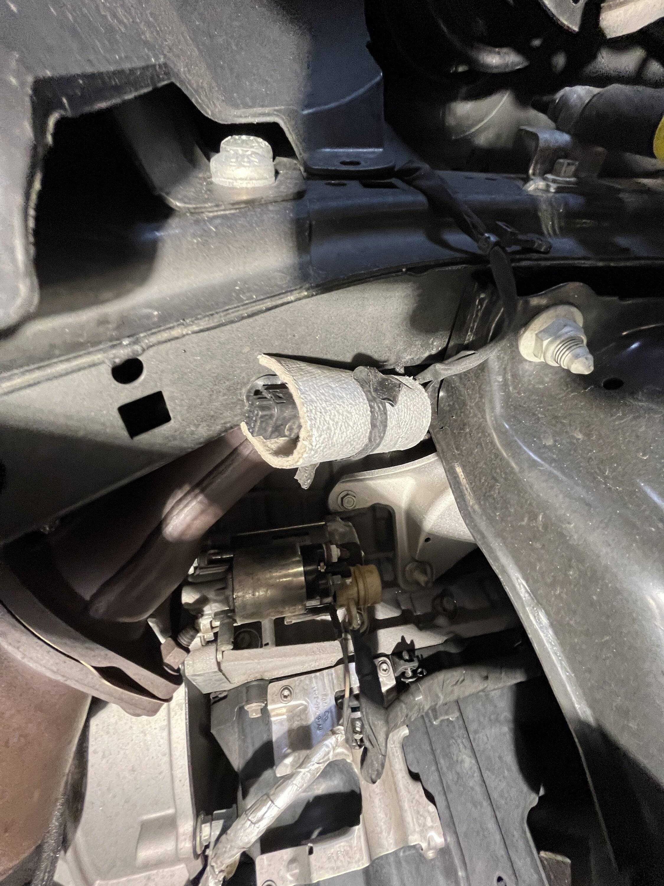

Initital wiring is 95% complete, I need to extend the main wires in the engine a bit more.
First, jack up ya cah

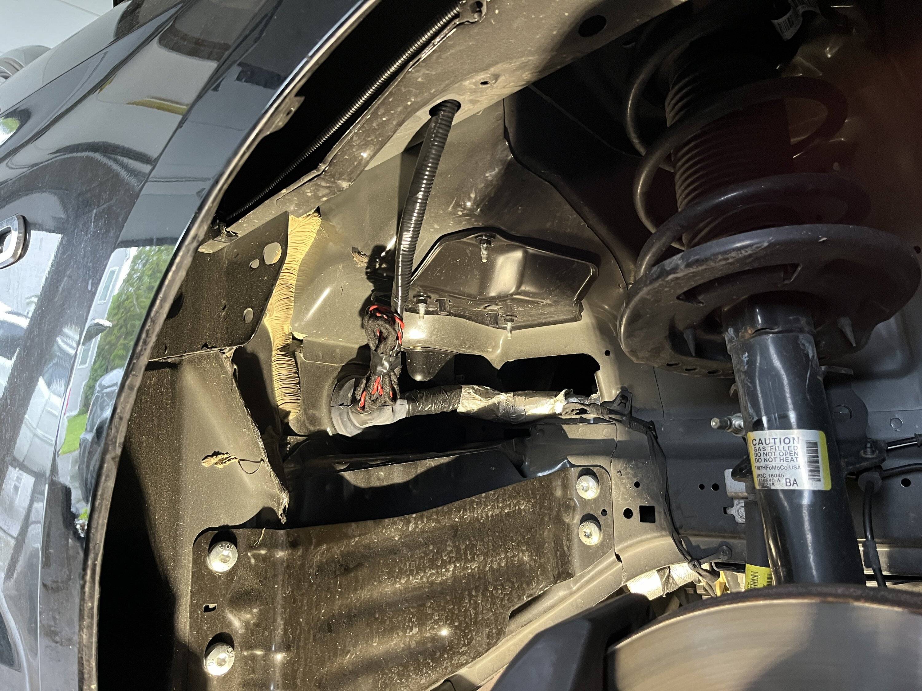

Found this connector under the passenger side wheel liner, for magneride I assume?
Wires go through this hole
and then down through an unused port on the main grommet. I also threaded 4 18 AWG wires, which can be used for sensors, triggers, and the solenoid. I only really needed one for the solenoid but it never hurts to have extra, and If I need to do this again I'll probably jump off a bridge. I hate running wires through the firewall.

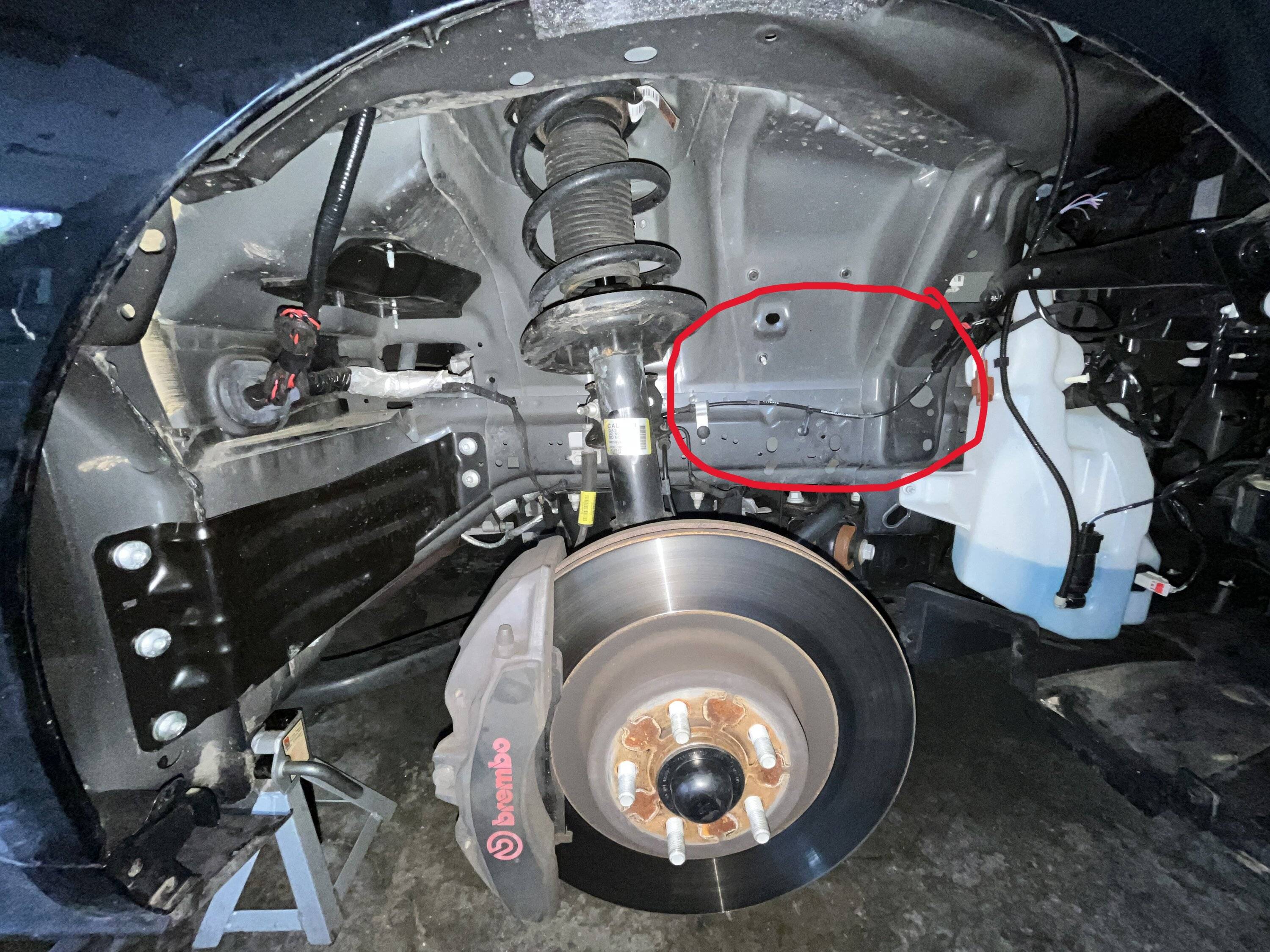

I bundled up the smaller wires for now. The plan is to mount the solenoid behind the wheel liner, somewhere in this area. I may use the extra two for a pressure sensor, or they might become trigger wires. I haven't decided yet.

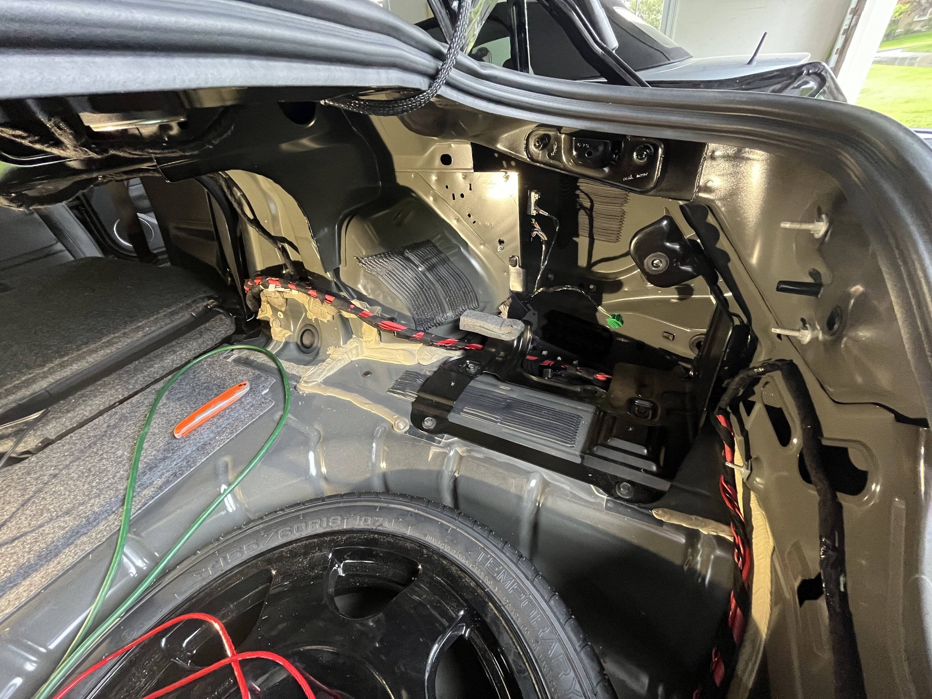

The 4 small wires, 6AWG, and 10 AWG wire travel along the body at the bottom of the door frame with the main harness and then pop out next to the factory subwoofer in the trunk. I wrapped the loom in tessa tape to protect it and give it a factory look.
the Thick 6 AWG wire is left unconnected for now it will eventually go to a sub amp, I wanted to run it because I didn't want to spend all this effort and time putting wiring primary wires only to have to do it again.
the 10 AWG wire was terminated and attached to this auxiliary fuse box. This supports 6 30A circuits (Though I wouldn't recommend going near that limit) and has LED's to indicate a blown fuse. I used 3M VHB to stick it to the back wall of the spare tire well. The ground goes to a factory ground lug in the trunk. Its just an amazon special and its meant for a boat, but it looks pretty slick and it should make my life much simpler.
The last thing I need to do is connect the wires to the main fuze box at the front, unfortunately I made my life complicated and accidentally cut the wires too short. So that will be an update that will come later.

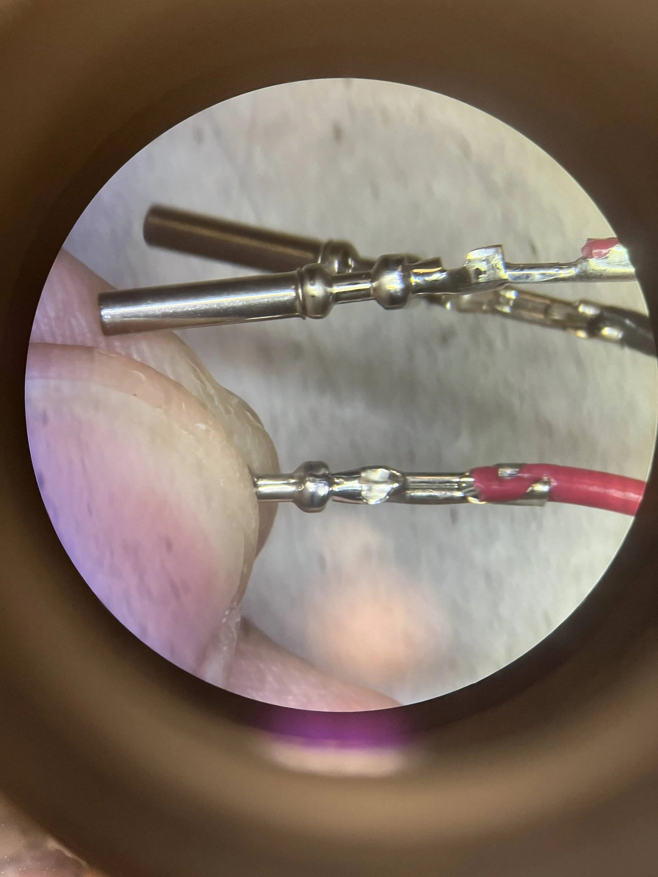

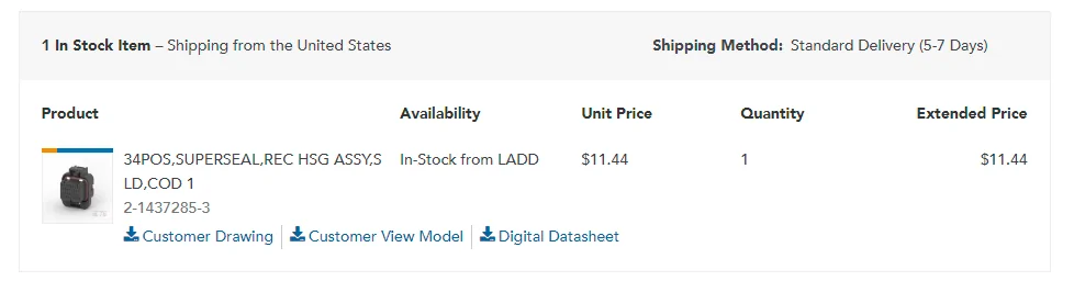

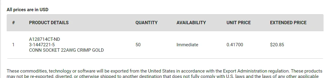

Procuring the special connector for the Syvecs WMI controller:
The Syvecs WMI controller uses an off the shelf connector from TE connectivity, and while their choice is perfect from an engineering and reliability standpoint, it is awful for a regular person to get ahold of. There are not many places that you can buy this connector and these pins from, and of the ones that do have this part in stock, about half have a really high minimum order quantity.
A quick check revealed that the connector housing, and 2 of 3 types of available pins are 0 stock from digikey and have a 4 month lead time 😬 These parts were both in stock last week. This got me spooked so I'm ordering them now before all the distributors sell out even though the project is still months out.
The pins are available in a -5, a -4 and a -3 variant, for 22AWG, 20AWG and 18AWG respectively, my preference was for the -3, but its only available in full reels of 7000...
I was able to snag a housing direct from the manufacturer, but unfortunately I was forced to buy the 22AWG pin variant. I think this will be fine, most pins on the housing are redundant so I don't expect voltage drop the be a big issue.
Also TE required me to indicate the final use case and if it will be exported. I gotta say I'm not used to having to sign what is essentially an itar agreement for a plastic connector, but here we are.

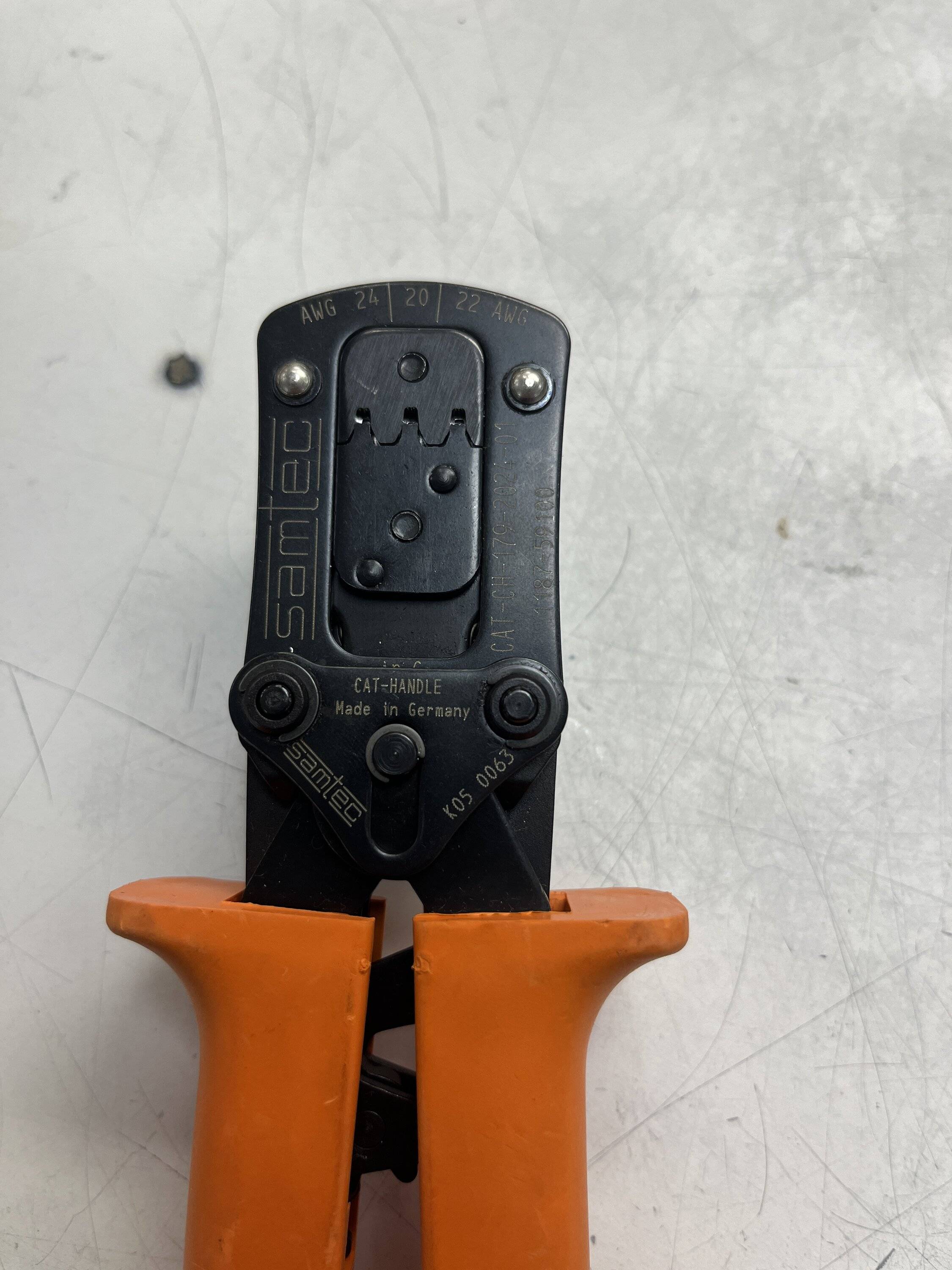

These connectors require a crimping tool, this wont work with just pliers or a normal crimper, I have an old one I bought off eBay some years ago, if anyone is looking to duplicate this you'll need a tool like this. A real crimper will be >$500 so I just deal with the ebay one and visually inspect and test each crimp, if you're careful you'll have no issues. You can also add solder to the joints after they are crimped but you need to be careful. Too much solder will foul the connector and not allow it to mate.

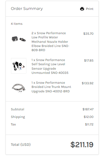

more parts ordered:
Prices are great at beefcake, much less than summit. I want to get the line run and the solenoid mounted. Then all of what I consider the annoying parts of this install will be done. Which is to say I'll be done crawling around under and in the car.

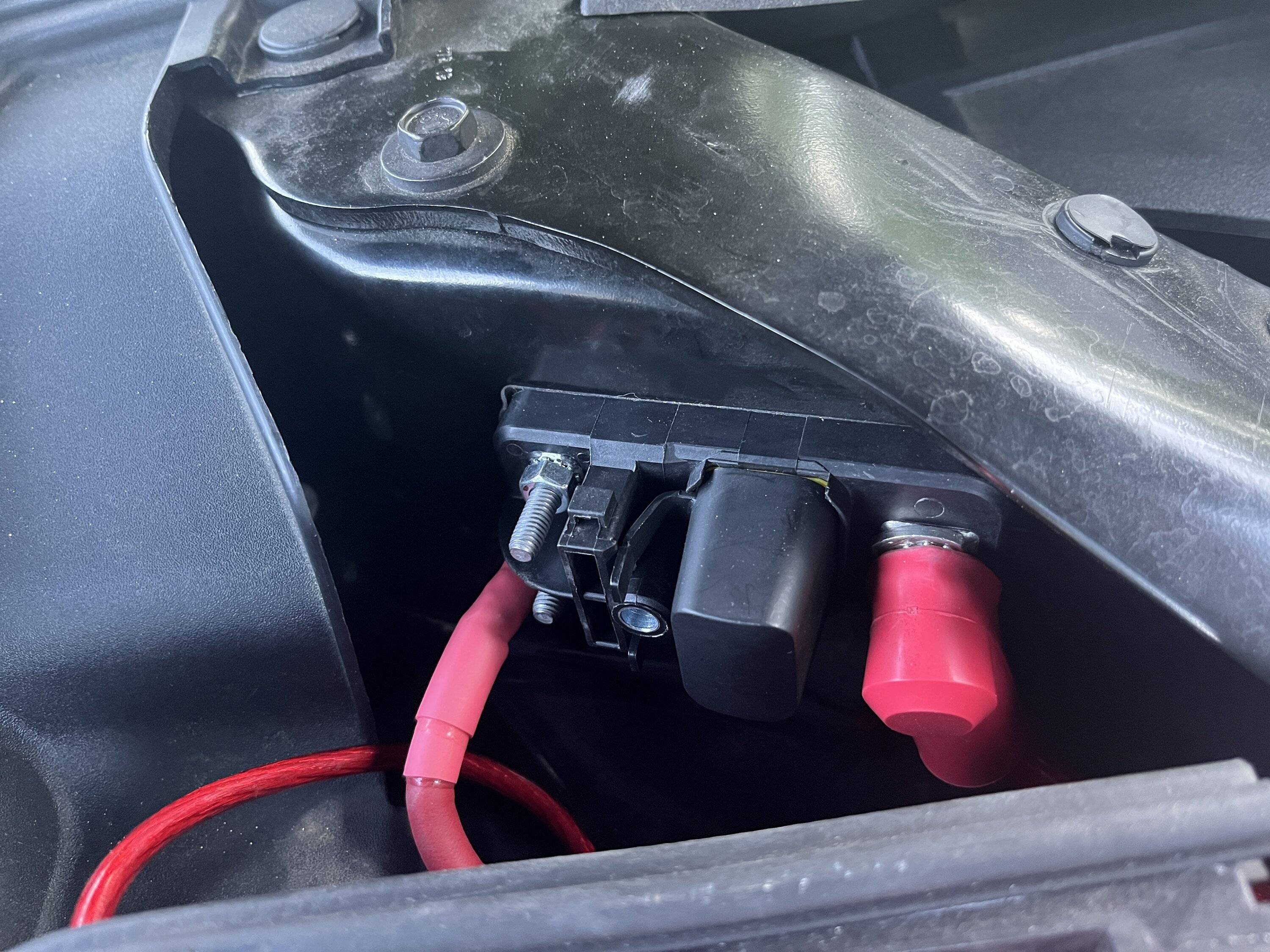

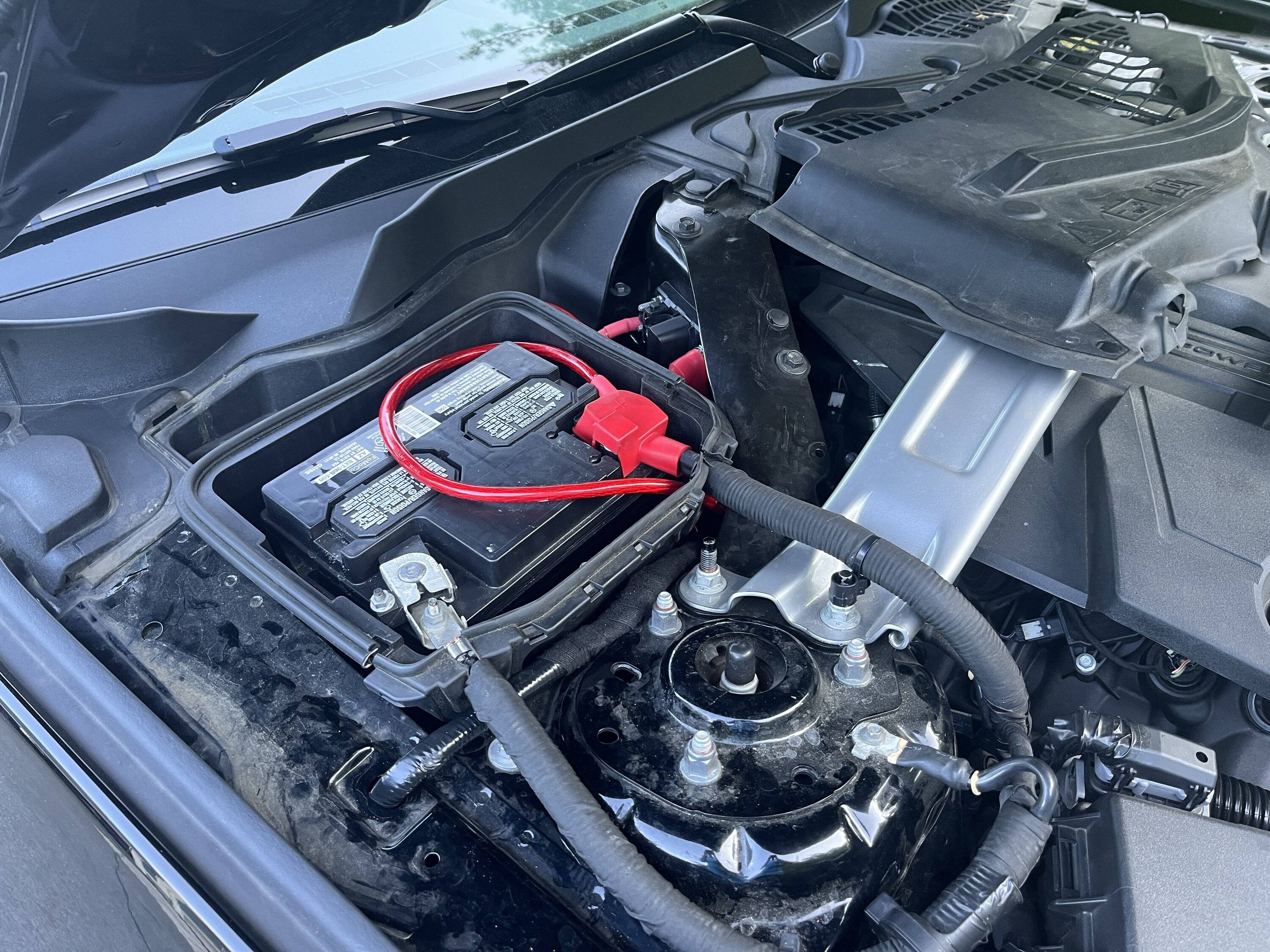

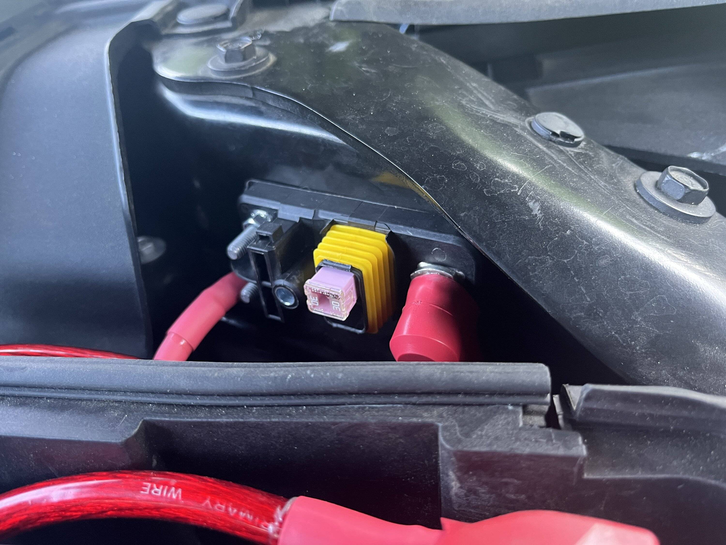

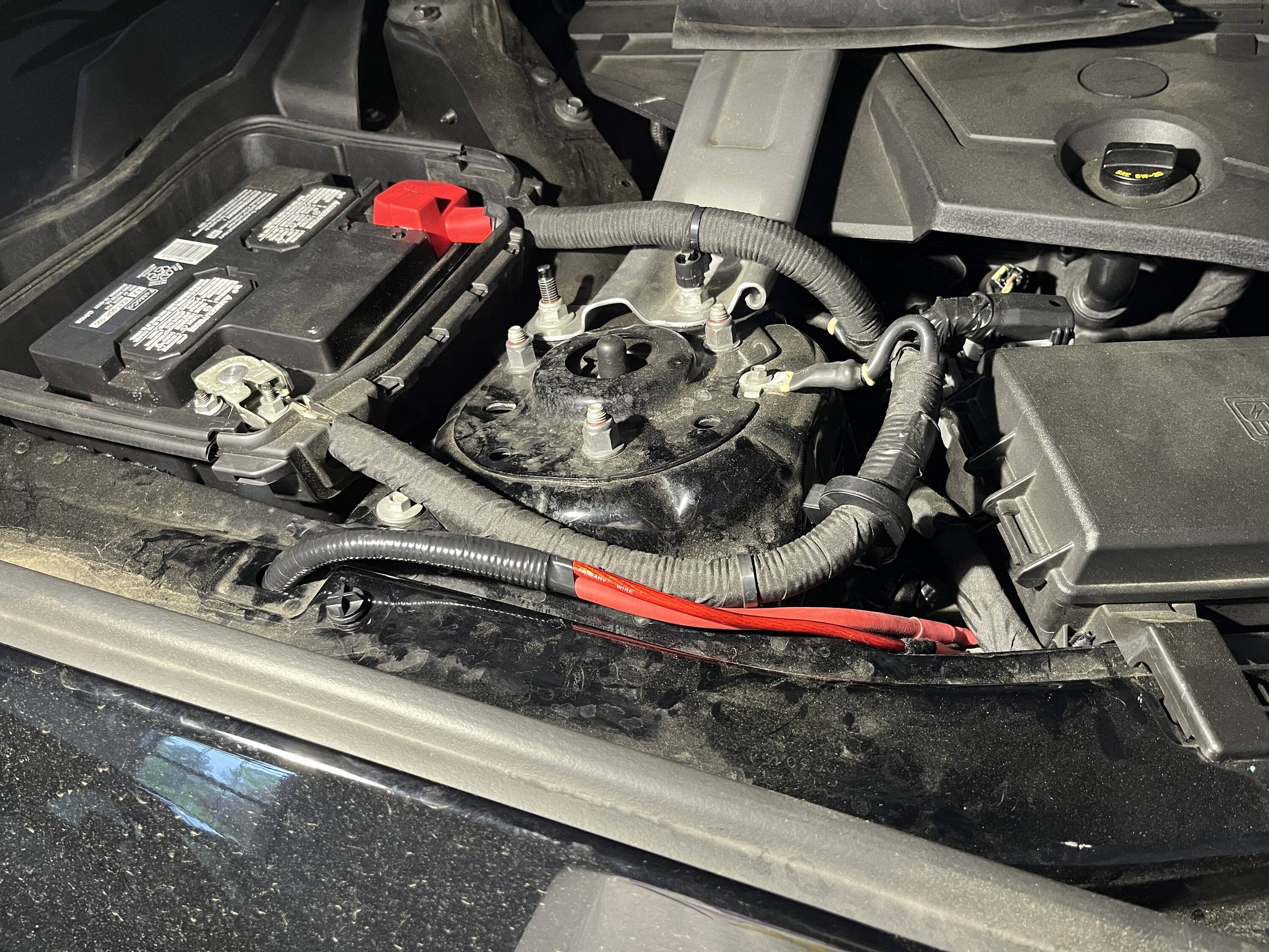

power is fully wired in. Main fuse box is mounted in the small area next to the battery box. I used the Christmas tree there to locate the fuse holder and some 3M VHB to lock it in place. It’s very sturdy.
I used about a foot of 4AWG wire to jump from the battery to the fuse box. I attached it to the positive thermal in the same way as shown here:
https://www.mustang6g.com/forums/th...at-install-long-post-heavy-pic-warning.78694/
I disassembled the positive terminal and threaded the clamping parts through the terminal lug. When you crank down the bolt it pulls the lug tight onto the terminal. Nice install method and works very well. I wish they had used the same method as they did on the negative terminal and given us an easy place to attach to.
I’ll be adding an AGU fuse holder inside the battery box to protect the entire thing. With the cover on the battery box this install is invisible.

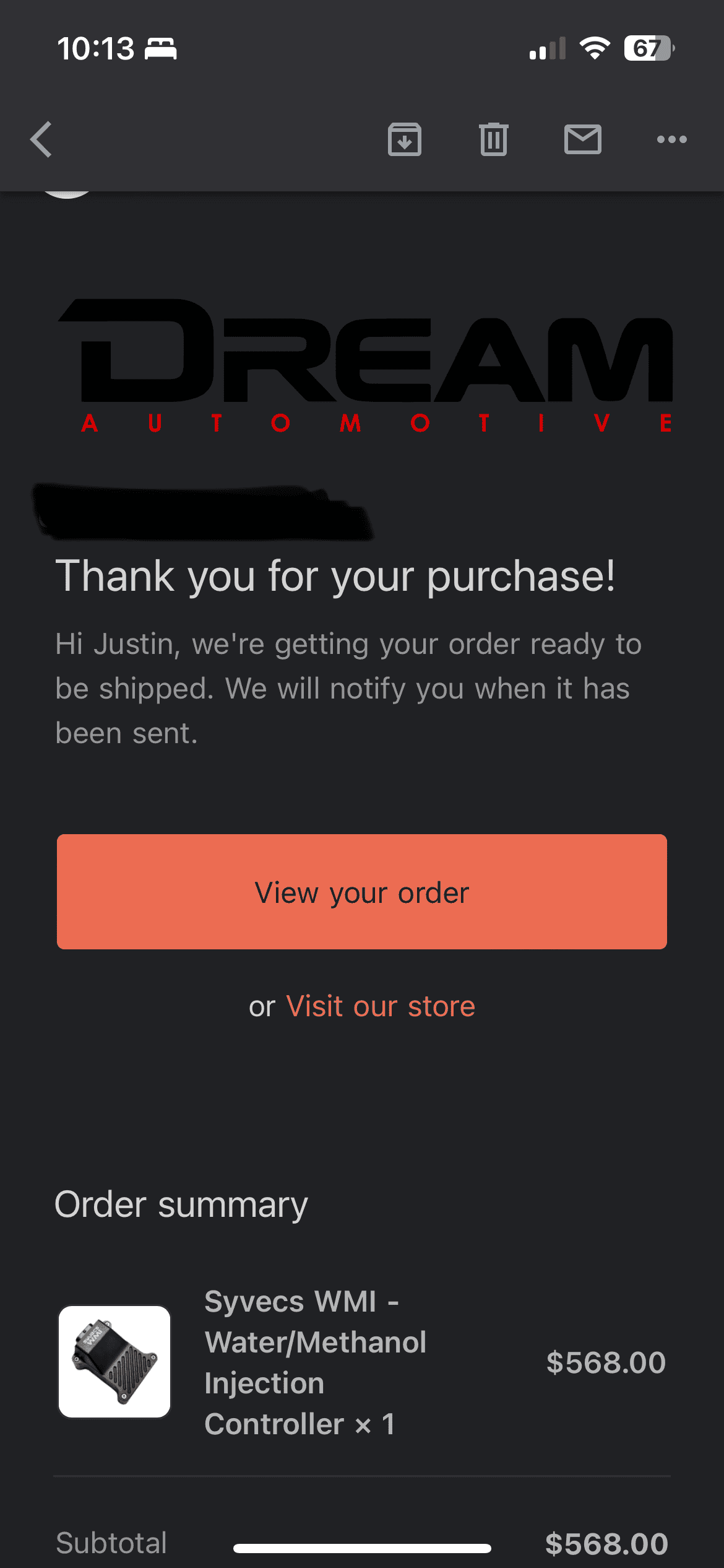

I also ordered the main event…
stupid money for this thing but I guess it is what it is, I’m adamant that this is the best on the market. Hell I think this could even be repurposed to control nitrous if you wanted.

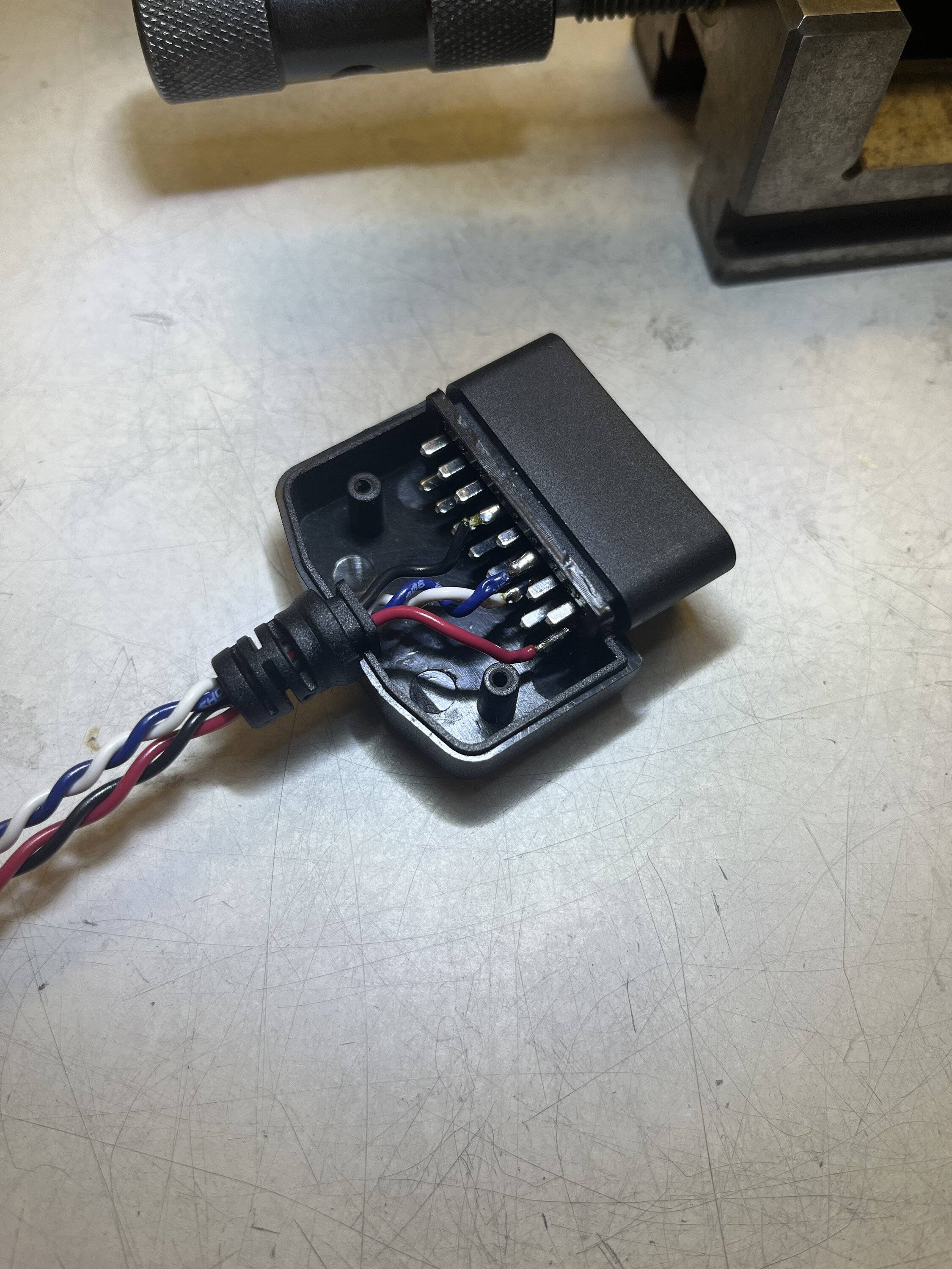

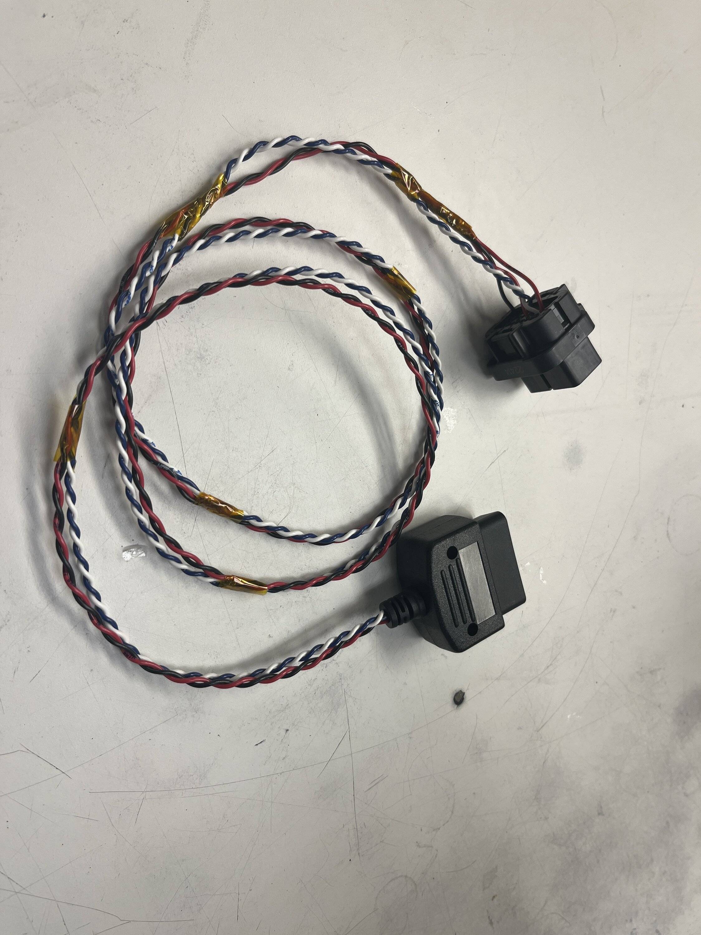

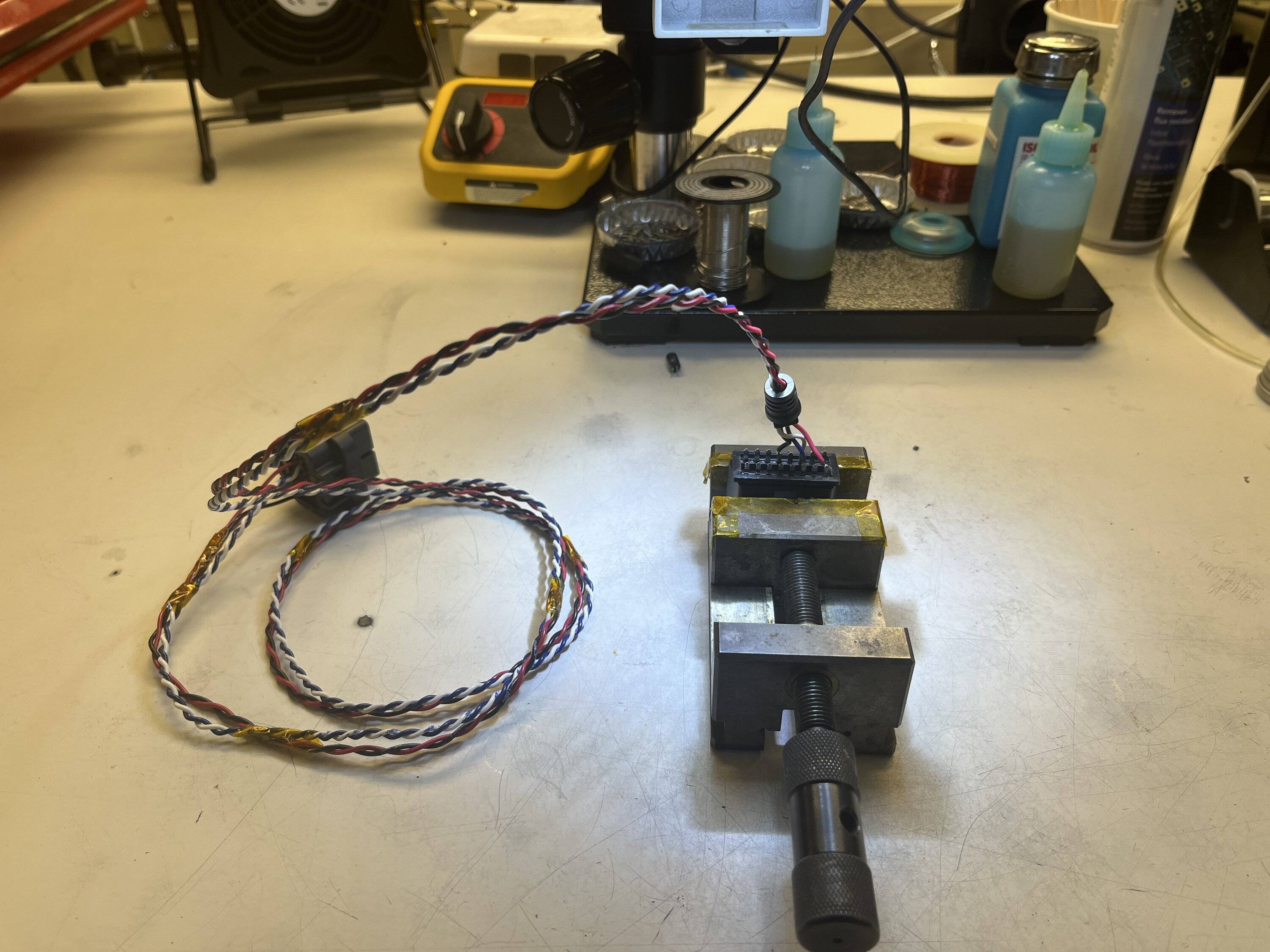

Harness made for testing and firmware development. A perk of my job is that I have full use of this professional rework station. Made very light work of this task.
The paperwork all calls for this 34 way connector but the pictures show the 26 way version. I hope it was just changed at some point and it’s not an error, I guess I’ll find out when it shows up.
CAN bus wires must be twisted or else it won’t work. Also you cannot make this harness without a crimp tool. Look how small these pins are.
