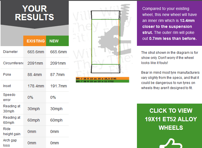

Ok great, thanks for the advice! I’ve got a set of Velgen 19x10 front and 19x11 rear on the way that is supposedly flush fitment. I saw that post above and started to panic lol!
rxryanm
Jan 11, 2019
672
890
KY
Ryan
2019 GTP PP1
What's the offset?
Joshinator99
May 13, 2023
621
1,151
Massachusetts
Josh
2022 Mustang GT Premium, 2017 Camaro 2SS
rxryanm
Jan 11, 2019
672
890
KY
Ryan
2019 GTP PP1

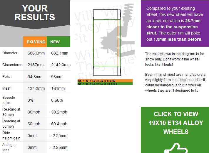

34 front 52 rear
You'll be golden imo.
Front compared to stock setup with a 25mm spacer (255/40/19 compared to 285/35/19). Was nice and flush.
Rear compared to my current aftermarket setup (305/30/19 for both, unsure what tire you're gonna run).
