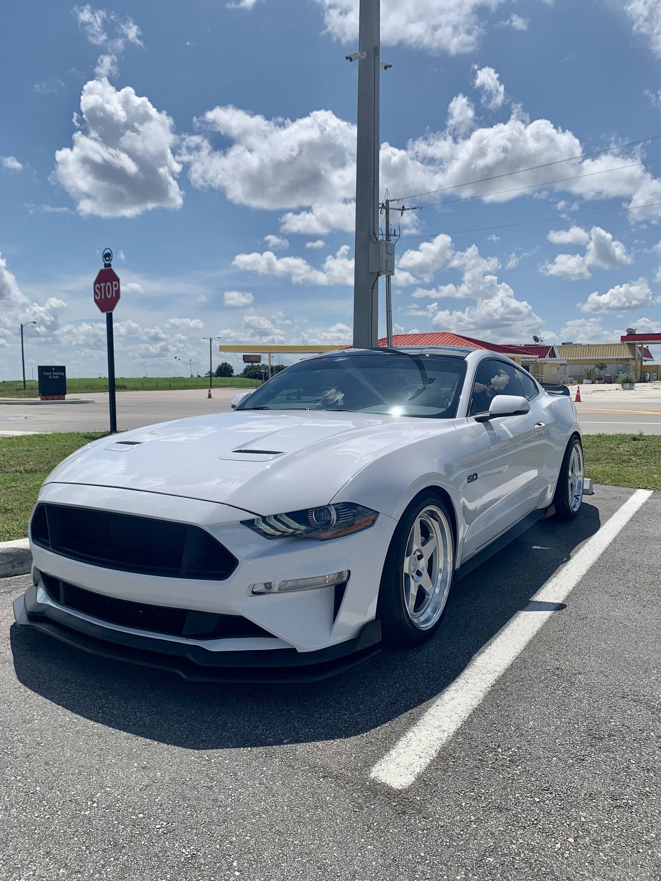

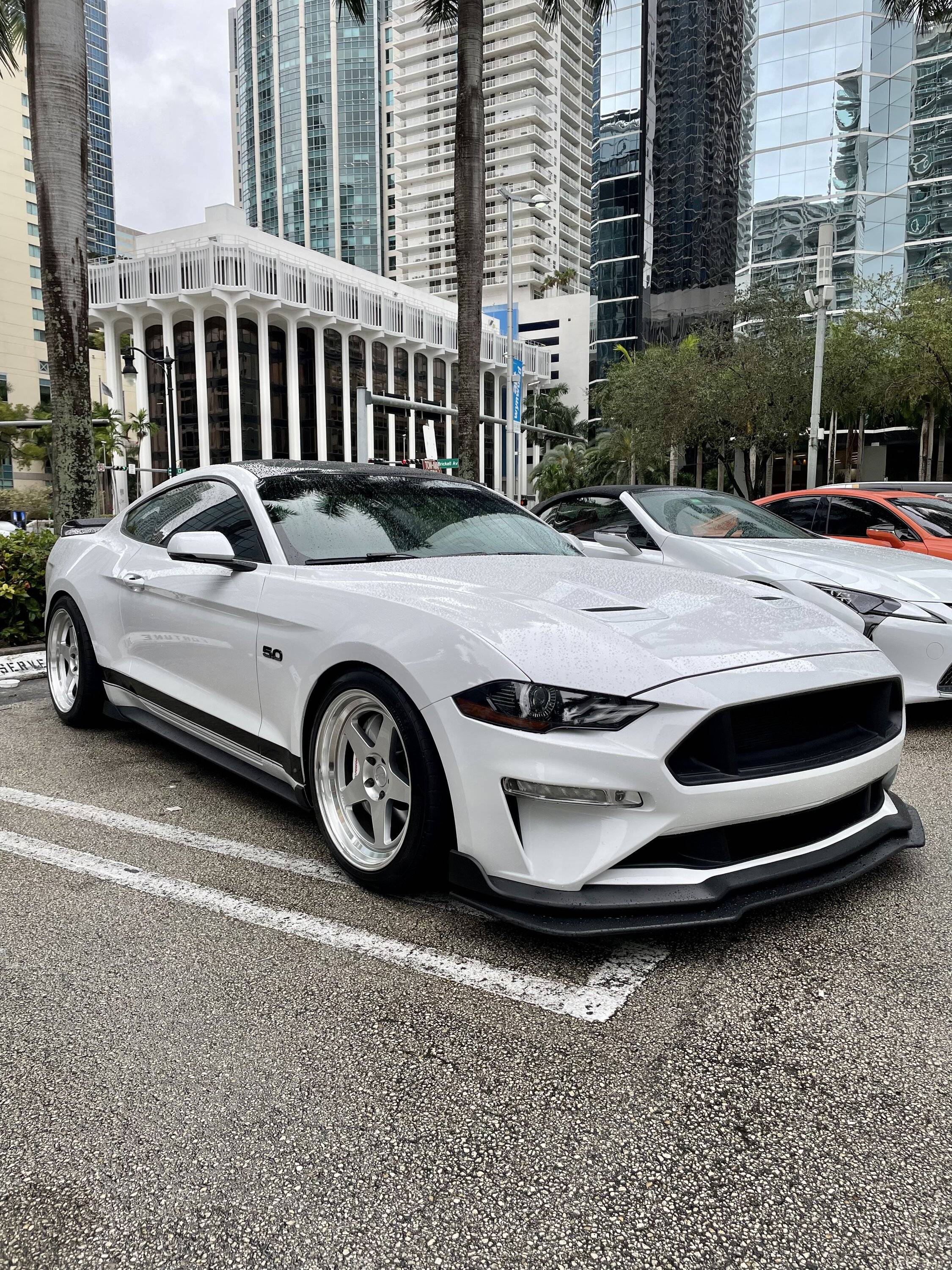

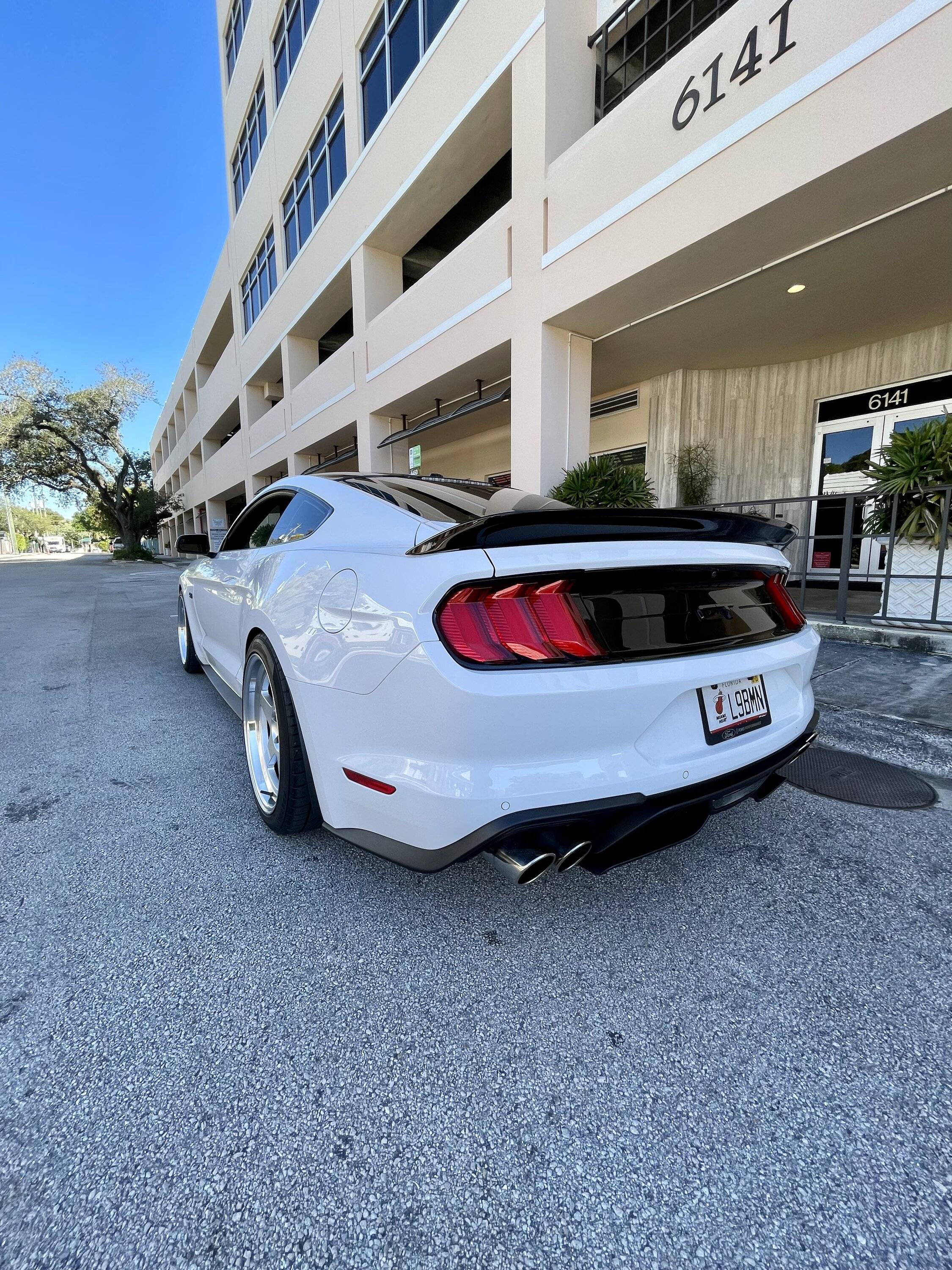

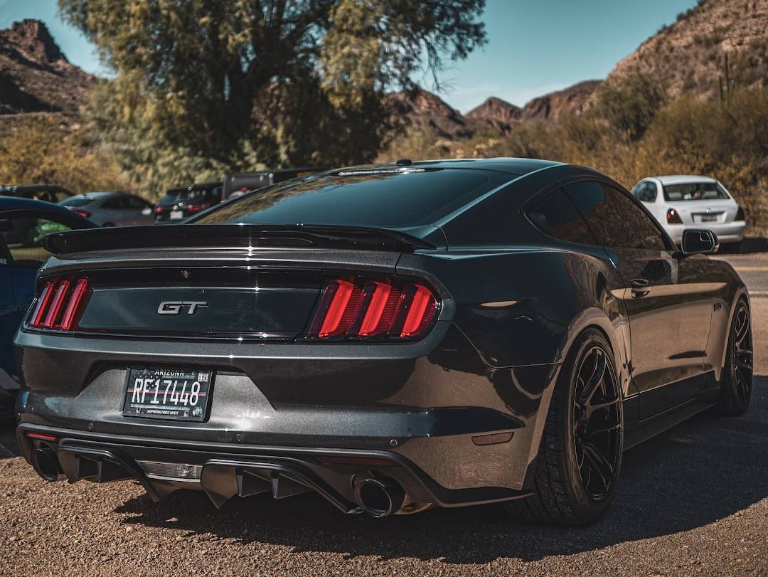

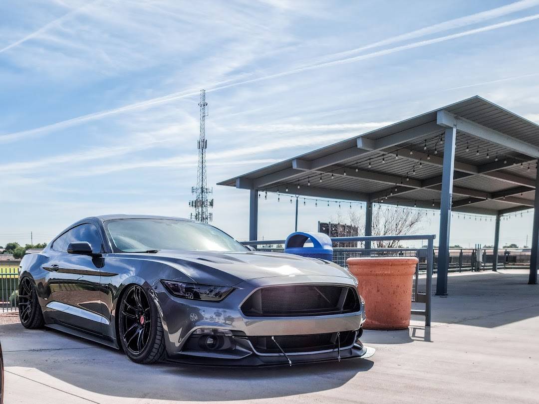

I am running 19x10.5 +35 offset all around. Tire size is 285/35/19. I'm running about 2 degrees camber up front and about 1.7 degrees camber in the rear. Fits great with no spacers.10/4 if anyone is running +35 offset I’d love to hear all about it. I’m thinking the 9.5 will give me more room, but I’m also not stancing it. I just want it low and drive able, like maybe 3 inch drop, then air up for driveways. And yeah I’ll read up on 3H in the next month, I’ve only been looking at 3p because at first glance was thinking I don’t want to jack with height sensors
