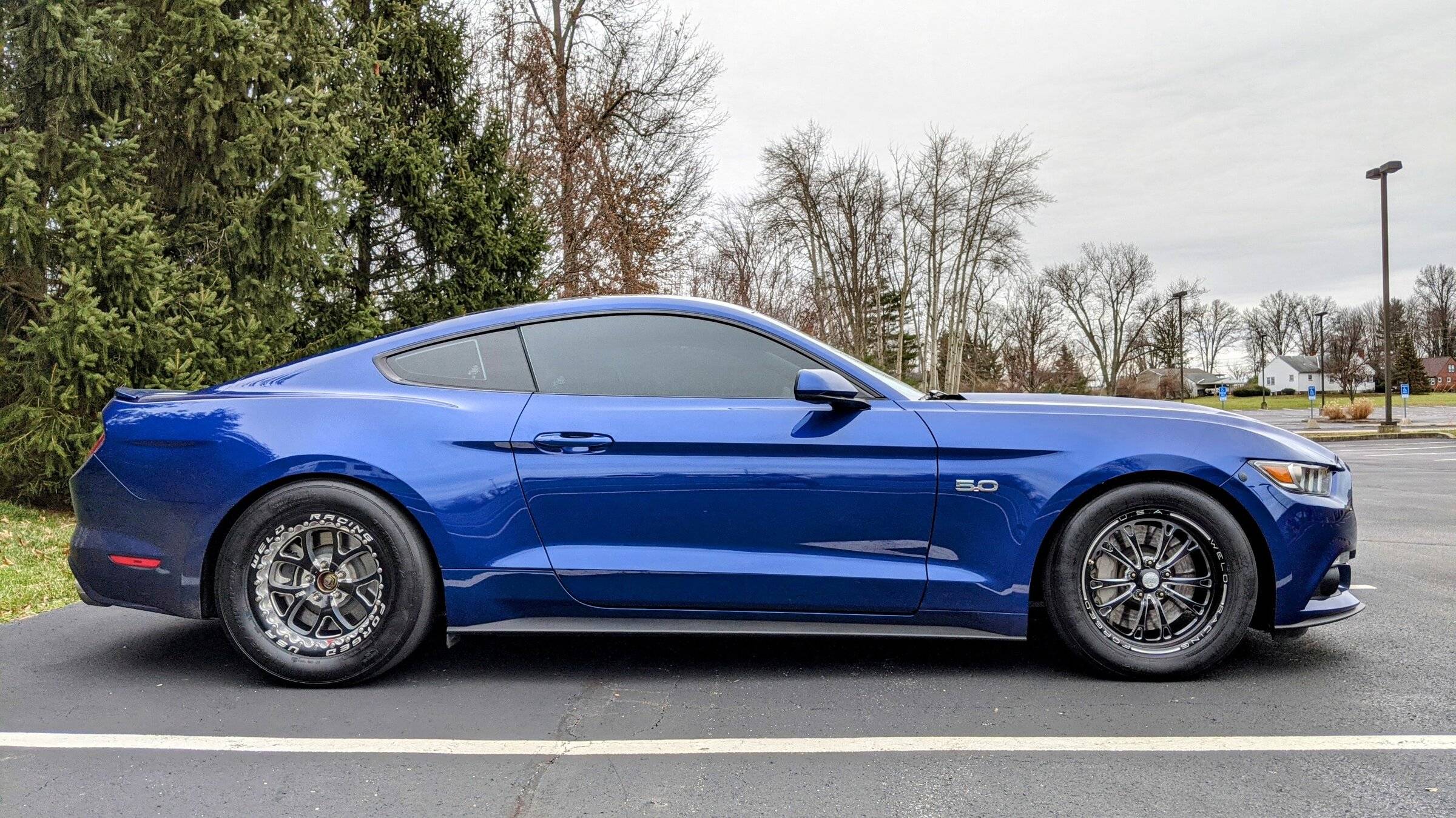

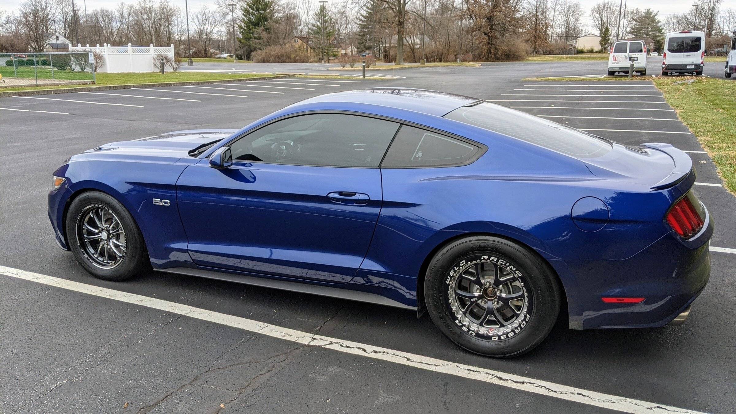

Hopefully this can be a resource for members looking for drag wheel info moving forward. Lots of different variables considering wheel / tire size, brakes, rear spindles and springs.
This would be a great place to lay out your details and pics!
Front:
17x4.5 Weld V-series, MT ET Street fronts 27x6-17. Billet alum shank lug nuts. Cortex Racing 14mm spacer to clear base GT brakes. Outer edge of tire still .75in from being flush. Viking coilovers up front.
Rear:
17x10 Weld s76 beadlocks w/ polished ARP hardware, ET Street R 305/45-17. No spacer needed, base GT brakes. Fitment near flush at -1deg static camber.

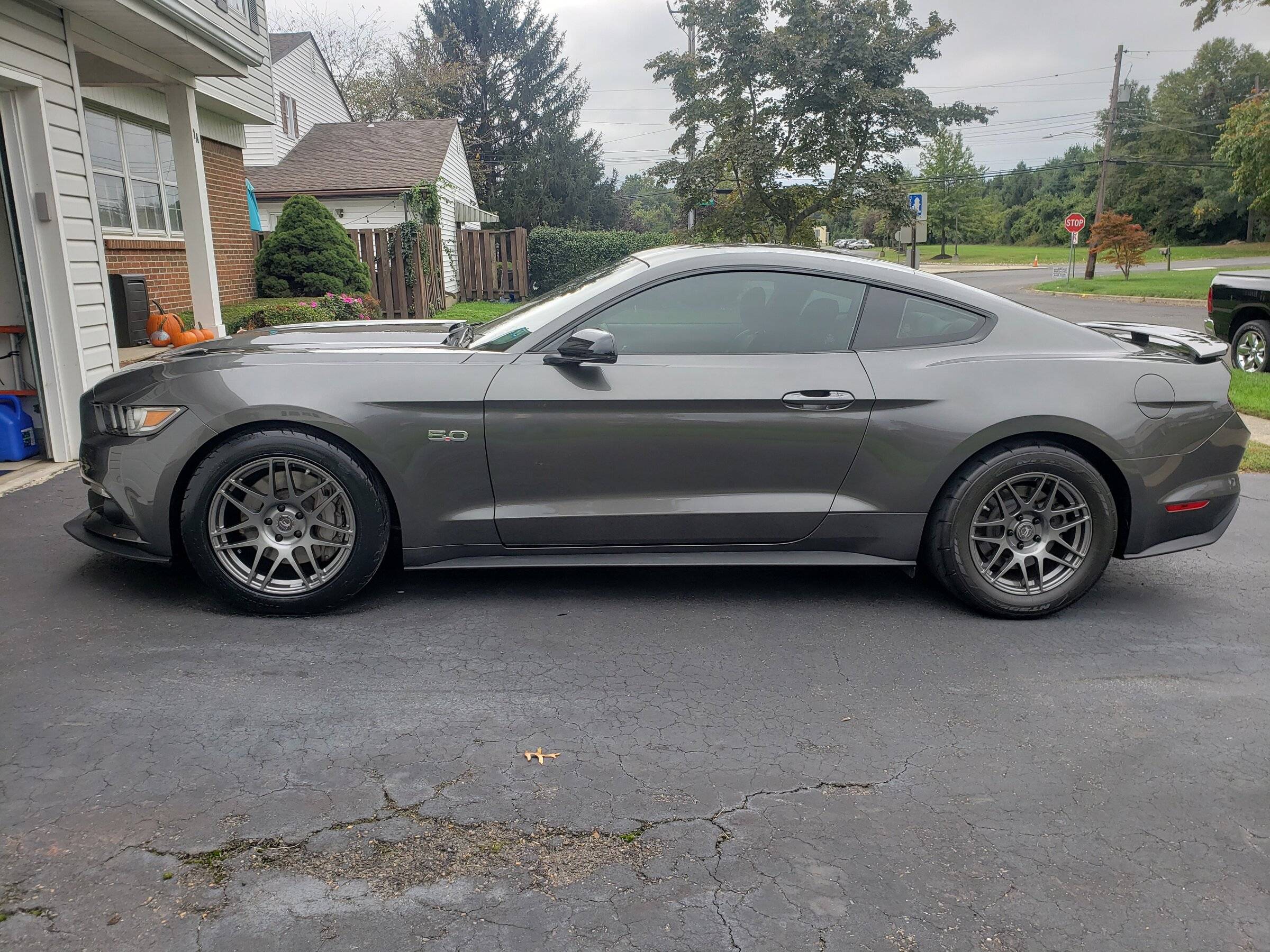

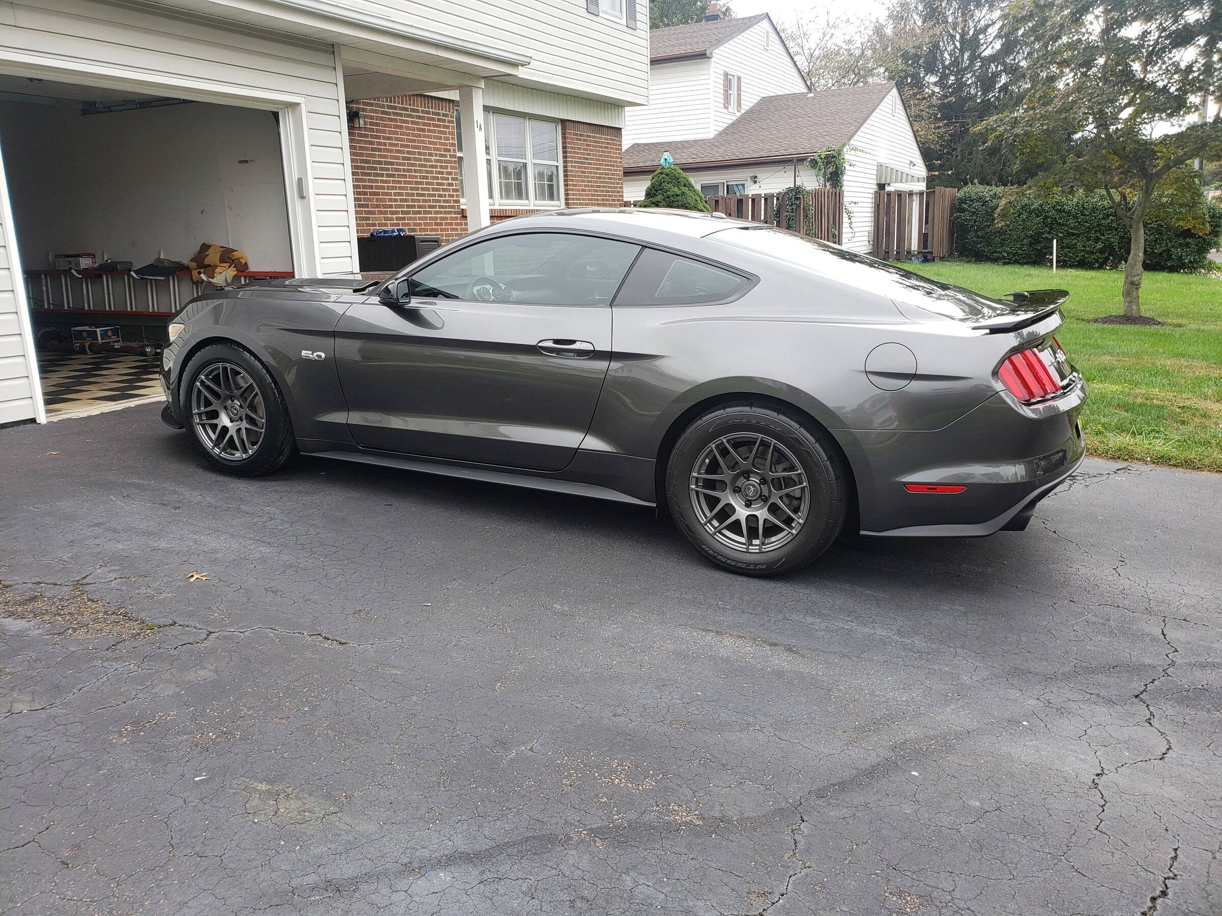

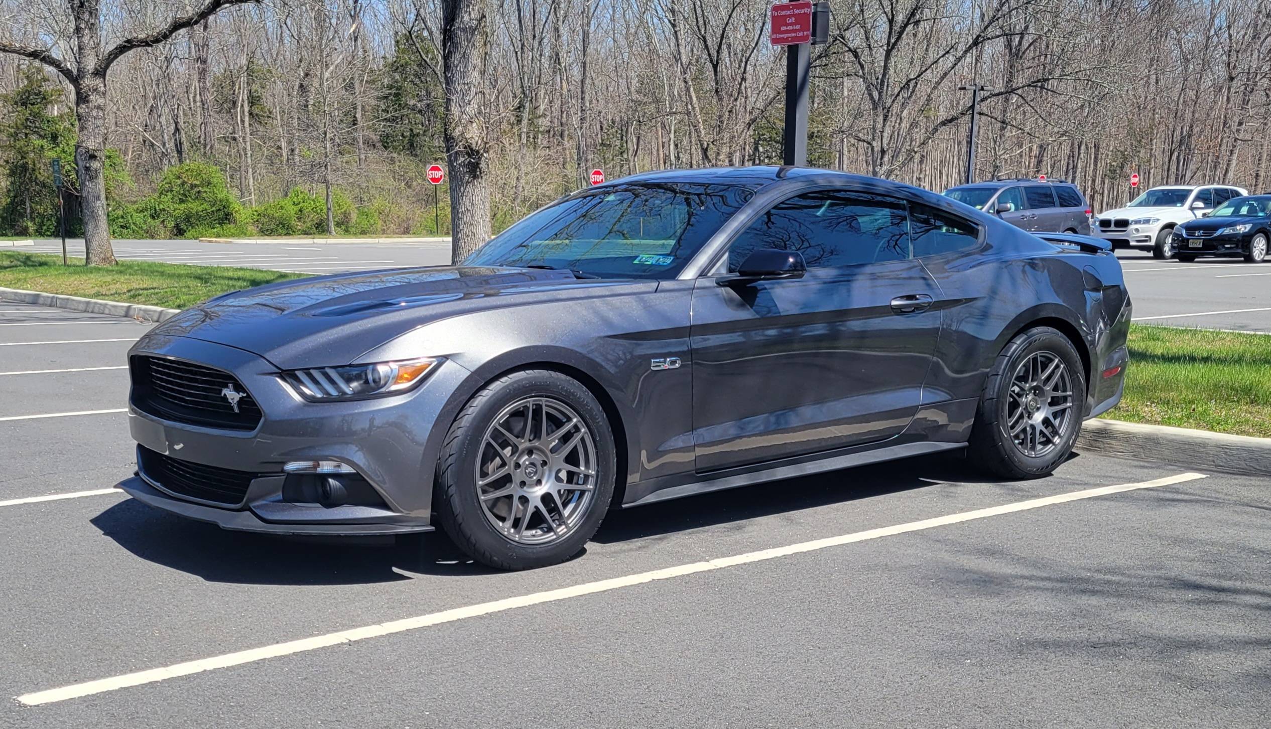

wazslow
Oct 10, 2014
633
548
PA
2016 Mustang GT/CS
Forgestar F14's - 18x5 with 28x6x18 MT Sportsman SR's and 17x10 with 305x45x17 Nitto 555R2's. I know it sits a little high, but with the Hellion Street Sleeper setup I don't want to lower it.
