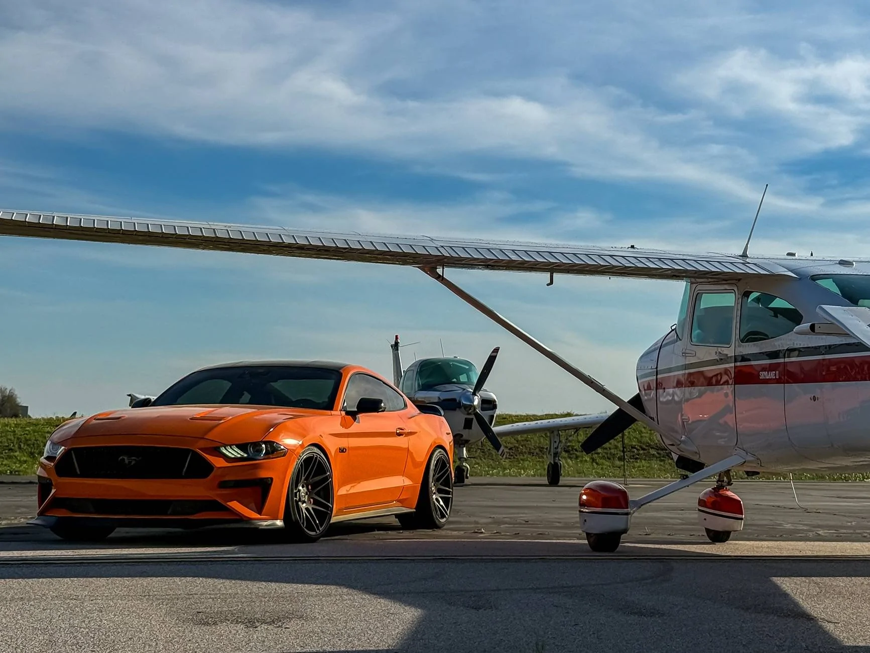

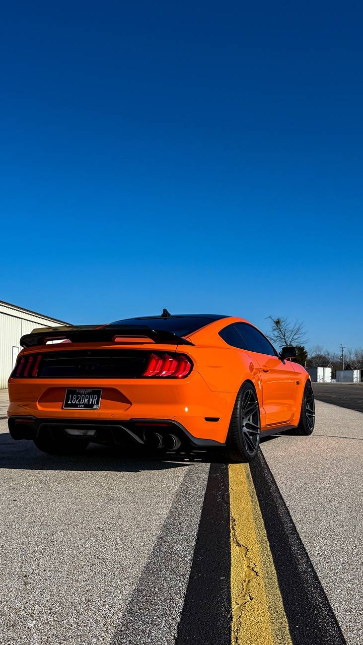

Camber was set at the maxed out OEM adjustment(to remove camber) and toe was set to zero based on my string alignment. Have not been to an alignment shop yet. Camber looks well under -2 degrees front/back and I was able to get away with not having to install the adjustable camber/toe arms I bought.
