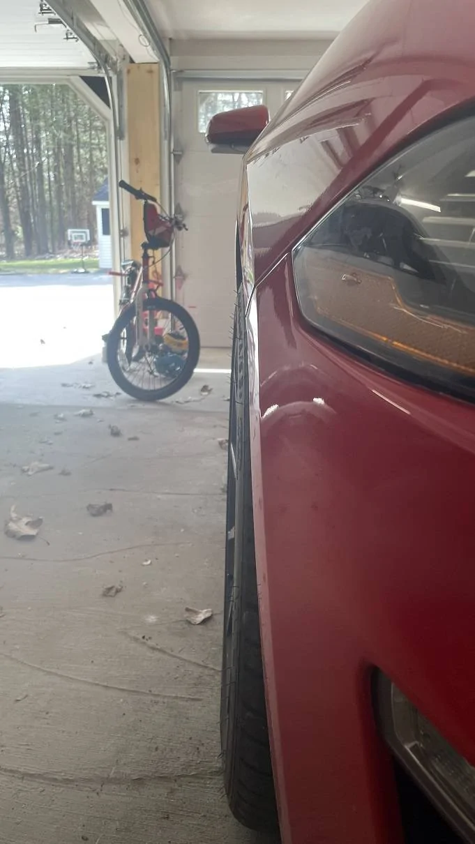

The stock wheels are really far in, there's alot of room up front. I have 19x10 +35 wheels with a 6mm spacer (so effectively +29) and it just barely sticks out of the fender if you look at it from the right angle. A 19x9.5 +22 is only 1mm further out than mine:

Not sure if it will clear the brembos. Worst case scenario you could run a spacer or just get the +22 offset option. I wouldn't necessarily say 9.5 +30 is "aggressive". 19x10 +35 is considered "flush" around here, if you go 9.5 +22 it will only stick out 7mm more then the 19x10 +35 which isn't a whole bunch.
