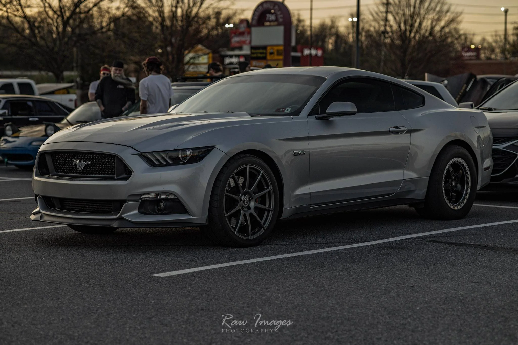

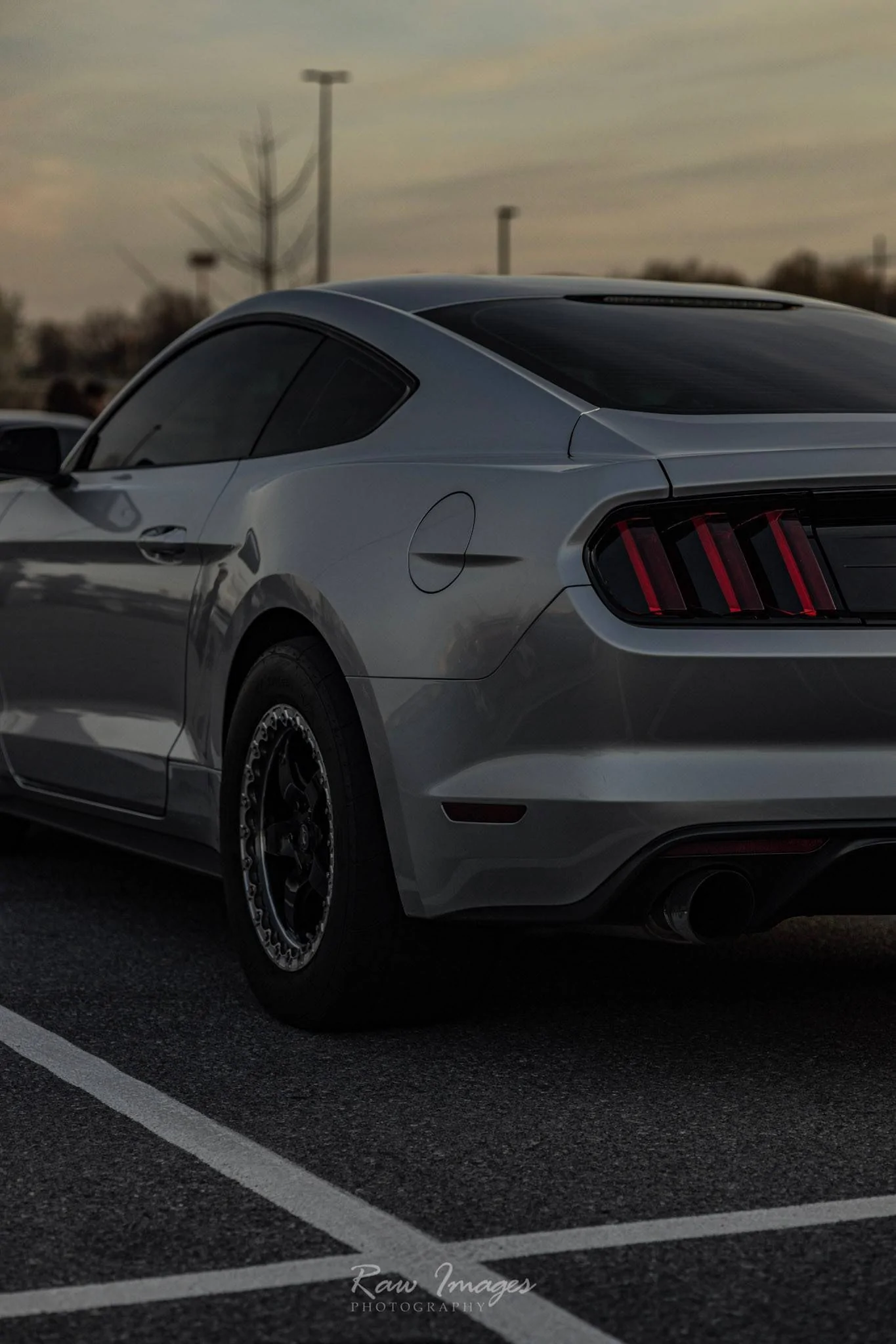

@CORNYOTE , one word. BEEFY!
What kind of 60ft with them tires?
1.3 on the track, but I usually drop to a 275 for track stuff so it will fit in a class. The bigger tire will probably only hurt the 60ft on a well prepped track. I run the bigger tires on the street and can usually manage a 1.6/1.7 or so without getting serious about prep

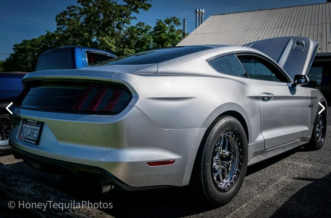

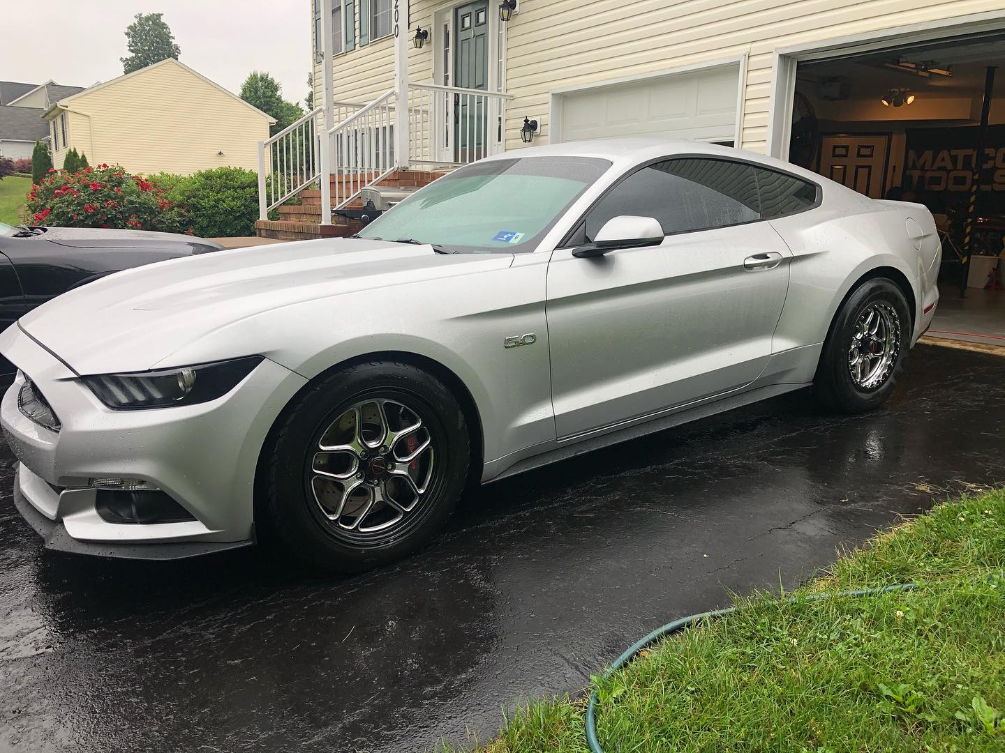

Old race star recluse set up. 18x5 front and 17x10 rear with a 28x10 hoosier. Stock spring height.
Forgestar rear single bead lock. 17x11 with Mickey thompson et street ss. Stock height.
Last years set up. Billet specialties Winlites 18x5 front MT 28x6 front 17x10 Hoosier DBR 28x10.5 Stock height. Ford performance Rear hub kit w/ ARP studs. Stock style cone front lugs.
Big suspension changes coming for 2022 and some hoosier C06 28x10 bias ply.

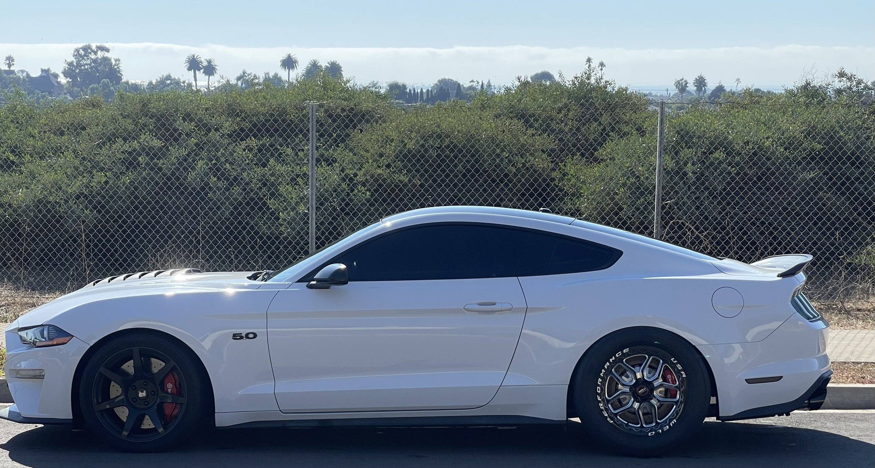

Question for you fellas.

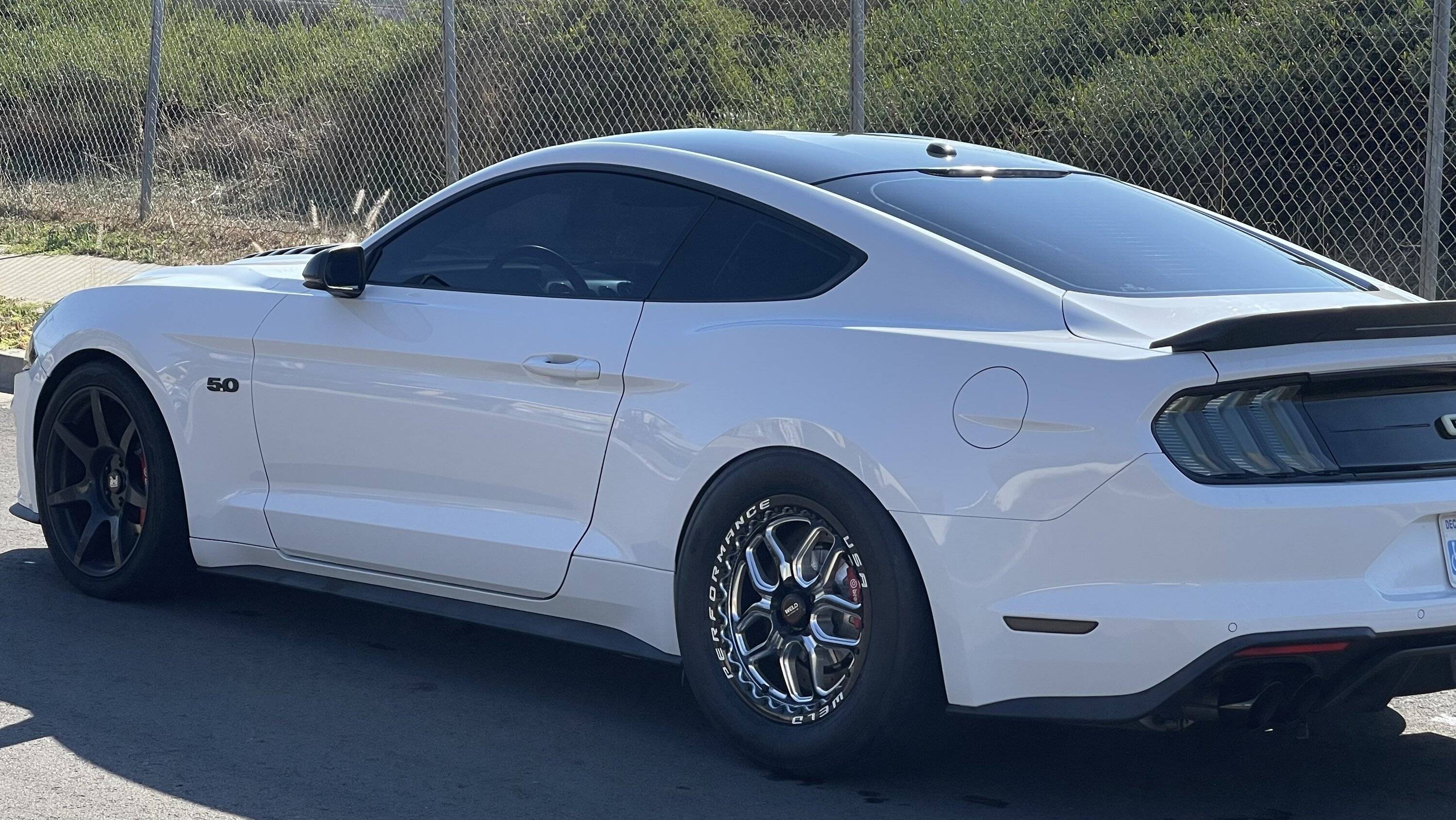

I just purchased some Weld beadlocks (18 inch Laguna). Now I’m in search of some Mickey Thompsons. Which series tire? Car makes decent rwhp. Will be roll racing with the tires.
Any suggestions
Thanks
Mghoward74
Nov 21, 2018
354
305
San Diego
Greg
S550
just some meats for the streets.

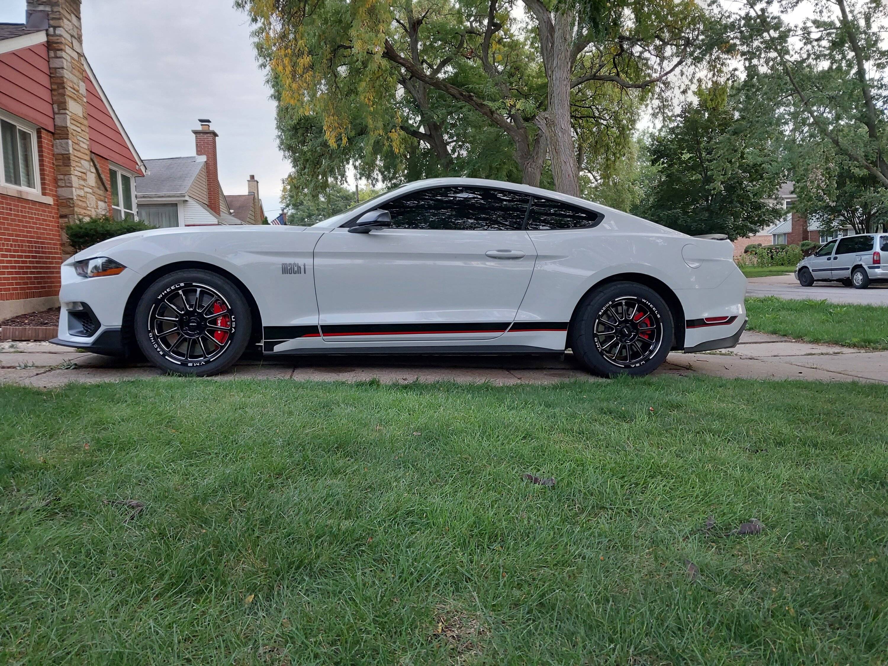

Juggernaut
Oct 12, 2023
92
121
Chicago
J
Mach 1, Expedition platty max, TBSS, Silvy, Camaro
2021 Mach 1 non hp a10
vms blackhawk drag pack
Rear 17x10
Mt 275/40-17
Front 18x5
MH racemaster 185/55-18

Nice look! 10R80 or manual tranny? Either way, please let us know how well it performs once you take it down the strip.
Juggernaut
Oct 12, 2023
92
121
Chicago
J
A10, edited original post.
Thank you, my 2 boys picked them out and they did a great job.
I did some datalogs Sunday and it's moving 52.7 lbs across maf. It's stock besides wheels/tires hoping for some low to -da and an 11.
That should be an easily attainable ET for you. Have you ran it prior to the drag pack?
