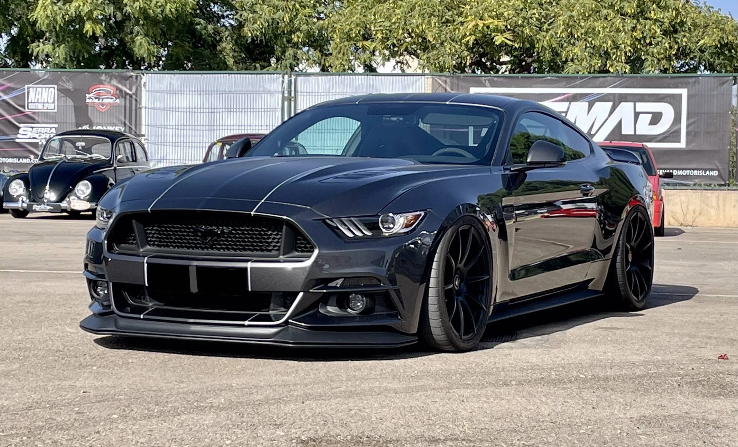

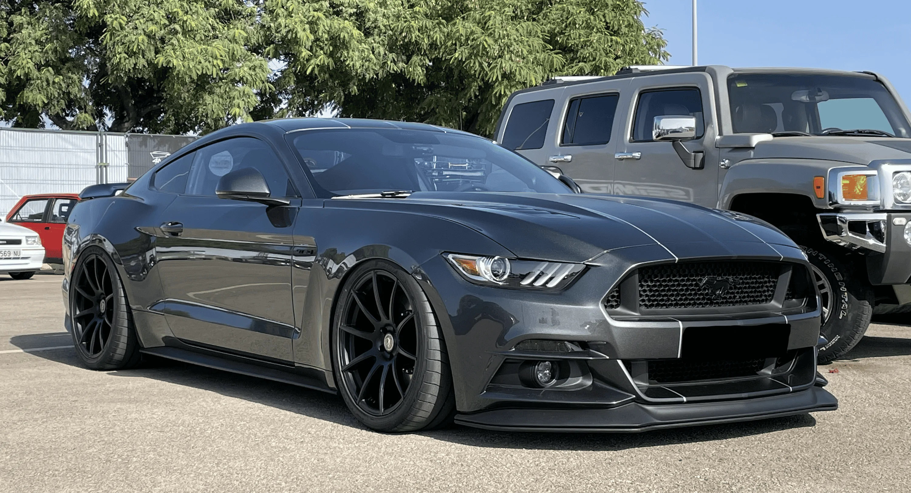

Same wheel as before but now on airlift performance.
Forgestar CF10 20x11 +30 and +45
305 / 30 R20 all round.
