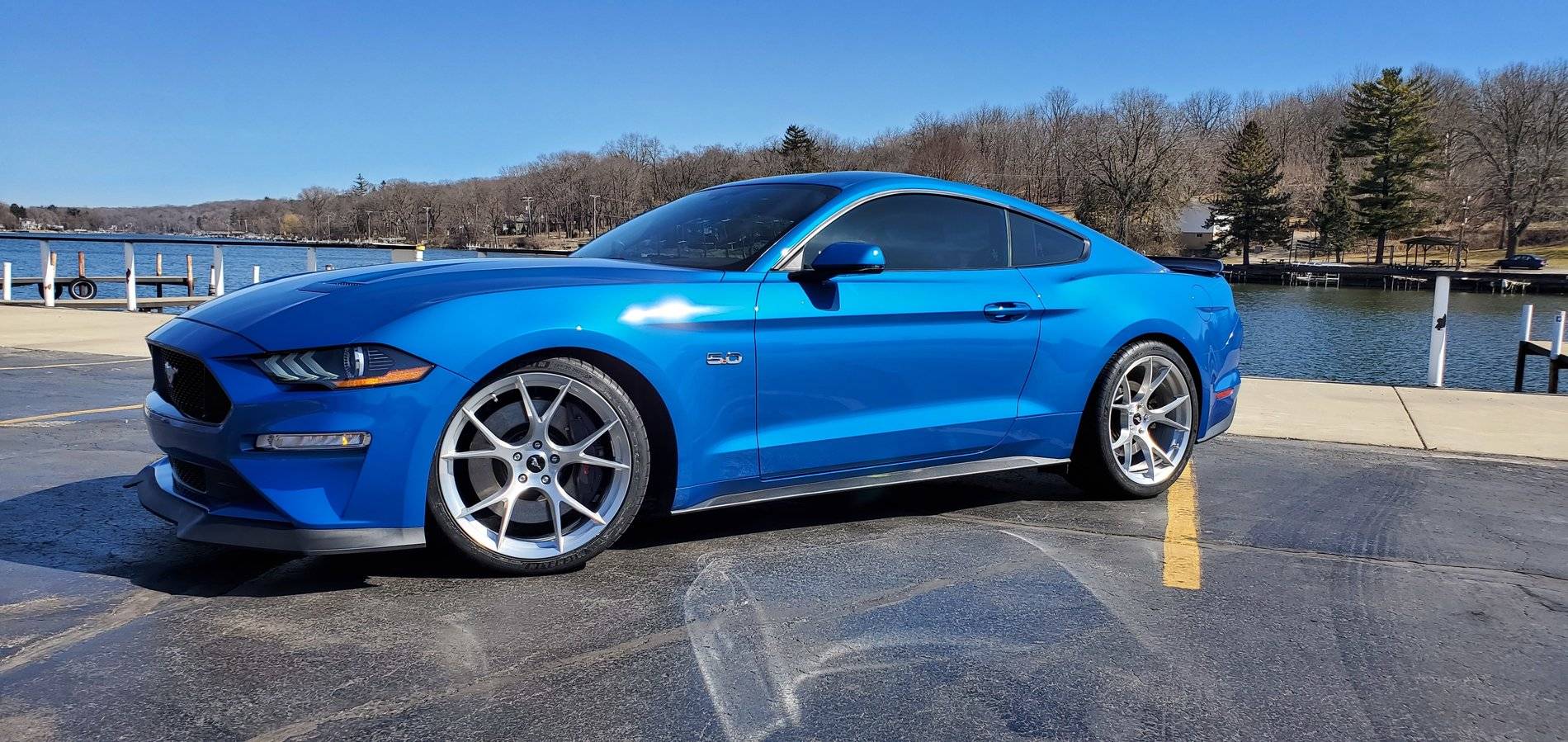

Ok. My turn. Shelby CS-3 wheels on a 2019 GT.
Front 20x9.5 +40 275/35/20 Conti ECS
Rear 20x11 +50 315/35/20 Conti ECS
Any concerns? Would a 325 work in back?
Thanks in advance!
