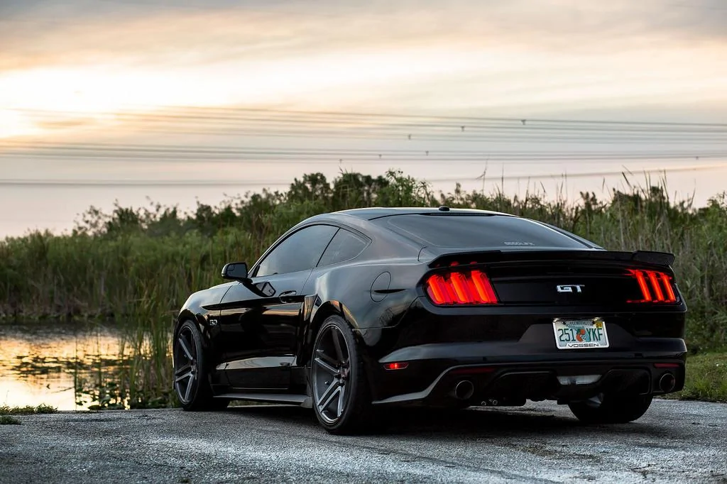

    Vossen VPS302

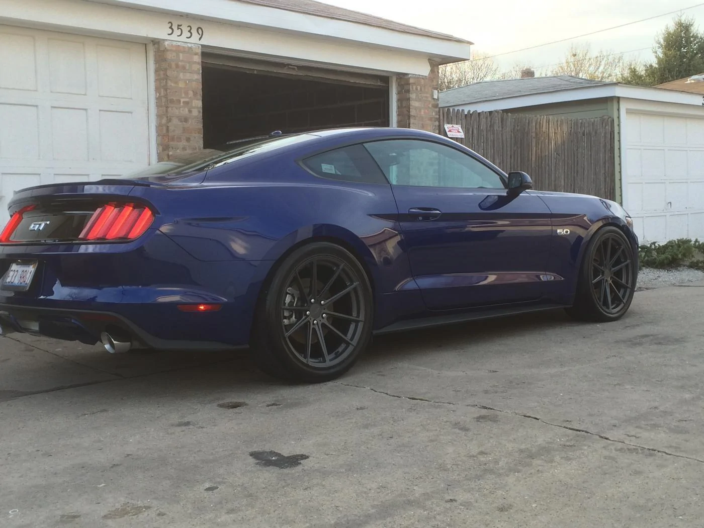

    295/35 20x10+40 and 275/35 20x9+20 TSW Bathurst IMG_0483.jpg IMG_0480.jpg

    You definitely need higher than a 28 offset for an 11. The black GT above is Brian at Vossen and that's 20x11 ET50-something..

    what are the wheels in the very first picture?

    Vossen VPS302. Their fully forged wheels.

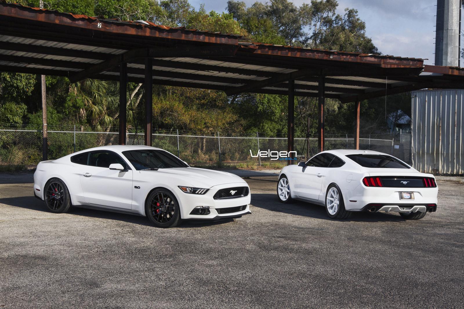

    The white eco boost is on Velgen VMB8s. The front is 20x9 +35 with a 285/35/20 tire and the rear is 20x10.5 +45 with 305/35/20 tire.
    The white 5.0 is on Velgen VMB7s. The front is 20x9 +32 with a 285/35/20 tire and the rear is 20x10.5 +45 with a 305/35/20 tire

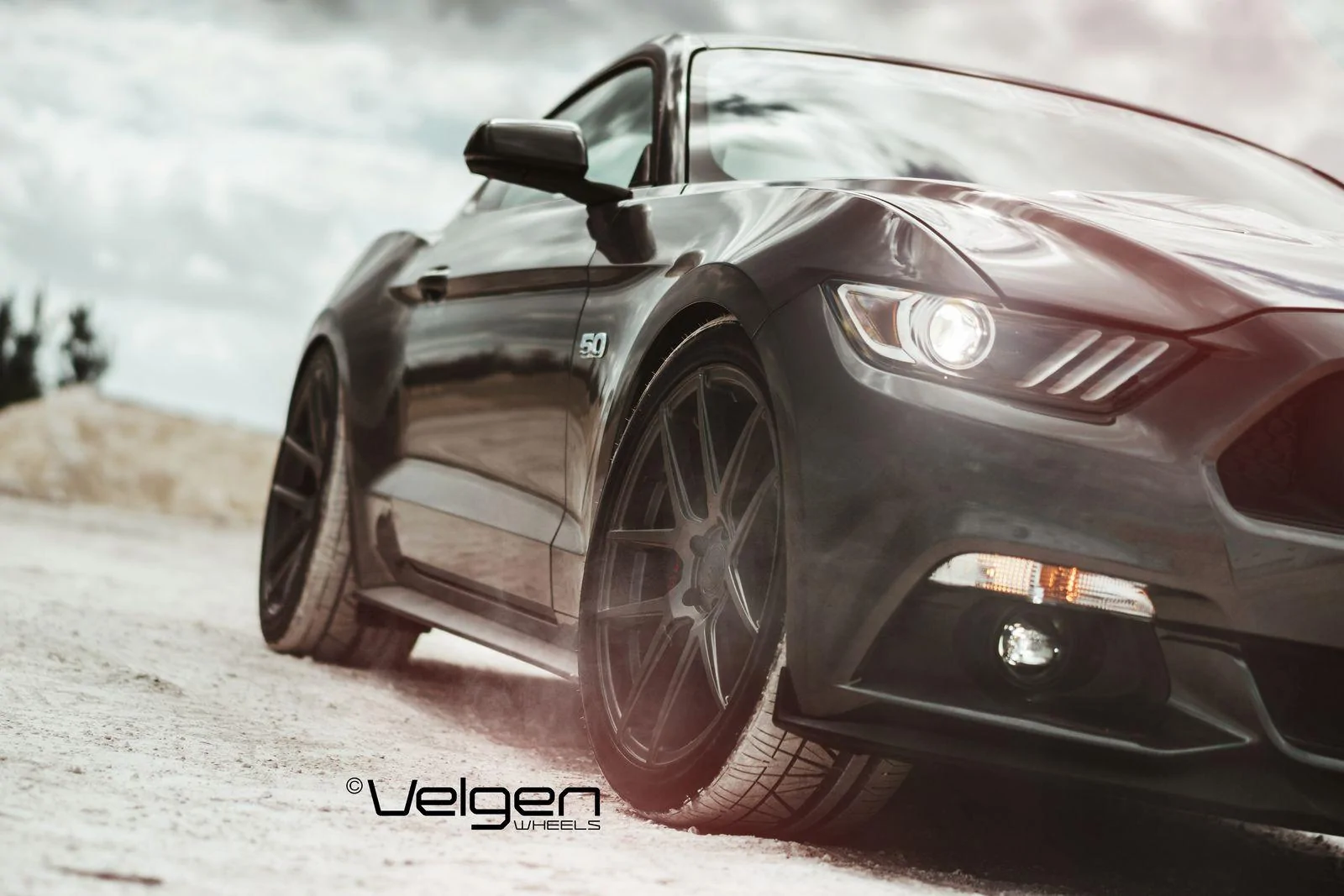

    These are Velgen VMB5s matte gunmetal lowered on eibach sportlines.
    Front: 20x9 +35 275/35/20
    Rear: 20x10.5 +45 295/35/30
    TwinGT, Yawnn and 350Mike like this.

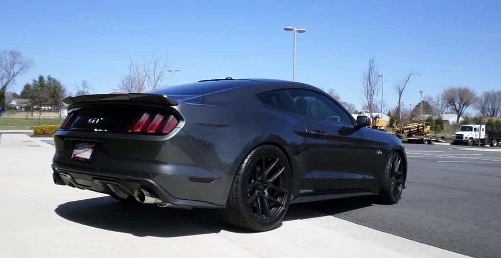

    Here is another S550 on Velgen Wheels VMB5s Satin Black. Same offset as the other mustang but lowered on eibach pro kit. Tire sizes are 275/35/20 and 305/35/20
    myblkshadow19, SpeedLu, Yawnn and 3 others like this.
