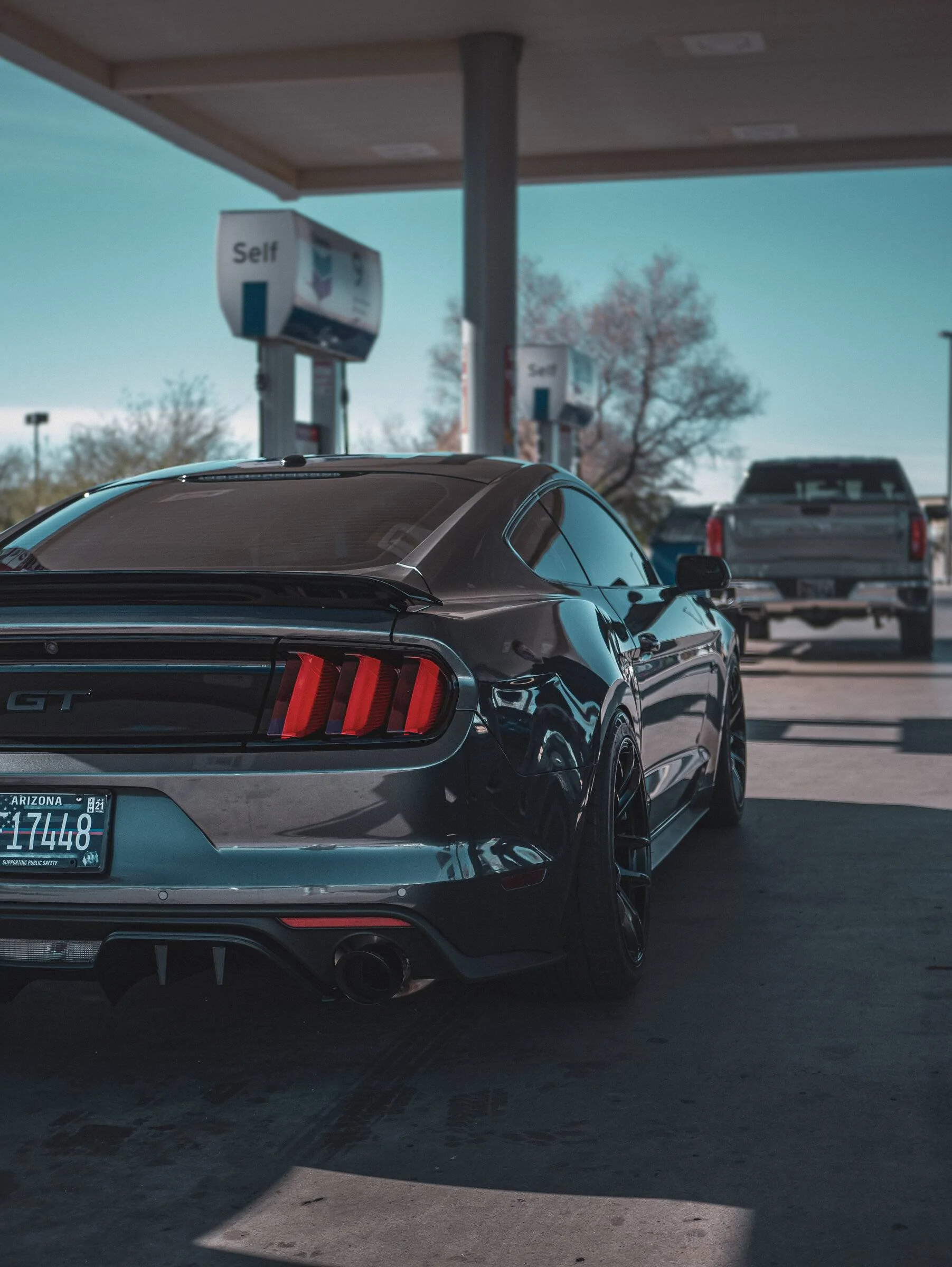

It will be a decent amount. Here's 19x10.5 +22 running 275/40 for reference.
Thanks for the visuals. What was your camber specs here?
Thats a good question. Never had it aligned when I had springs, so whatever the natural camber is with eibach sportlines
