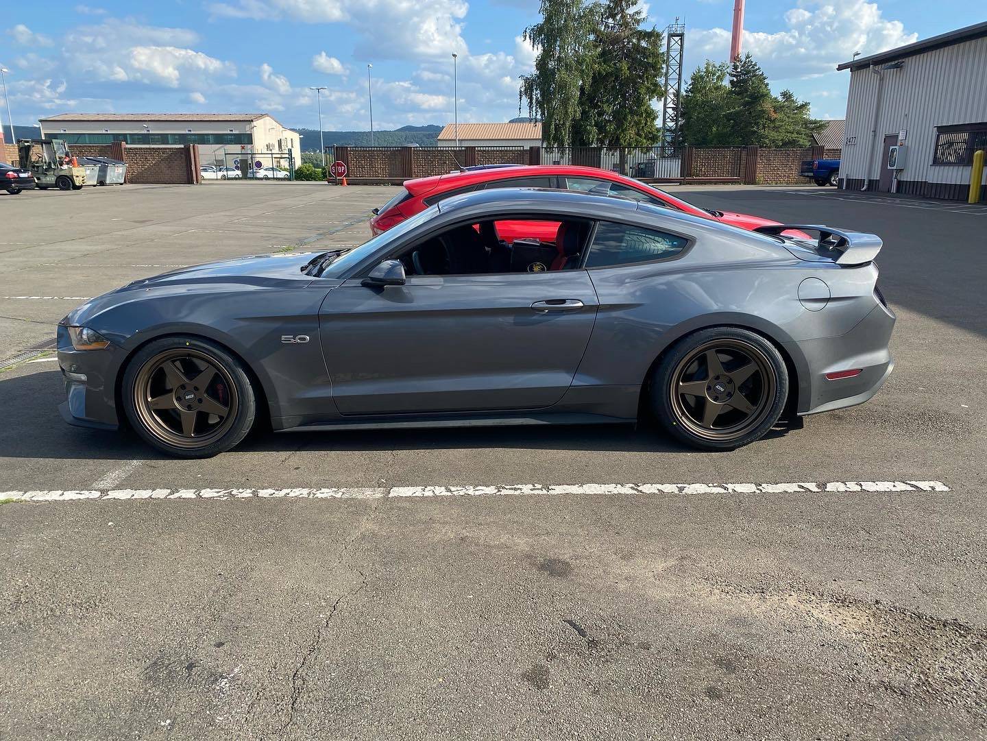

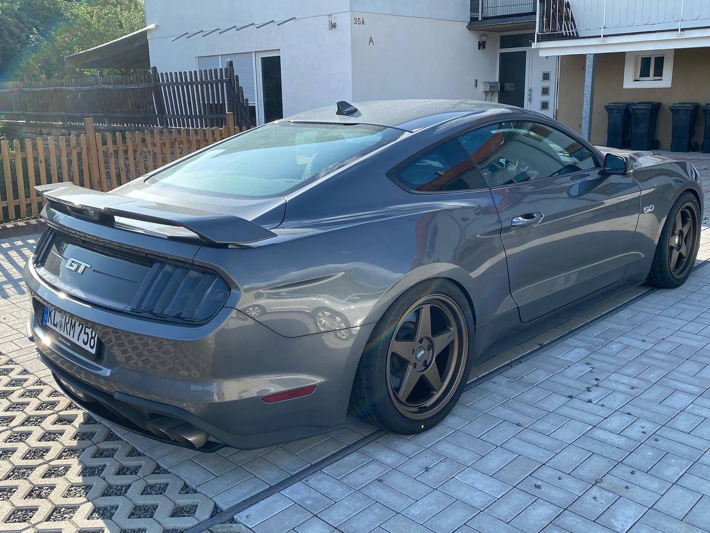

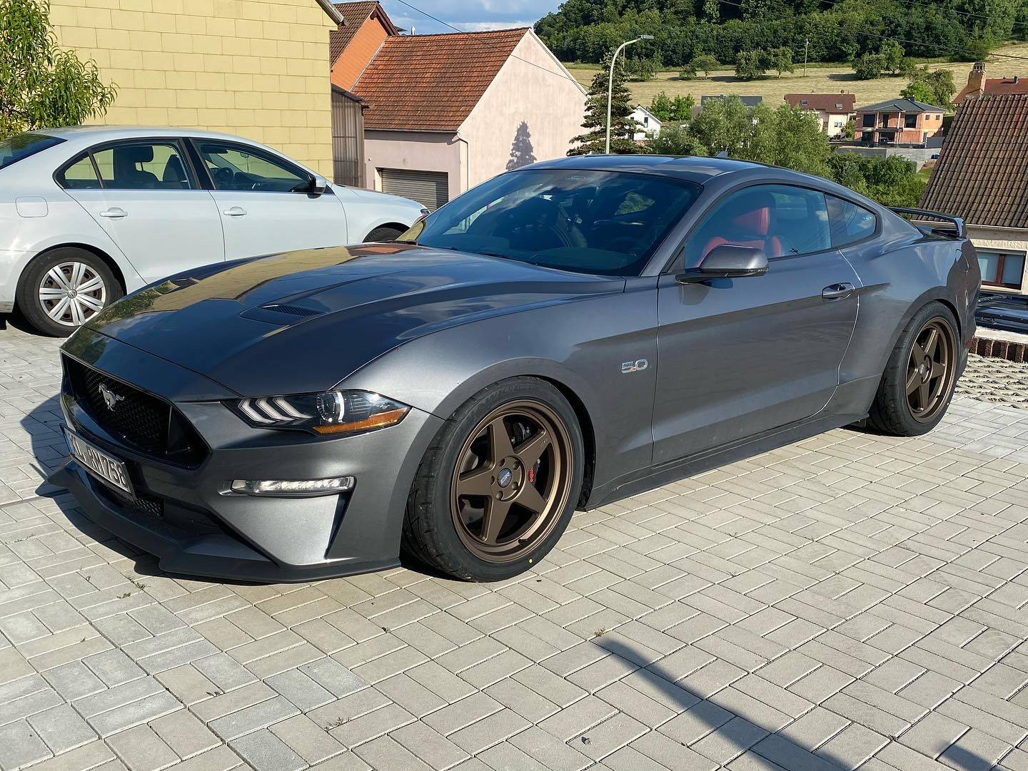

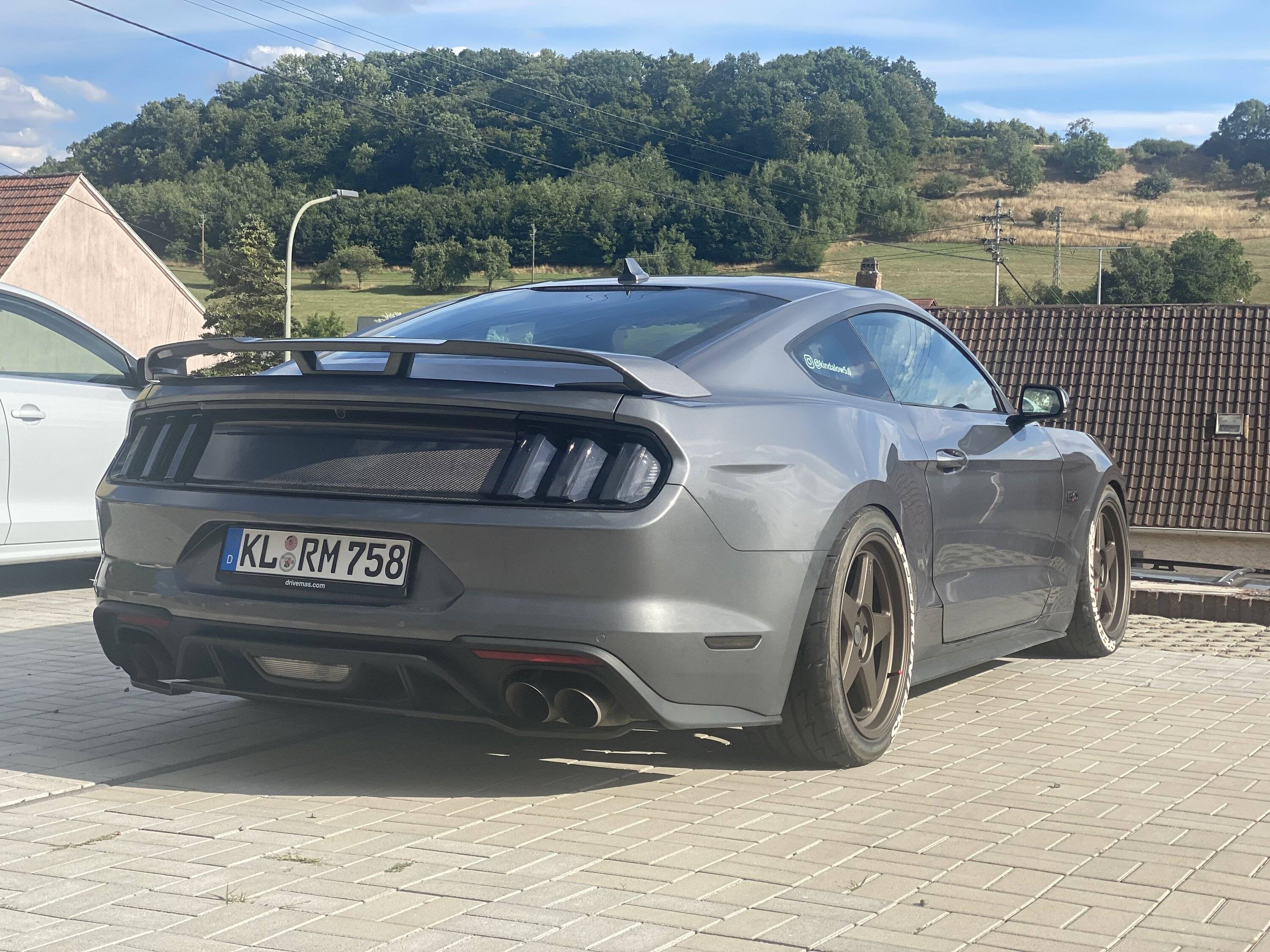

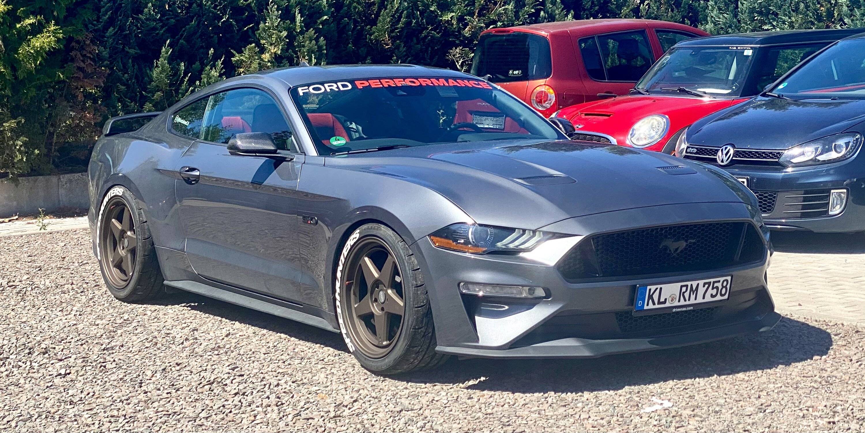

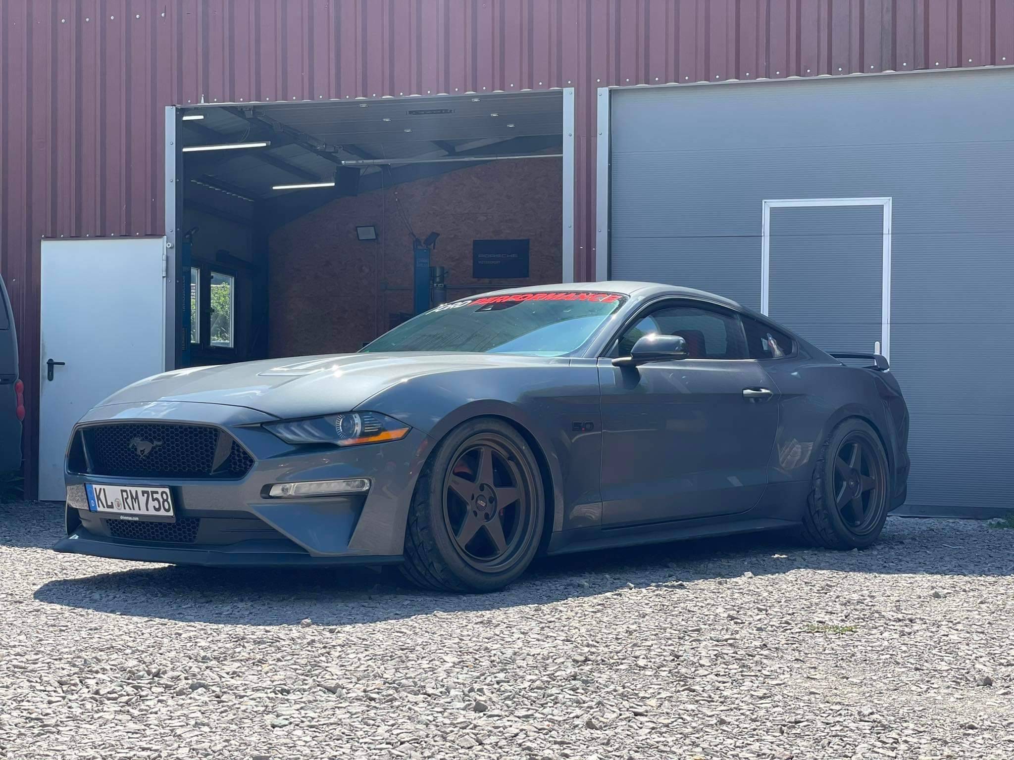

He's looking for 10.5 square with+35. I'm thinking those will need more camber up front.I run the same 285/35/20 on 20x10 +35 in the front on the FP springs no issue with clearance there. The rear has a bit more poke than some prefer running 315/35/20 on 20x11 but I think she sits nicely.

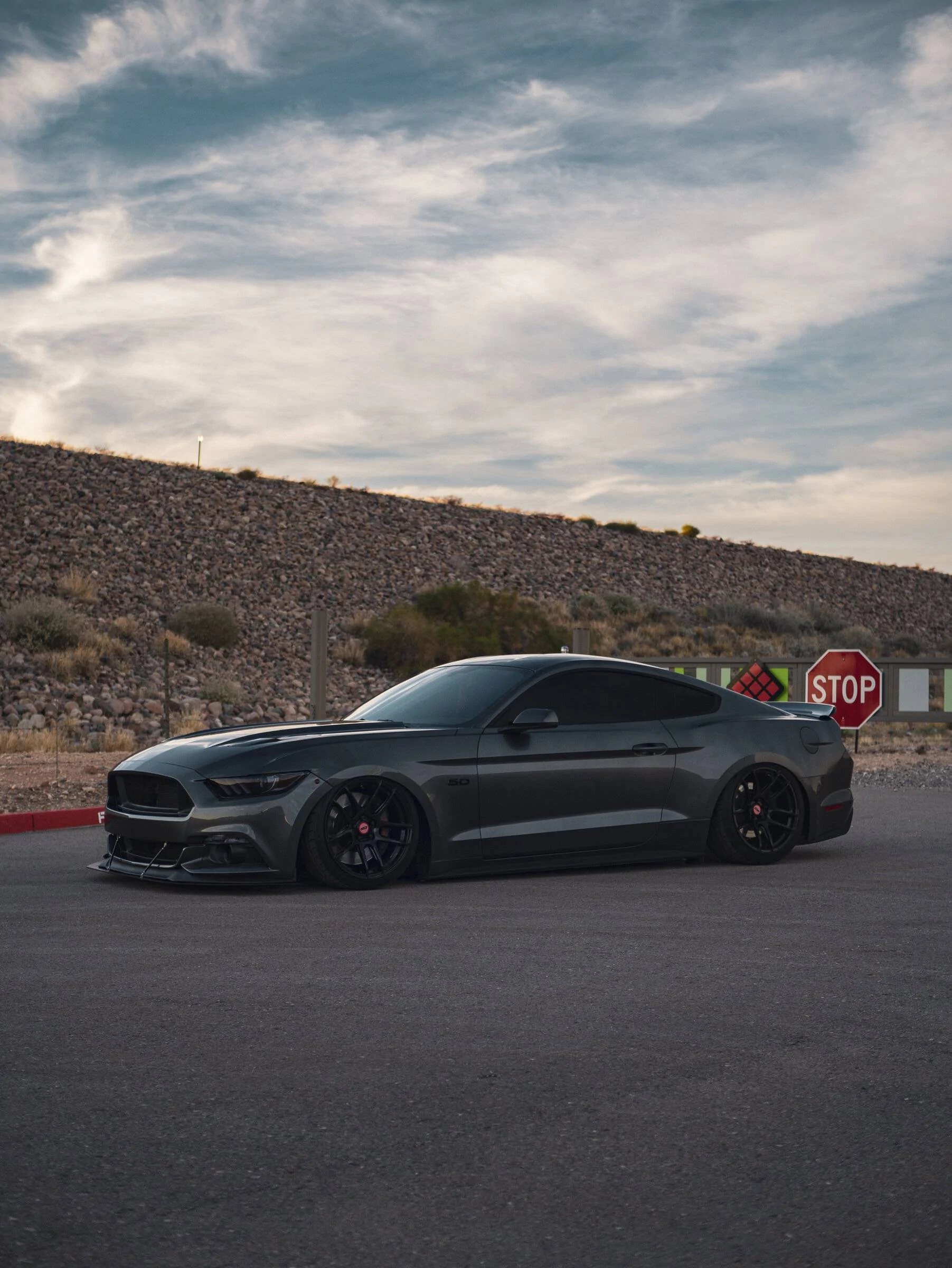

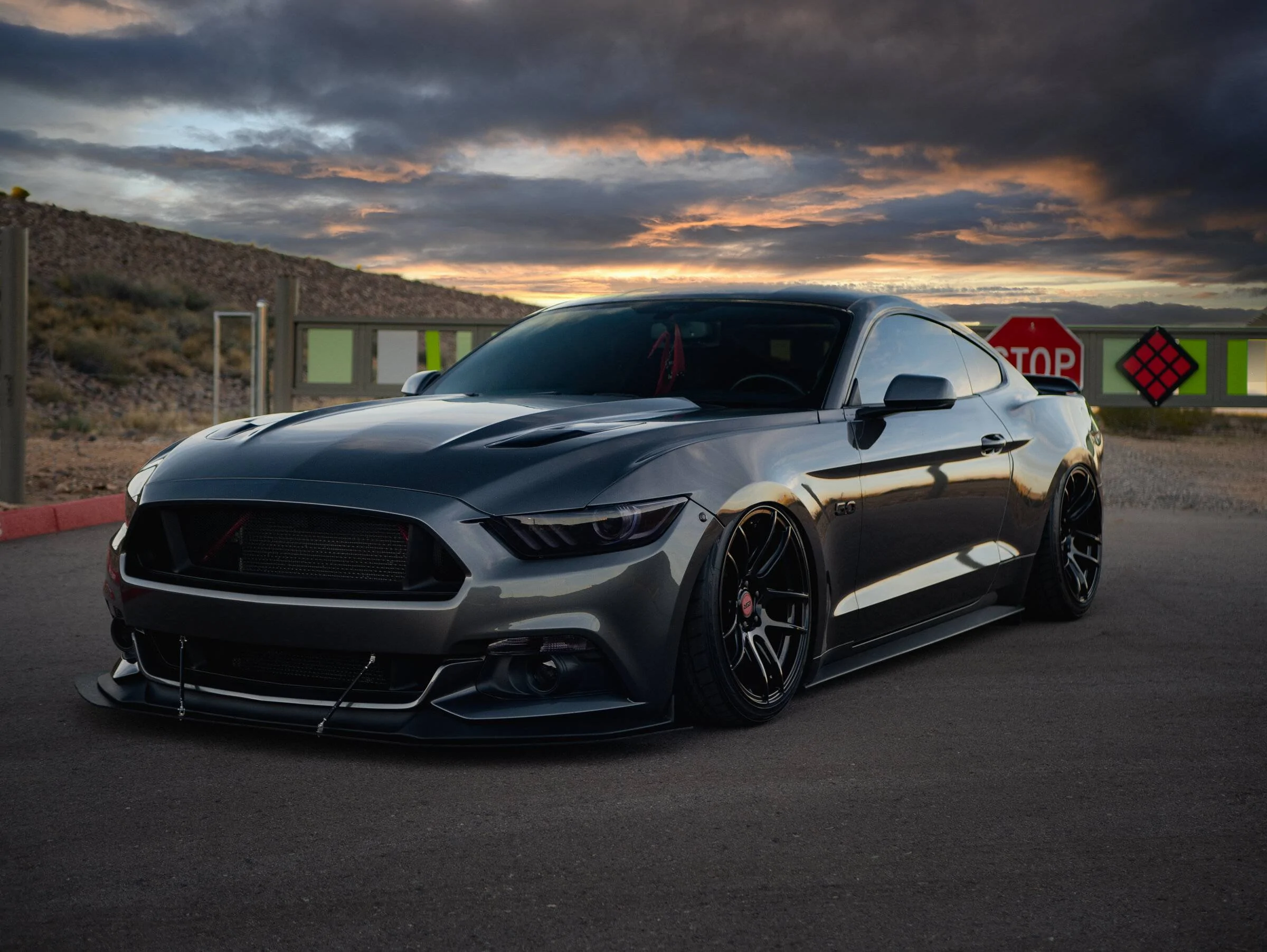

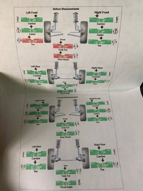

My car was slammed, I had to raise the suspension more than 2 inches upward to clear without a spacer. I have to check the amount of camber I'm running though.
I'm contemplating running the GT350 brake kit. It will move the rears out ward but I have adjustable billet camber arms on the rear so I should be fine.
