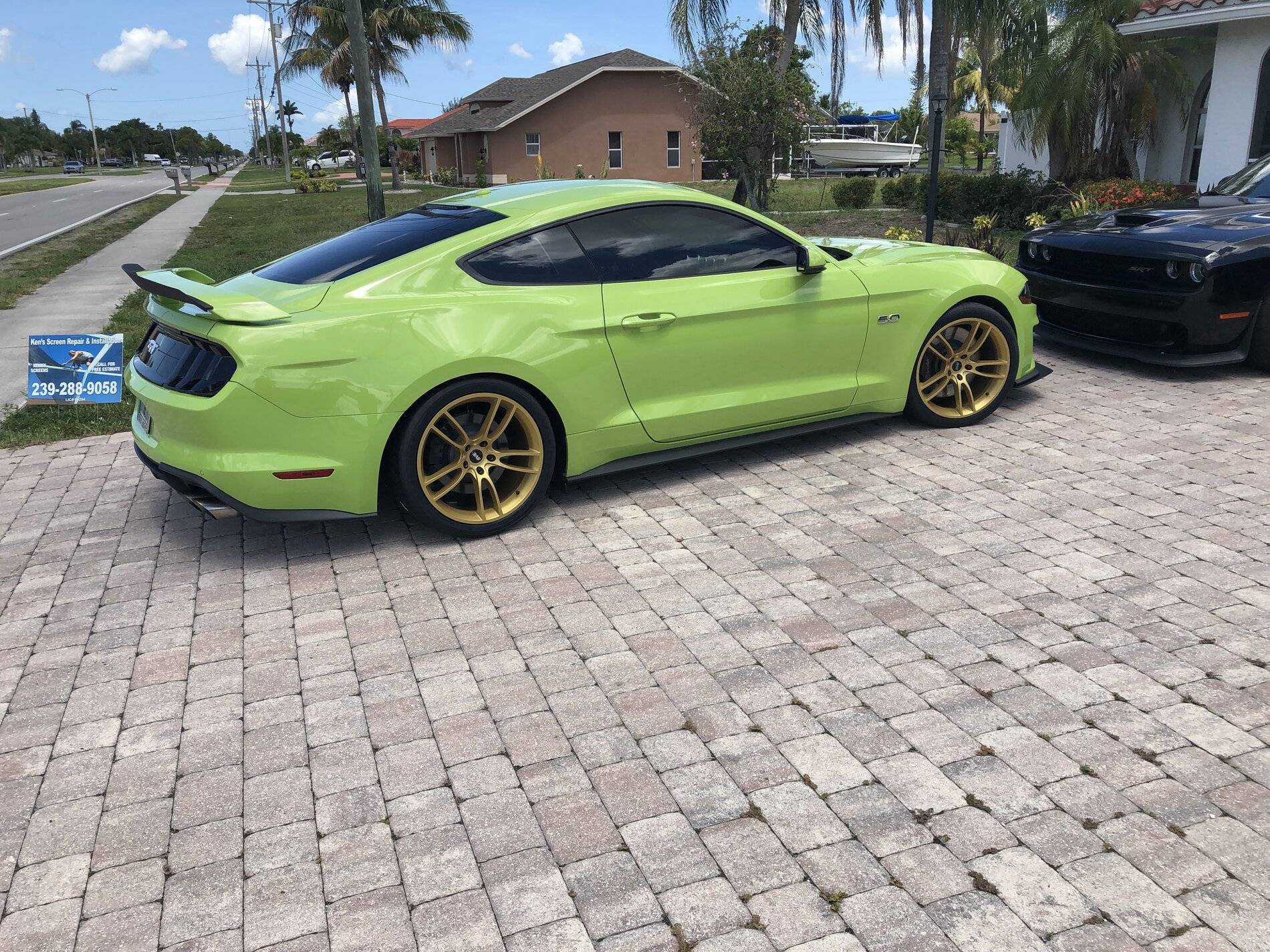

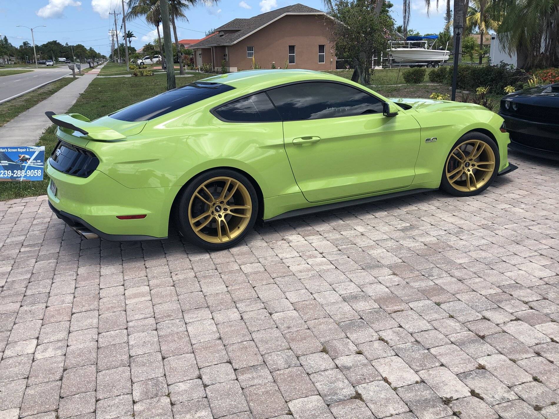

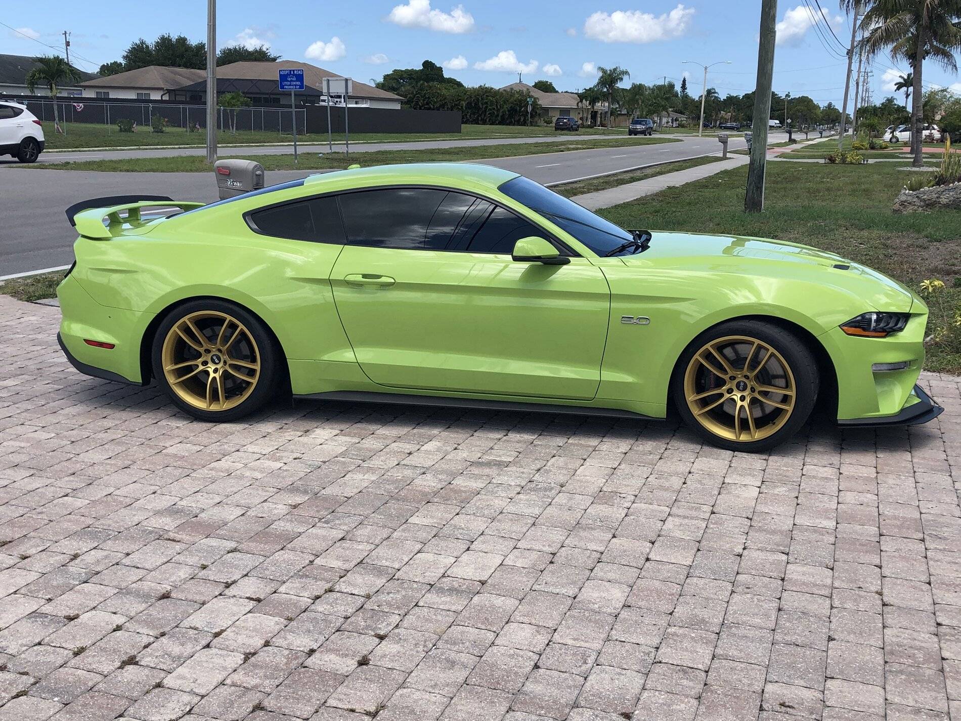

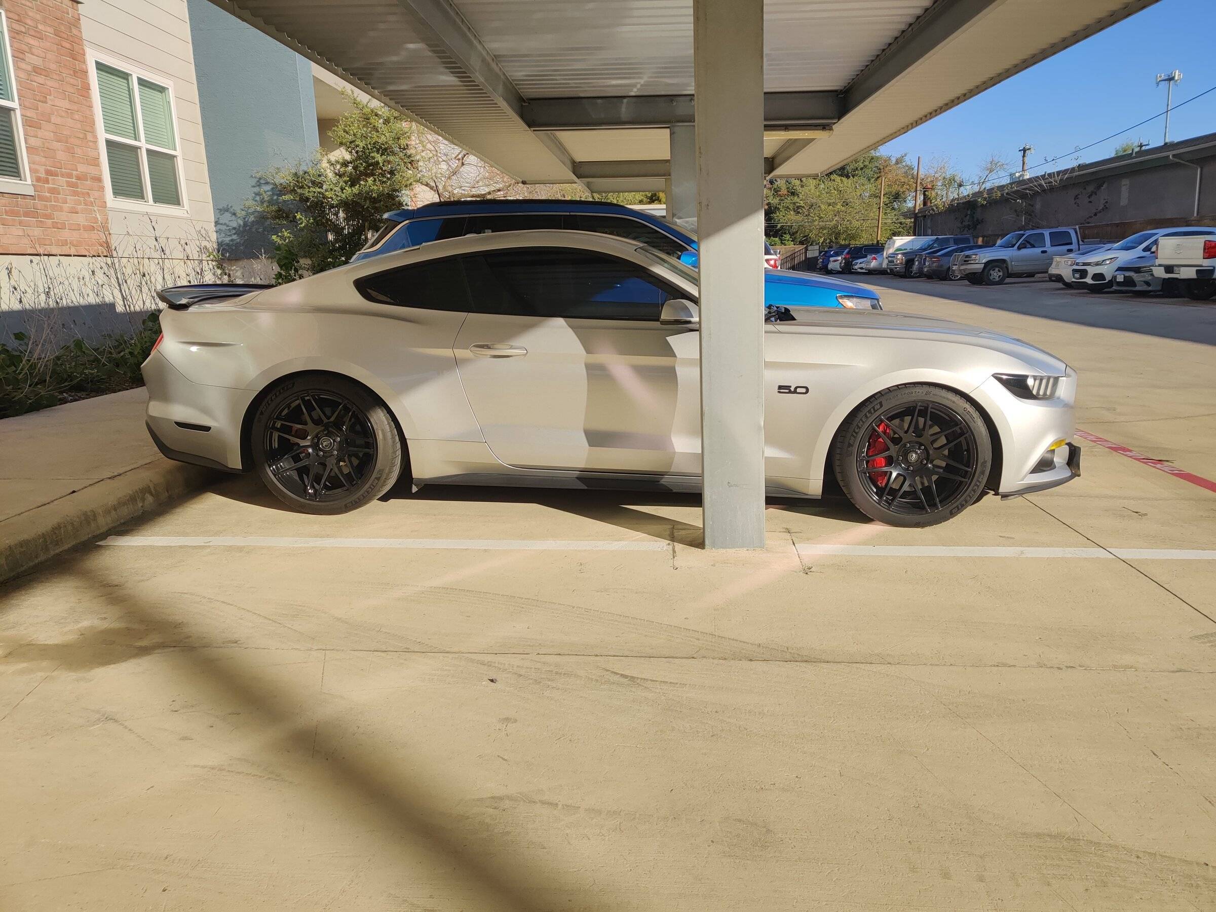

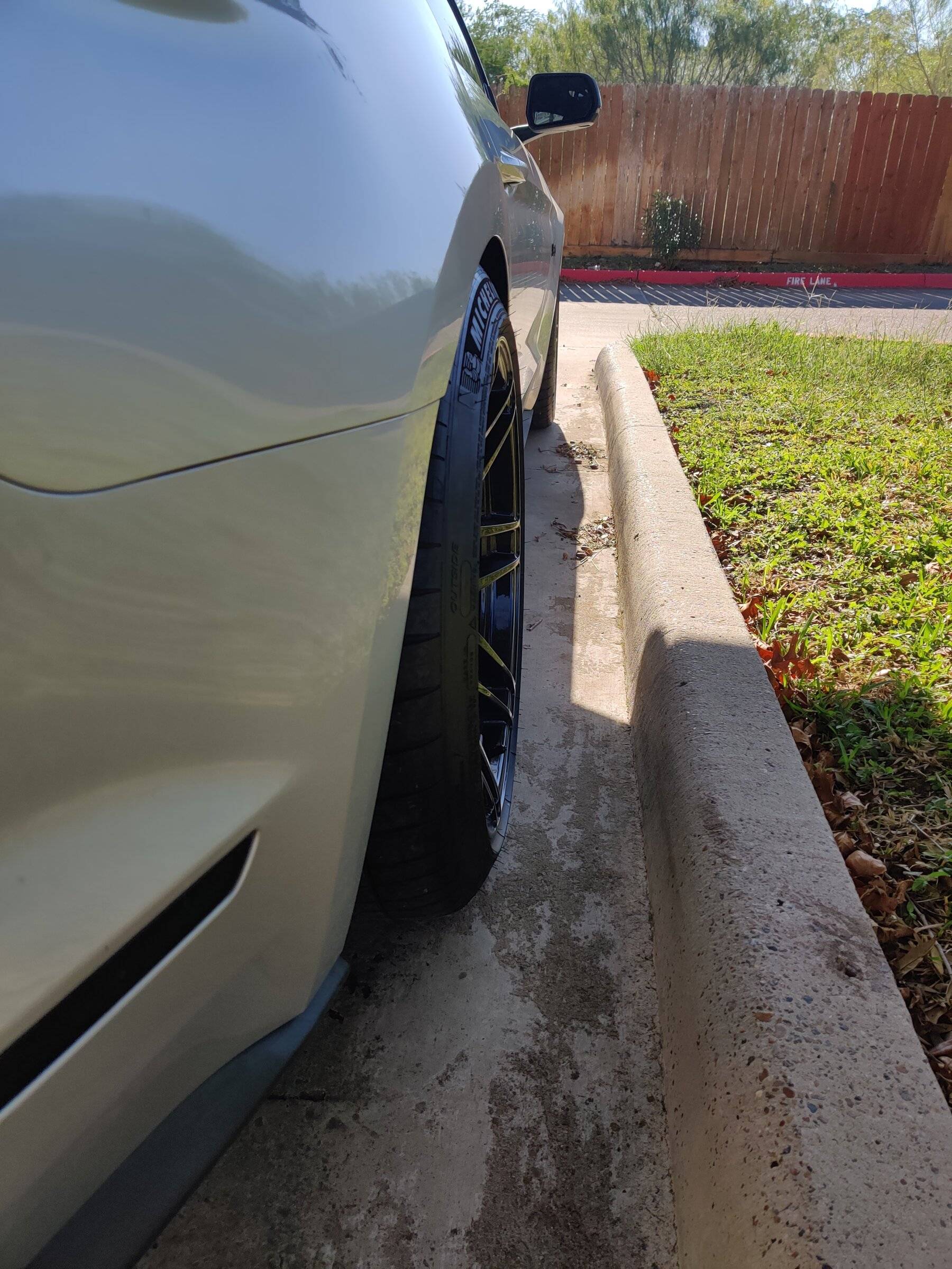

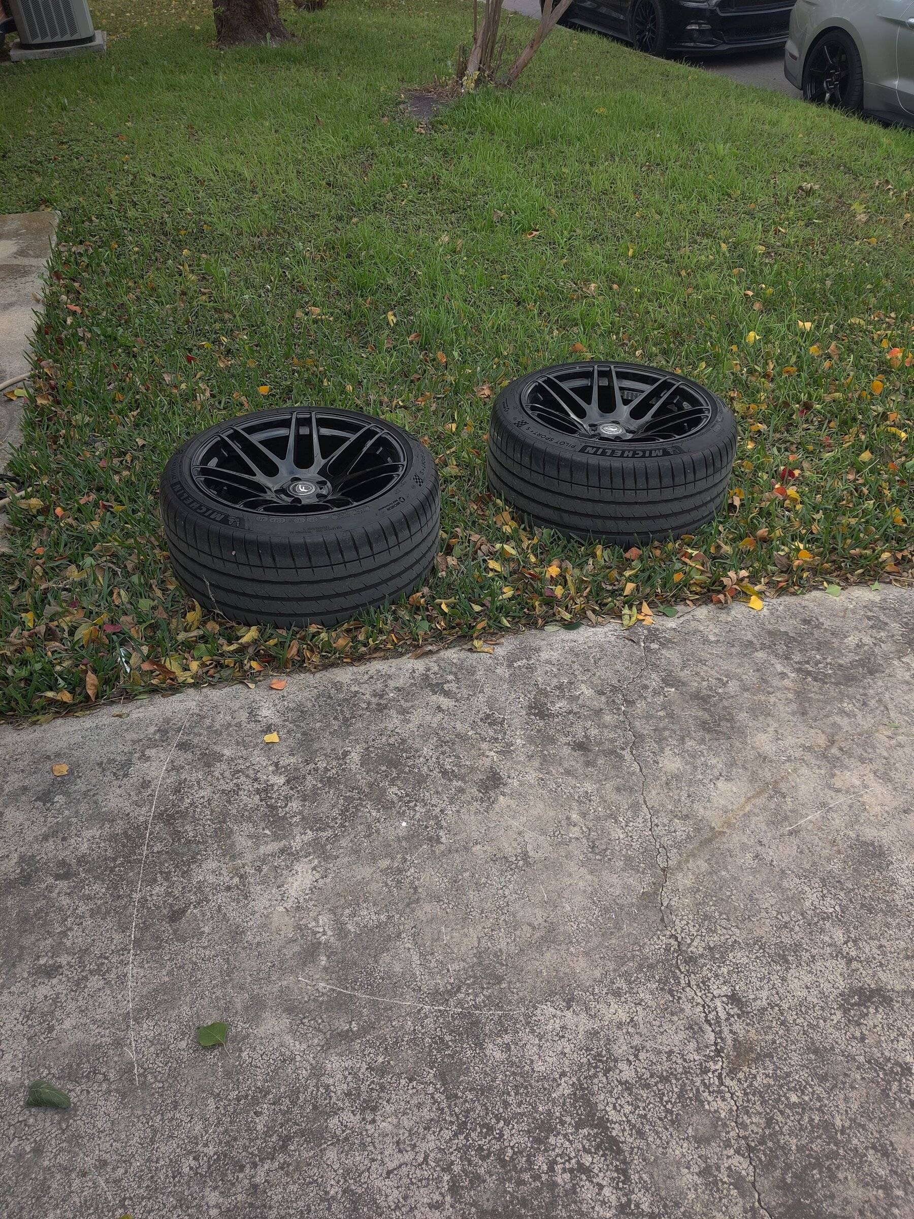

Hey guys! I finally was able to get a setup together that I love on the car. I previously had 20 inch 6GR wheels on it but wanted 19s and something more aggressive. I was able to source the front wheels and tires from a member on here who was selling his. Then I went to Paul and Akio @ PKAutoDesign who hooked me up with a set of F14s in 19" and Super Deep Concave fitment for the rears. They let me know the rear was going to be aggressive and I'd likely need camber to tuck them. I've not done the alignment yet since I just got lowering springs put on but I like the look overall so still contemplating if to camber or not. I added a pic of the rear wheels alone to show how concave they are. They're deceptive in pics depending on angle but they're great!
The specs are:
19x9 (unknown offset) 285/35/19
19x11 +37 295/35/19

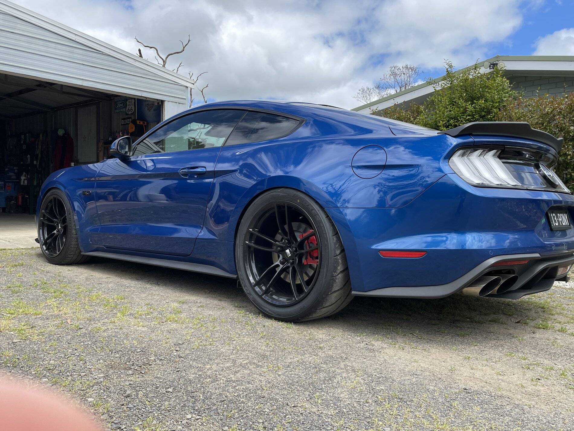

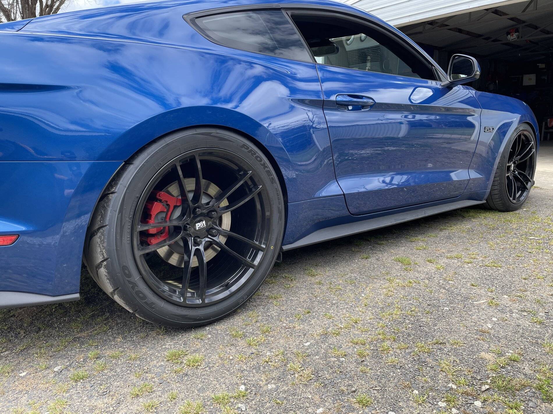

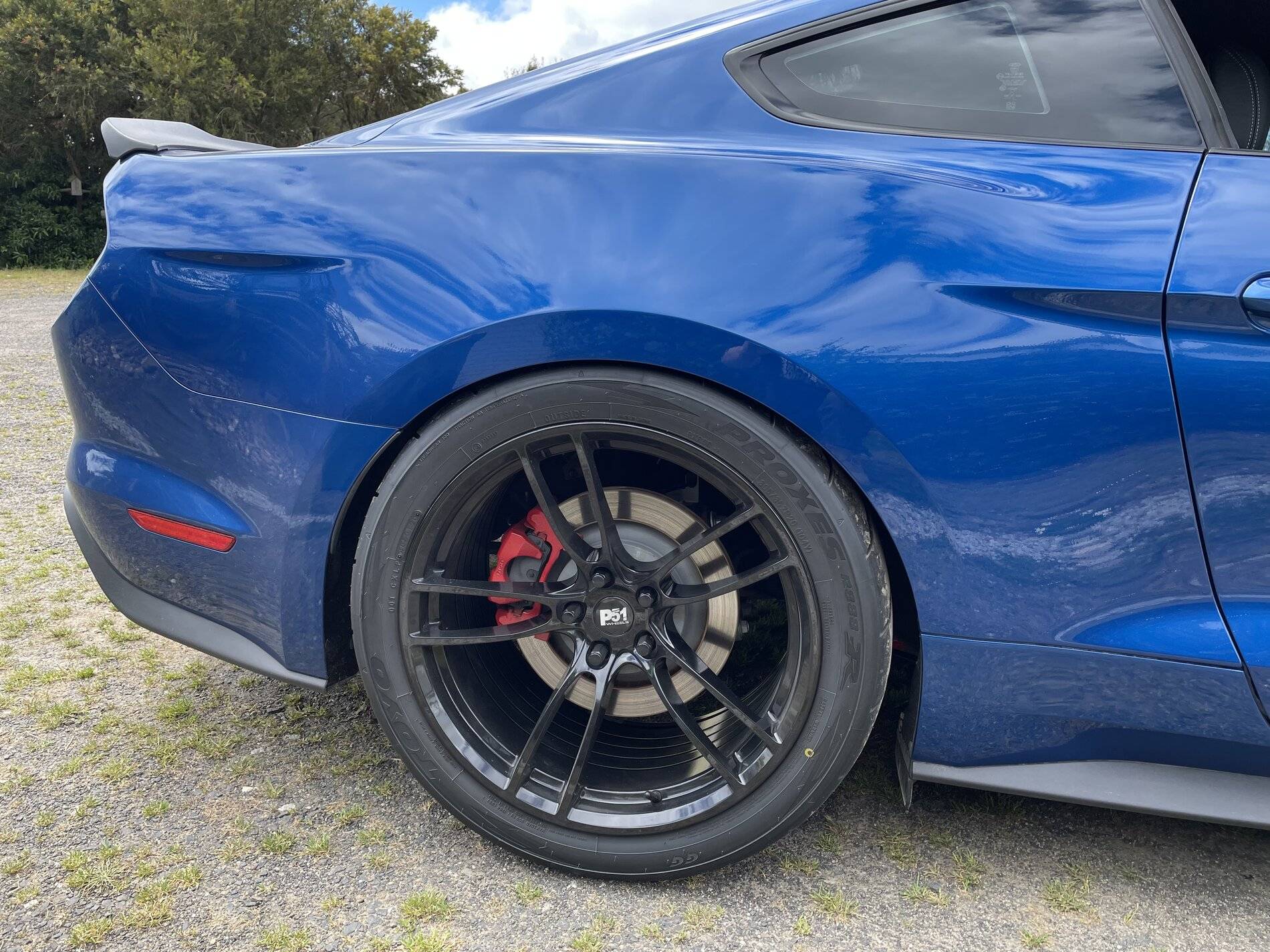

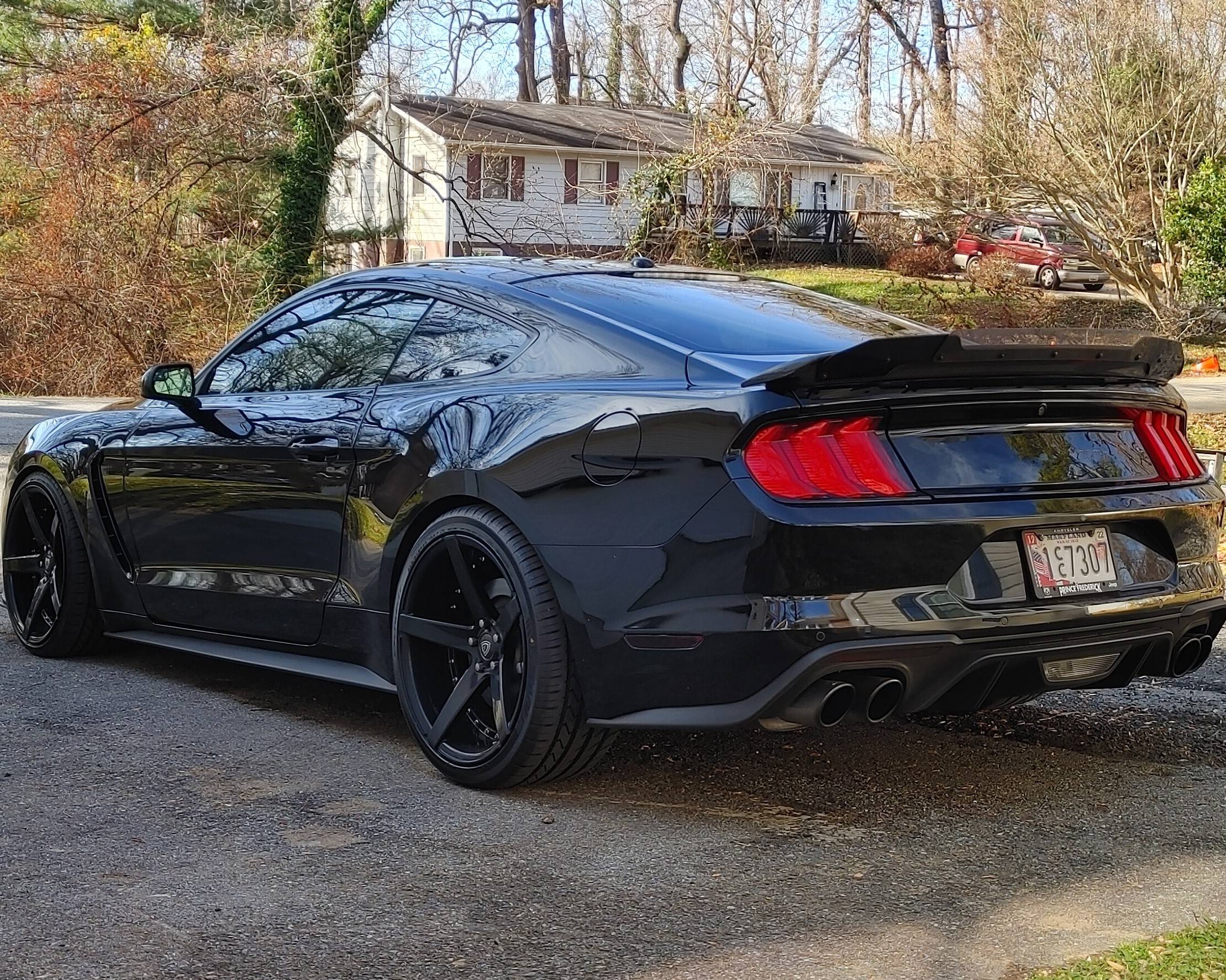

Had the 19x11 square set up installed today and took off the 20’s square set up that I had on the car in Matt black. The 20’s ran Dunlop’s 305/30/20 rear and 285/30/20 fronts. The 19’s are running 305/30ZR19 Goodyear Eagle F1 Supercar 3R all around. Springs are H&R’s super sports if I remember correctly. These are some quick shots I took when I got home will try to get some better ones later in the next day or so.
What offsests do you have for your 19x11 square setup? Have to run any spacers?
