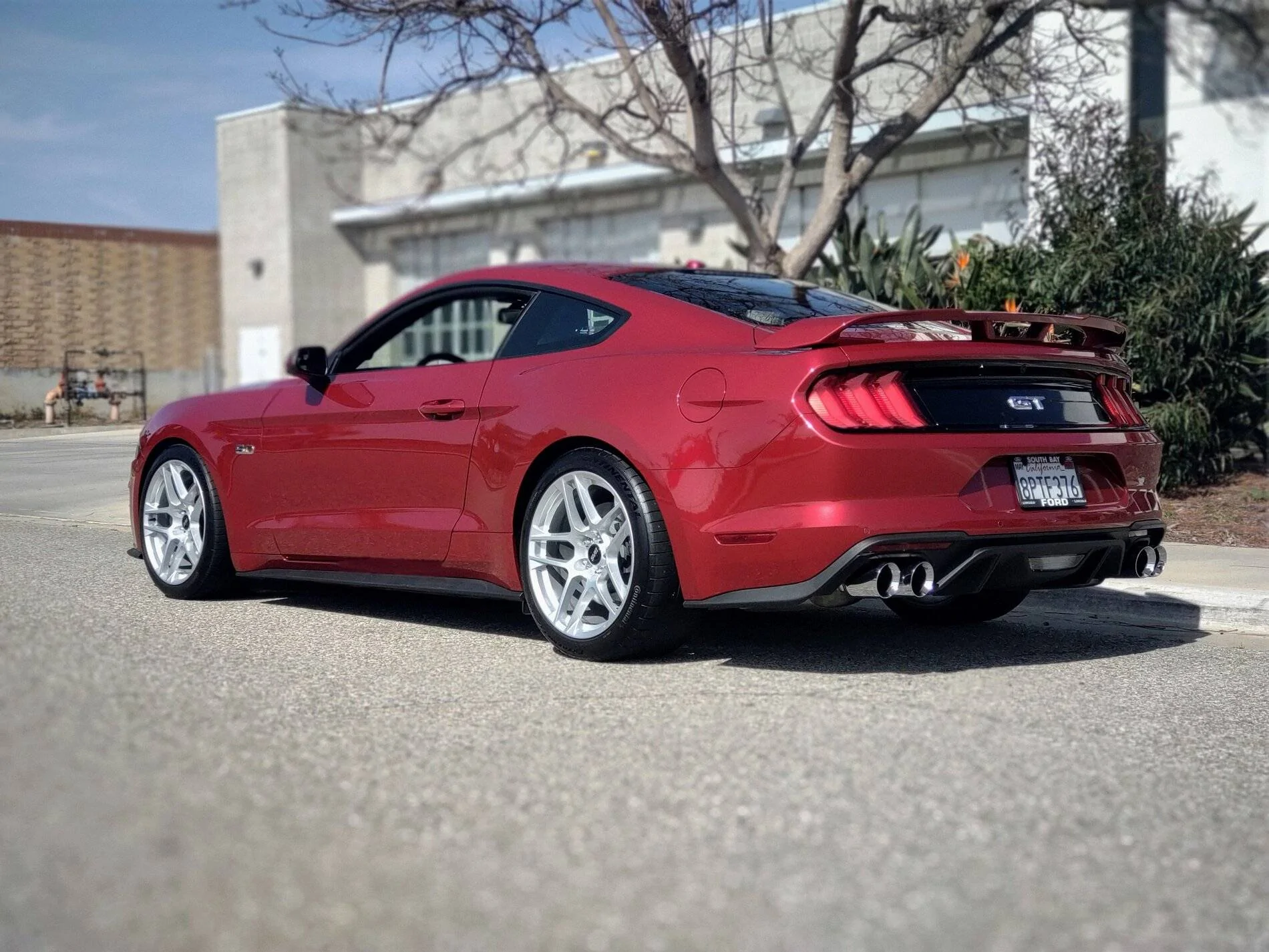

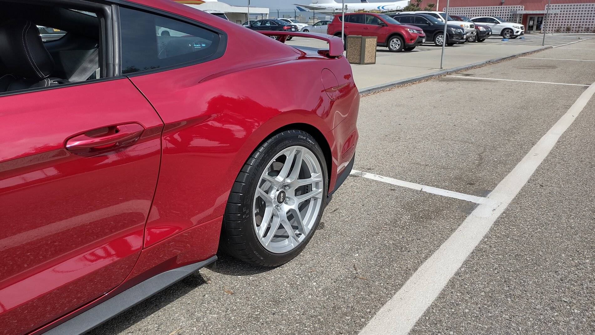

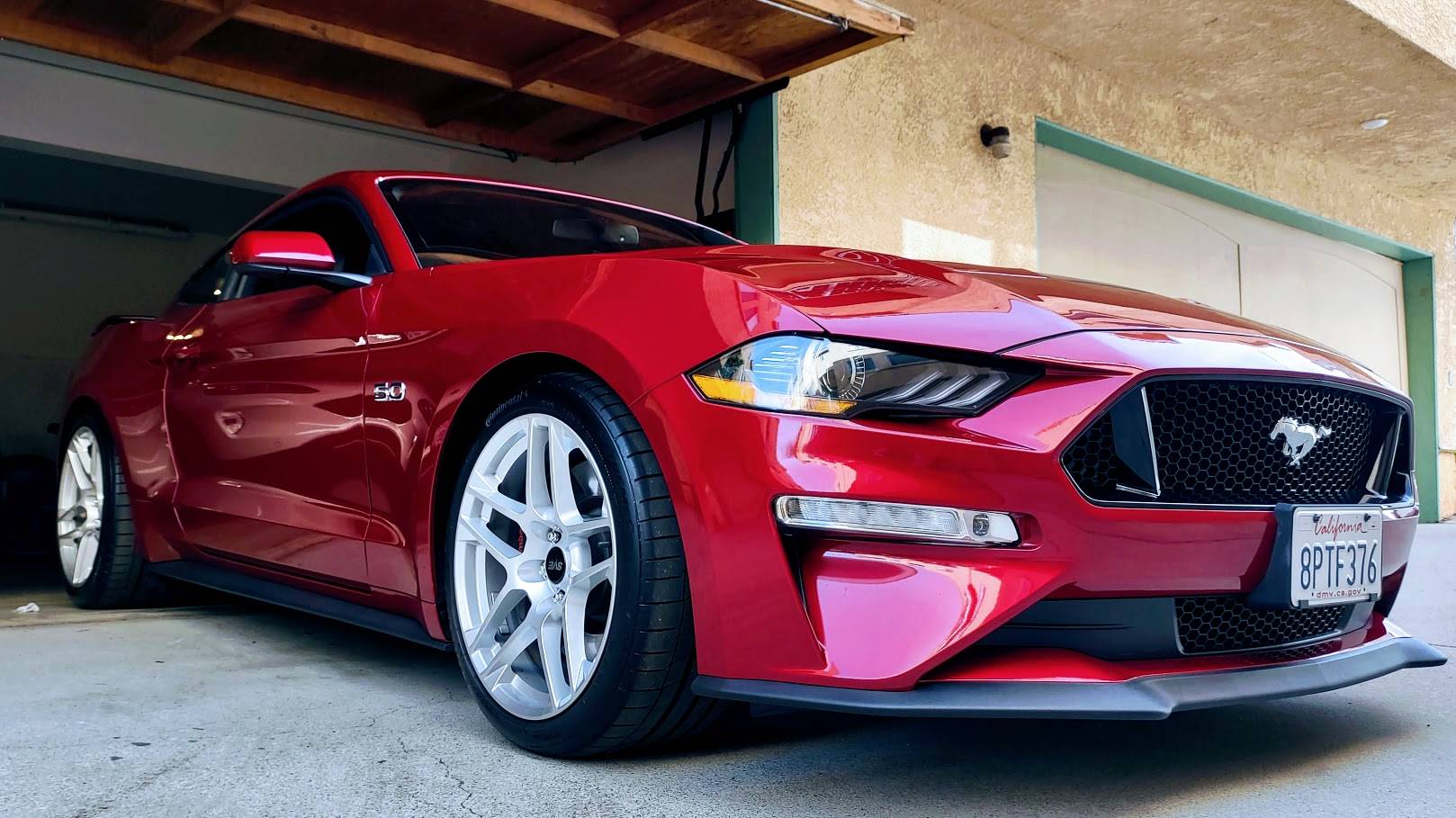

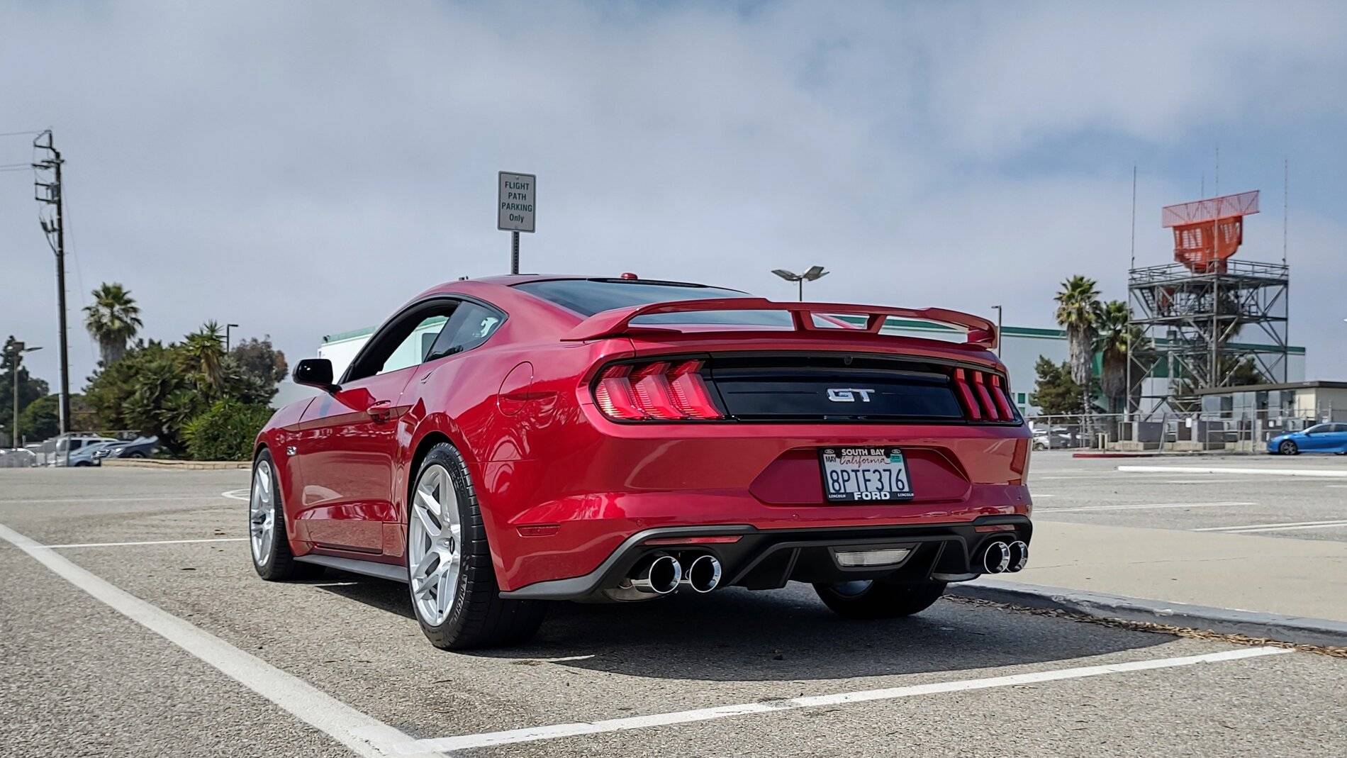

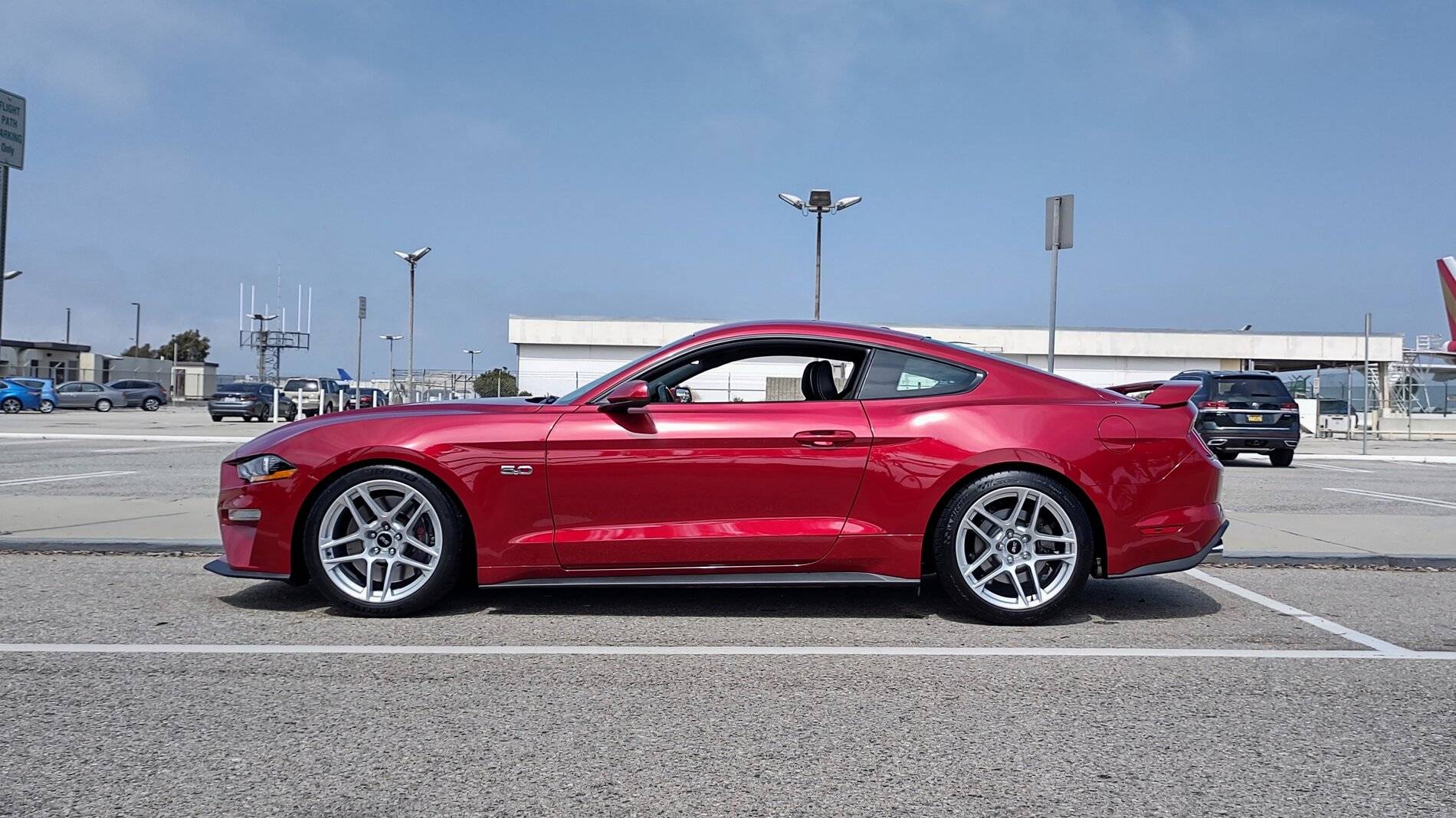

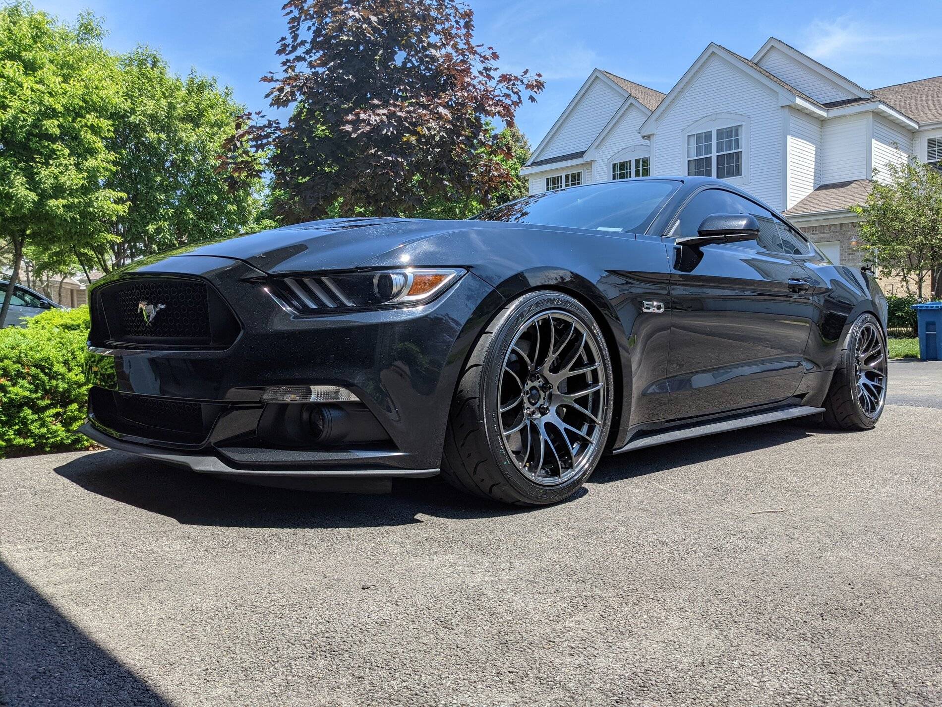

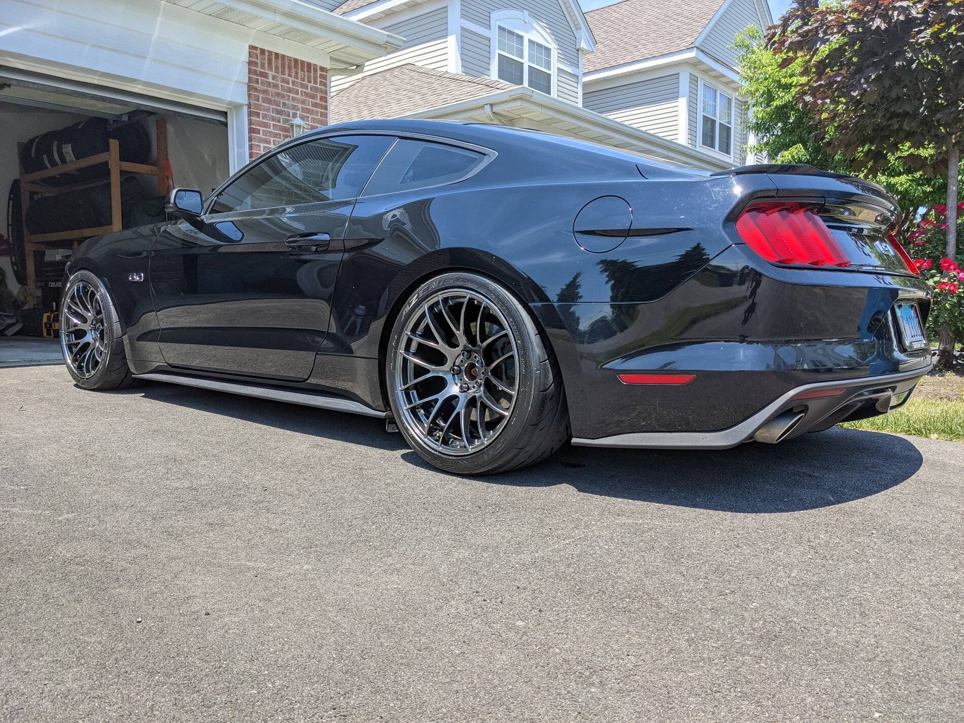

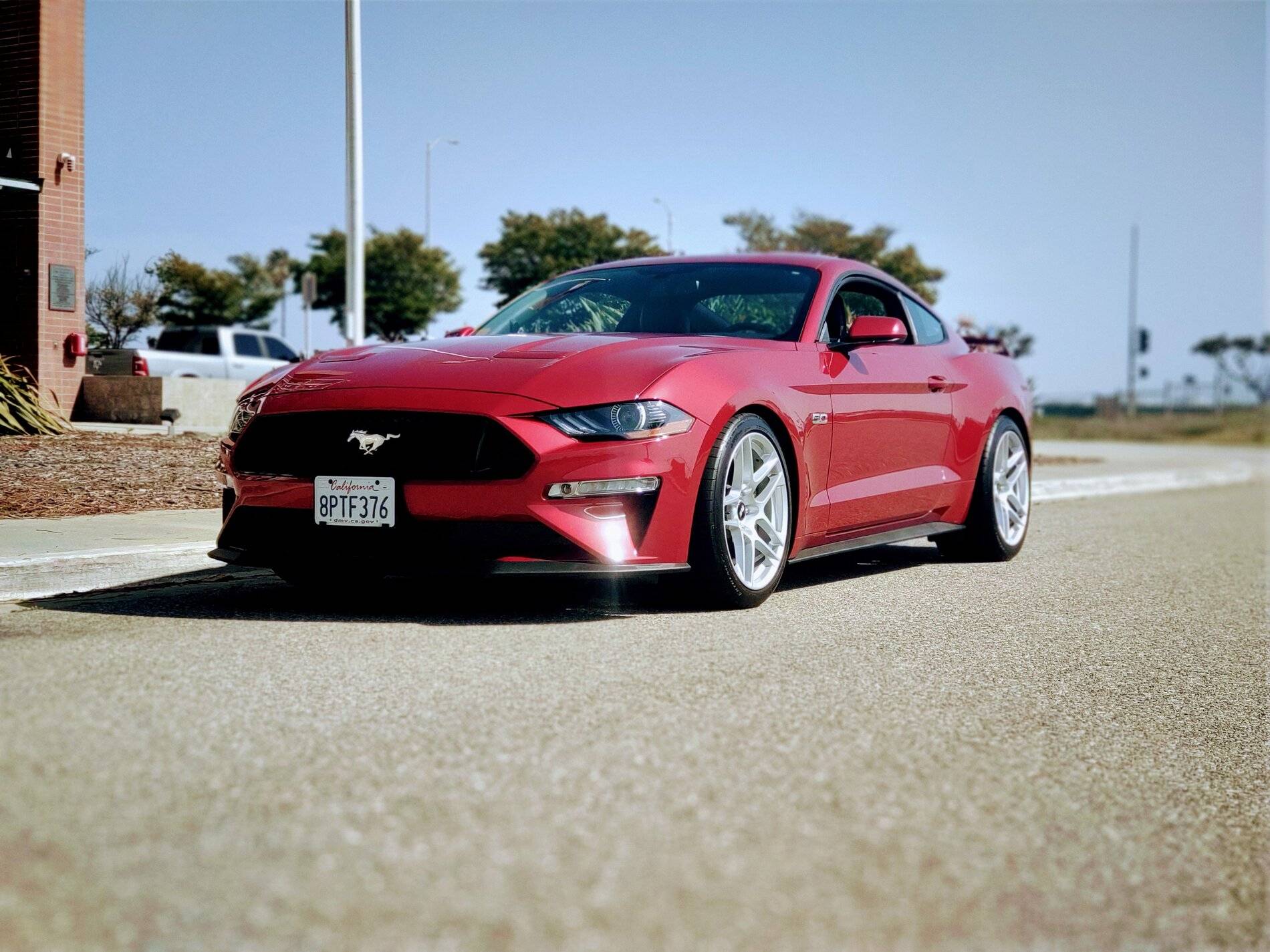

My set up. SVE X500 wheels in hyper silver, 19X10ET35 and 19X11ET50 (pretty common offsets). Some photos have 275/35/19 and 295/35/19 CSCE and a few with MichPS4s in 285/35/19 front and Mich PSS in 30/35/19 rear.
