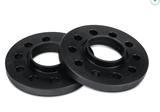

Hub centric spacer(s) are definitely the way to go. I (personally) would do just one than two but that's just me.
The main point that I was driving here was also in @JohnnyGT question/comments about spacers/stacking shims. "Stacking shims: why is this bad?" as well as "OK sorry. Your vid was about swapping rear wheels to front. so no spacers needed.". Hence my comments.
I should've quoted both for clarity.
Either way, if one was to go about getting spacers, I would highly recommend the slip on style with a hub centric ring. It's so much easier.
