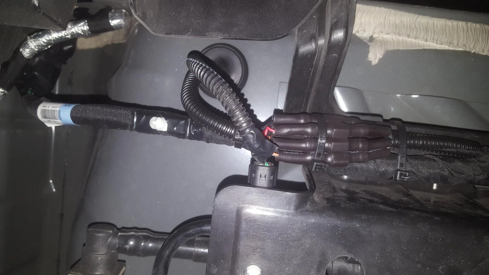

This is by no means a step by step how to. Mainly consolidated information from the other thread and photos of my sketchy half assed(for now) installation. Please read through the other thread to get a full understanding and verify before proceeding. Thanks to Fishtail, Rock50, and others for putting in the hard work of tracking down information and tracing wiring from the pcm and fuse box to the passenger cabin.

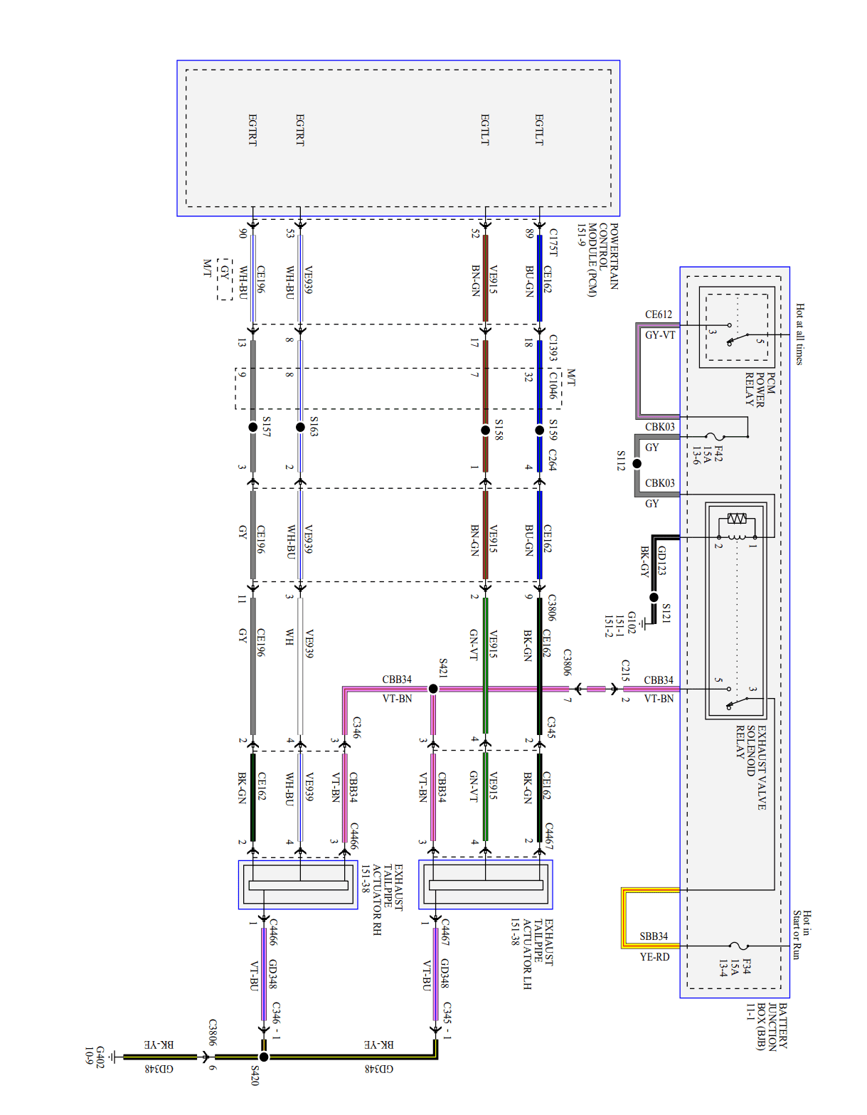

Wiring is not there unfortunately.... Here is a wiring diagram of the actuators. Technically it looks possible and worst case, you would have to run wiring directly to the PCM and battery junction box. Best case is that the wiring mostly exists and is just missing the actual leads and connectors. Have to do more investigation to find out.
