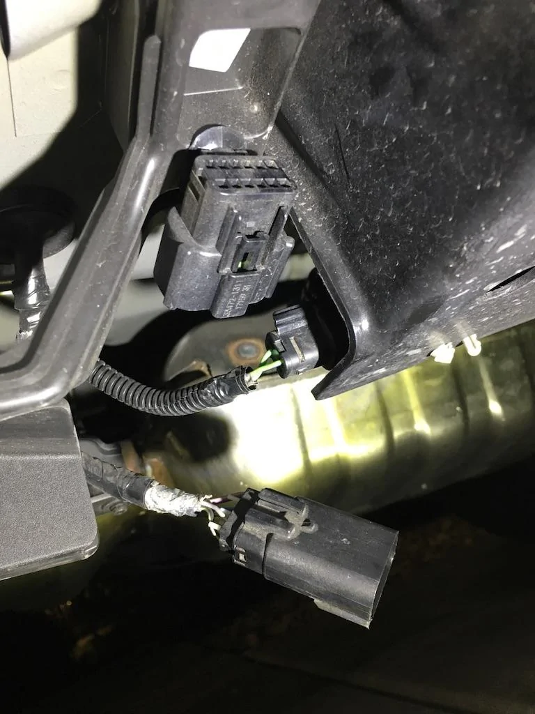

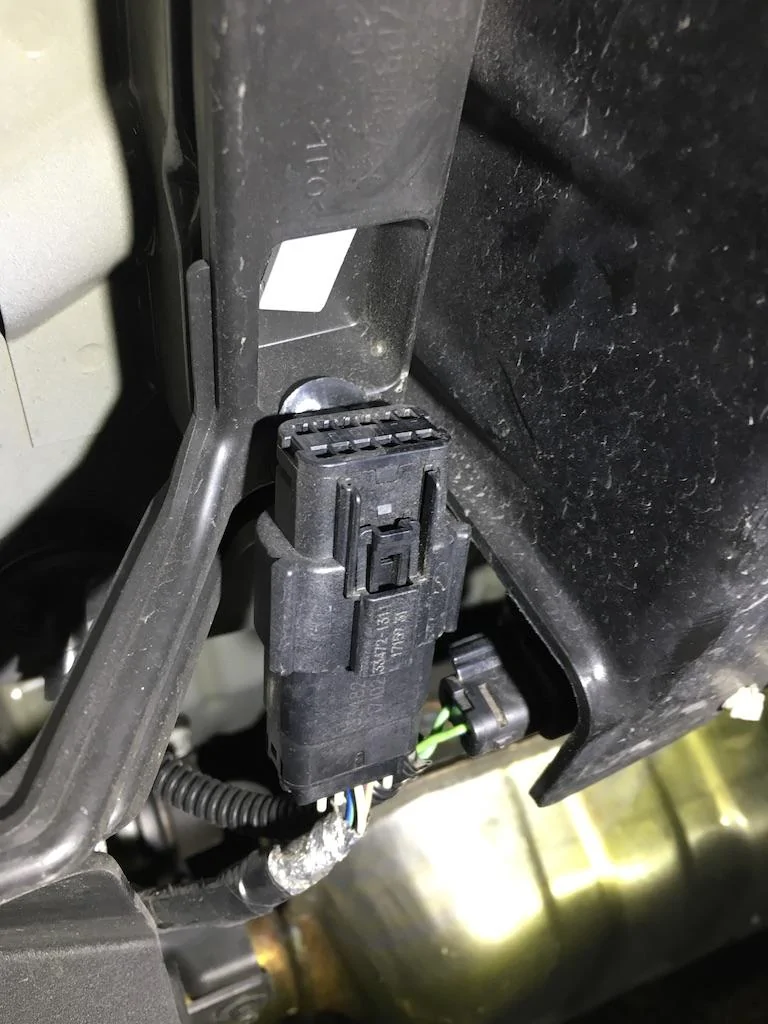

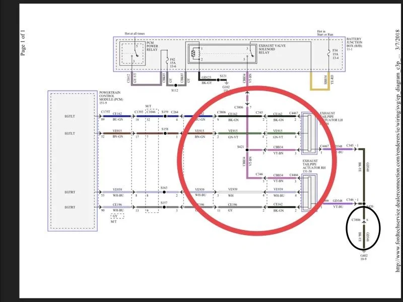

I have the mufflers in my possession, I paid $188 ea. I did some investigating on my '18 GT. There is the connector shown in the pictures at the rear on the car, plugged into a blank to keep it clean.
The relay & fuse are also present in the relay center.
It looks like the only other thing I need is the harness that connects this 12 pin connector to the 2 4 pin connectors at the exhaust valves. Anyone know a way to figure out the part number from the diagram? It is labeled C3806, but I can't find anything using that. If I can't find it from Ford, or it is too expensive, I can make up the harness. I will do a full writeup on converting an '18 once I can get this harness.
