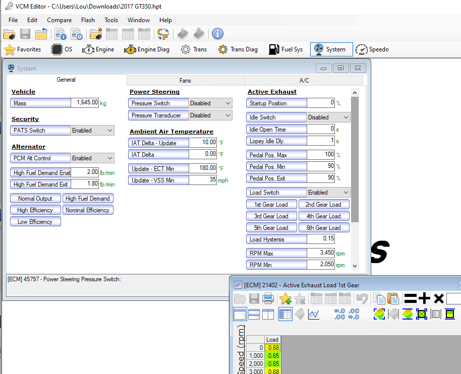

You guys are awesome. Let's hope it is finally the solution we've been waiting for!
I guess once my hardware minus the actual exhaust arrives I will have to do some poking around. Thanks for trying.Ok they will not tell me what they turned on. Looking at the HP Tuners forum it is a simple thing for the Dodges, GM, and even see they have it setup for GT350.
I have, also tried several different numbers for 720-04 and 720-10 based on the big thread as there's a bit of confusion it seems.Did you activate using forscan?
