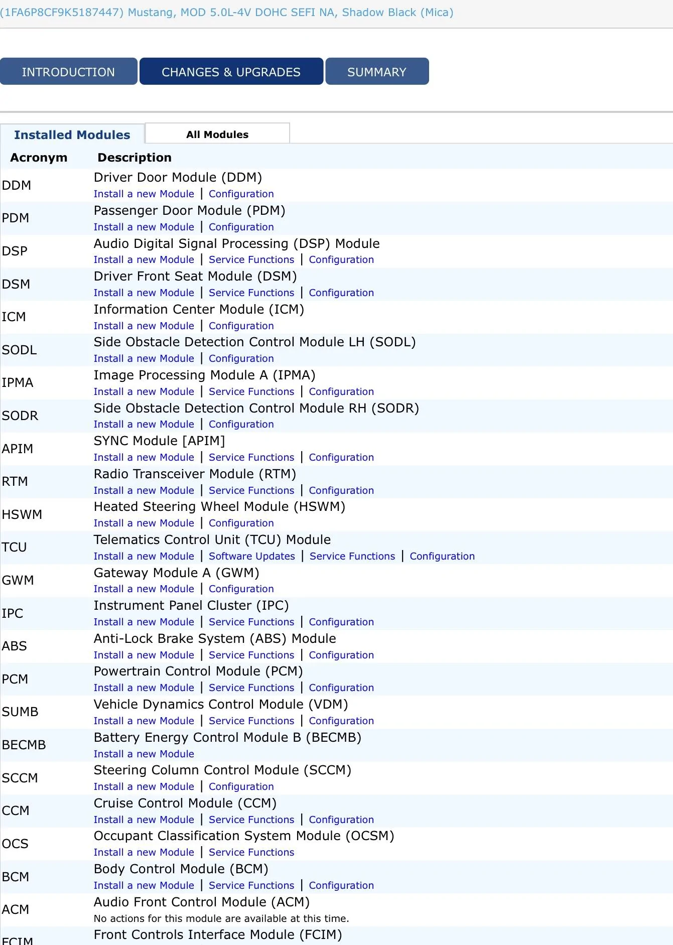

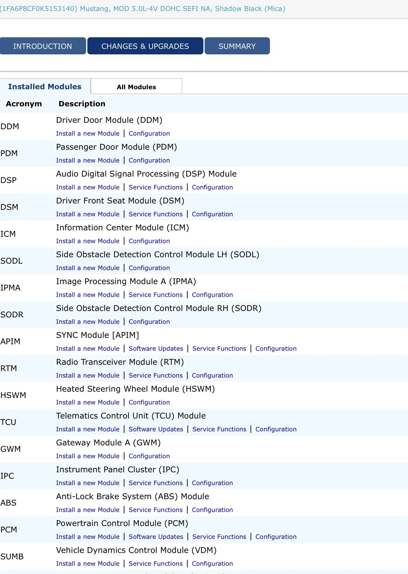

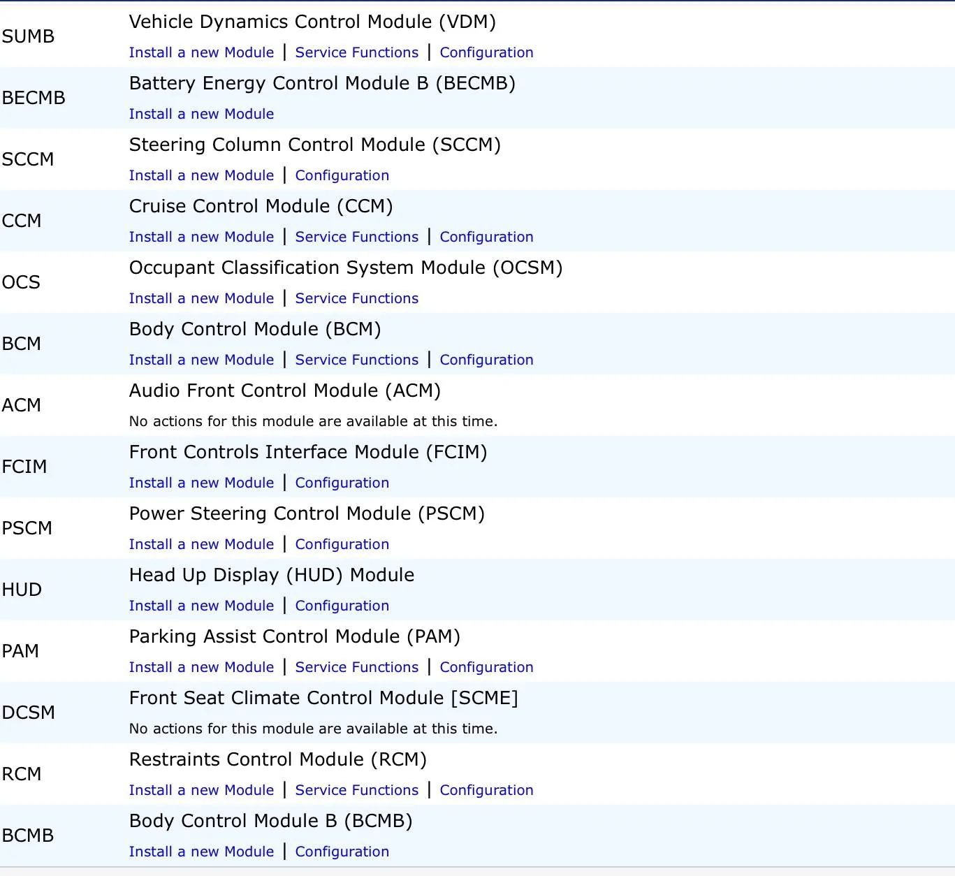

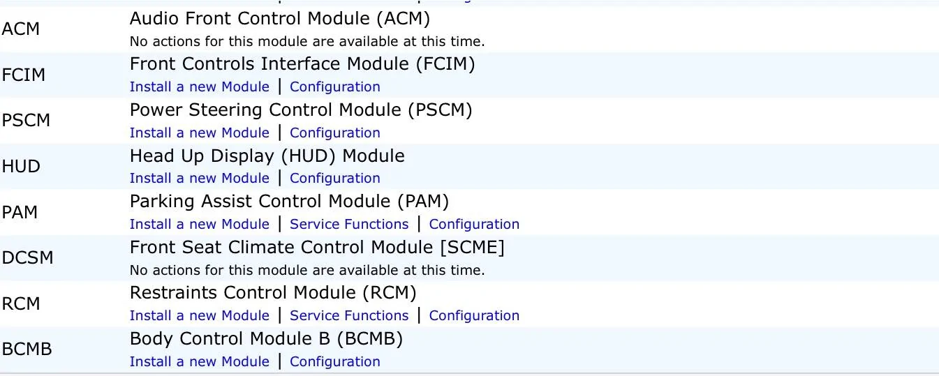

Here is another 2 with magnaride
1FA6P8CF0K5153140
1FA6P8CF9K5187447
I didn’t do any analysis, but here’s the data for those (2) VINs - see if anything in the docs helps with the comparison quest....
and here’s the other dataset (different from PDFs)

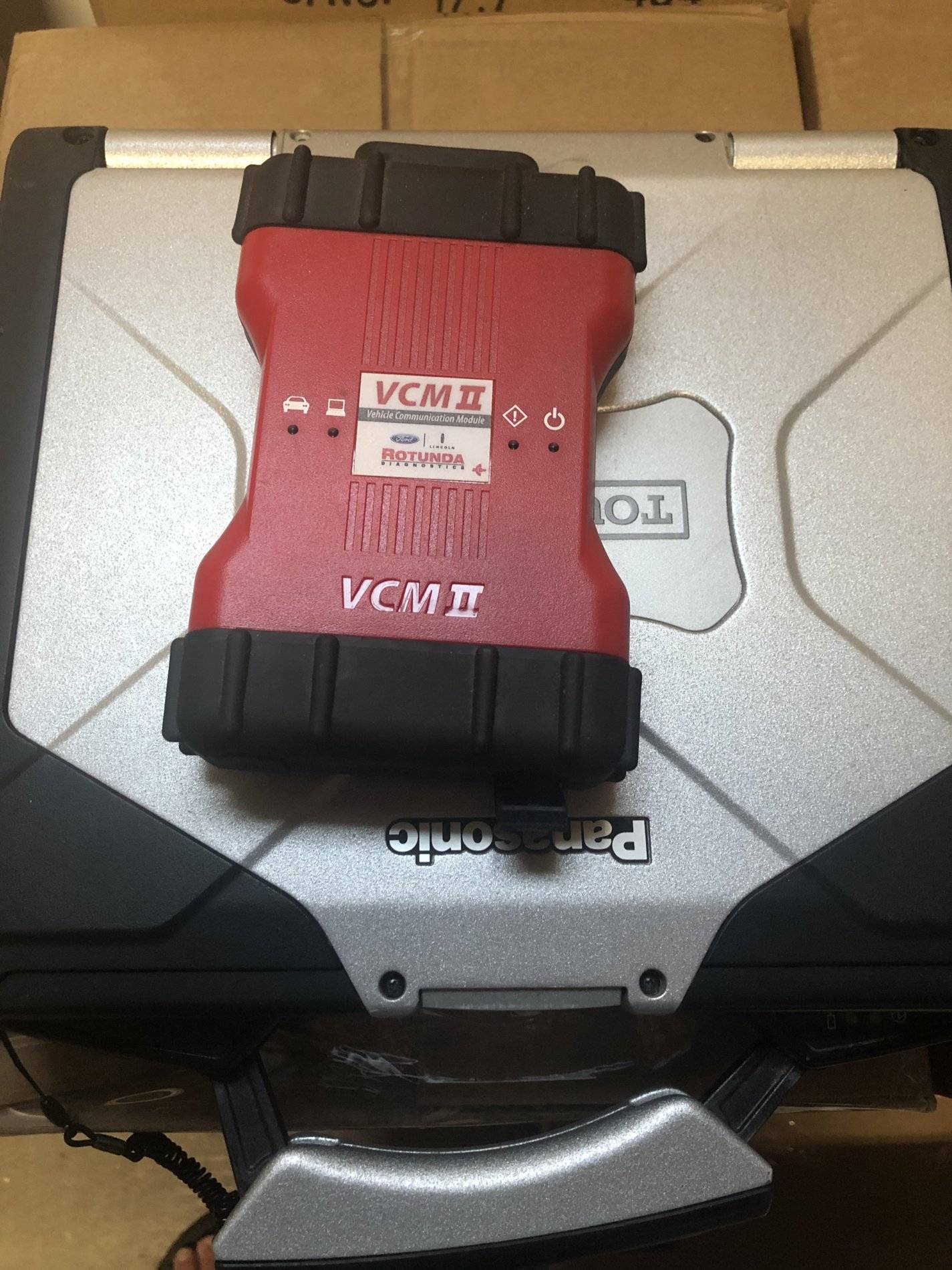

Ok I have read what you are doing and talking about using forscan to program it. I have never used forscan but guessing it is a aftermarket software people use. That being said have you ever used a Ford VCM 2 with the IDS software it comes with?
I have not hooked it up to my 2019 Mustang GT yet but have used it on a 2012 F150 to turn on the electric brake controller. You can go into the Programmable Module turn things on and off, change tire size ect
Plug it in! I'm praying someone finds a way of doing this as I have the exhaust in my garage waiting to go on... but ford are difficult and won't even look at the PCM to make a change.
