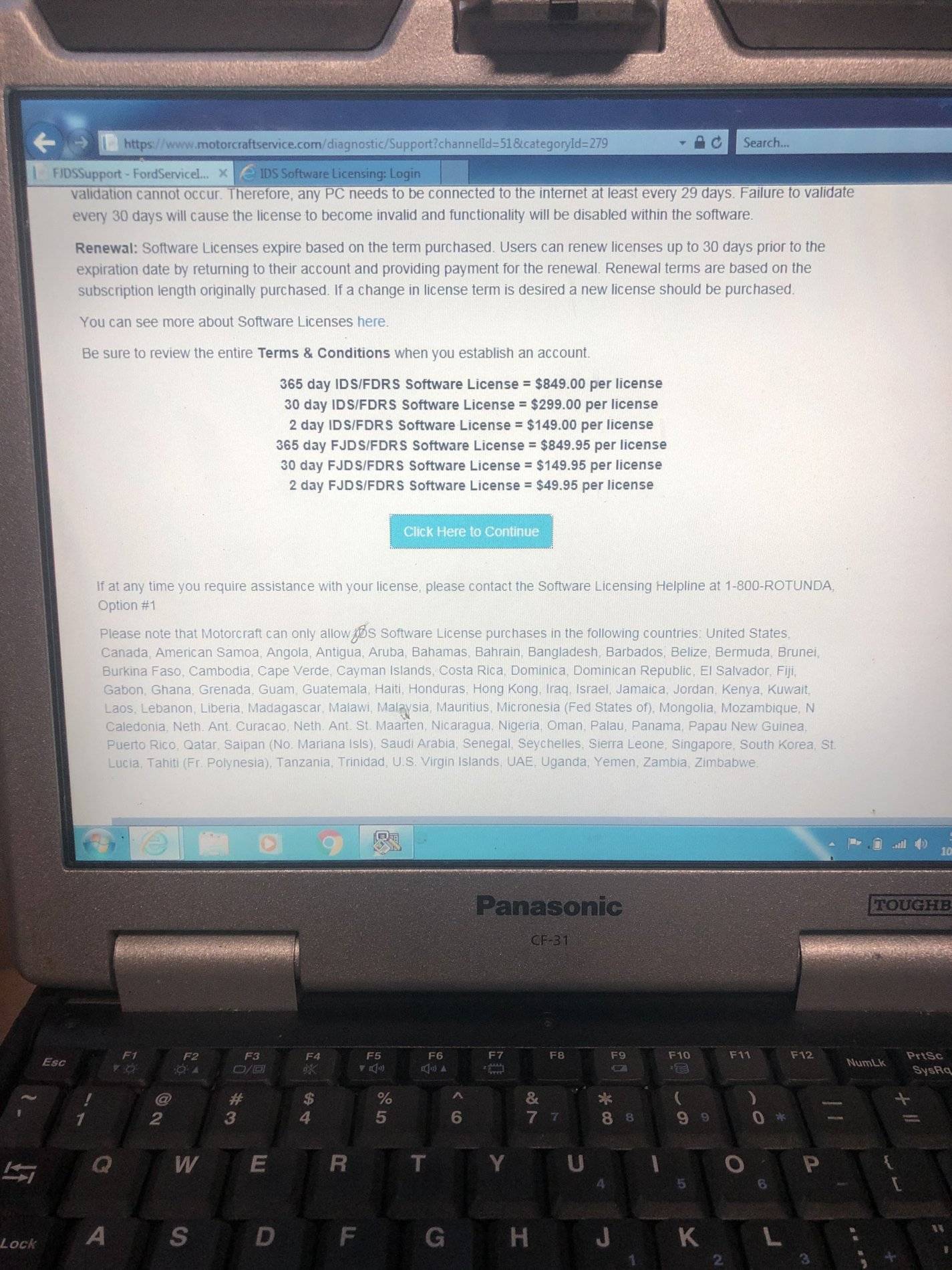

I just went to hook it up and found that the IDS software has expired it is only good for 1 year
looking at the Ford site to renew it there should be no problem programing it because it is same software Ford uses
The only problem is hate to buy a 2day 30 day or a year because I don't need it right now if someone wants to buy a 2 day I will hook it up and test it

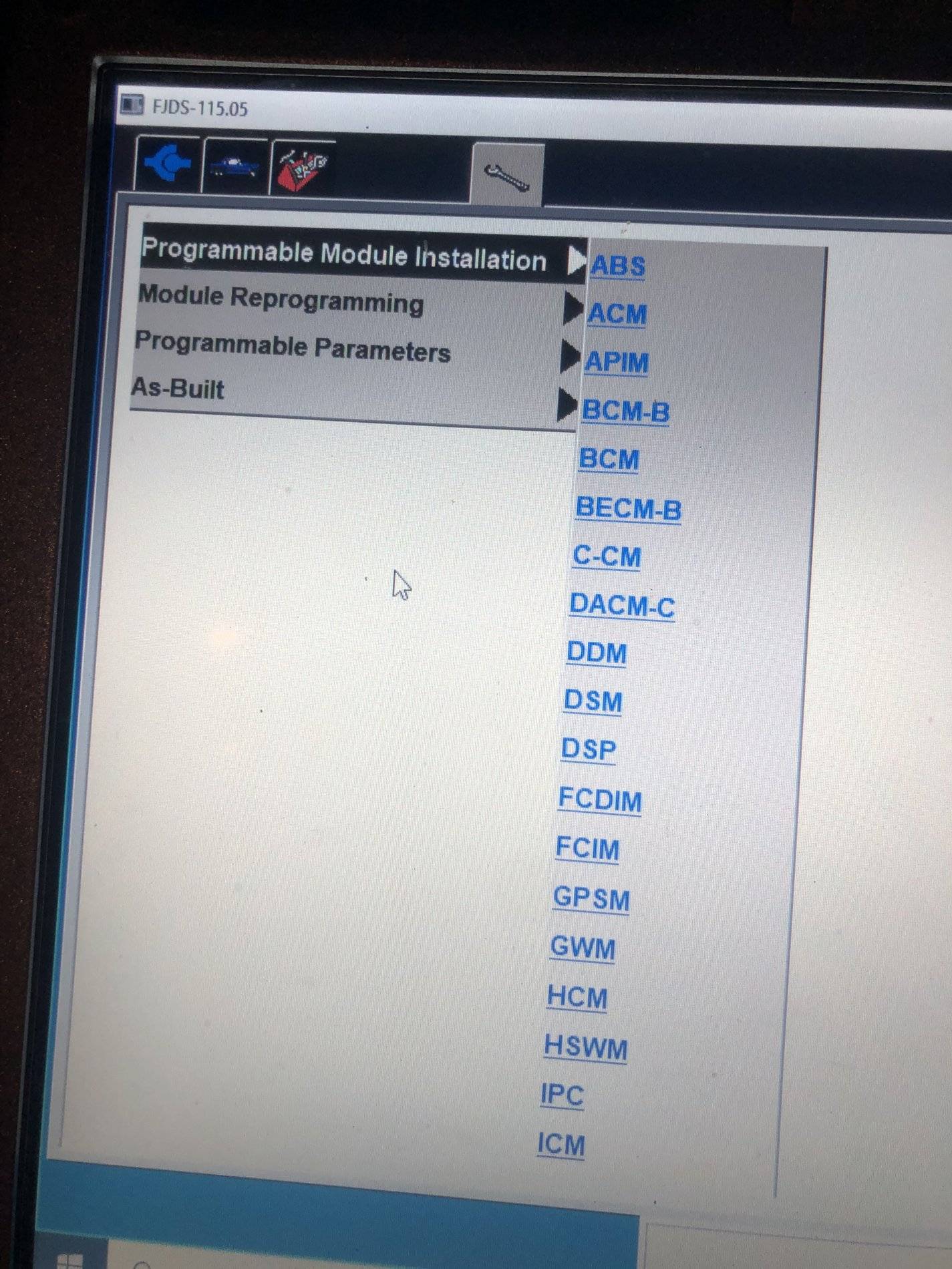

think I found it using the FJDS ford software

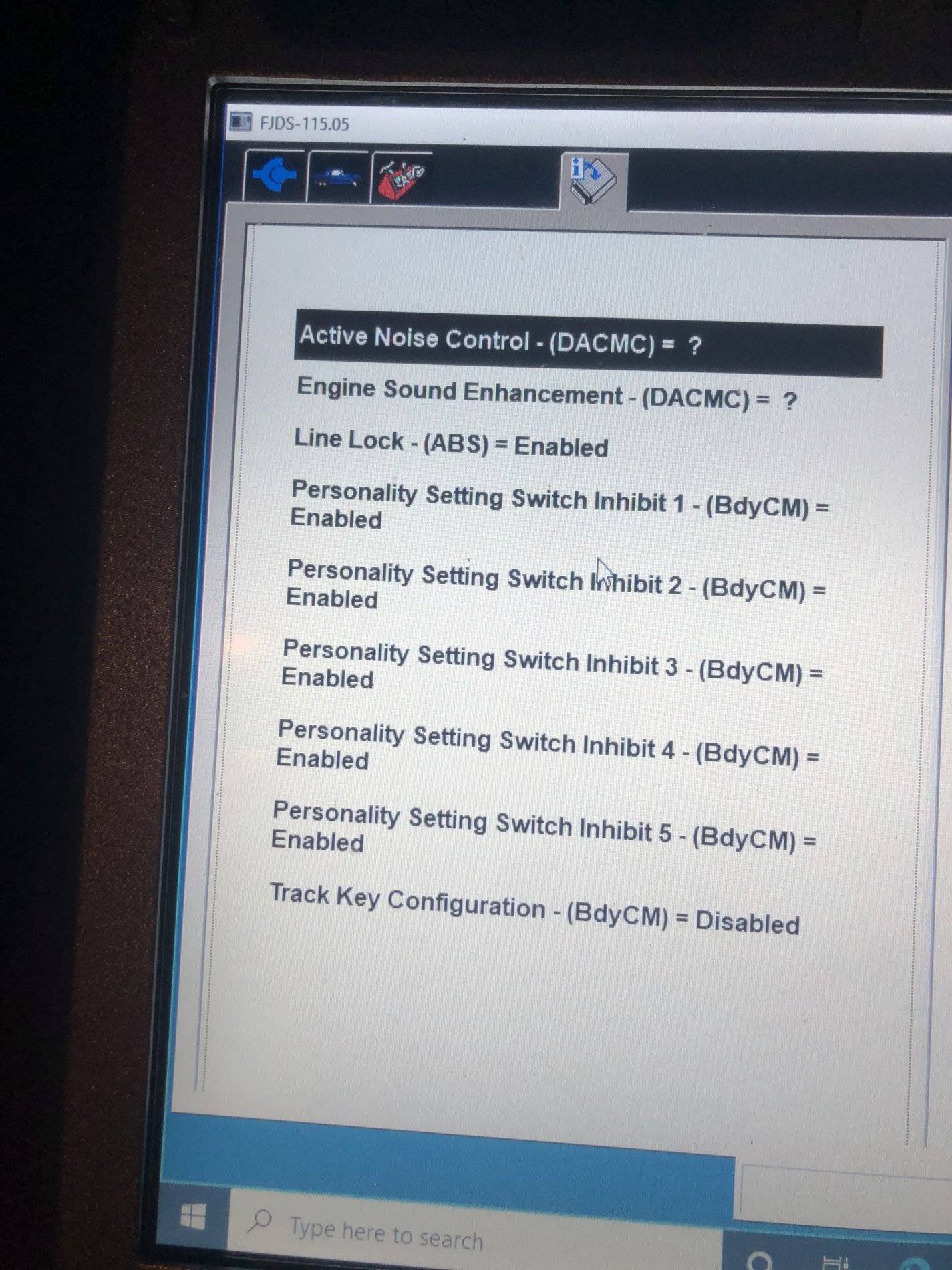

I don't believe those are the settings. Active Noise Control uses microphones in the car to 'noise cancel' using the speakers.
Personality setting switch inhibit is the walk up keyless entry

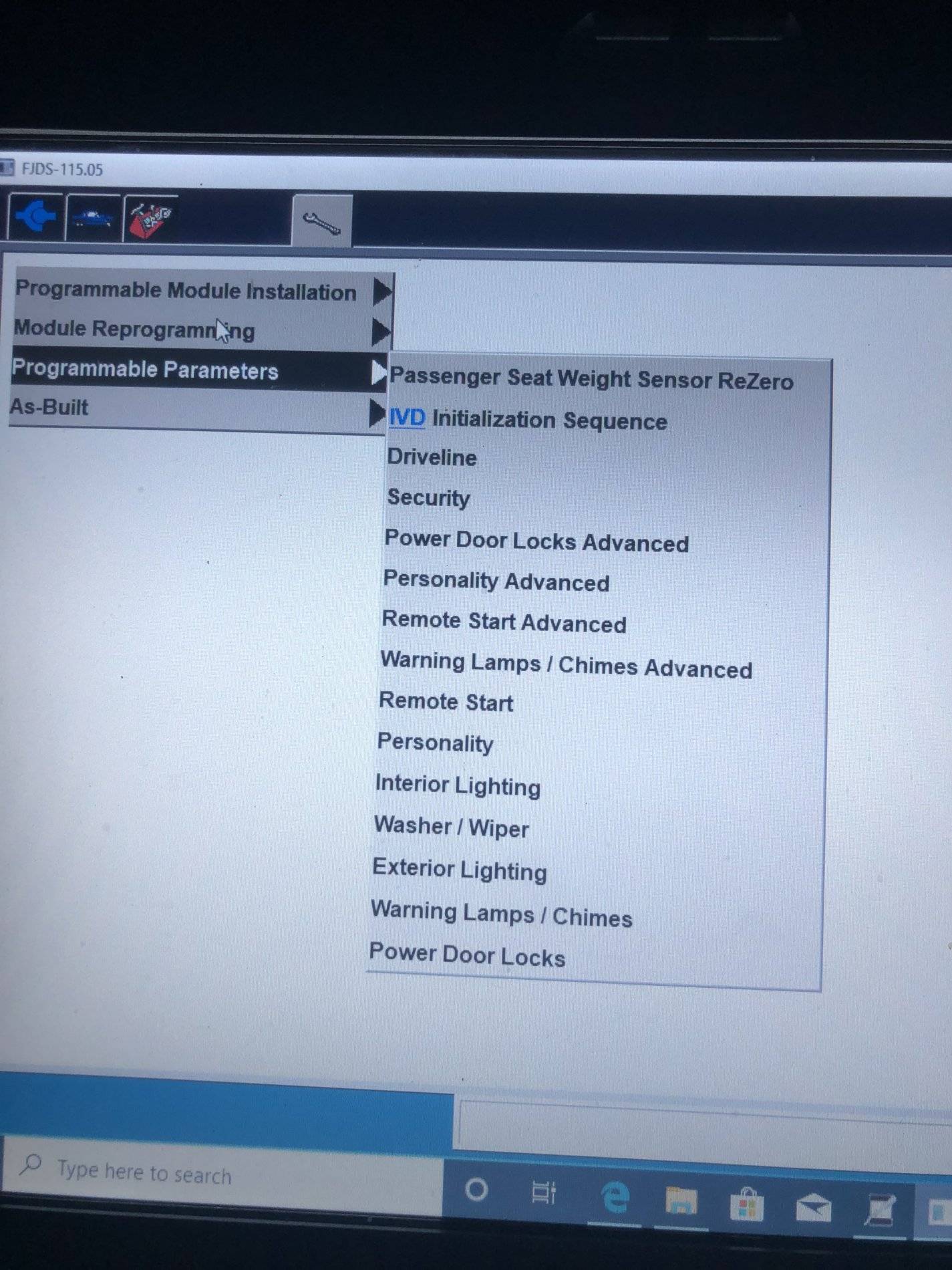

I am not sure where to turn it on but I am sure you can do it some where in this software
I have it so everything is turned on
