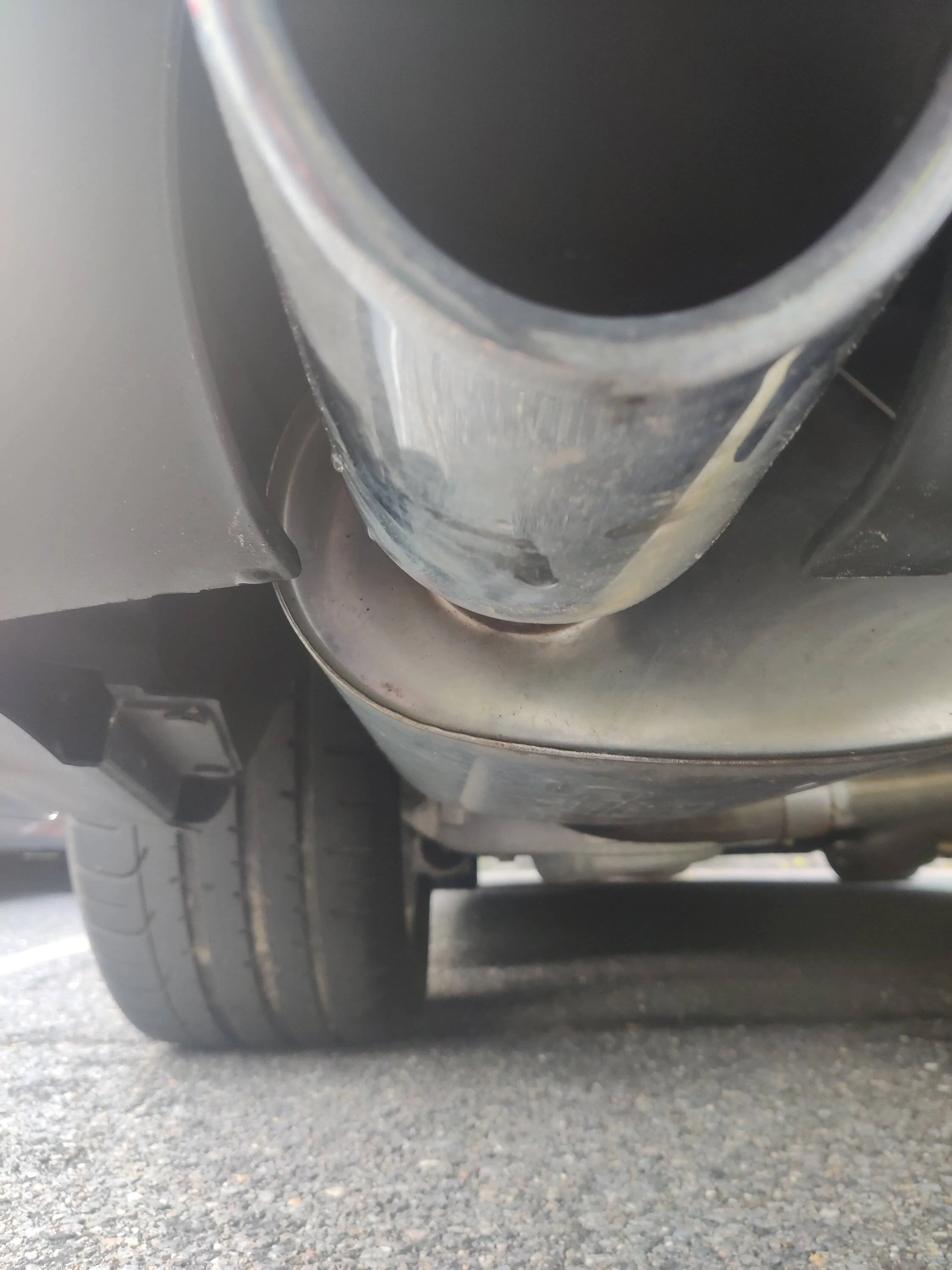

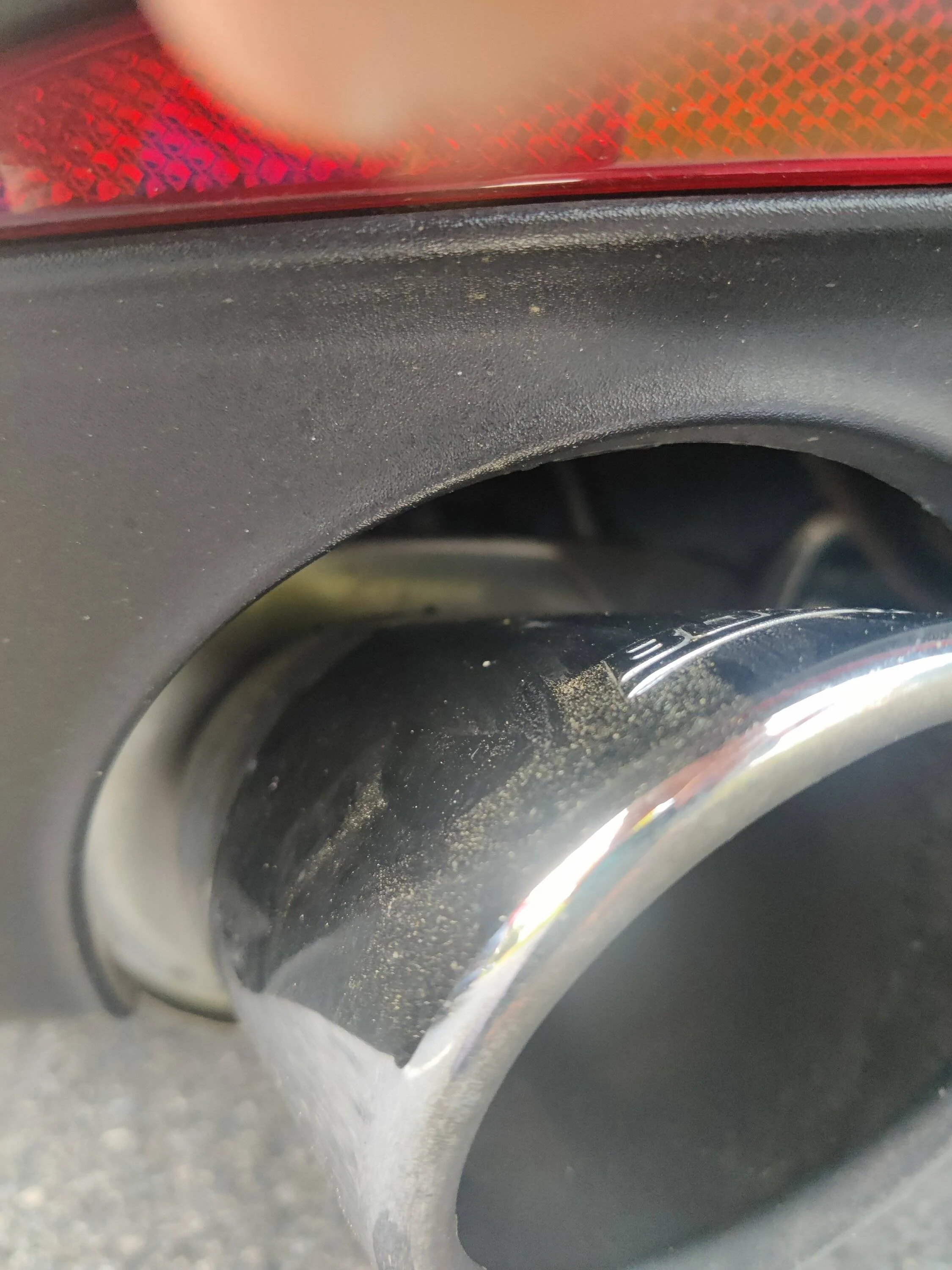

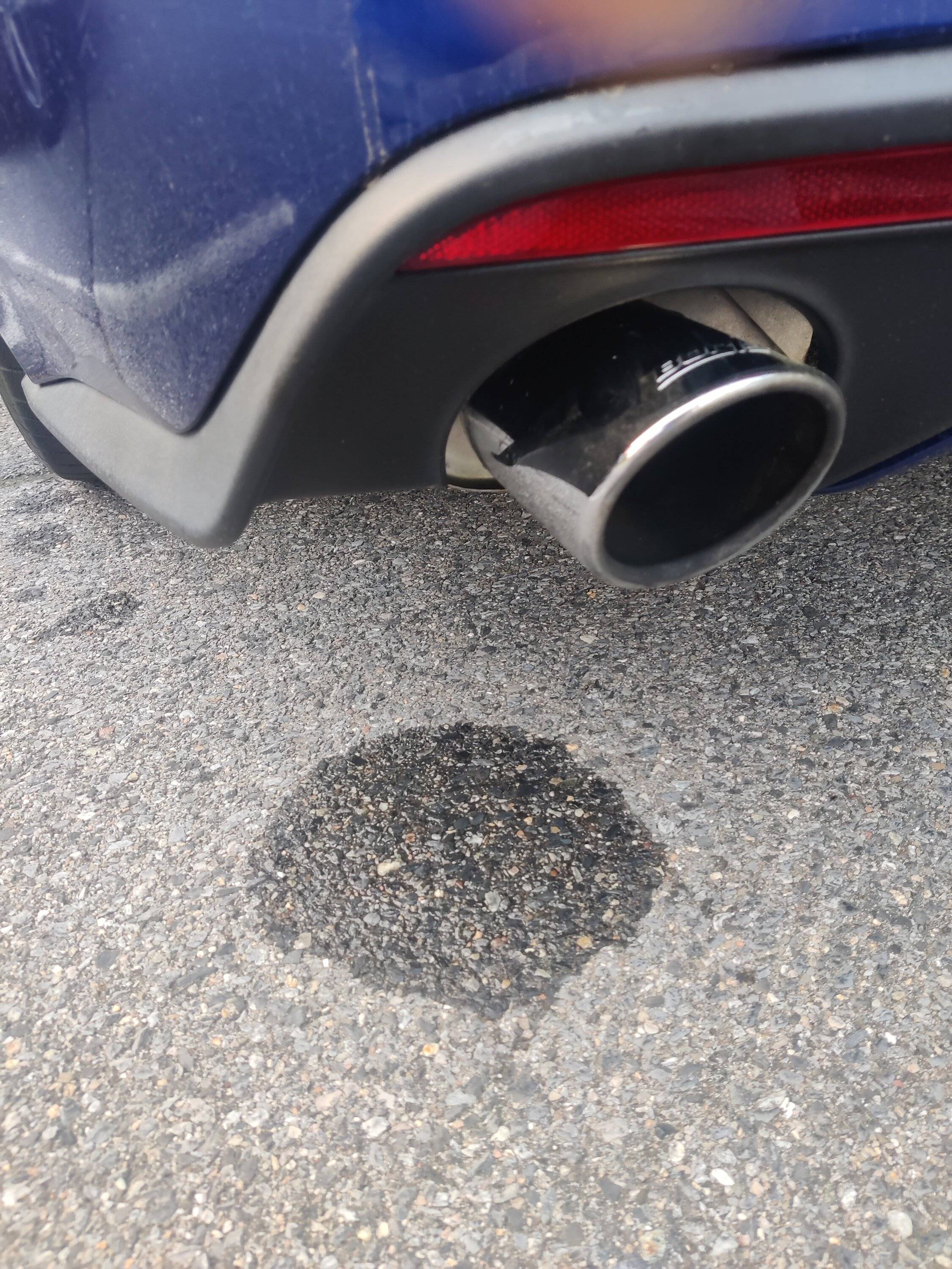

Lately I've been finding puddles underneath my exhaust tips. Water isn't coming from the tips, but from above them, and running down the pipe. I'm hoping I don't have another leak, as I just got done fixing 3 of them (window seam seals, and third brake light). Anyone experience this, or know if there is some sort of drain around the area? Thanks for any input.

The trunk water runoff goes down the back of the taillights and then the lights seem to partially drain down the back of the bumper cover, it wets the bumper bar and then drips on the tailpipes.
I’ve noticed because the bumper bars aren’t very well protected against corrosion and I occasionally get a rusty water drip / stain on the top of my tailpipes.
