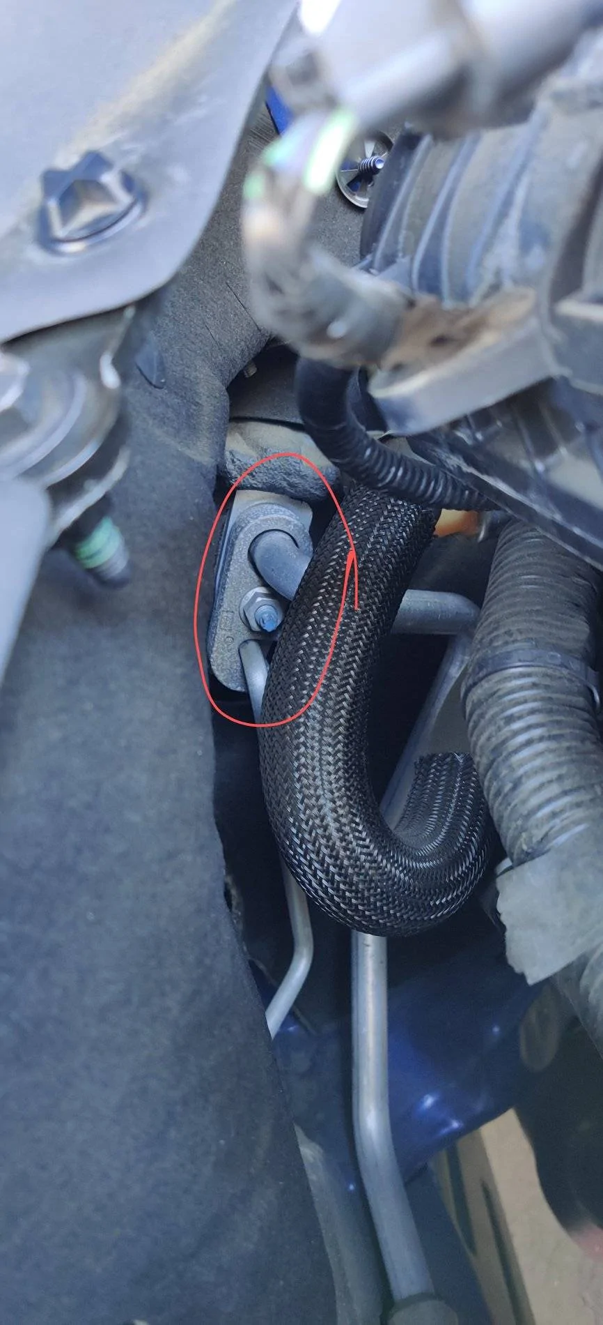

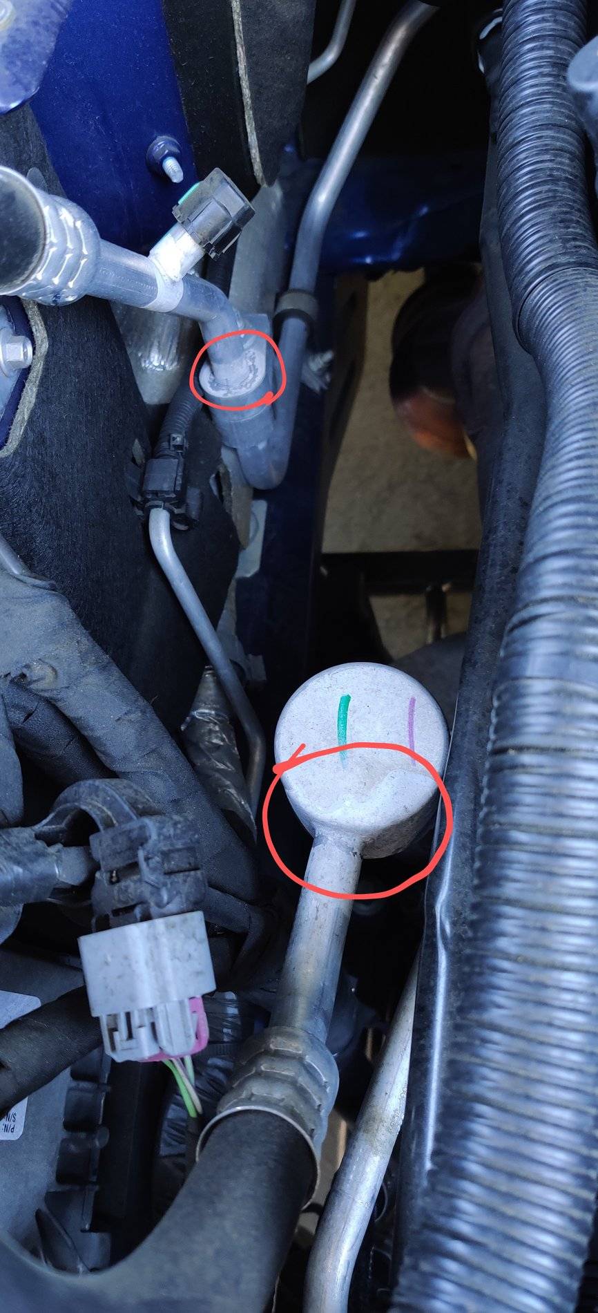

As I mentioned before, my A/C still cools down the cabin but it takes longer. Today I decided to visually inspect some areas and I took a few pictures. I'm not sure what that white residue is around the low side couplings and ends. Needless to say the Low side is far from generating any condensation on itself.
