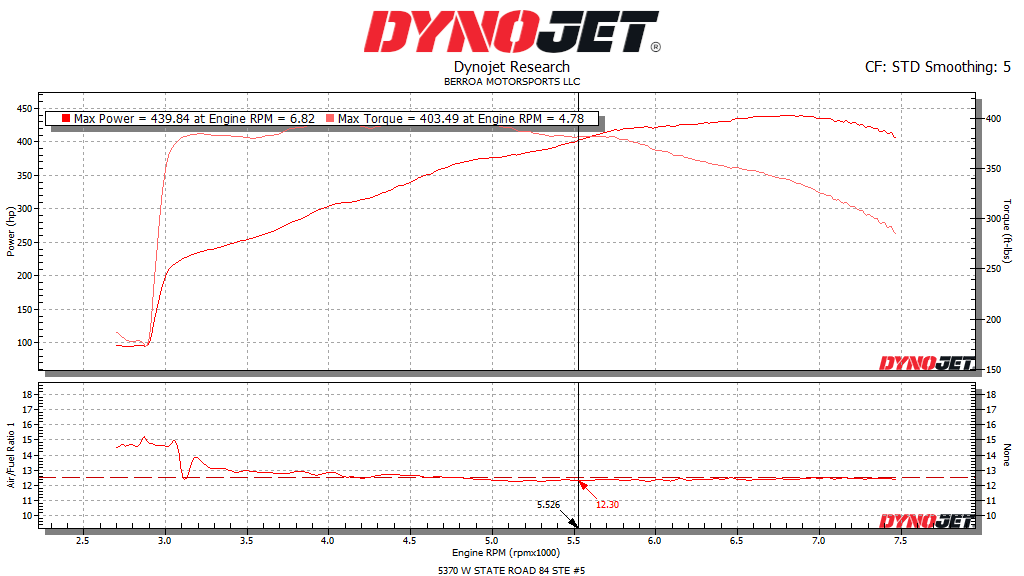

Car put down 439.84 WHP and 403.49 Lb-ft torque. STD CORRECTED. Numbers seem a bit low for a full bolt on e85 gen 2 motor.
2017 Mustang GT
Mods:
2018 Stock Air box with K&n high flow filter
2018 Ported intake manifold
LU 47 injectors
SP catless longtube headers
Corsa Xtreme exhaust
E85R tune

STD is not s good stamdard for Dyno cause is not keeping in consideration real ambient factor.
Usually is SAE smoothing 5.
Std tends to read higher so yes looks little low .
But..
Where did u start at?
More than absolute value u need to take a look of the delta bewteen before and after.
Also. Have u ever done a compression test?

never did a baseline so I have no idea. and no, never done a compression test. Car feels fine but I guess a compression test wouldn't hurt

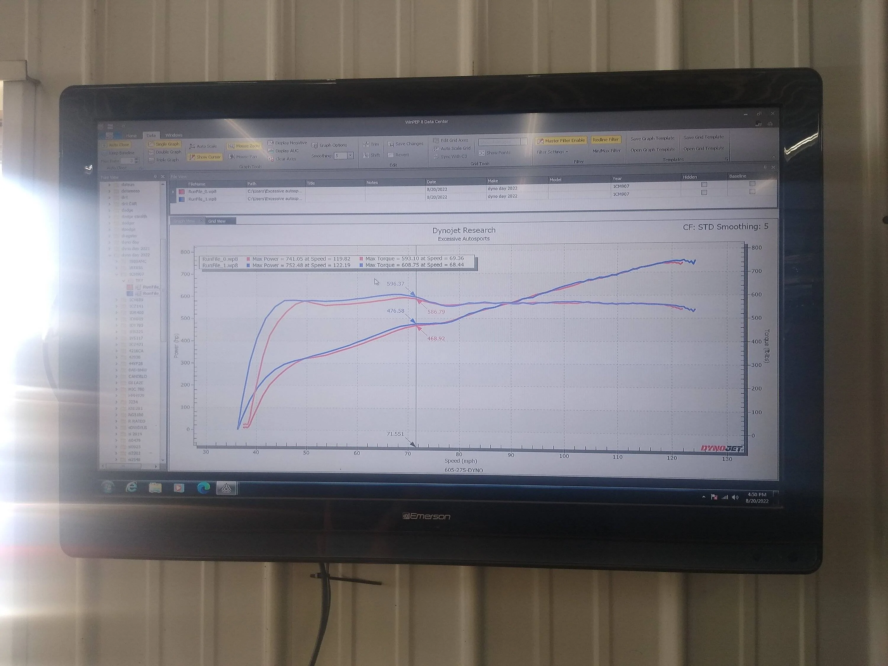

Sorry about pic quality, I didn't take it.
2016 Mustang GT
Kenne Bell SC
Sai Li fuel System
E85
Stock exhaust manifolds and cats
Borla Atak catback
Getting Retuned tomorrow. Different tuner, and have added catless headers and went to an MBRP touring exhaust to offset the headers.

That’s what my car felt like when it was FBO. Gen2 cars don’t make a ton of power N/A :(.

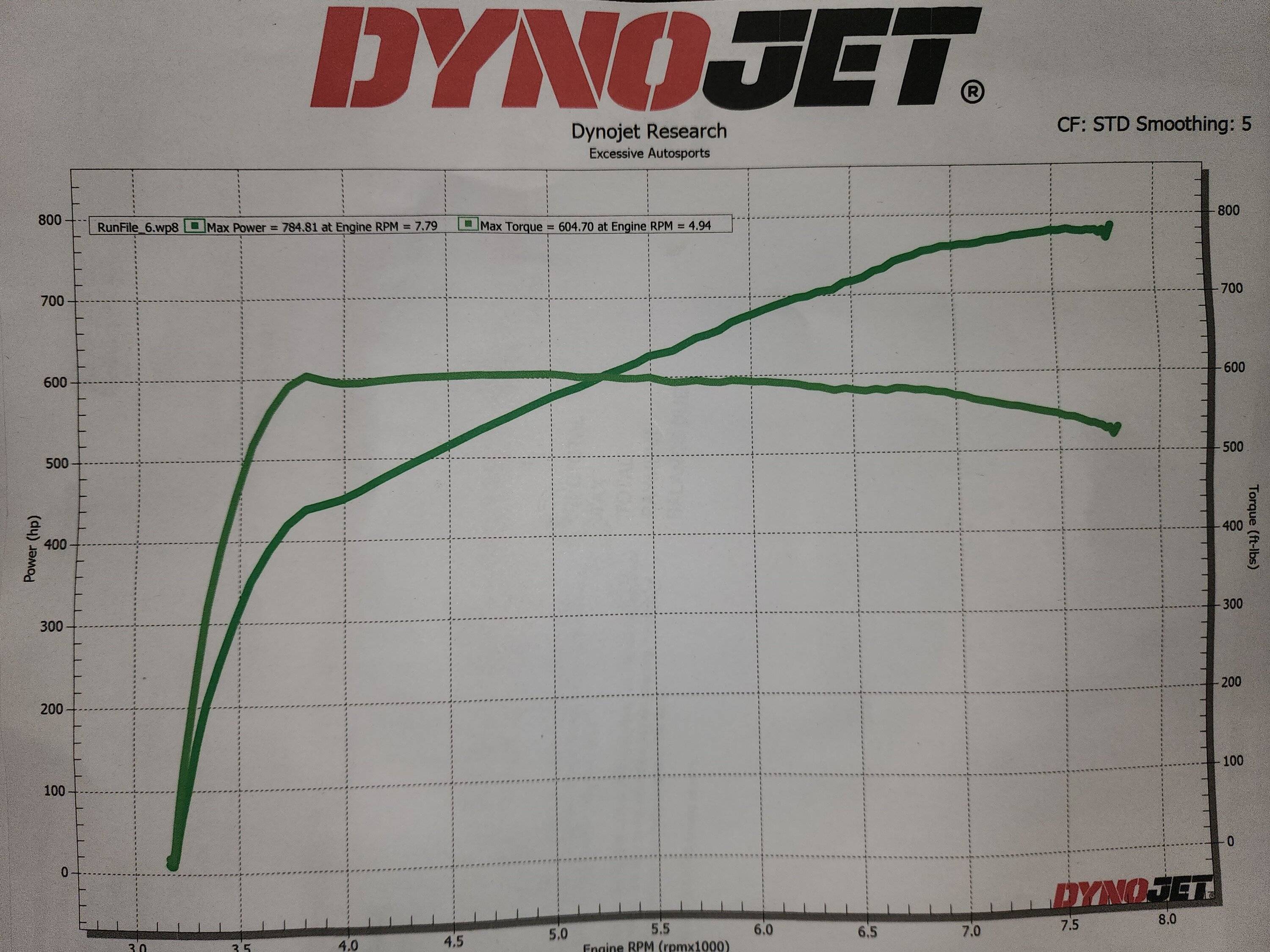

New Dyno Run 785 hp 605 lb-ft.
Current setup:
StainlessPower 1-7/8" LT Headers, Test Pipes, MBRP Touring/Street Exhaust
Kenne Bell SC
Sai Li fuel System
E85
Sai Li hit its limit. Fuel pressure started to drop at high RPM. At least I know the next thing that needs to be upgraded.

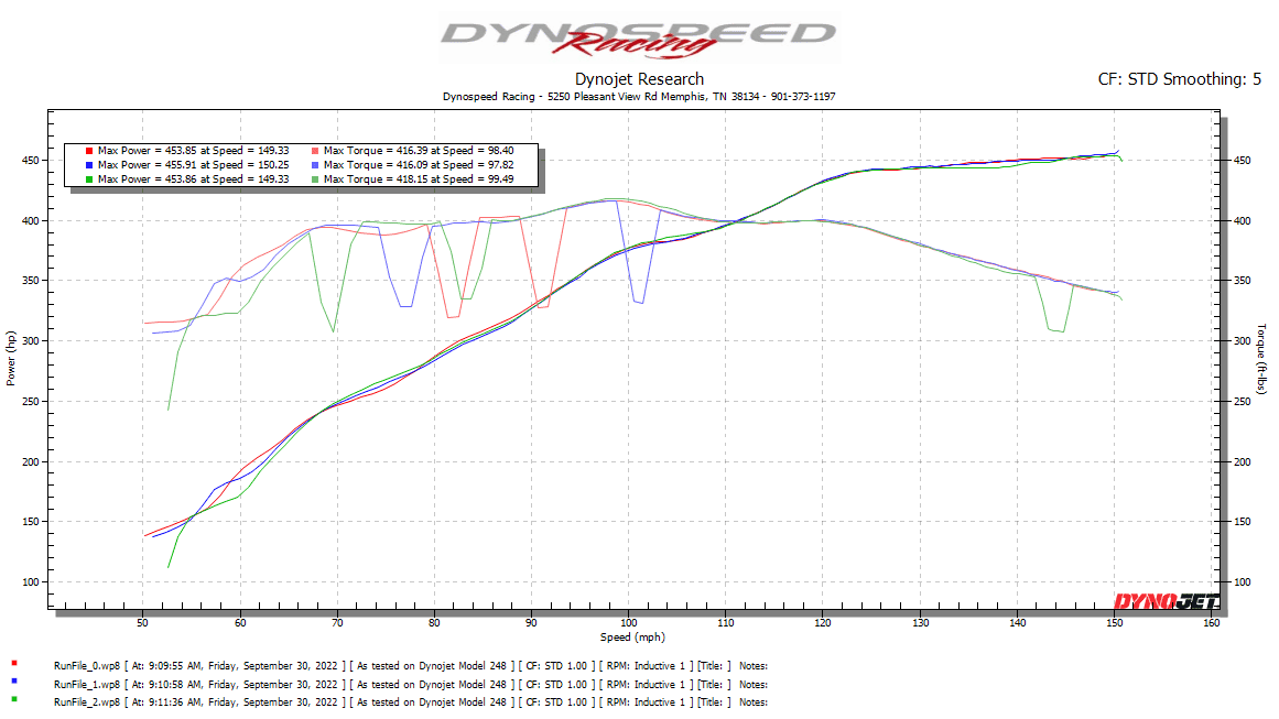

2021 mustang gt 6speed. Longtube, no cats and Gibson cat back. K&n intake tube with drop in filter & e85 tune. Looks like dyno had issues reading torque. Replacing intake in a few days and running it again this Wednesday to see if I pick up any hp. I don’t know what gear it was run in.

Do you have access to SAE instead of STD? SAE puts the output level to compare. Very curious about the intake. I have a ported stock intake and TB but doubt they're worth more than 5hp. What intake are you putting on?

Pmas. We’ll see if it makes a difference
