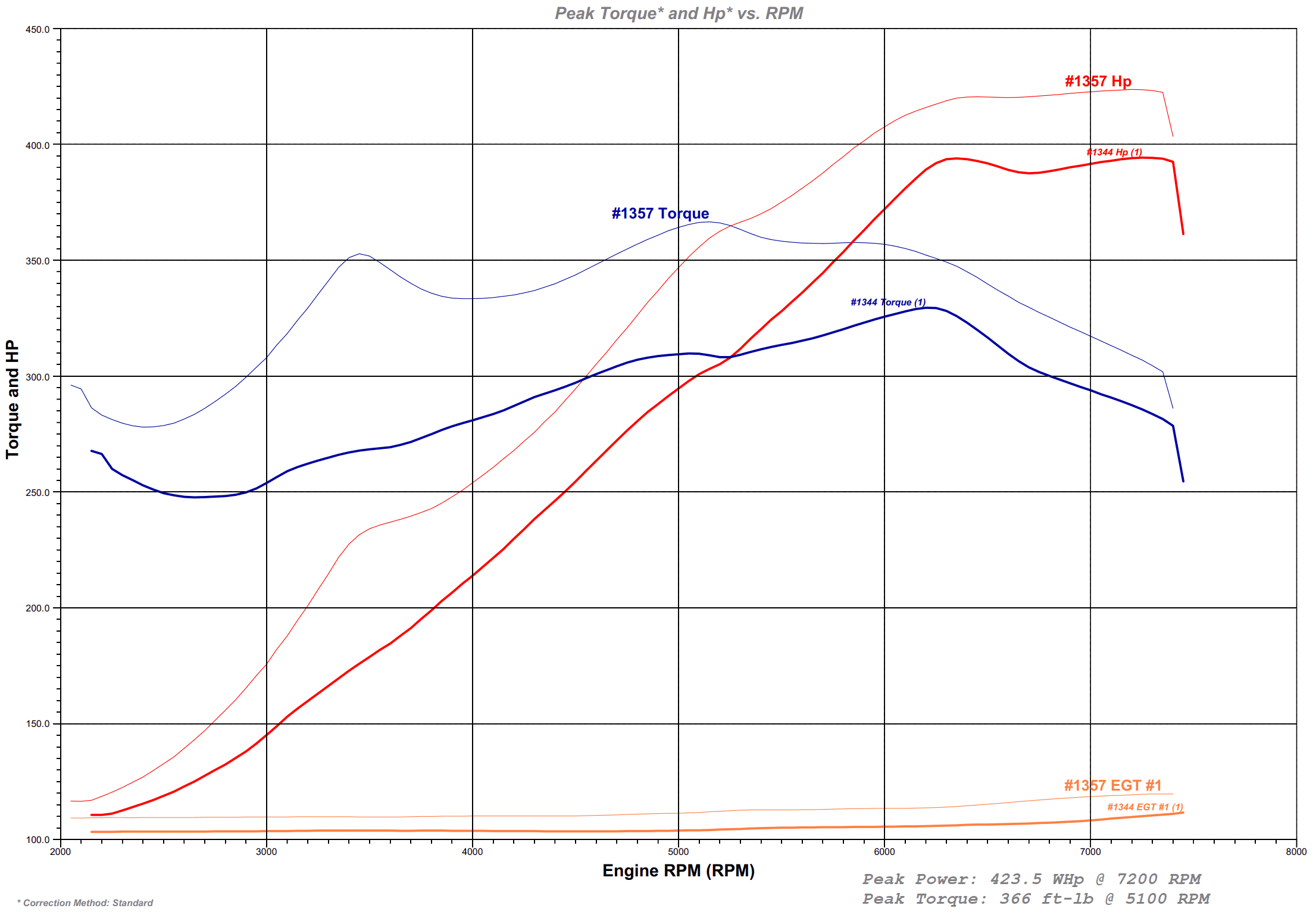

Mach1 2021, MT, dyno at 3th gear,
1 3/4" kooks headers with green cats,
h-pipe,
93oct tune.
423 WHp, 366 ft-lb
...thoughts?
3th gear? You should at least test in 4rd gear, man. 😇
EDIT: I'm starting to think nobody gets the "4rd gear" joke. 🤨

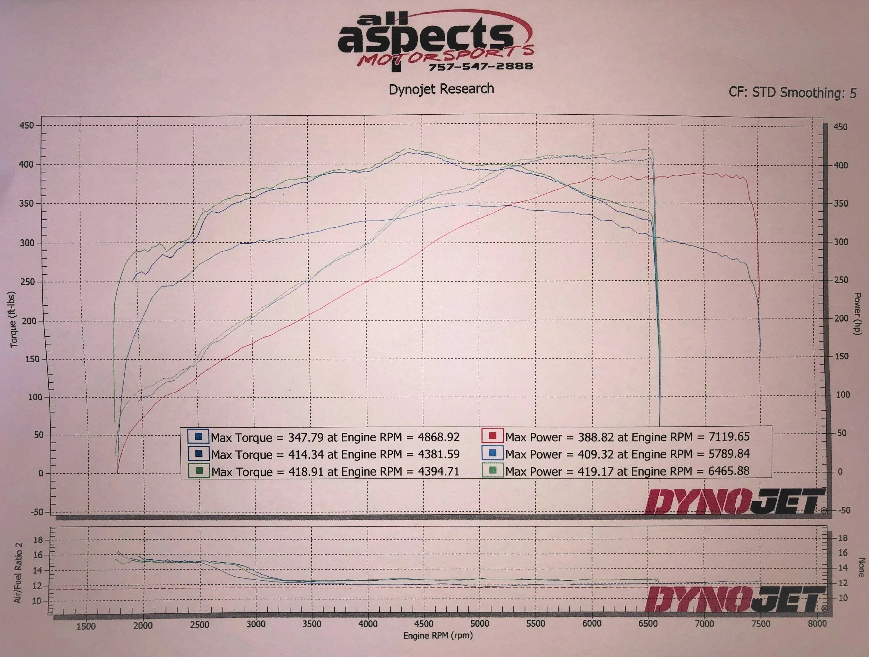

Now that I've found this thread, I'm posting a baseline in case y'all need one more...
2020 GT PP1, 6-speed, tested in 3rd and 4th gears.
Stock, shortly after the first oil change.
93 octane, on a May afternoon so the weather wasn't hot yet.
419hp and 418.9 ft-lbs
The first pull was in 3rd gear. The shop technicians first said my 1:1 gear was 5th, but when I told them "No, it's 4th for this model year", they accepted it and moved on. I can't remember why we did the first pull in 3rd.
3rd gear gave us a measurement of 388hp and 348 ft-lbs, and right away I blurted out that it sucked.
They did the next 2 tests in 4rd gear, at my request, and we got better results right away,
except that the car thought it was going 150mph or whatever and cut off the fun at 6500rpm.
The 3rd gear test was still good for showing that the "peak" power is really part of a plateau that runs from 6000rpm (or less) to redline.

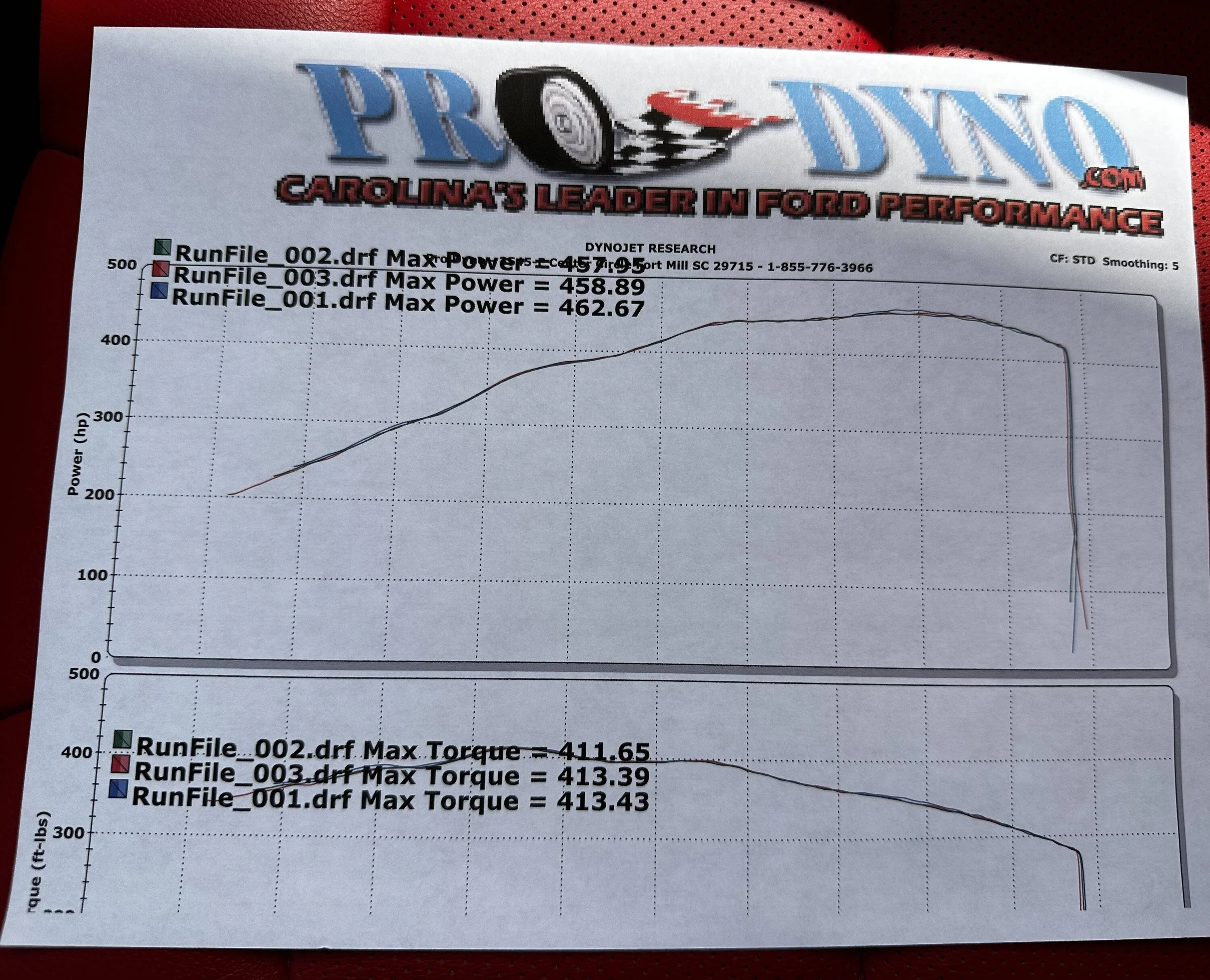

I don’t have same graph, but 2020 pp2 (mt82) jlt intake, roush Xpipe , lund 93

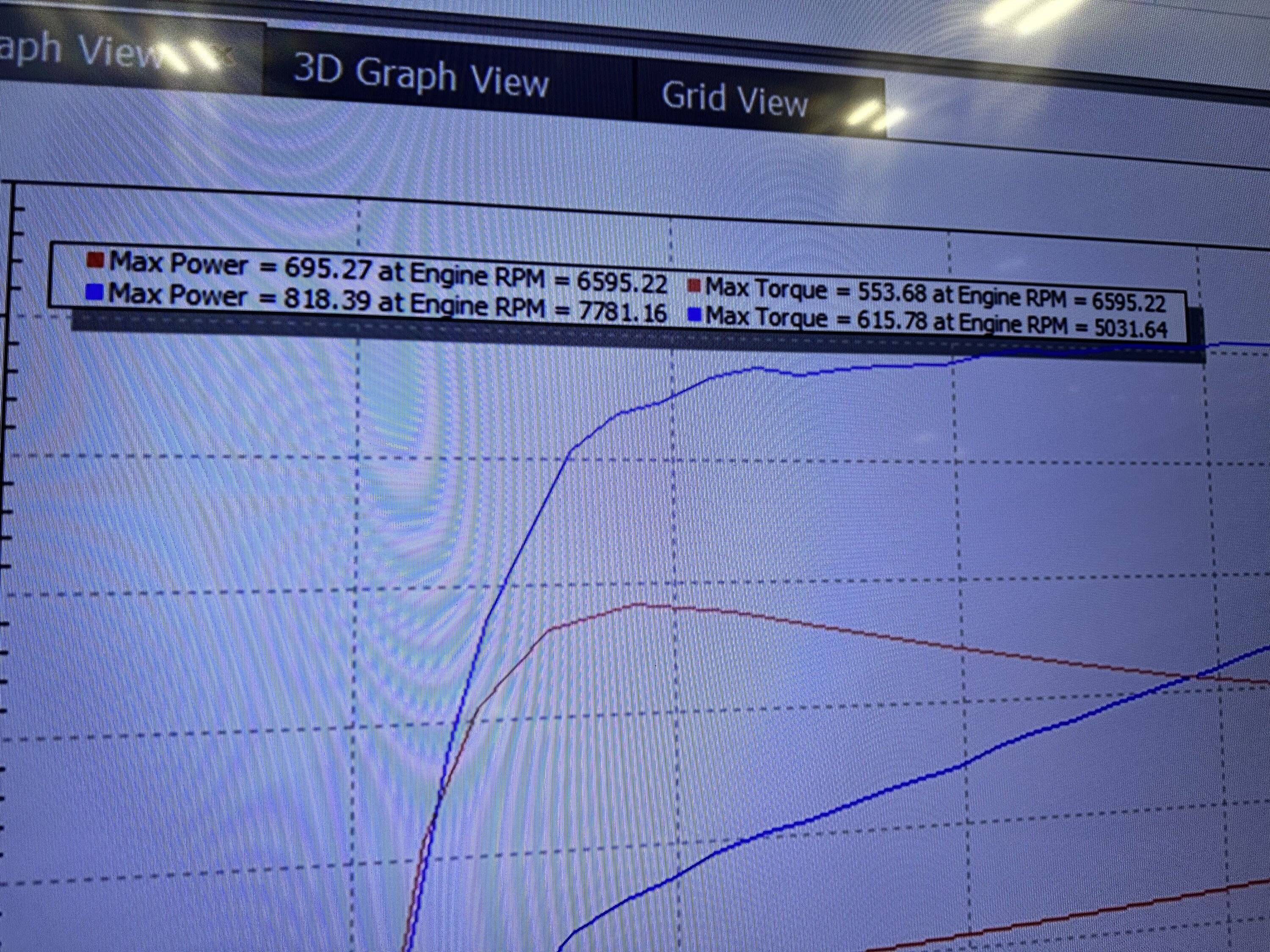

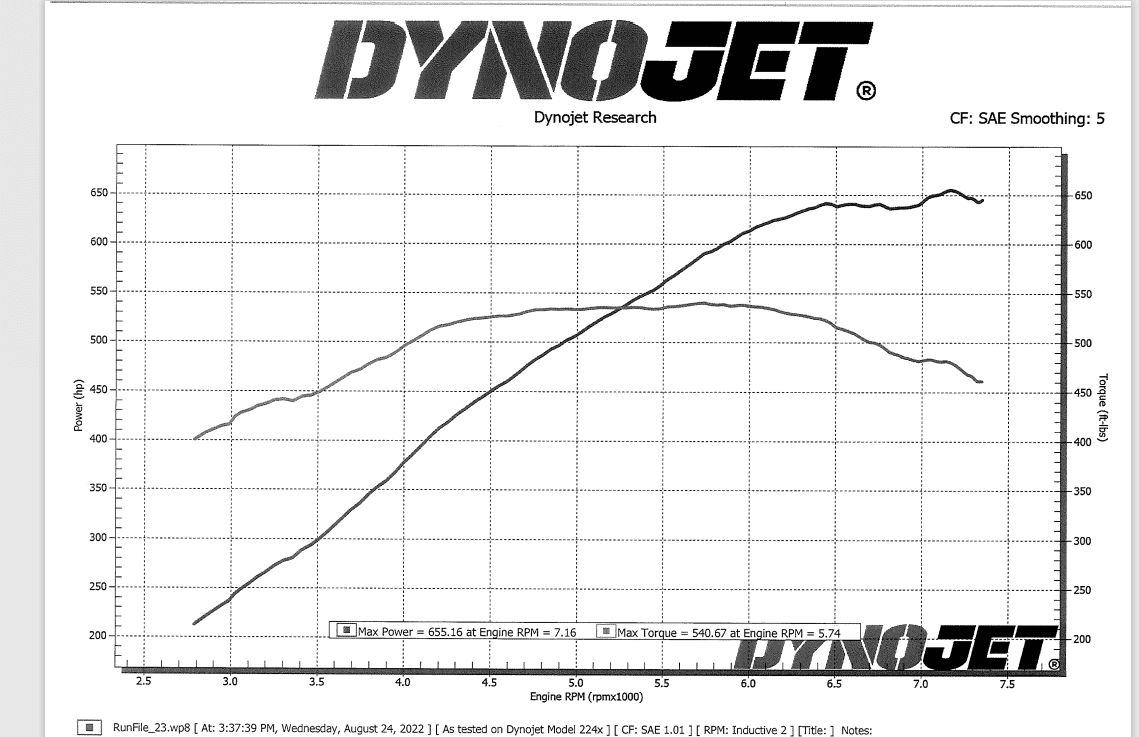

I suppose i'll repost my numbers since this thread seems to have come alive. Like the above poster numbers seem to be low compared to other whipple guys running similar setups.
Mods:
whipple stage 2
3.875 Pulley
132mm TB
Catless 2"LTH
Full CBE
Vortec BAP
Id1050
93 Lund tune
Yeah seems low but you are getting some serious knock up top looking at your graph. For reference I'm on the 3.7 pulley and seeing 10.5-11psi and did 690whp. Car trapped 138mph on that setting.

Exactly what it appears to be. I have been getting told from lund a couple other people that those are healthy numbers, others using octane boosters in their dynos etc, contrary to what i've been seeing from other similar setups. Honestly don't know if I should request a different tuner to look into the drop in power or take their word and live with the fact that I should be making more power than I am. Was your dyno done in SAE? Did you use boostane in your dyno run?

It was SAE and no boostane or anything. Car pulls hard all the way. No knock.
