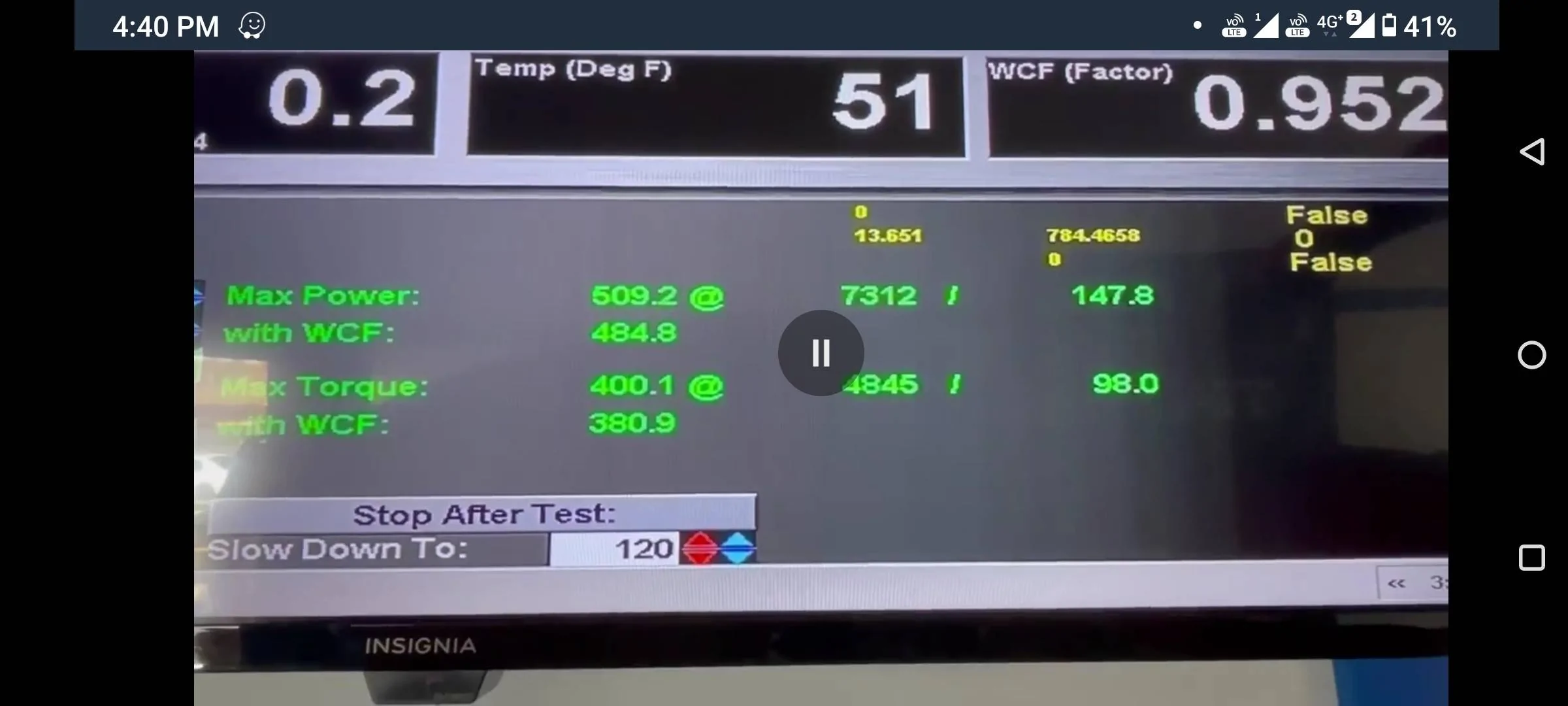

2015 GT PP1
Steeda proflow closed air intake
2018 manifold 1320 junkie ported IMRC intact
56lb injectors
Stainless works 1 7/8" LTH
Kooks green cats
Corsa sport cat back exhaust
Mantic flywheel and clutch
Calimer stage 3 MT82
Getting sheet from tuner
Video below
Mustang dyno
5th gear pull
93 octane
484 hp @ 7300 rpm
380 torque @ 4850 rpm
OPG & Crank sprocket coming soon, then boost.

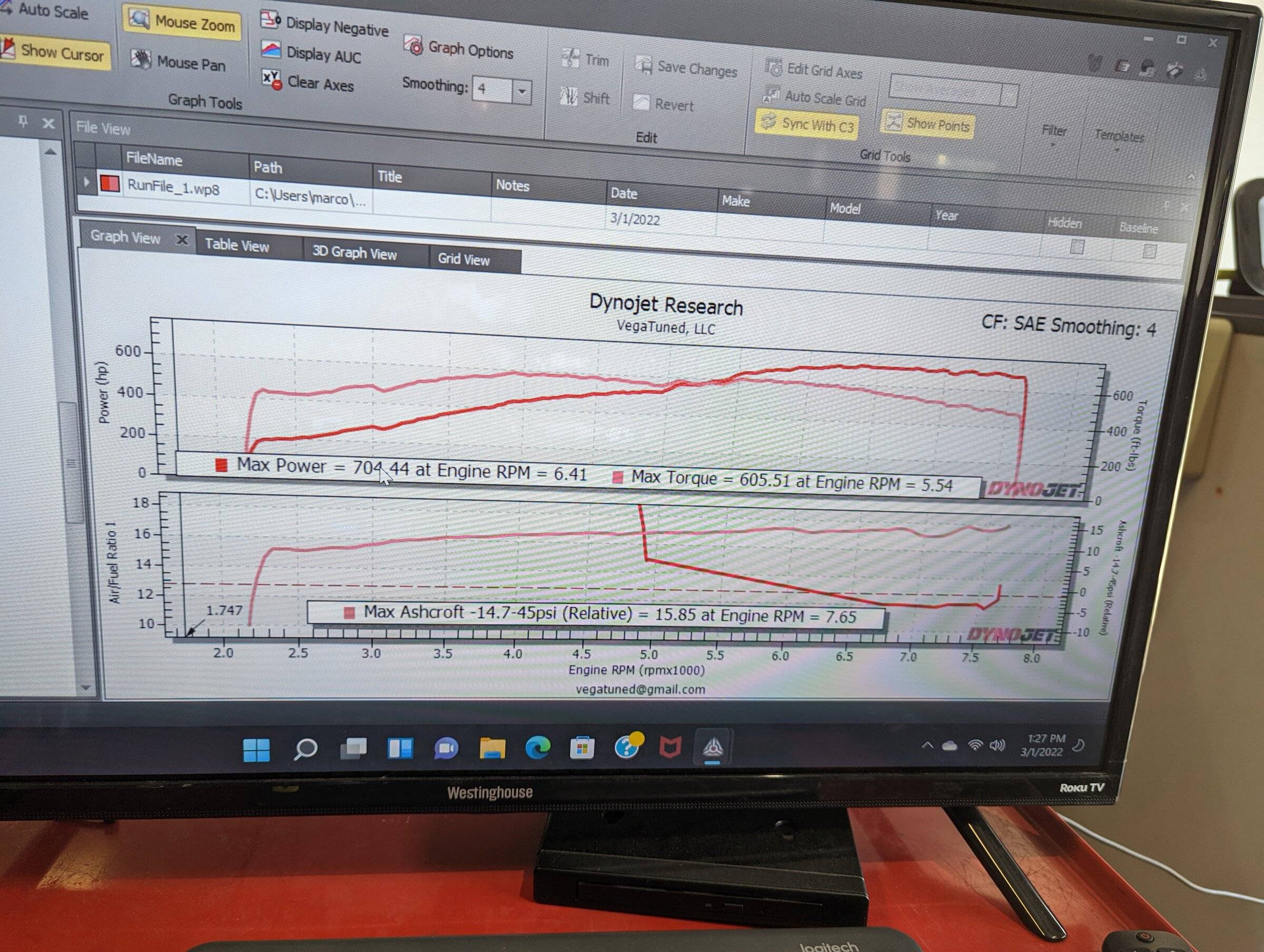

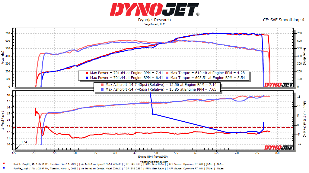

Shit I guess I'll put mine up here as well
EB 2650
LTH
103mm TB
3.15 Pulley
93 Octane + Meth
704 whp 605 tq SAE
eddy current dyno jet
Ignore the bad AFR trace on the "blue run", he didn't know my car had AE, and it literally only read a third of the run. The "red run" was the second one, with AE in track, interestingly enough there is pretty much no variance in the runs, we only waited 5 mins in between the two.

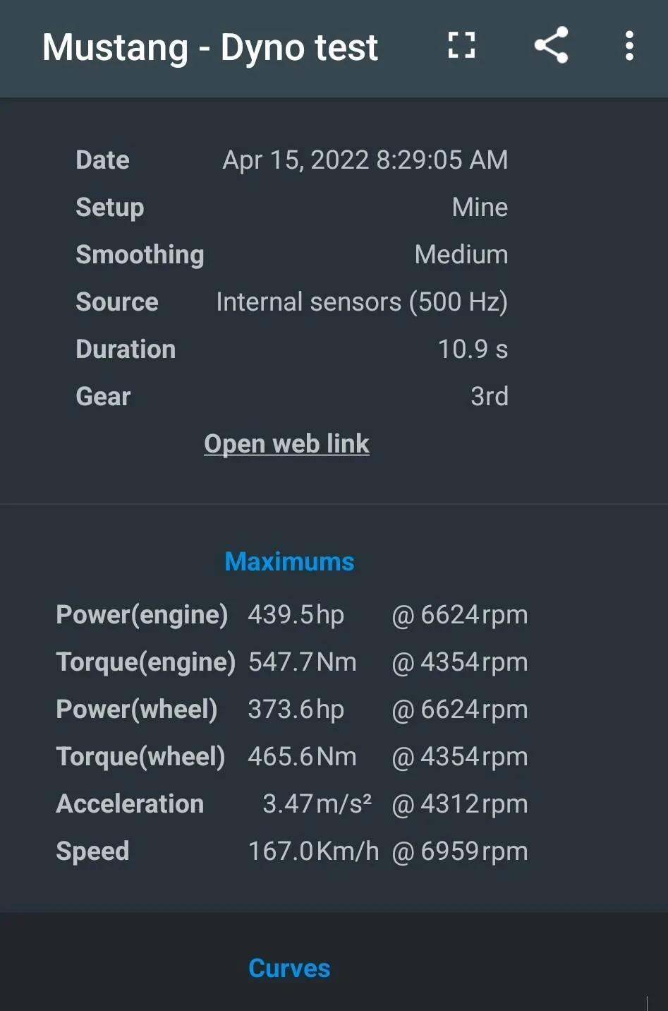

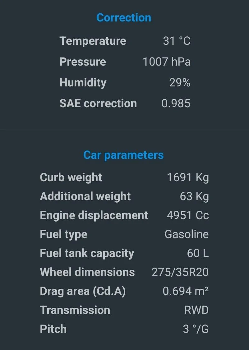

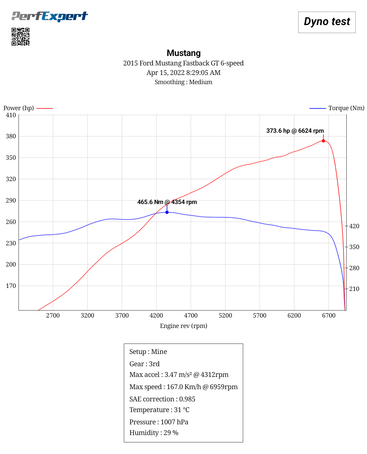

Volkan
Mustang GT 2015, Xterra
2015 GT 95k km
Roush Air intake and Roush exhaust kit
20" wheels
3rd gear
not sure if anyone tested Perfexpert app
people who used dyno and this app claims its within %1-3 range of the actual dyno

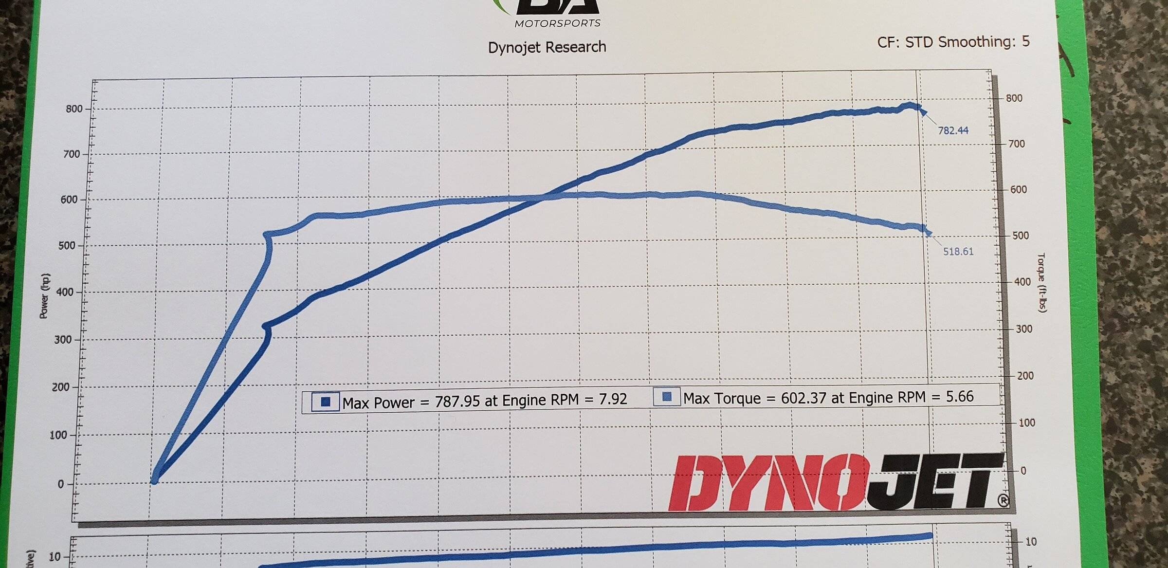

Car made 787 Whp on E85R tune
Whipple stage 2 Gen 5 3.0
1 7/8" Corsa Headers
Corsa X pipe
Corsa sports

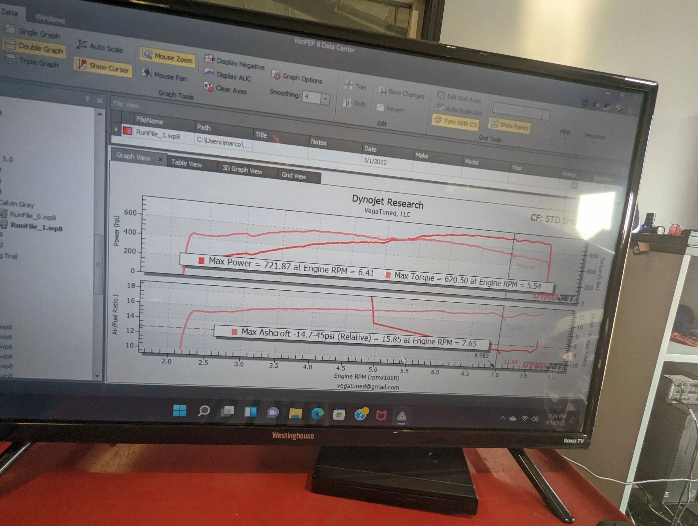

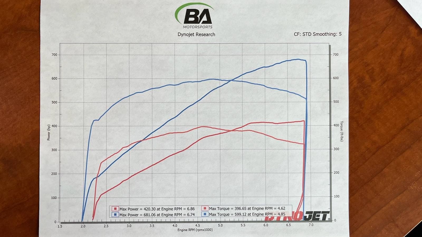

2021 GT, mt82, stock with Roush stage 2 & roush canned tune
Stock: 420rwhp/396 rwhp
After Roush install: 681 rwhp/599 rwtq

Those whipples throw down

lots of STD numbers, you guys didn't get SAE sheets?

I don't even have the car yet lol..I'm flying in to get it Monday. I can ask if they have the sae for that day. I know my numbers look a little high.
Edit: my best guess with conditions plugged into a calculator gives 666 rwhp

I'm guessing that's around what it would be, SAE numbers are definetly more reliable even though I got both myself. I'm from GA as well I know we don't dyno well in all this soup. I also see they didn't rev you out all the way as well. STD number on the base line is quite high abut if you look at the gain it's about right so kudos anyway.

The dyno was done in Cincinnati, I'm going to pick up the car Monday. So I just guessed at the numbers based on what the weather was like there yesterday. Yeah, the 'soup'lioe you said around here definitely doesn't help. The roush tune has a speed limiter that caps it at about 6800.
