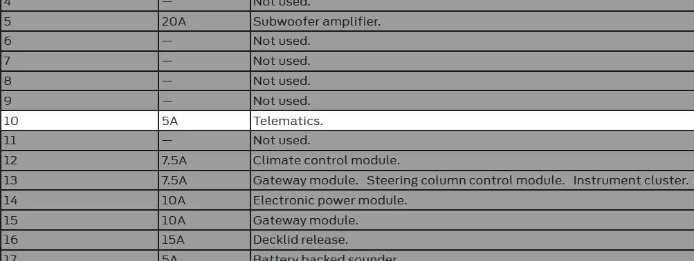

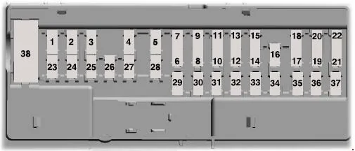

When I started researching this, one of the first things I did was search the fuse section of the owner's manual for "modem" and "4G"
I did not find those anywhere, but this one sounded interesting:
I wrote that down along with a few other suspect items, but when looking around at what they do, telematics turned out to be the winner.
I would imagine the fuse section in your manual will also show telematics, or at least lead you in the right direction. If all else fails, find a diagram like the one above showing the location of the TCU, grab that bastard and rip it out.

#8 - 5A - Embedded modem
:wink:
Thank you sir! I see that now in my manual. Going out to pull that fuse now.

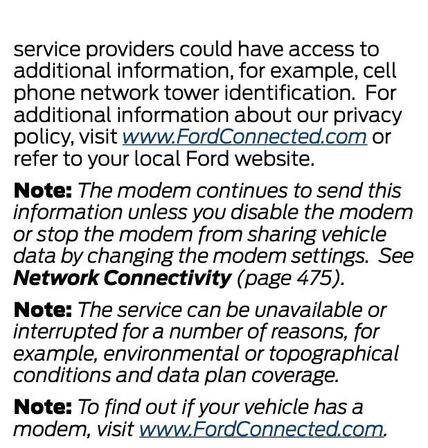

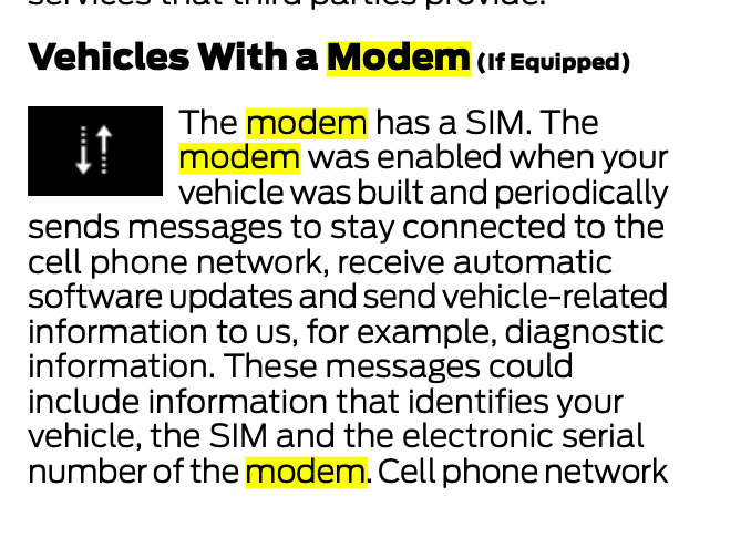

From page 12 & 13 of the owners manual... Notice it says it does send vehicle related info to Ford!! My dealer says it is black box recording data, GPS info, tire pressure info and even he is convinced he can see other changes such as from Forscan...
