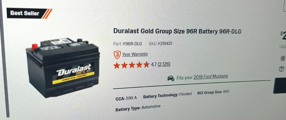

Also o see some said the duralast is a CCA 700. Is there a different gold than this one? This is 590
