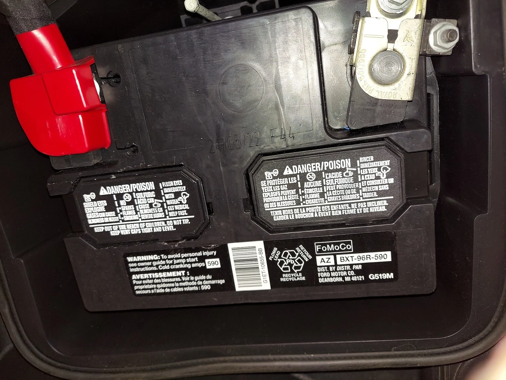

I recently swapped the one in my truck; it was $250. This for Duralast Gold, 710 CCA.
Attaching one document and one photo.
The document is battery case sizes. A battery's group number will be directly related to case size.
In the photo of a Mach 1 battery, see the PN#. In it is "96R" the case size, followed by CCA (590).
