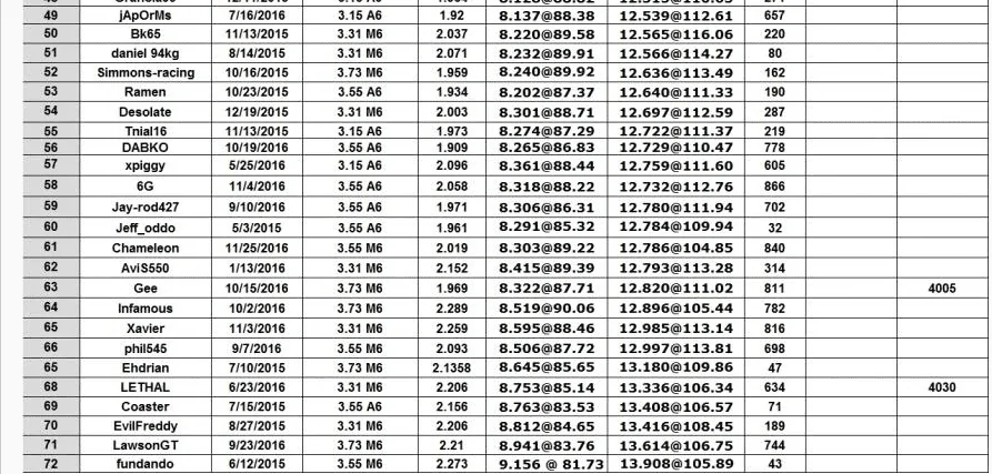

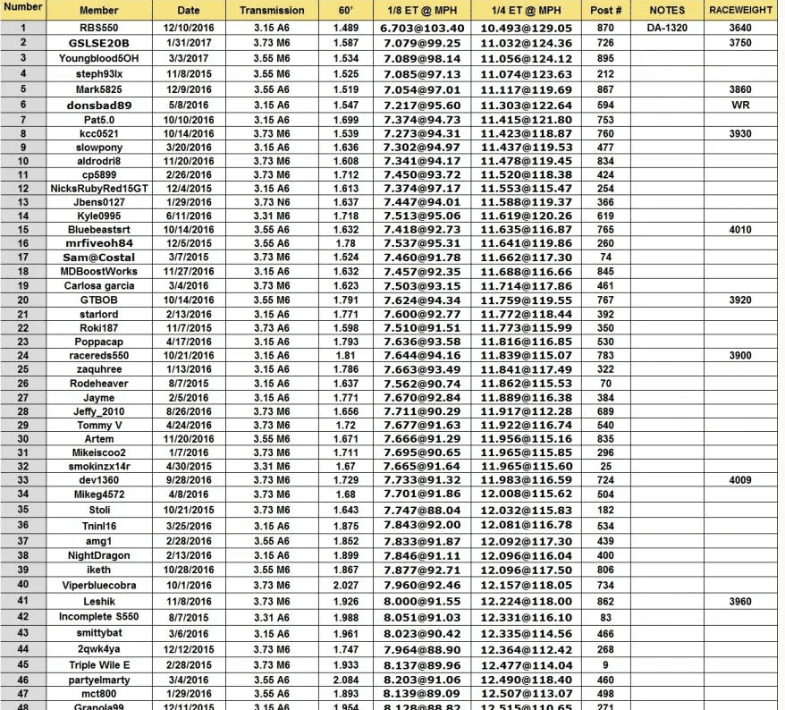

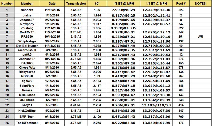

Well actually, kind of. If you go take a peek at the 1/4 leader board. All the top M6 are 3.73 in the stock & bolt-on categories, with some 3.55s as well. But once you get to the power adders you see for the M6 the 3.31 gears are the best option.
