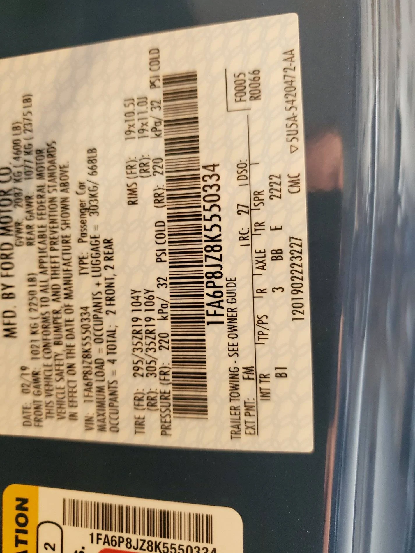

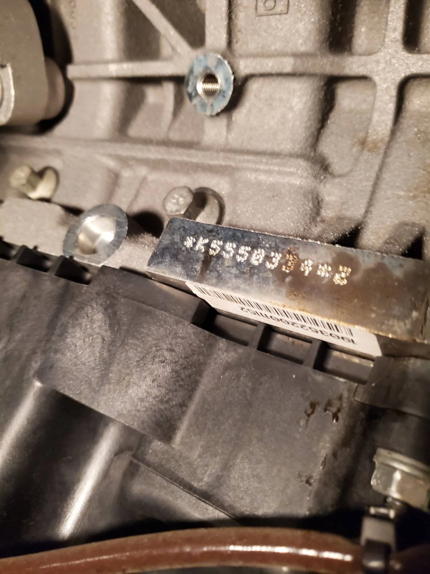

there’s a previous post here about having a numbers matching car? There is no Vin number on these engines to match and the only engines that did have the numbers was strictly for warranty purposes like my 66 GT350 and early bosses!
It's not the complete vin but last 8 are matching.
