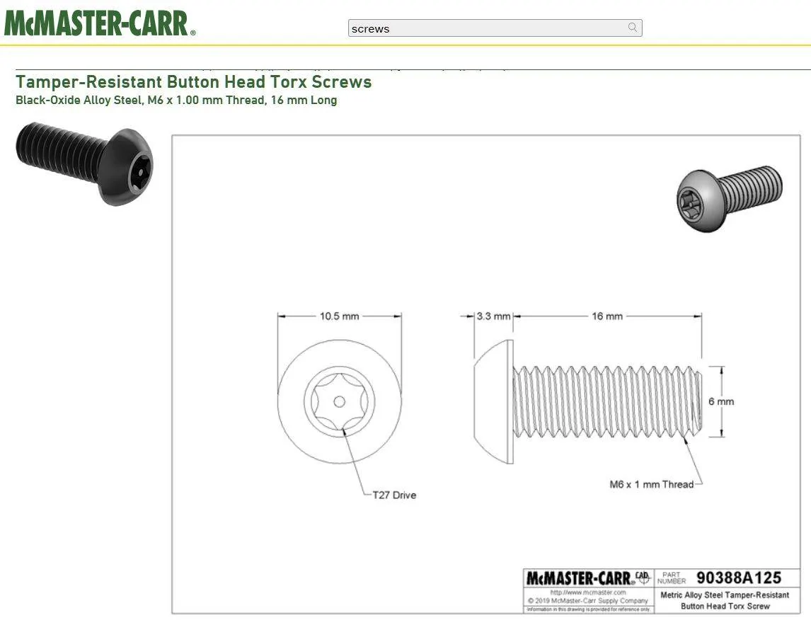

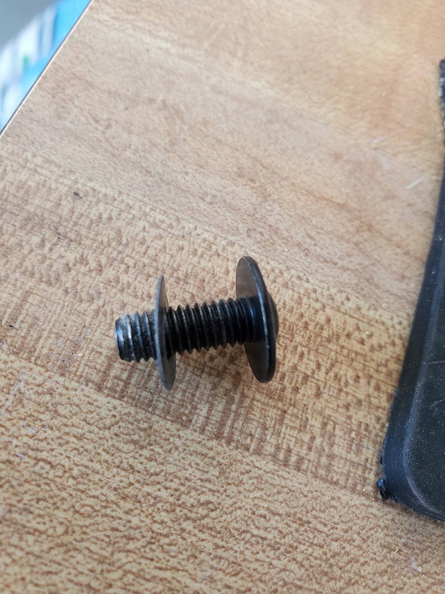

There has been mention of replacing the stock GF screws with a security-style screw. I cannot find a direct replacement screw with the exact same dimensions. My favorite resource is McMaster-Carr as they always use quality fasteners and they ship quick so I looked there and think I can put together something very close.
Just for the heck of it I'm going to order the following to closely mimic the factory fastener that will require a security tip to remove them. First up - the screw. I'm going to try an M6 x 1.0mm black oxide screw. I cannot find a 15mm UHL so I'm going to try 16mm. Note that the head is only 10.5mm. The plan is to use a washer to increase the surface area as well as reduce to OAL (overall length) down close to the OEM 15mm UHL.

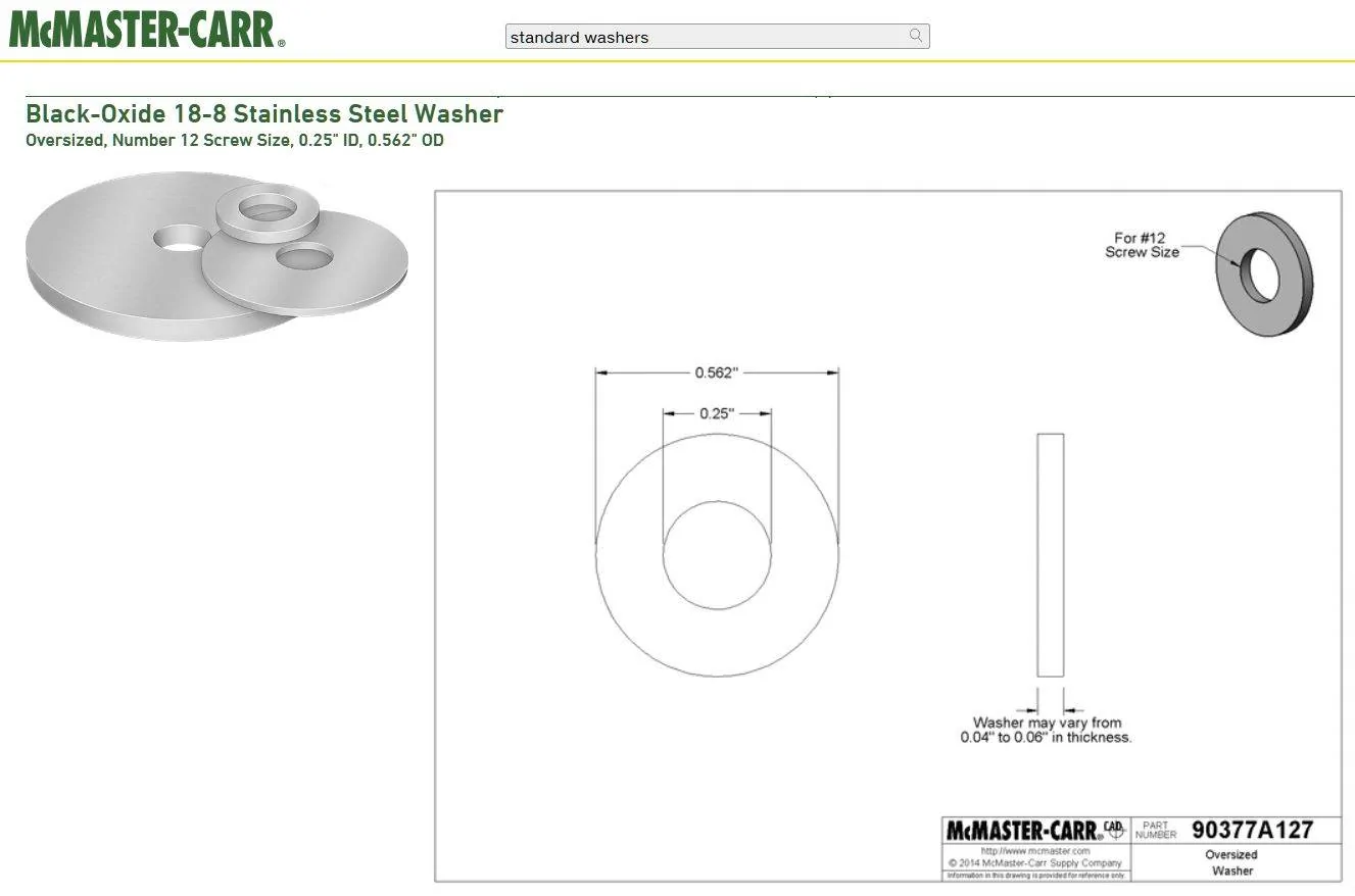

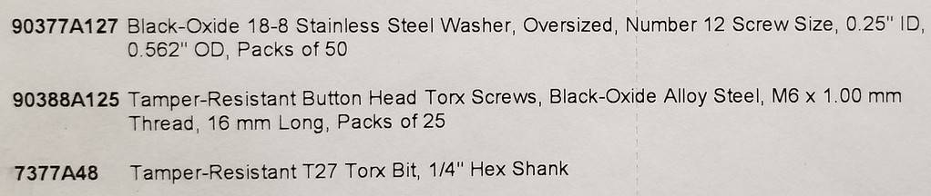

Since I can't find the proper metric washer I noticed a washer for a #12 screw should fit and when I looked through them I found a good match.
The OEM M6 fasteners have a nominal diameter of 6mm which equates to ~.236" and the washer below has a .250" ID. Perfect.
The outside diameter of the OEM fastener head is ~15mm or ~.591" and the washer below is .562" - close enough.
The washer below ranges from .04" to .06" thick. The 1mm I'm looking for (to effectively shorten the 16mm threads the screw up top uses) equals .039" which is close as well. So the washer used with the screw I listed would make give the fastener just under a 15mm UHL - again, perfect.

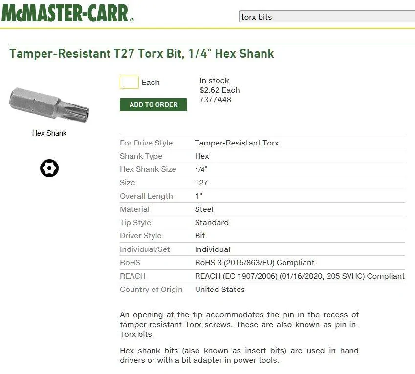

And finally, the screw I'm considering uses a tamper resistant T27 Torx drive. I'll pick up a few of these (because my tools like to grow legs and disappear forever).

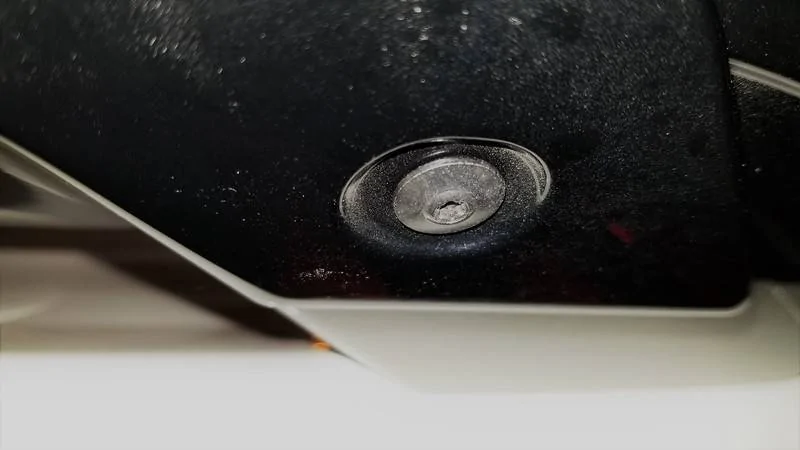

If you want to fully cover the opening in the spoiler, you will either need a flanged head or use a washer. Here are the ones that I bought.

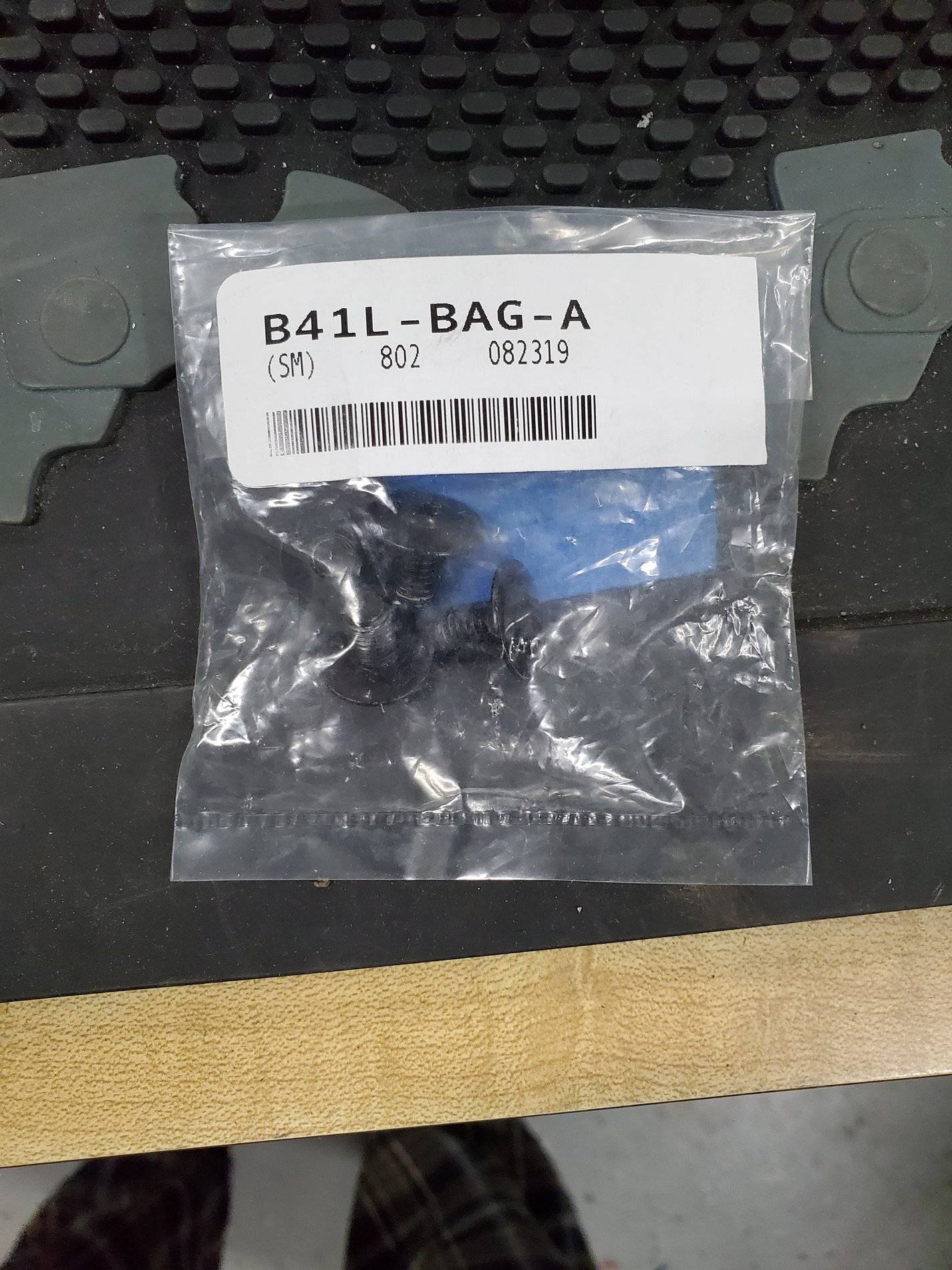

Maybe you can track down the needed screws using the info in the pic. This is the bag the long screws came in with my gurney flap. The part number on the bag doesn't come up during look up on ford parts though.

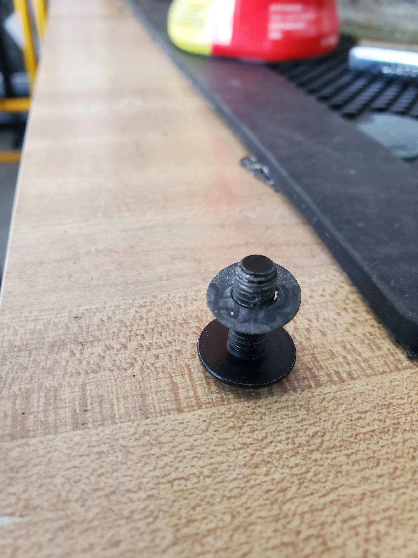

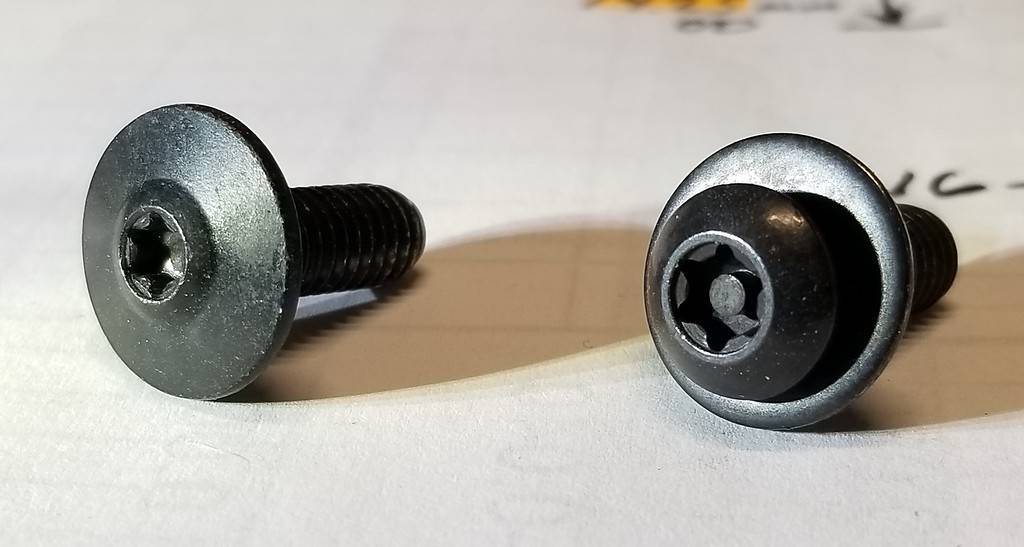

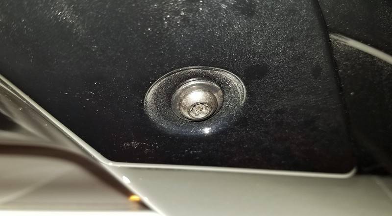

Got the hardware today from McMaster-Carr. Fitment was perfect. A quick video.
Note that near the end of the video when I show the security screw it is actually an internal hex drive/pin unit - there were two or three accidentally included in the box and that just happened to be the one I grabbed for a closeup. Rest assured, the part numbers I listed are for Torx drive fasteners such as in the following photo.
The data from the above video...
McMaster part numbers...
OEM in place...
McMaster...

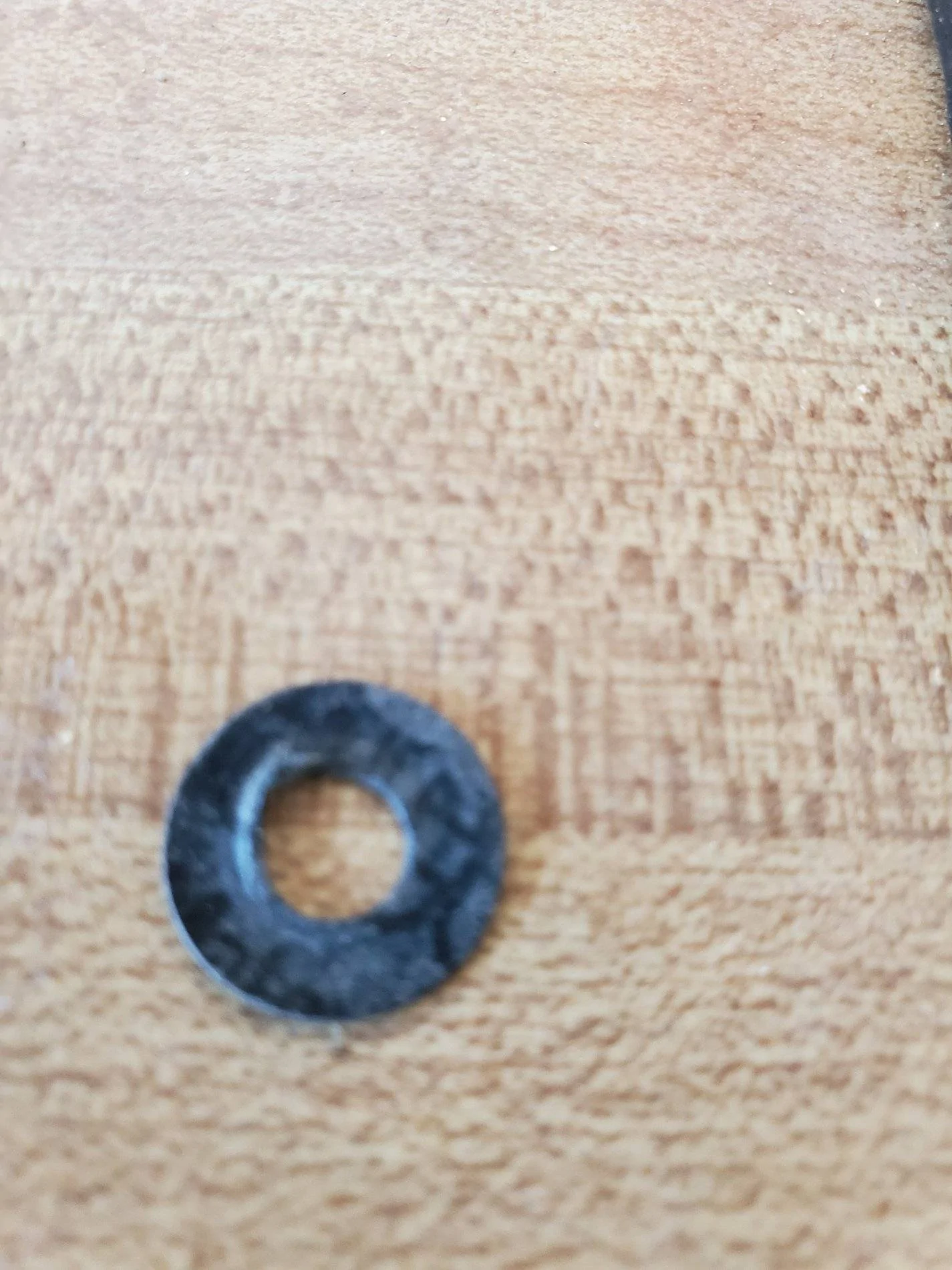

On another note, mine have a thin vinyl washer under the head. Not sure if others have that as well. I guess it is to keep from maring the gurney flap mating surface.
