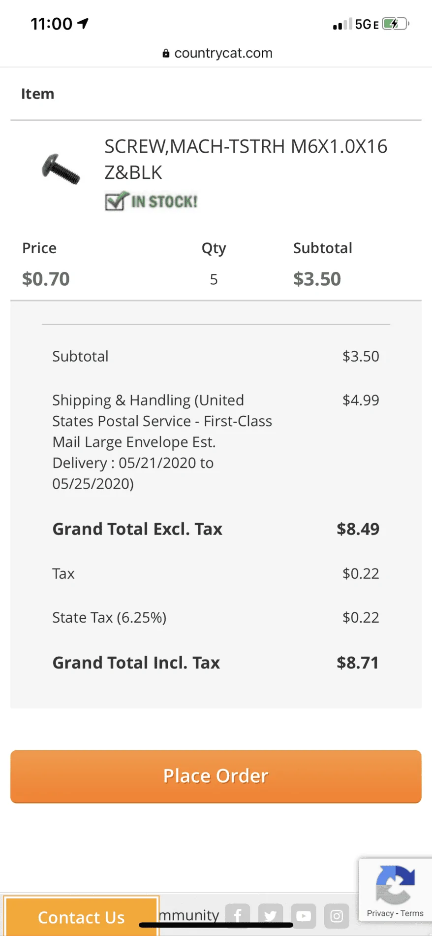

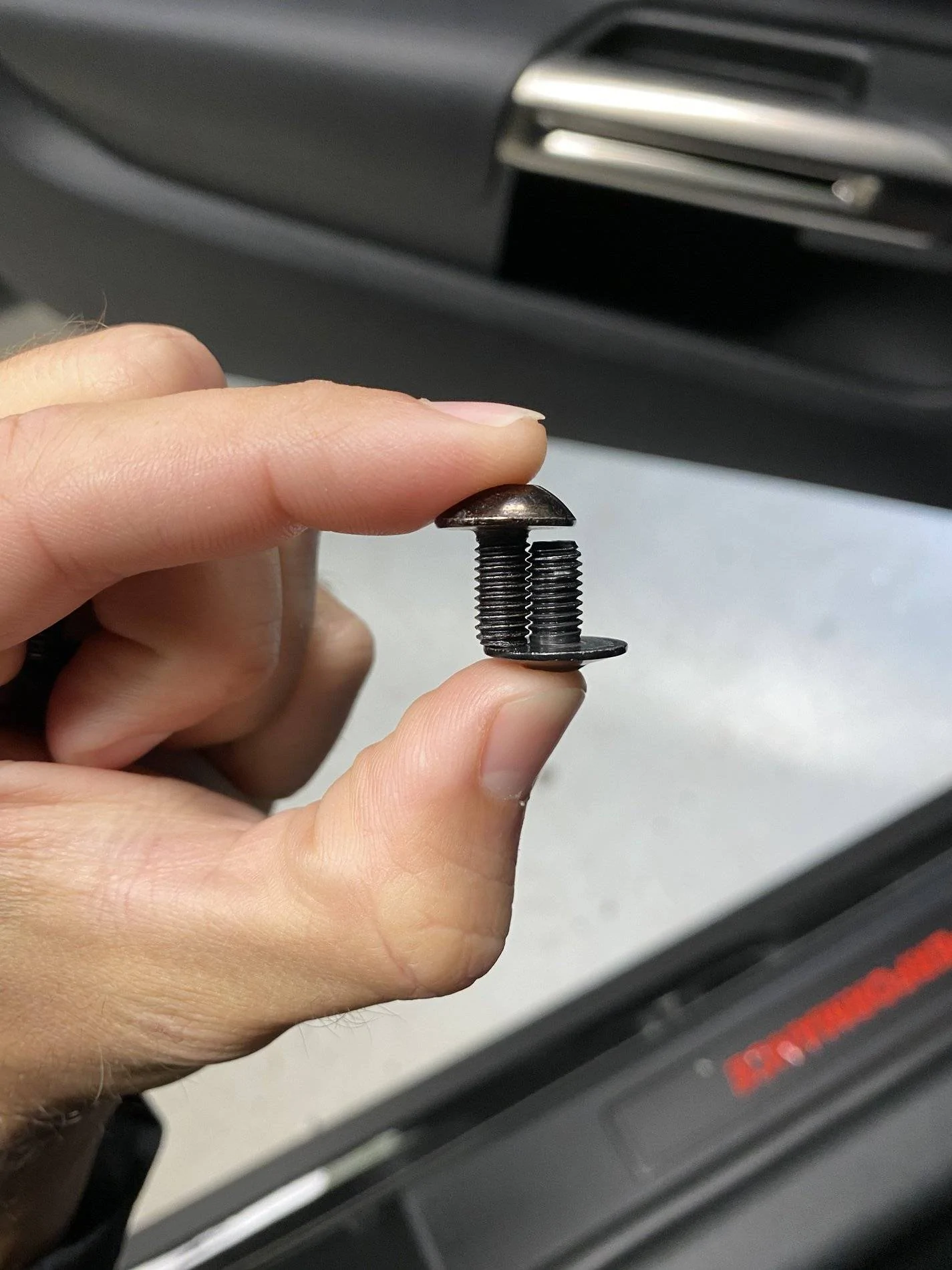

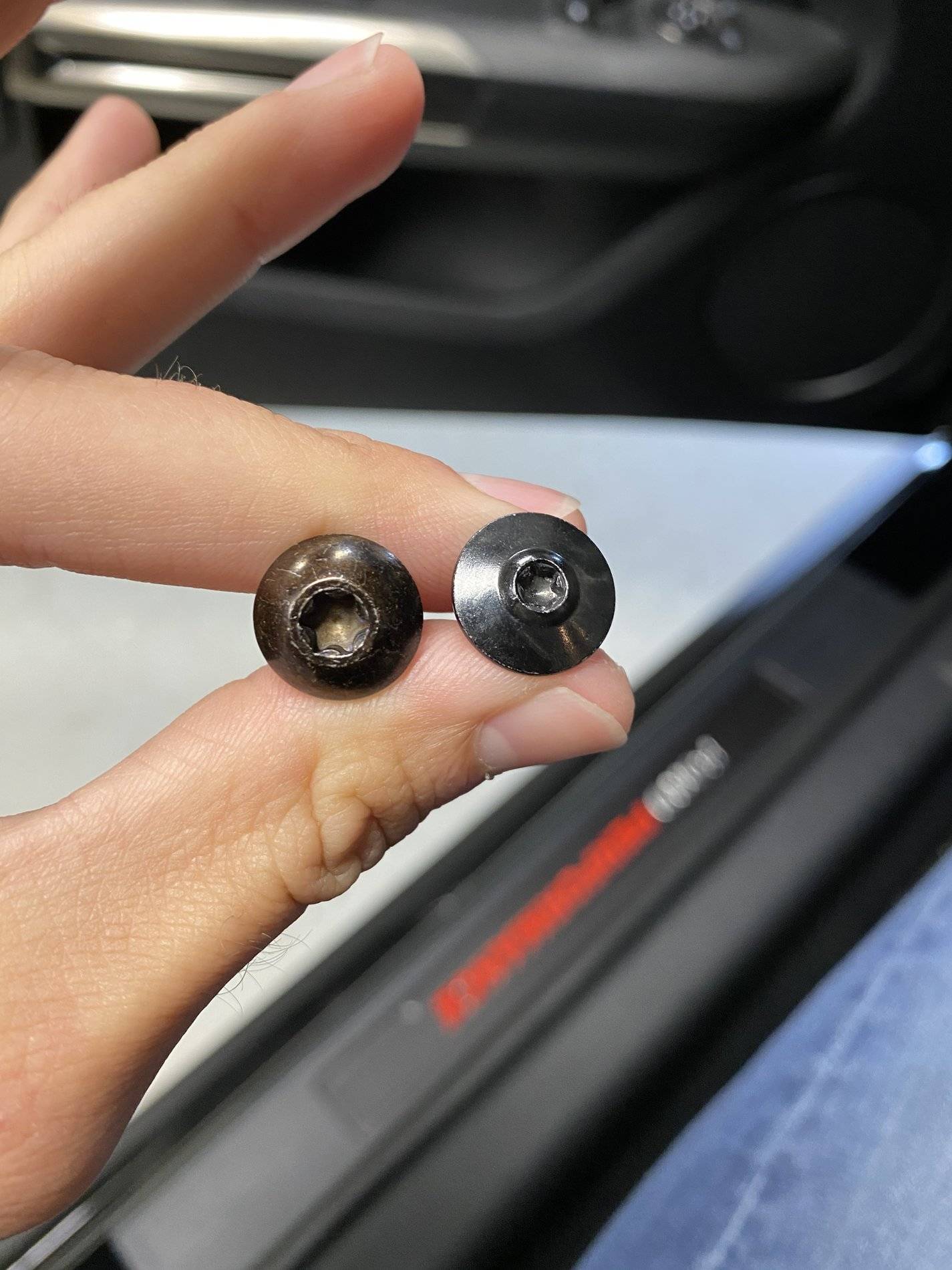

I bought this part: arctic cat 8477-616
I took a chance because it was a 16mm bolt, we’re supposed to have 15mm, and stock SWING screws are 10mm. However, as Epiphany pointed out, under head length is the only thing that matters. The 16mm bolts I bought turns out are only about 12.5mm under head.
Even though my ford dealer is still going to send me what they believe to be the correct screws once they aren’t back ordered, I think I’ll be staying with this solution for now. They feel very stout, look pretty close to original, and will hold the flap on during track days without a problem.
All that being said, the solution Epiphany laid out is likely better.

Yup, head width is roughly the same so no washer required.
If I get a part number of any kind I’ll be sure to post it here, but it won’t be a ford part number. Ford dealer said after extensive research they were unable to locate these screws from Ford Corporate or Ford Performance. Allegedly, the fastener company my dealership works with for all of their in-shop supplies was able to find the screw we need in a paper catalog. However, that screw is currently backordered, which makes me wonder if that’s the reason so many of us got the incorrect screws to begin with....

Funny... I also ordered mine from country cat, and I ordered 5 :)
You’ll be happy, they’re heavy duty screws. I also like that it uses a T-30 instead of a t-20
