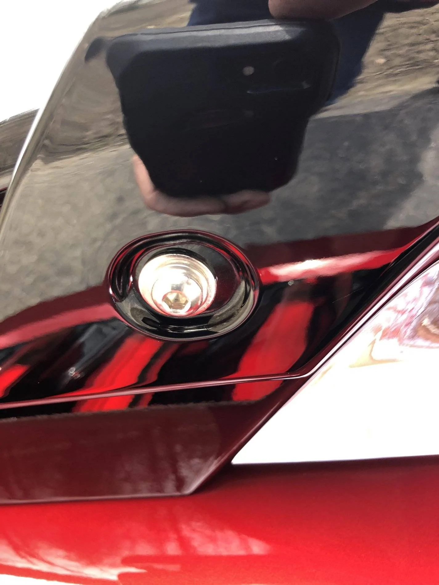

So, after some digging, I found two possible solutions to this dilemma:
1) This one is black, but hex and not Torx. The head is slightly thicker and slightly smaller in diameter than the OE fastener, but it fits just fine and looks OK on the car. It is also not as shiny as the OE fastener, but some gloss black spray paint would probably take care of that if you were concerned about it. https://www.belmetric.com/6mm-butto...p-13485.html?zenid=ndh9is4vnv7ufui5ct99fglp85
Note that for anyone missing the Gurney Flap screws, a 10mm long version is also available from this source.
2) This fastener is stainless and not black, but it is Torx. Head is also slightly thicker and slightly smaller in diameter. https://www.belmetric.com/6mm-torx-...p-15760.html?zenid=ndh9is4vnv7ufui5ct99fglp85
Still disappointed that Ford decided to tool up a specialty fastener and then not make it available when it's visible on the outside of the car, but I suppose I can live with #1 for now.
