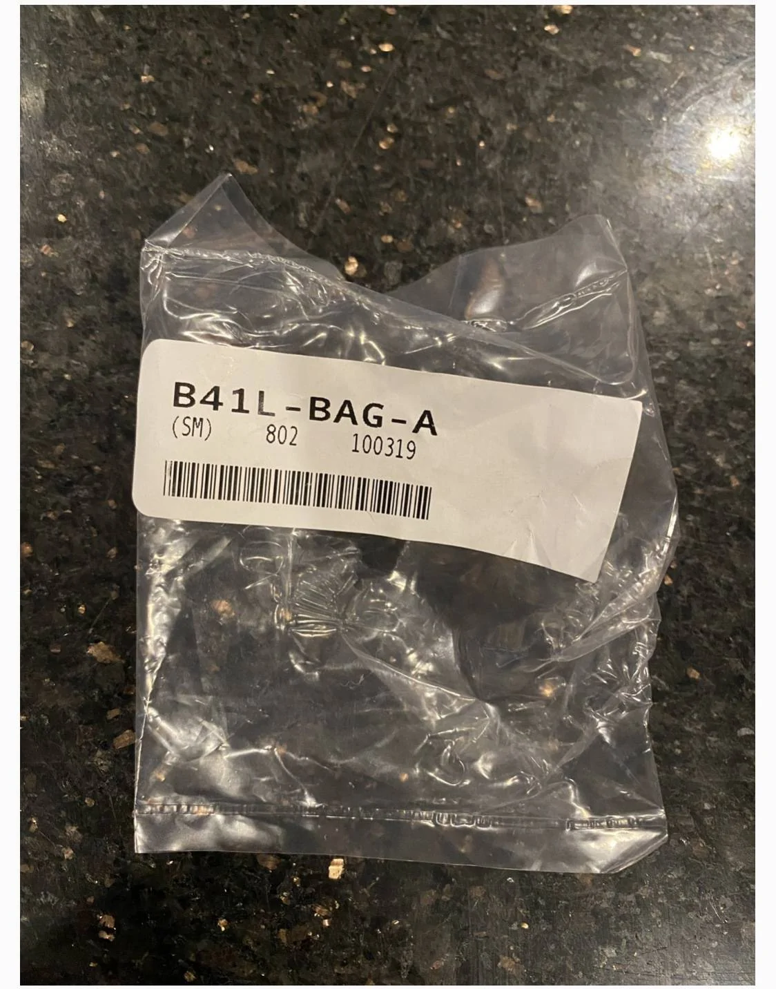

Not sure if that bag includes the shorter screws but maybe they can be cut down?

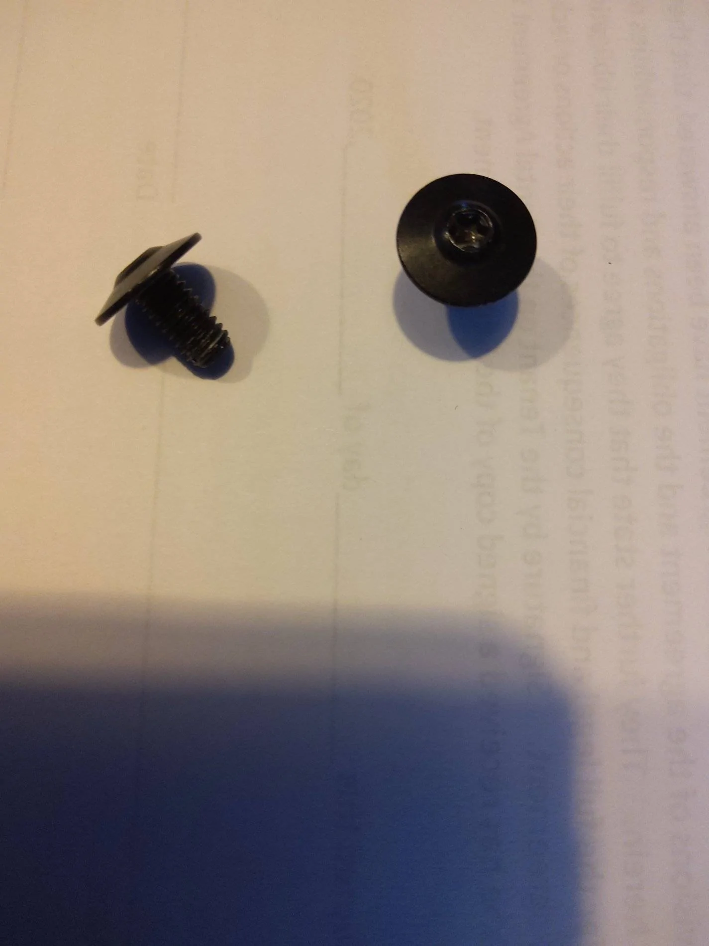

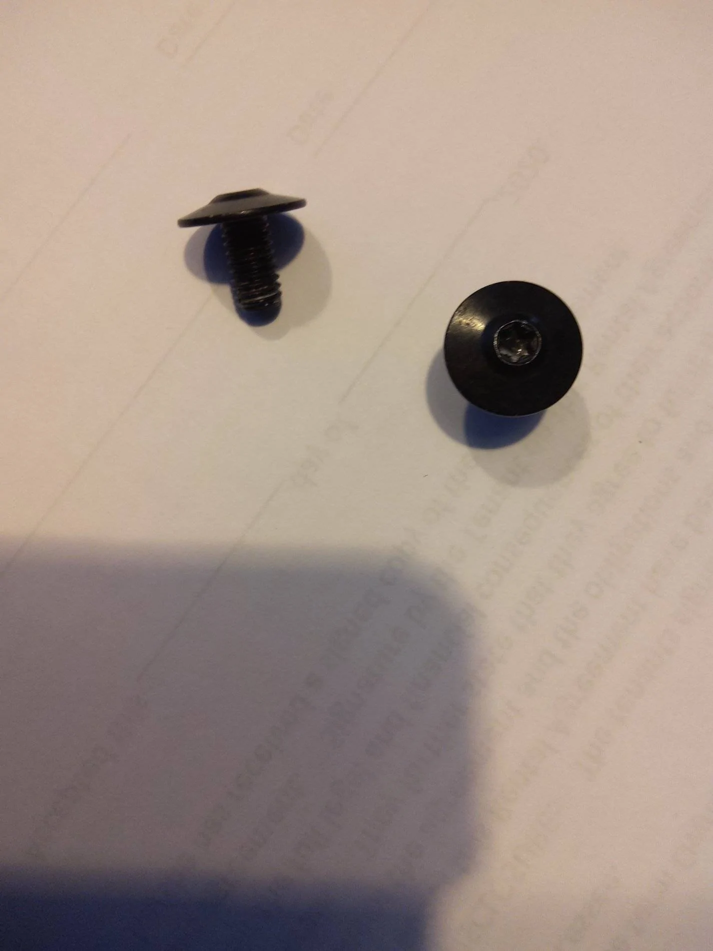

They are M6, The head is 14mm and the length is 10mm if my eyes are seeing things right, (old eyes) T20 torx. Pics of my originals

I confirmed today (as was confirmed above) that they are M6. I would gladly pay for some in Gurney flap (10mm) and OE (5-7mm???) Length. Black is awesome but if not I would paint them.
PS: Thanks guys for the pics and other info! Appreciated!

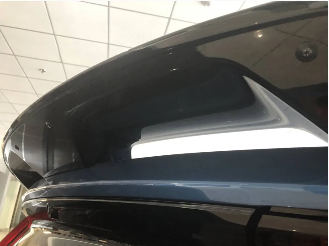

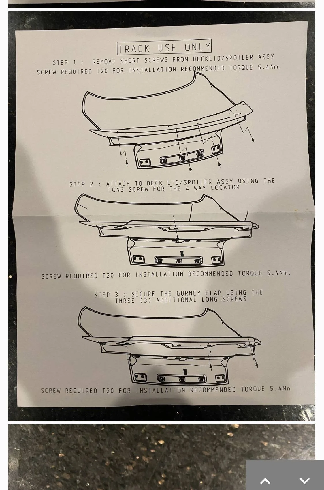

I have a ‘19, and my original screws are the same length as the ones in the gurney flap pack (even though the instructions say they’re longer.) I wonder if some dealerships discarded originals screws because they were identical and figured there was no point in keeping both sets.
The ones that came with the ‘19 gurney flap fit perfectly inside the Swing without installing the gurney flap and don’t protrude at all.
