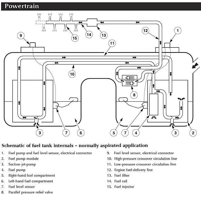

Have only had one issue, I ran out of gas...the gas gauge said almost 1/2 full one second and the next it said I had 5 miles to find a gas station or gun out of gas...I was 25 miles from the nearest station and in the middle of the desert, yes, I ran out of gas. The Ford road side assistance is great, although I did have to wait for almost 2 hours in 95 degree weather. I got to the gas station and filled up to find out it would only take 9 gallons. Took it in to the Ford dealer and they diagnosed the fuel transfer module as the issue...yes, the Mustang has saddle tanks, 2 of them, and the fuel is transferred. Other than that have had no issues or weird noises. I do have active exhaust and just removed the 30+ pound resonator with the FPP X pipe. I love the new sound!!!

The Mustang has 2 tanks...? What’s the purpose?

It's just ONE fuel tank, but in the form of a saddle (for packaging reasons), so the fuel of one side needs to get transferred to the other, where the fuel pump is. I used to have another car like that, but forgot which one. Ha ha. Maybe the Nissan GTR?

Here is a general diagram of the saddle tank, although the Mustang is slightly more complicated.
