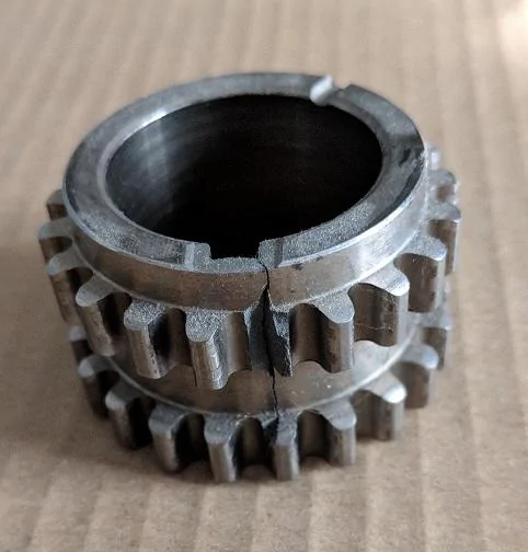

we have a couple cases of engines we've fixed with broken opgs, i personally have broken a couple sprockets before the billet were available

CS is the primary weakness in the 15 and up, OPGs just make sense to knock out if you’re in there but those are weak too. We’ve personally seen 15+ CS’s damaged on N/A cars who road race and or drag race. F/I it’s a no brainer, especially on Superchargers with the extra strain on the crank. Which cars are running 9’s without them? And how many? Don’t discount not needing them based off less than 1% of the cars when these breaking is a normal thing.

I cracked my sprocket in my 2012, luckily I caught it before things got ugly. If pushing things hard the cost outweighs the risk to me.
exactly,
it's all good and dandy until your the one with the broke block
