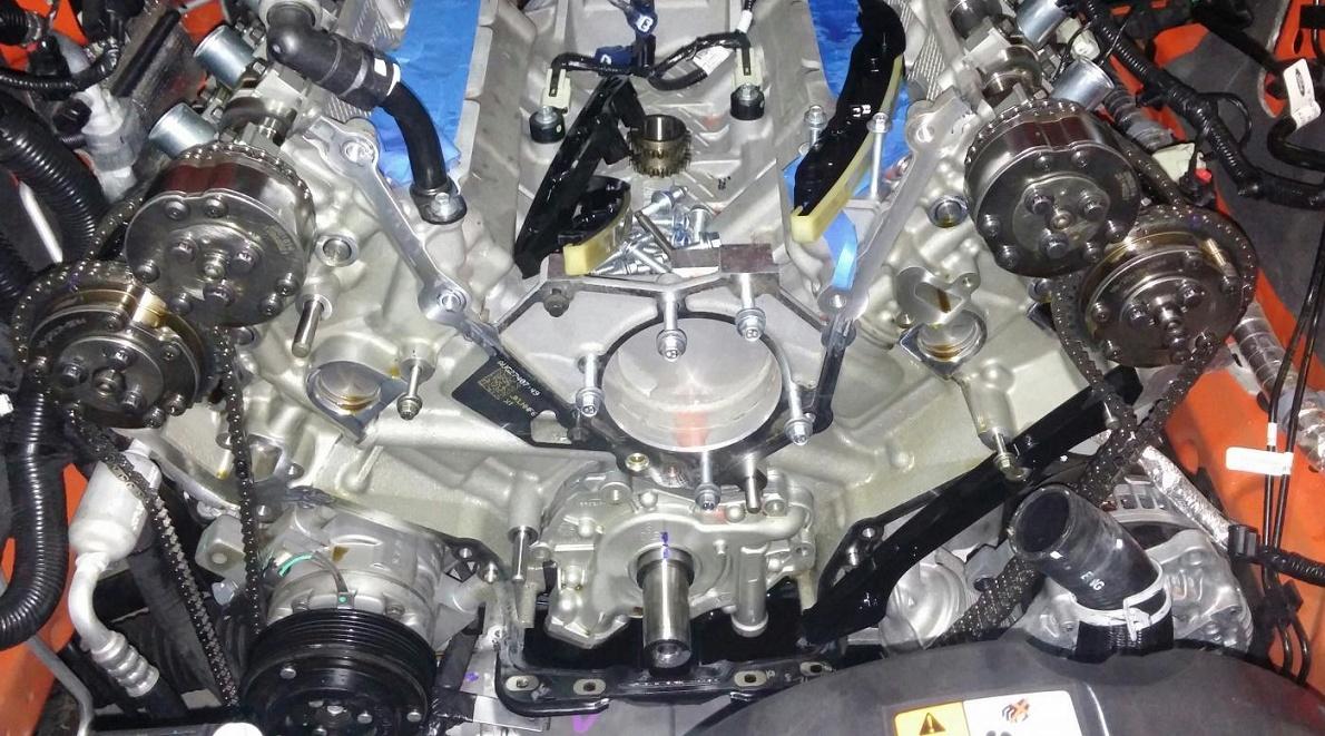

Has a billet oil pump gear ever suffered a failure like the stock ones, or have they been a 100% solid solution so far?

Now that the blowers have been running on these cars for a few months, I was curious as to if there have been many failures of the OPG's??
I guess what deters me in replacing is removing the front covers/chains.....
What kind of HP are the stock gears currently holding up to with FI?

if your not getting crazy on redline or power, you should be ok
