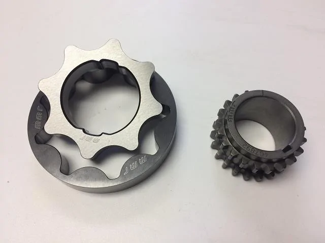

The procedure for installation is similar to that of the 2011-2017, with the exception of the oil pan, because the pick up tube is built into the pan (similar to GT350 oil pan) it is difficult to get the pump out, anyone who is attempting to install themself however should be prepared to remove the oil pan.
For those looking we have a great deal on our Billet gear combo for the 2018 here:

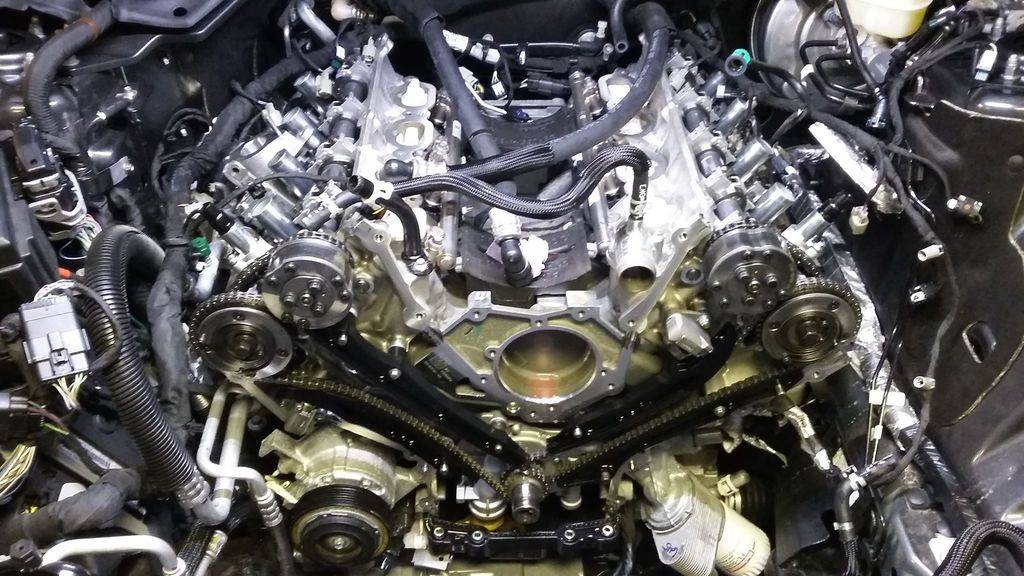

Which means pulling up the engine and lowering the front cradle assembly.

There's 2 important things to know about doing the OPG's on the 2018 that differs from the 2015-2017 cars.

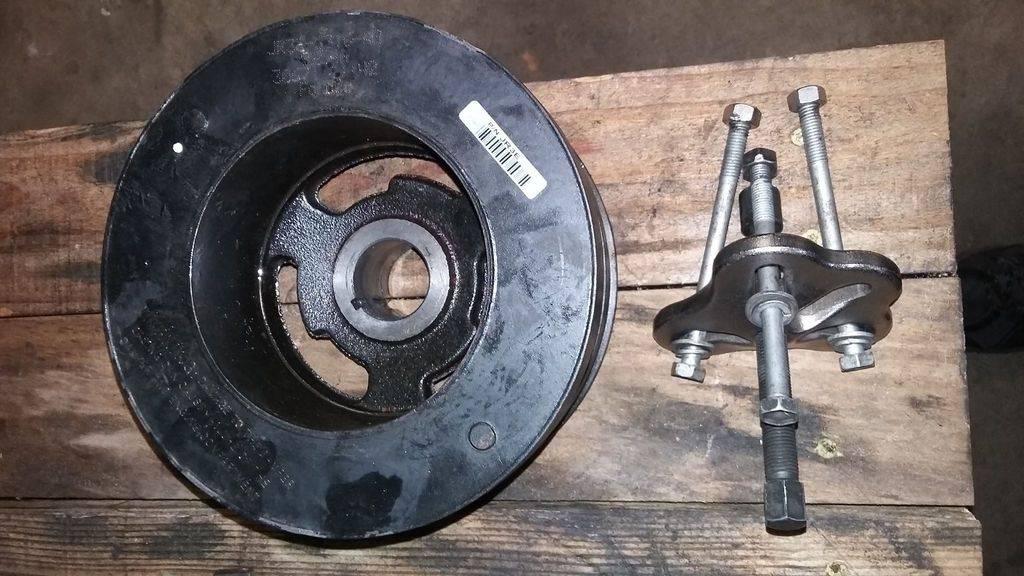

1. The traditional balancer puller tool doesn't work the same on the 18 as it does on the 15-17 cars. We had to mock up a special tool to remove the balancer on the 18.
2. The K-member needs to be lowered to drop the oil pan enough to loosen up the pickup as it's similar to the one used on the Gt350 where it's actually attached to the pan.

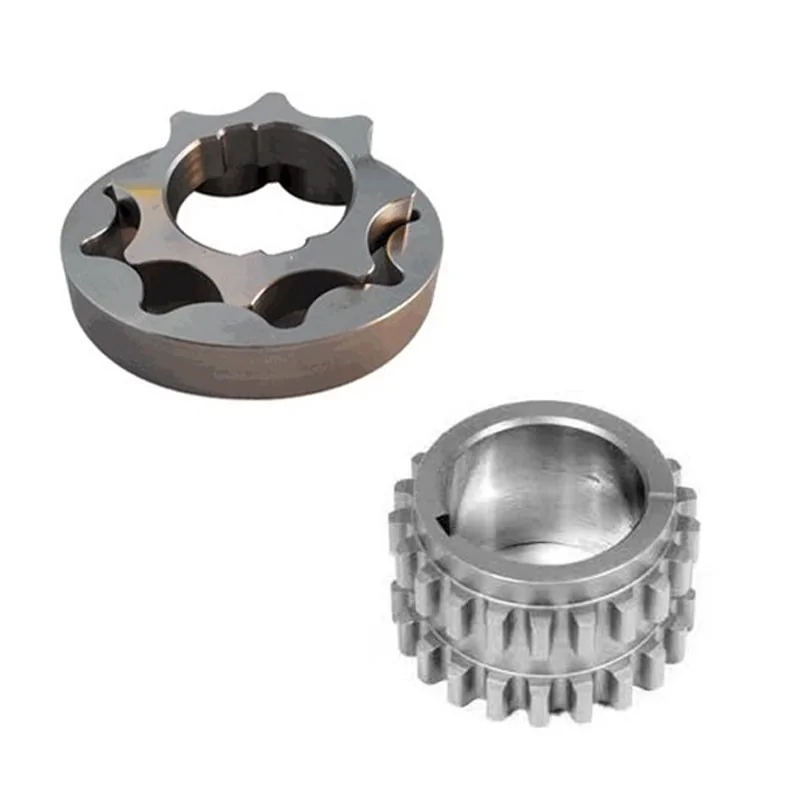

Other than that you're good to go. We've got plenty of Boundary and MMR combo's in stock. Give us a shout if you have any questions.
Thanks!
https://www.lethalperformance.com/b...l-pump-gears-and-camshaft-sprocket-combo.html
https://www.lethalperformance.com/m...5-2018-mustang-gt-2015-2018-shelby-gt350.html
