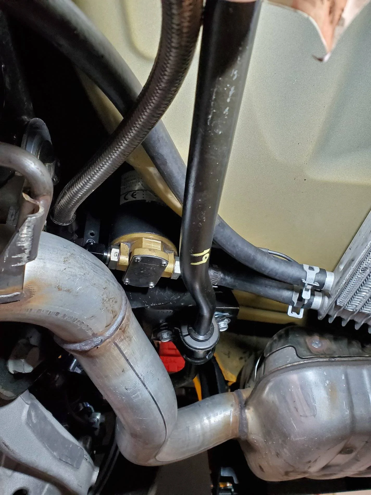

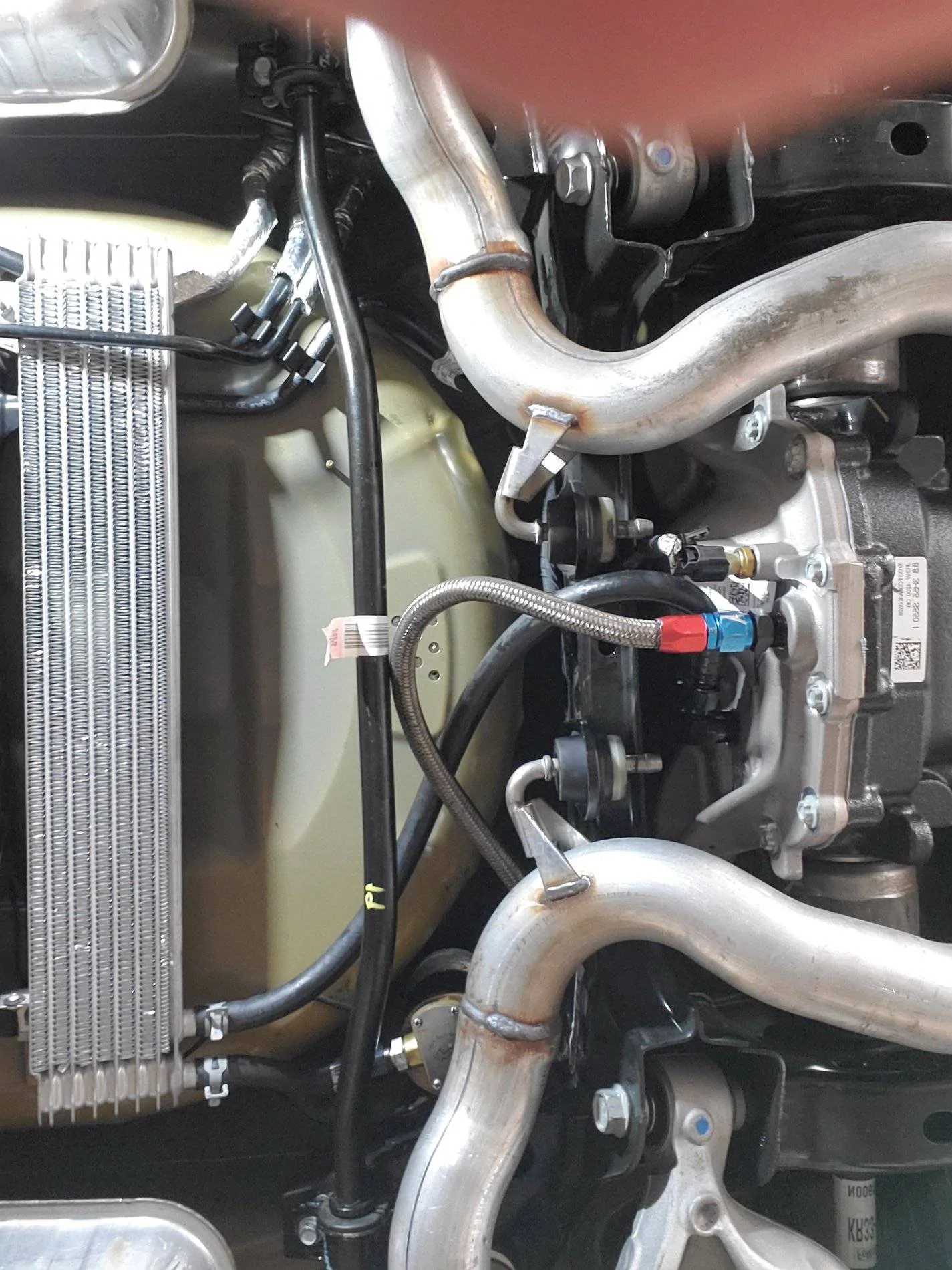

Why not have a real diff cooler? It isn't that hard. I did not even have to plumb into the spare tire well. I repurposed the oe a10 trans cooler. I could have gone much more extreme too.

What is your temperature drop with that setup?

No clue! Light does not come on=win.

Is there a fan on your diff cooler or it's just passive? Looks like it's passive
Vorschlag did testing with passive cooling and with a fan, and Terry determined he needed the fan, . That setup looks passive, it's pretty slick and I bet it works for HPDE at most of our levels.

is that a street driven car too? seems like if your not running the pump all the fluid would drain out of the cooler and into the diff (causing more losses), but its hard to tell how far the return line is up on the diff.

I DD my FTBR diff cooler with pump off and no issues after 1000 miles including towing my trailer to/from the track.
Max temp I see at track is around 220f with pump and fan on. but I’m still not fully pouring the coals to her due to coolant and engine oil temps shutting down the fun early.
interested to see max diff temps once I can fully wring it’s neck.
overall pleased with the kit, but the diff R&i is a bitch on jacks
