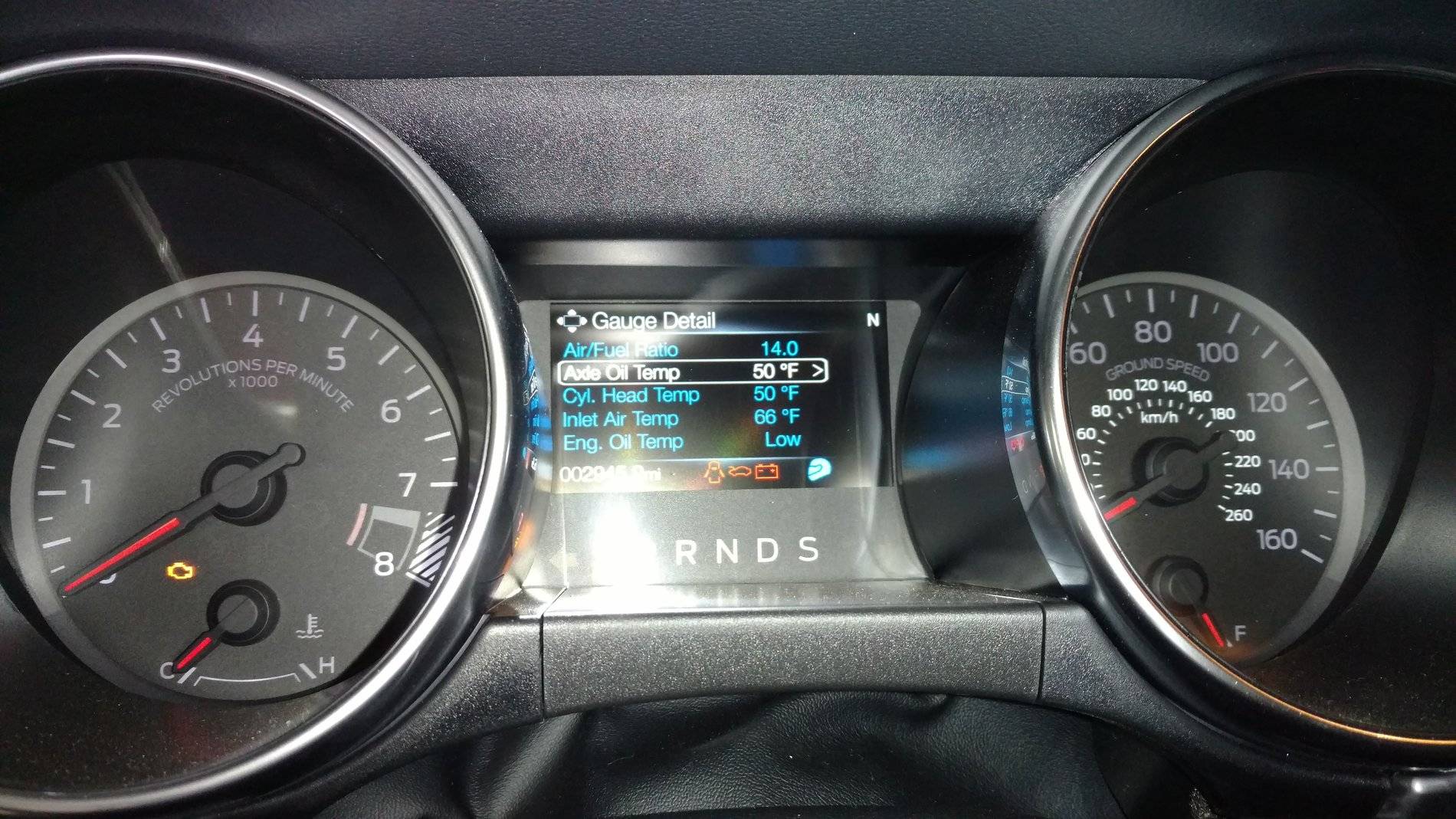

My Dash has a read out:

2015-17 do not have the gauge. We need Forscan to read the temps.
