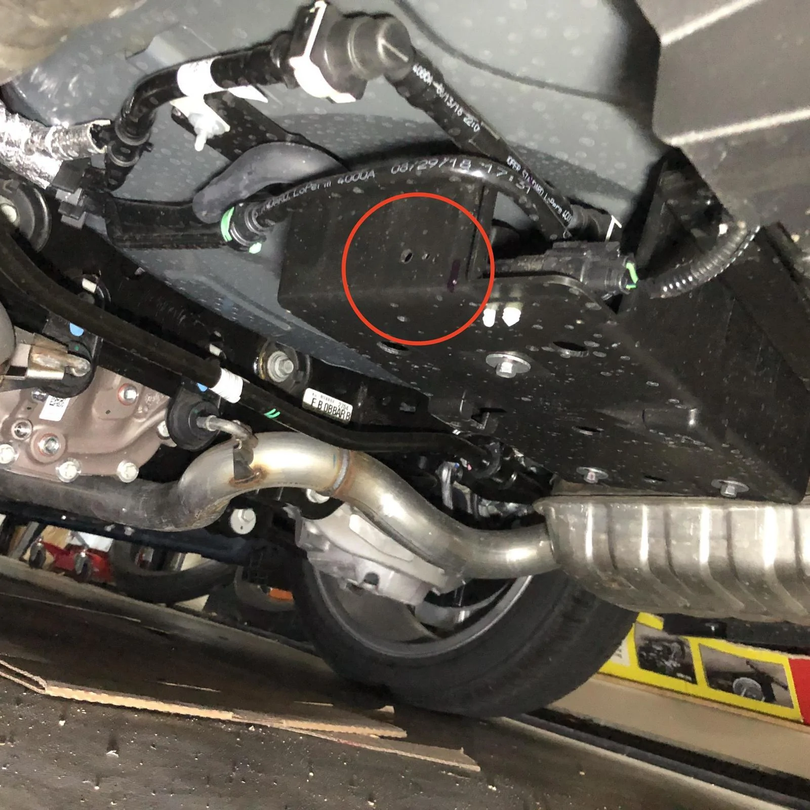

Yes. You don't have it. The plug would be clipped to those 2 holes in the evap canister cover.![]()
Am I looking in the right place?
Actually, higher, closer to the bumper. It would split from the plug with the green wires you see in your picture. Please see post #41 for the actual plug.![]()

#41 seems so long ago...Actually, higher, closer to the bumper. It would split from the plug with the green wires you see in your picture. Please see post #41 for the actual plug.
Just checked mine - you are right. it is higher.Actually, higher, closer to the bumper. It would split from the plug with the green wires you see in your picture. Please see post #41 for the actual plug.

Hard to tell in that picture but after studying it I see where it's suppose to be. I told the wife about the active exhaust and she said she didn't want it. She wants it loud all the time.
I'll revise the picture later.

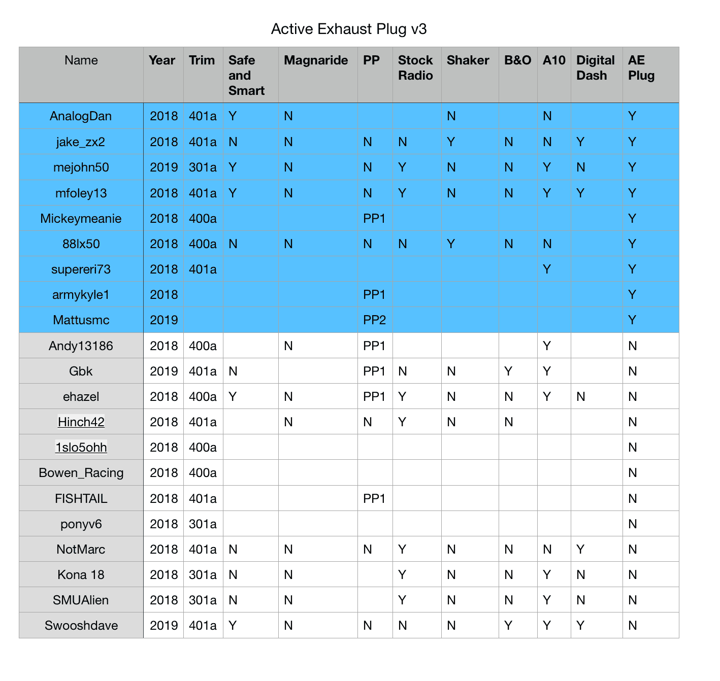

I have stock radio, no safe and sound, no magnaride, yes on A10, no on digital dash. One thing you might add is convertible or not... Mine is a convertible...I scoured through this thread to see if there was any rhyme or reason to the car configuration. There are some missing data points but the short answer is that so far I don't see any trend.
If you see your name here and want to add some more information just let me know, or corrections. If you don't see your name here and would like to add it to the list just post all of the below variables.
