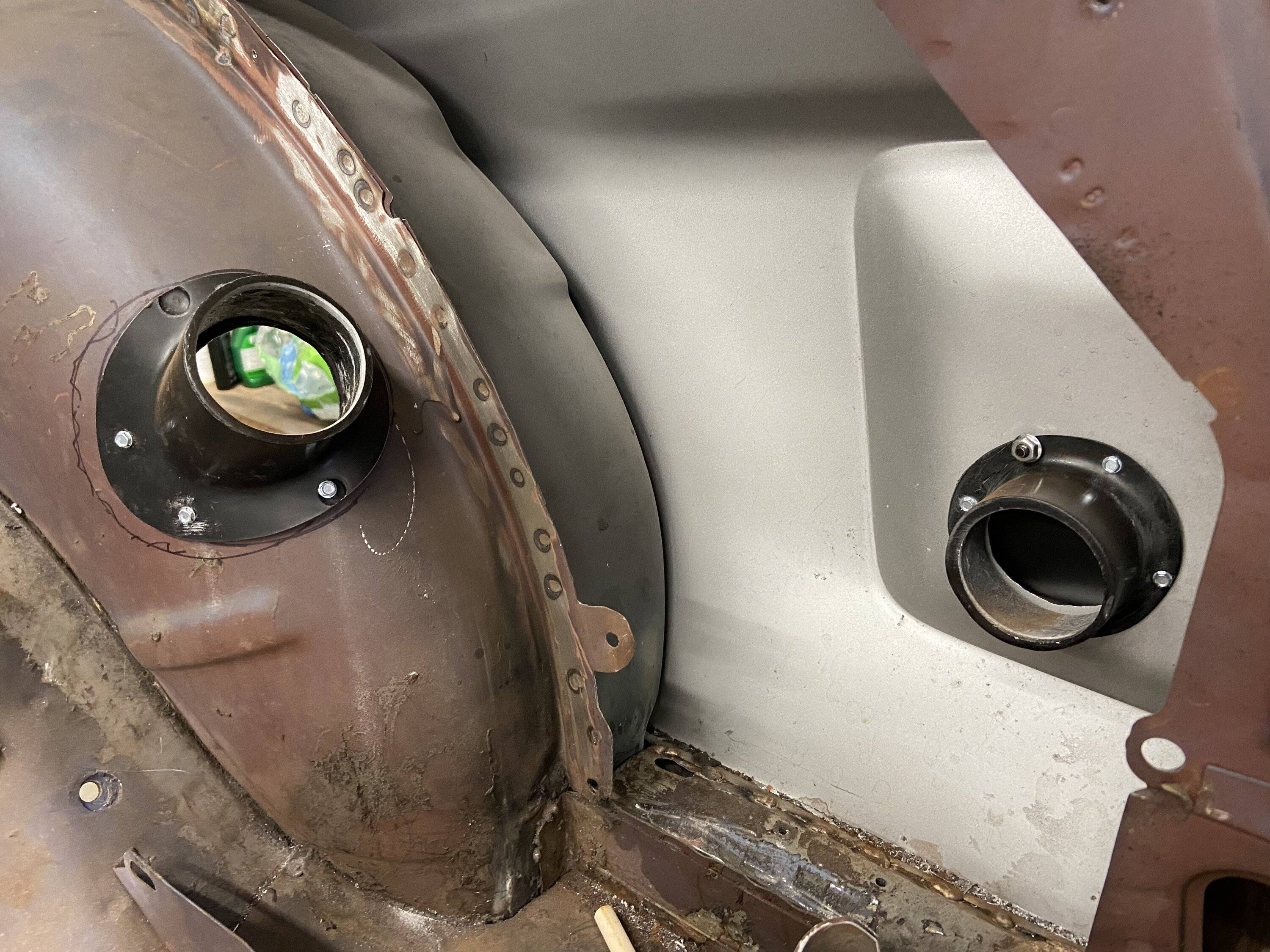

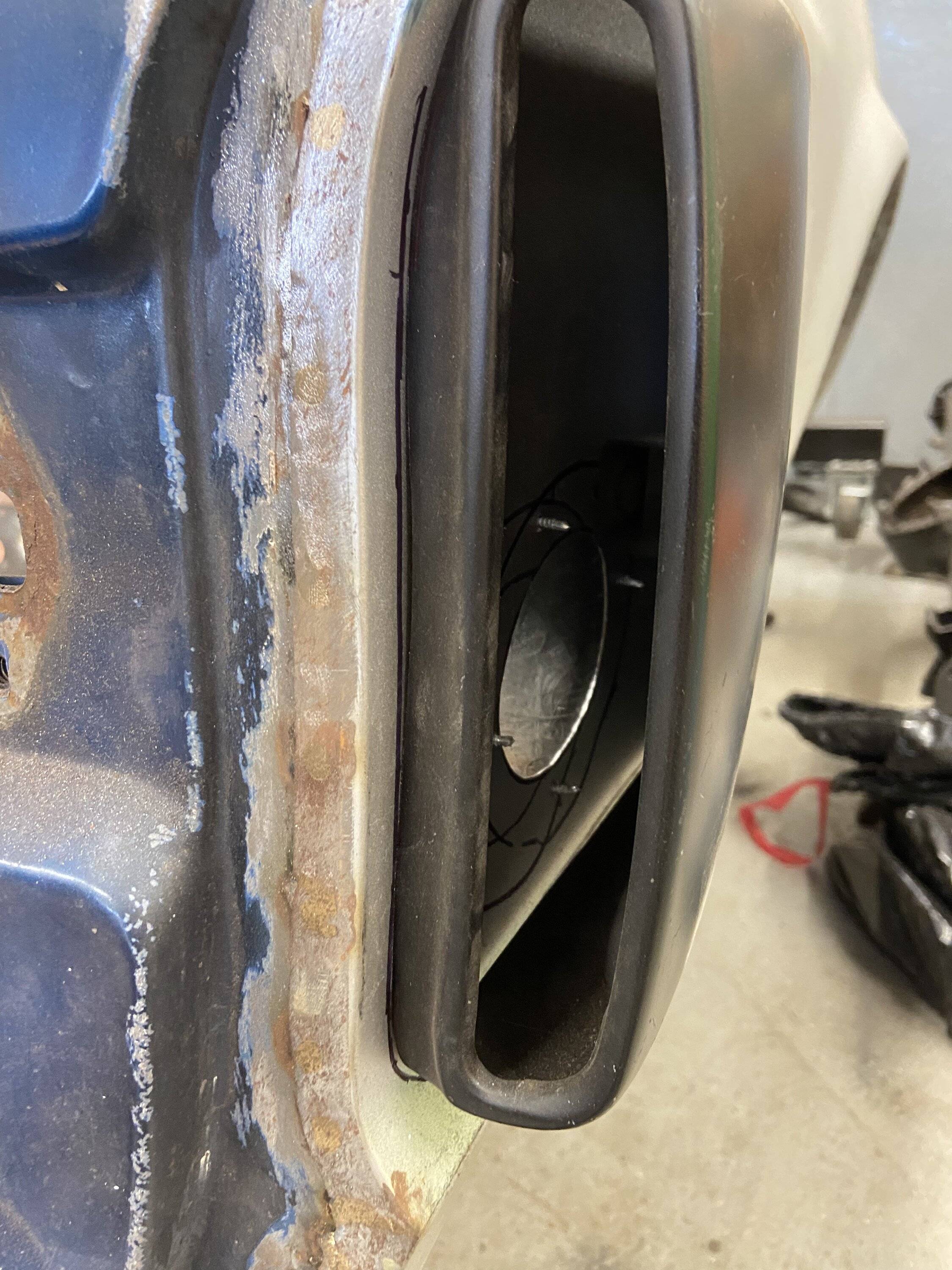

I know some people only like functional scoops….here ya go.
Lower scoops will duct to rear brakes.

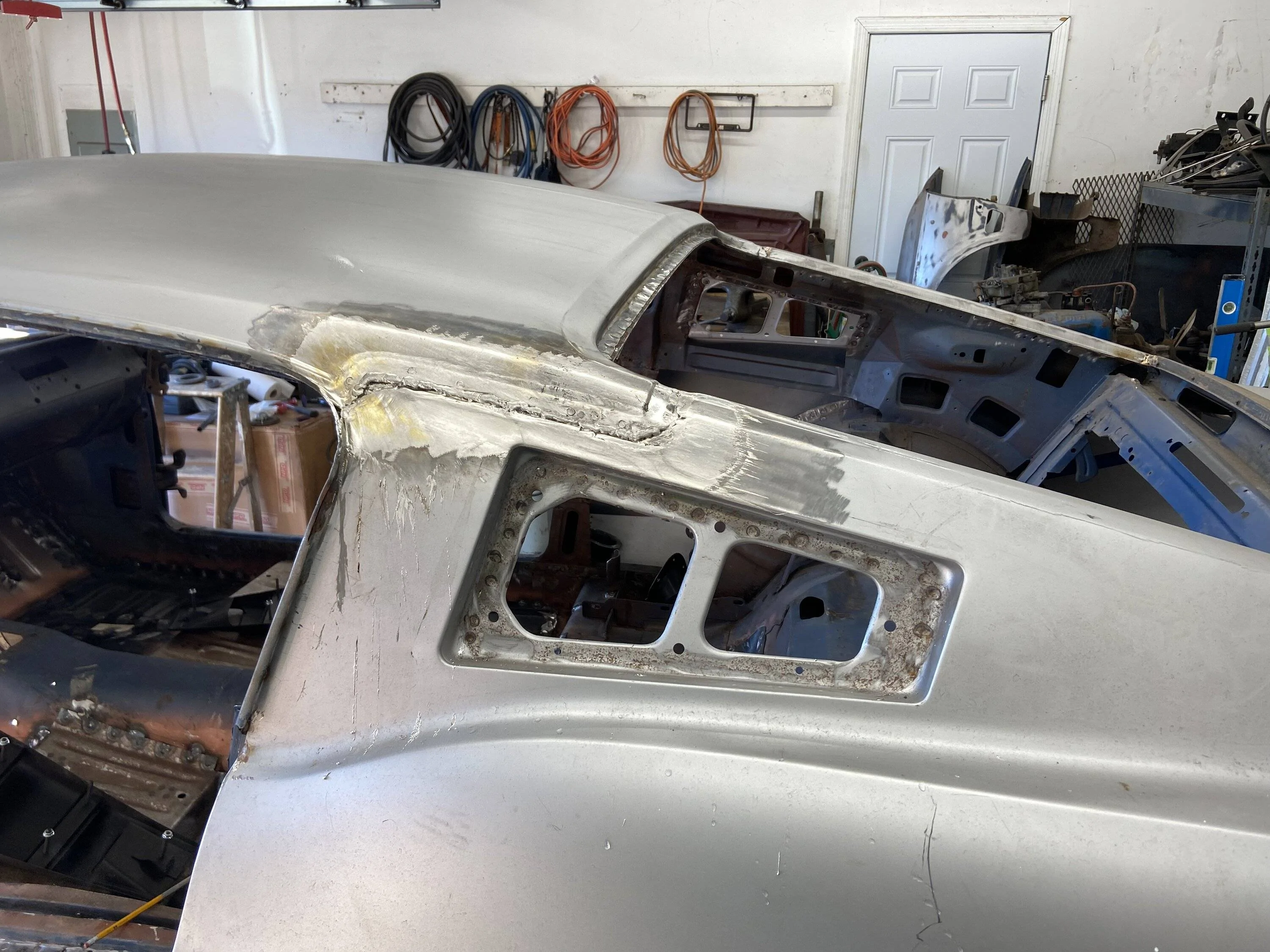

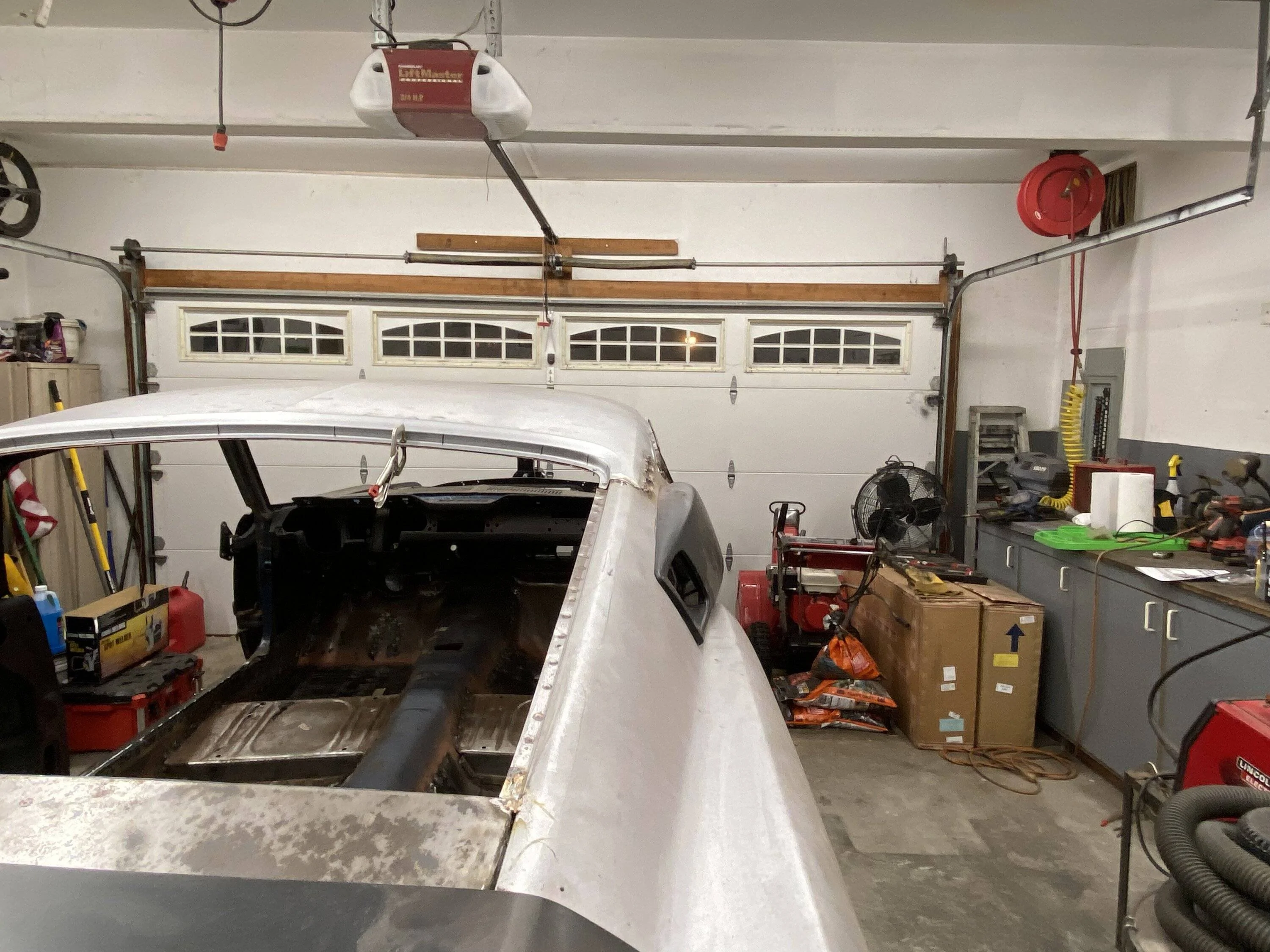

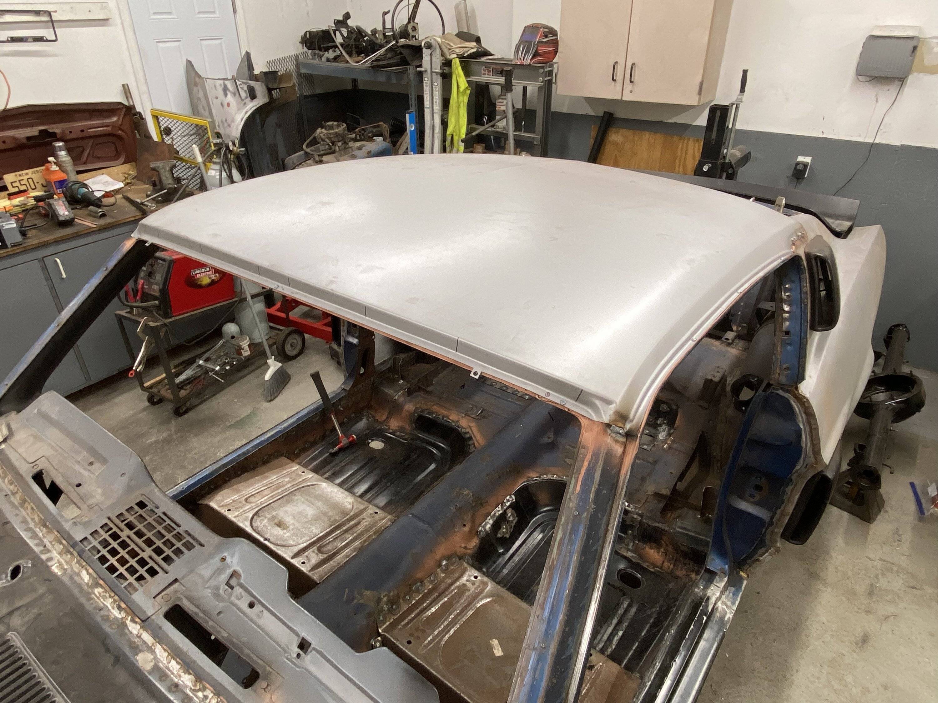

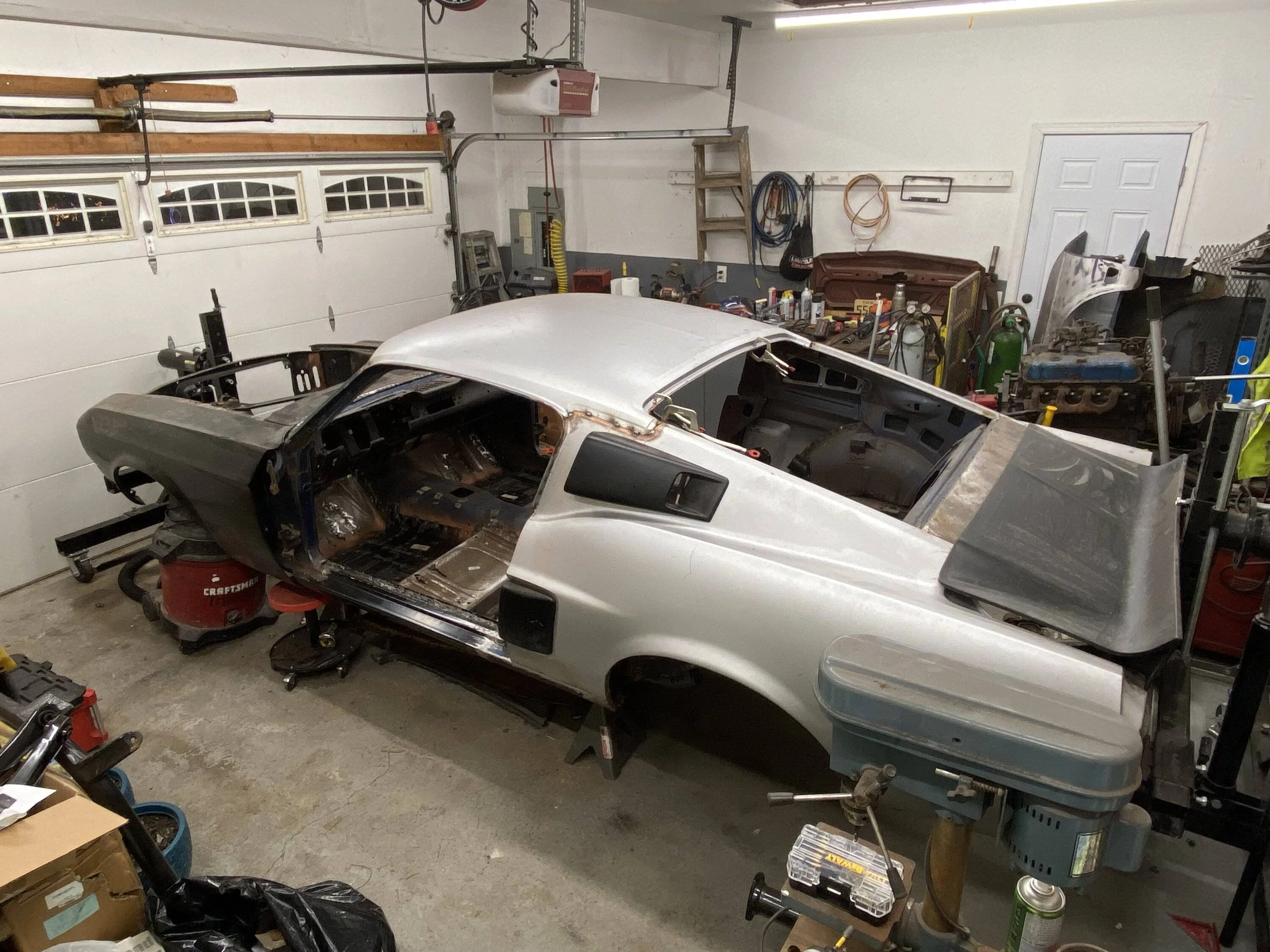

Roof panel in place! Took a bit of trimming to fit but we’re happy with results. Tack welded at four corners and temporary screws. Next step is spot welding tomorrow. So much nicer than a rusty oil canning roof! Hope all have a Happy and healthy New Years!

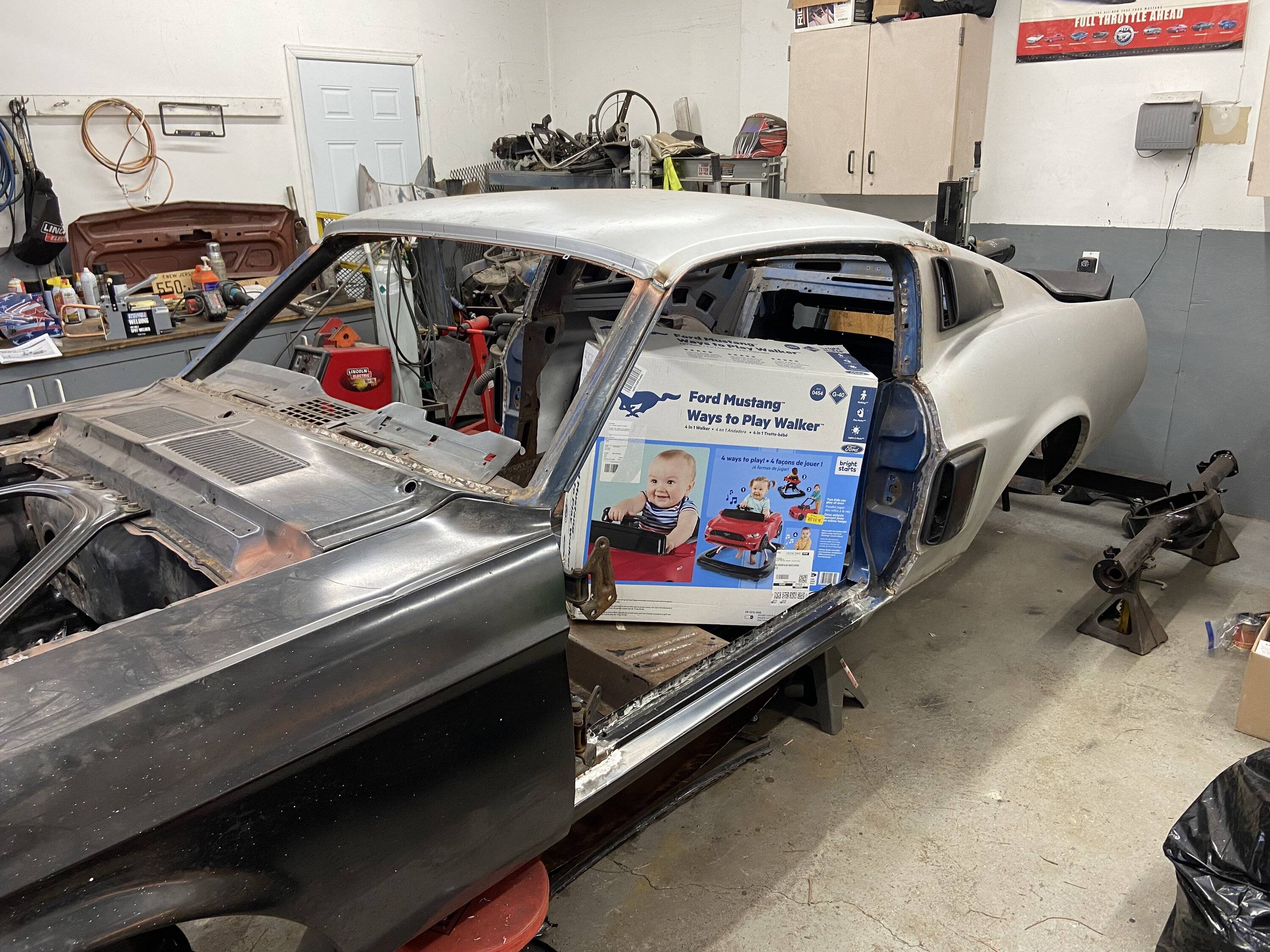

No work today. Had to assemble grandson’s first Mustang 😁

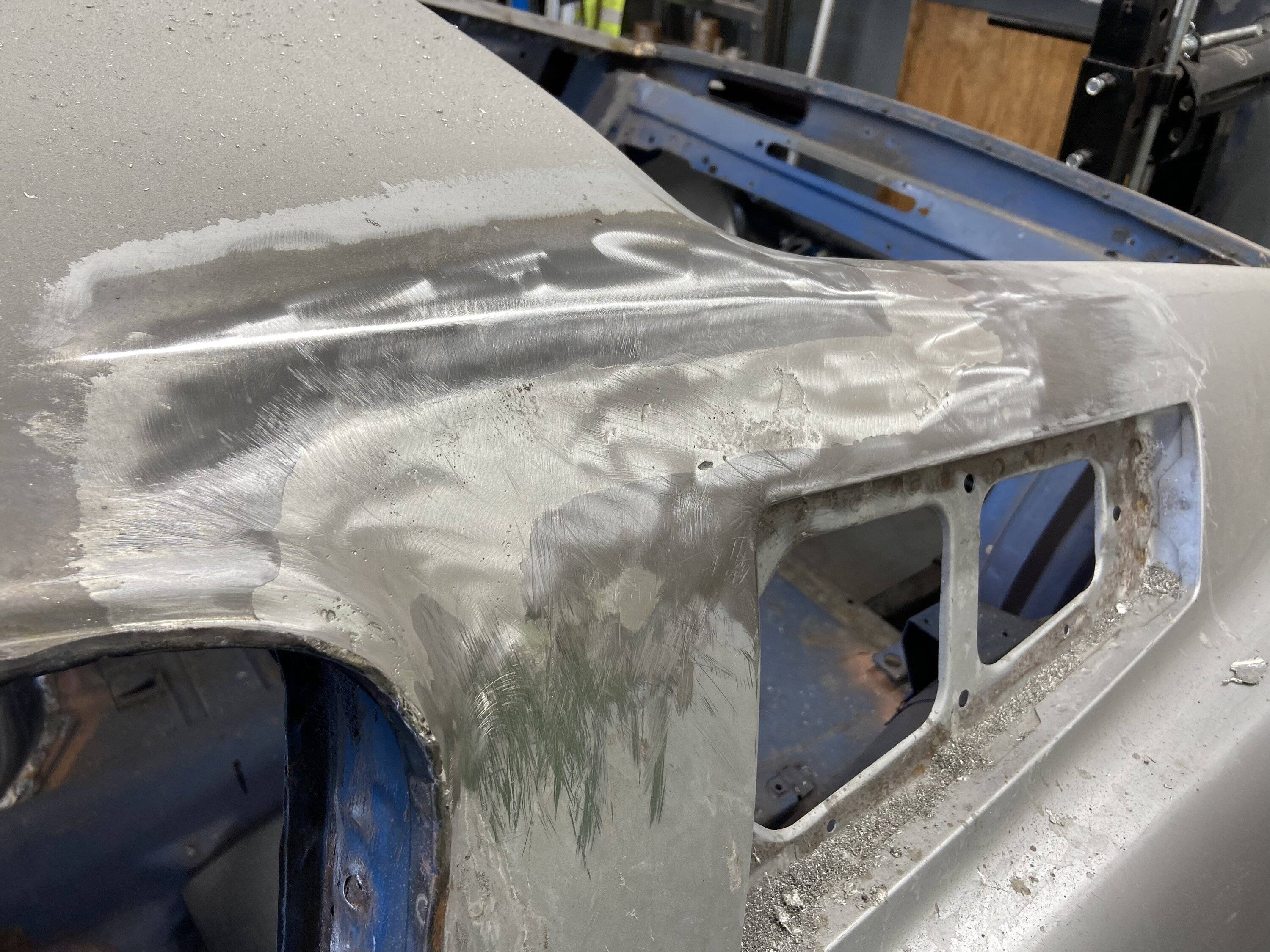

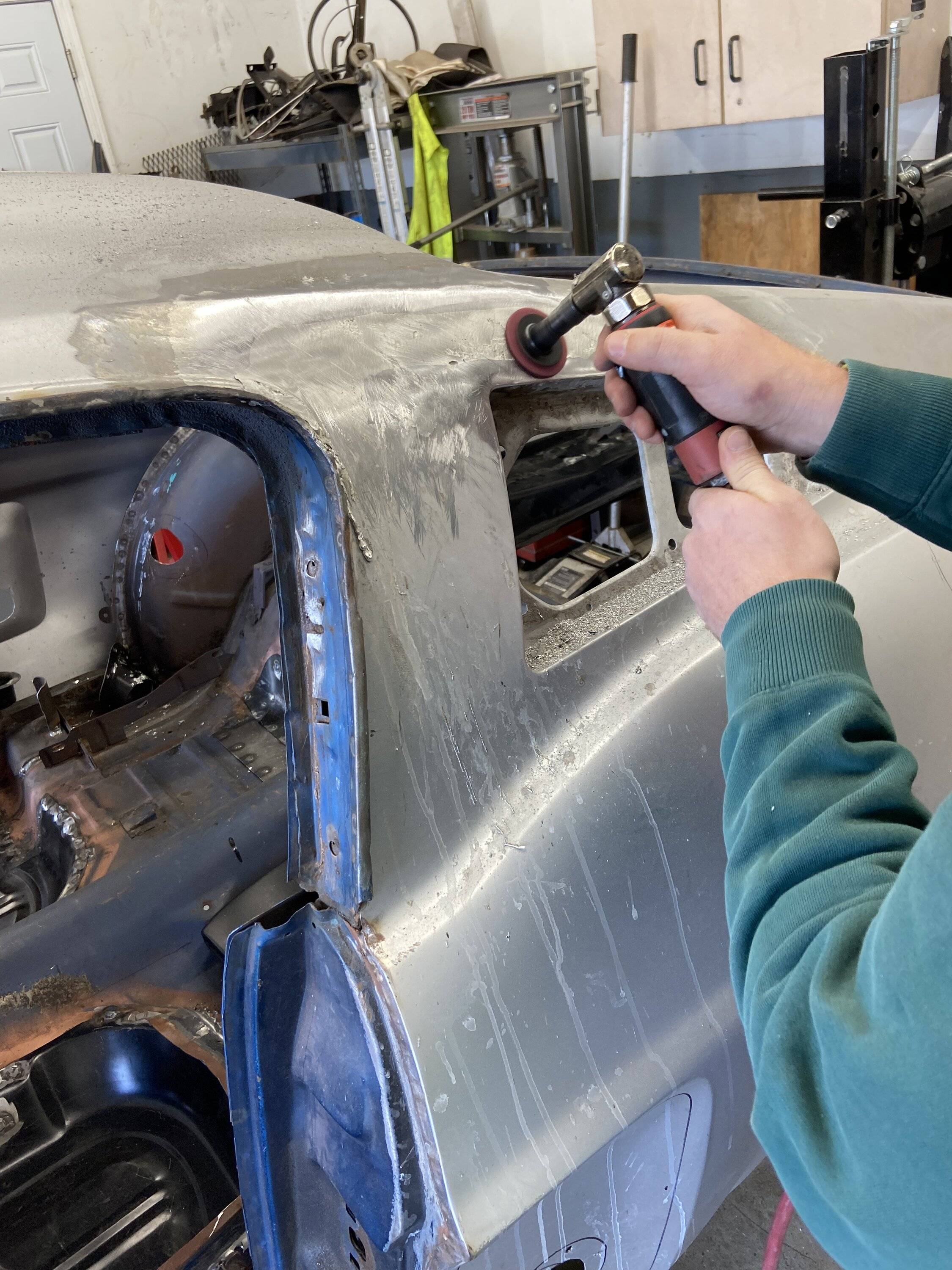

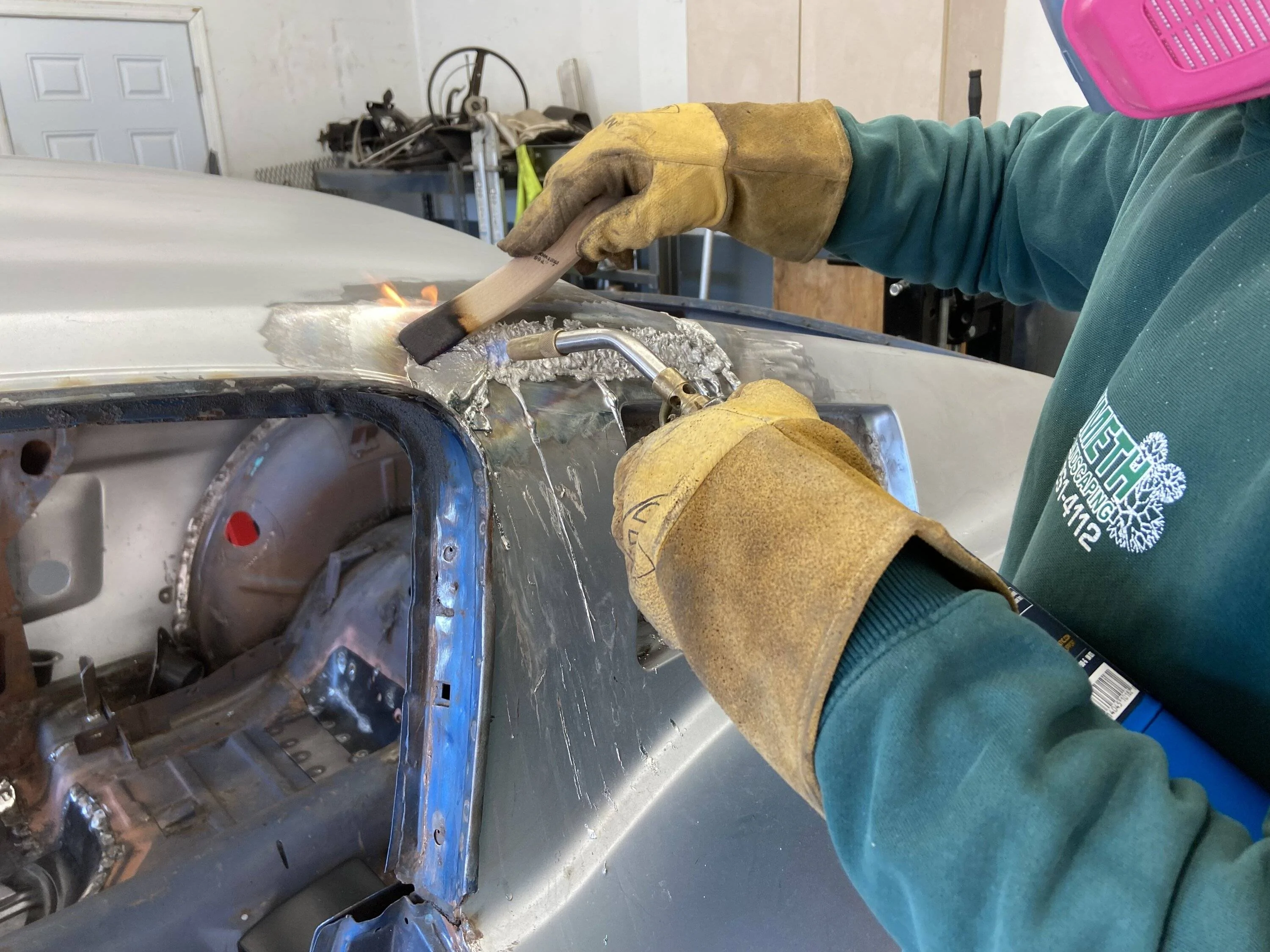

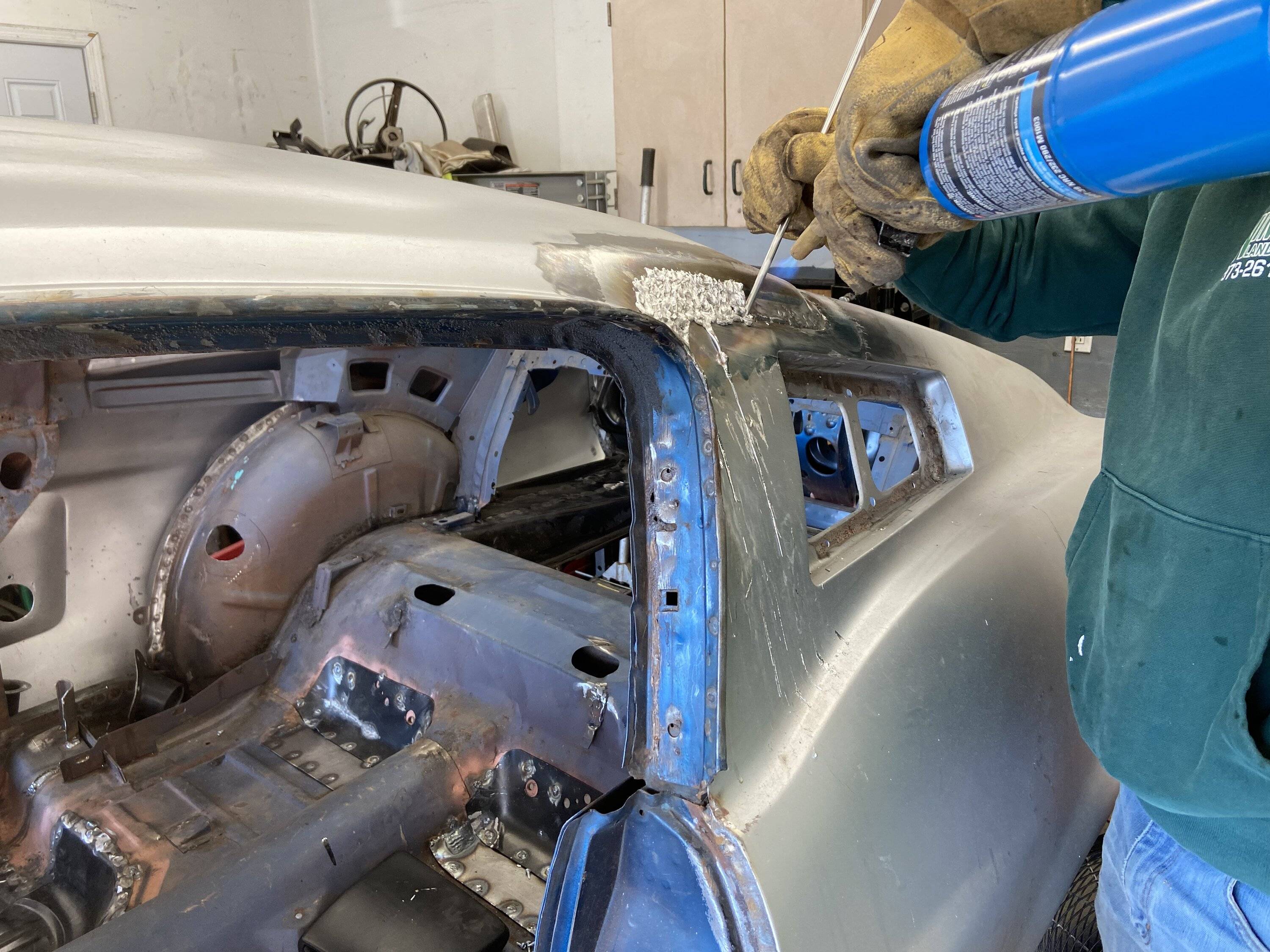

Roof is soldered in. Used Eastwood non lead solder. We’re happy so far. Not bad for first leading for my son.

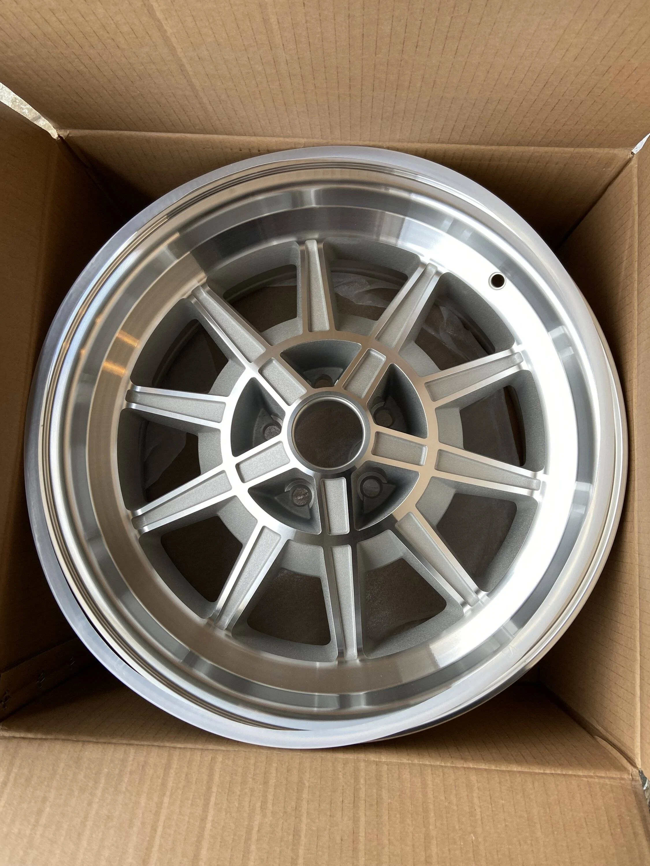

stang is off to bead blaster. Should be back in a week and then body work starts. Most of the metal is new so hoping minimal body work will be needed. We just received the wheels!

Kudos on picking the seam leading over bondo, it's a lost art and far superior.
