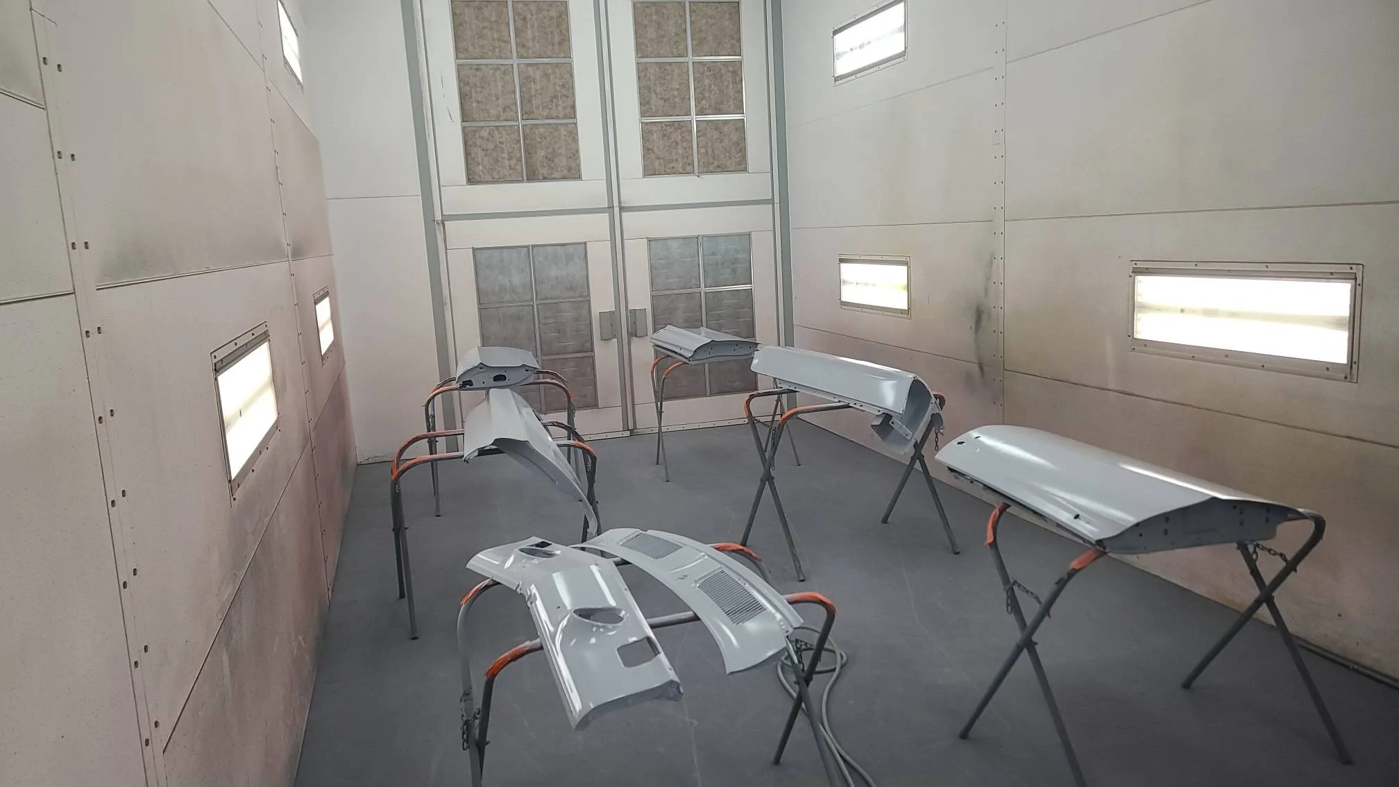

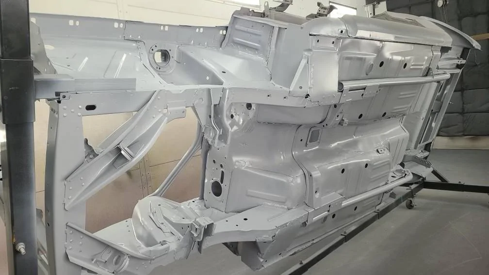

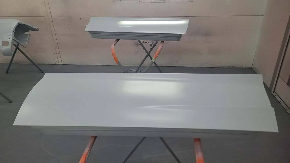

Already getting parts primed! Body is next up.

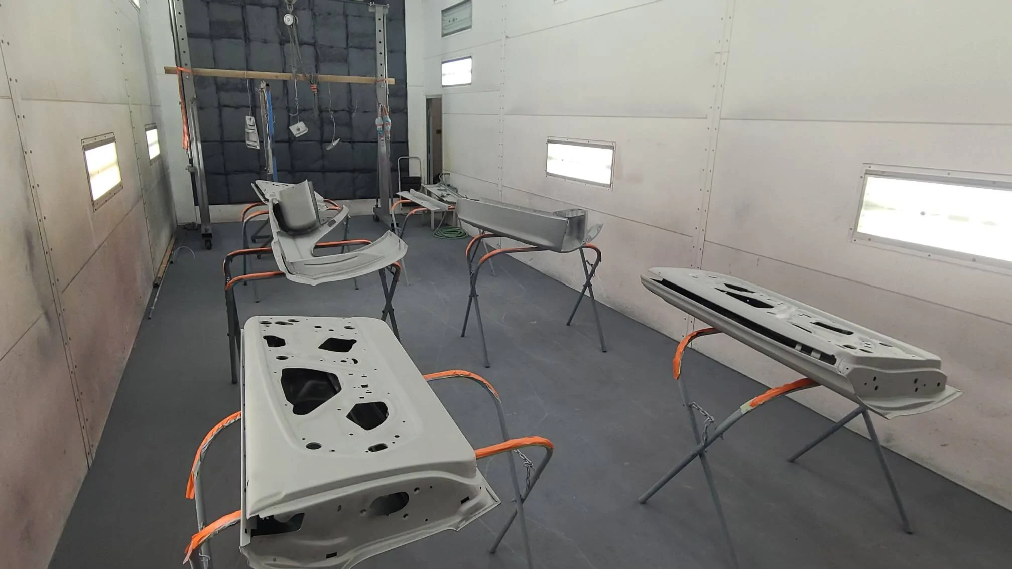

Finally seeing major changes since this project started!

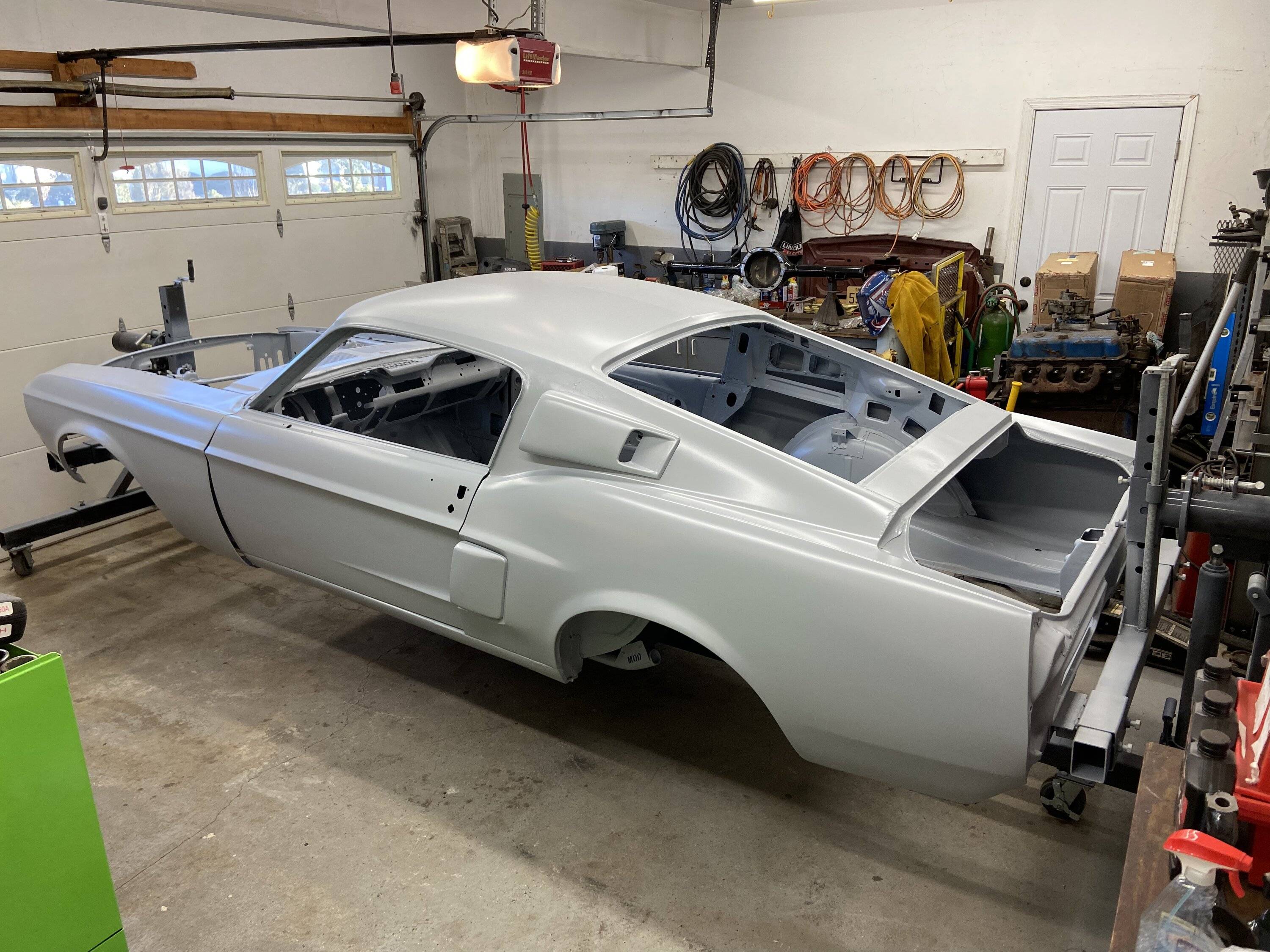

Bob

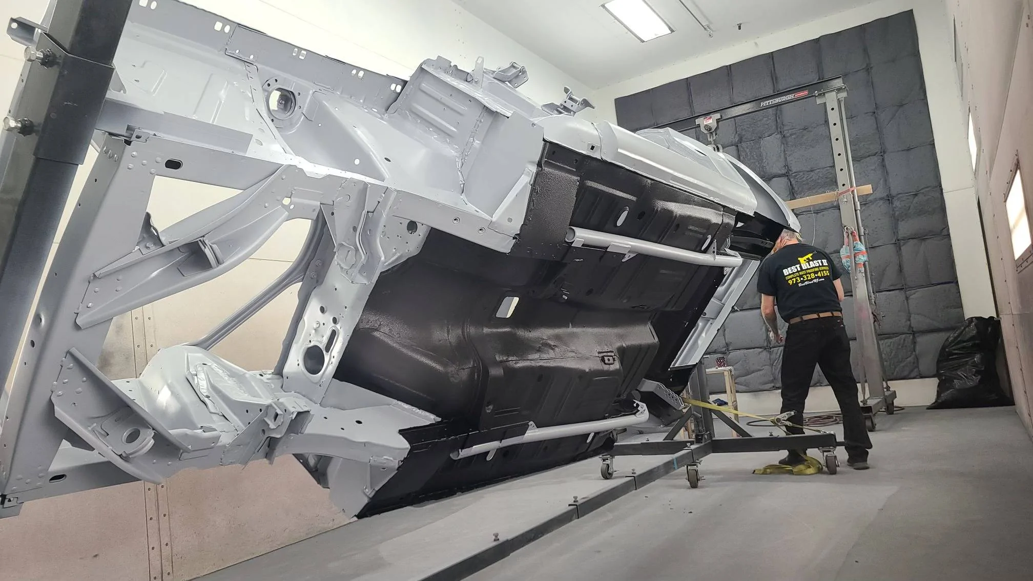

1968 Mustang Fastback, 2021 VB, GT/CS

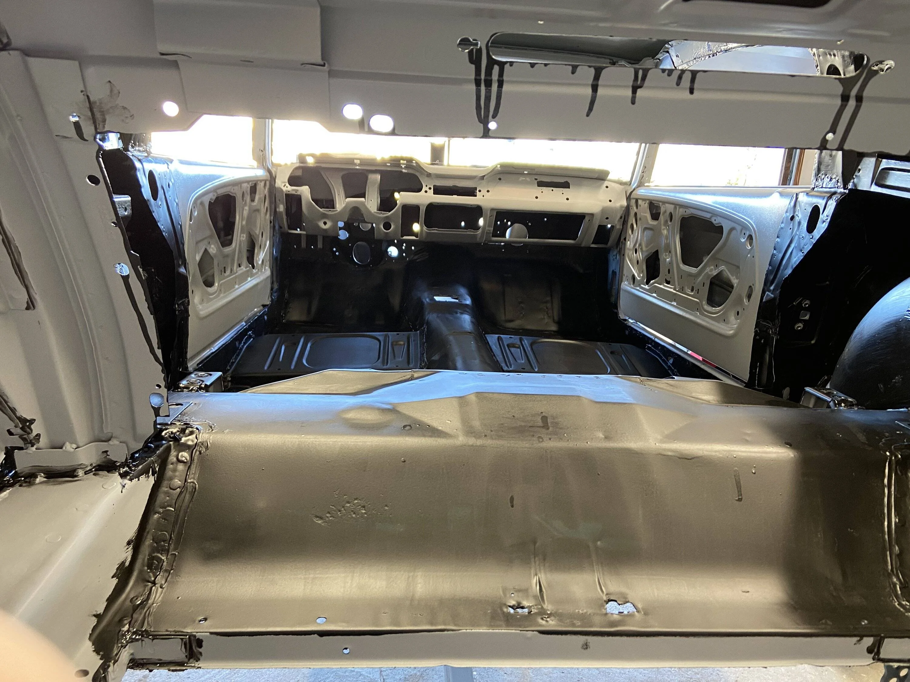

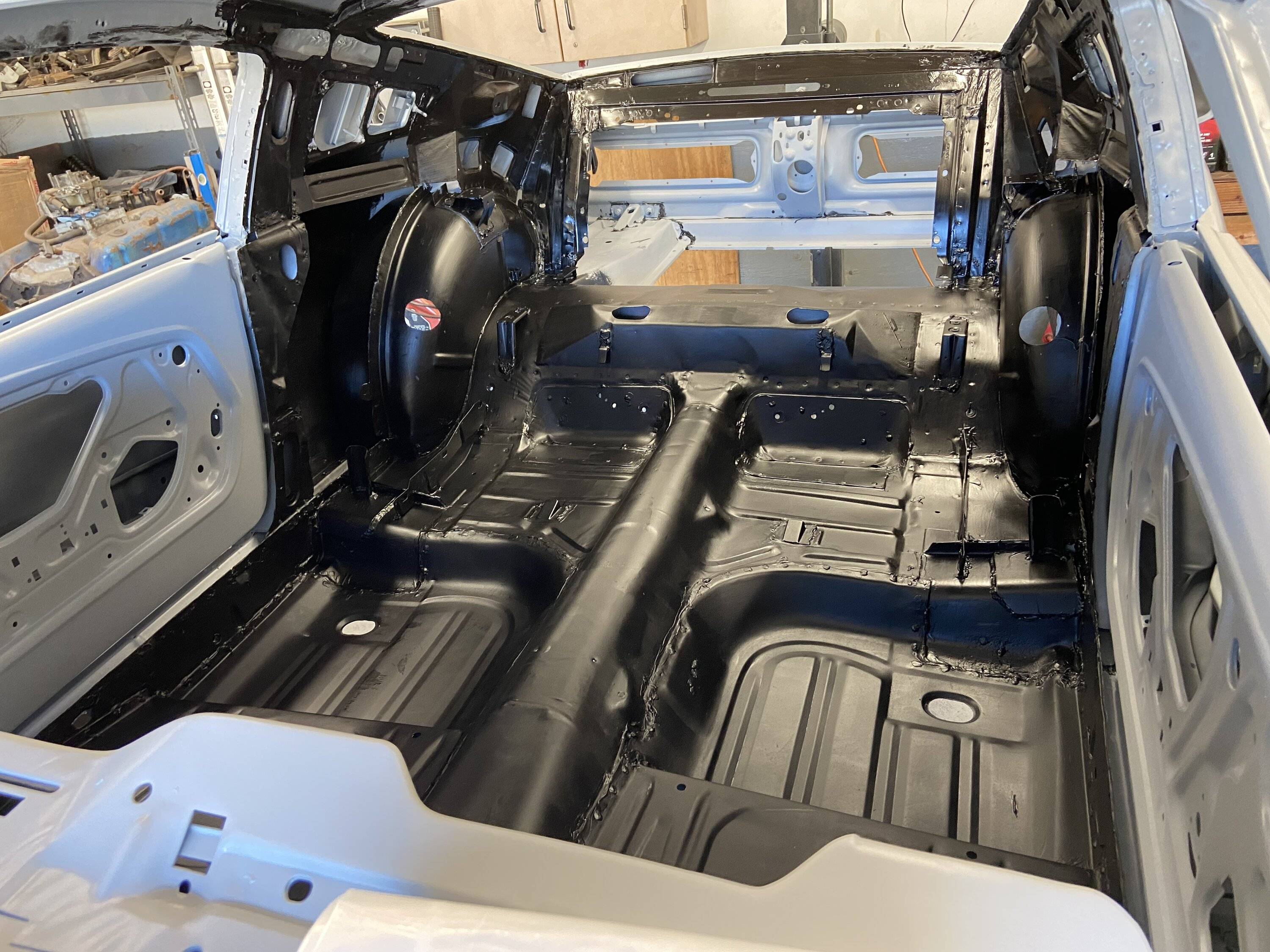

Shell is primed, seam sealer applied and undercoating is on.
Wow. What an amazing effort. If I were to restore a car I’d definitely want you on my team! Your attention to detail is incredible. This will definitely be an heirloom car.
The factory never came close to what you’re doing. Can’t wait to see the finish!

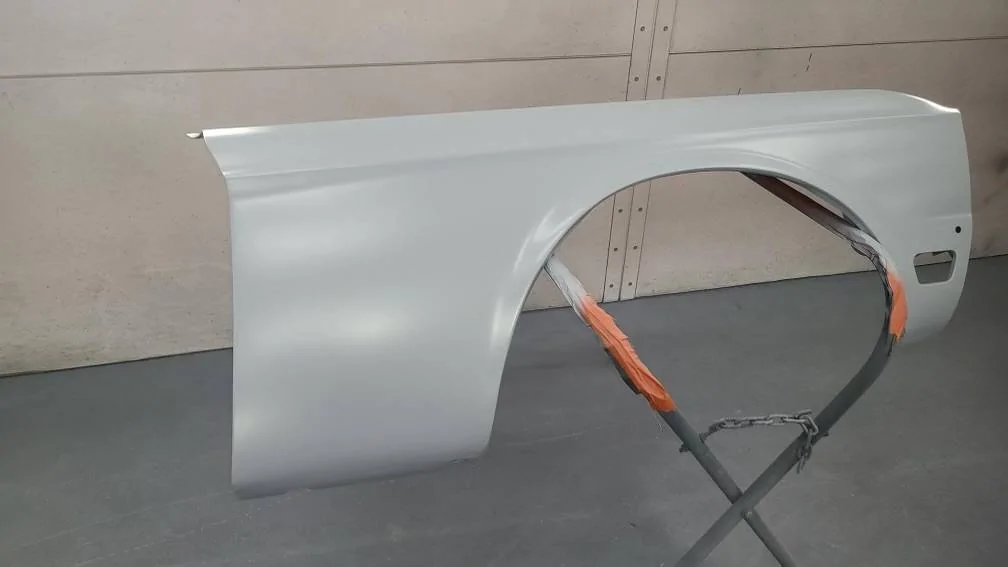

Bob

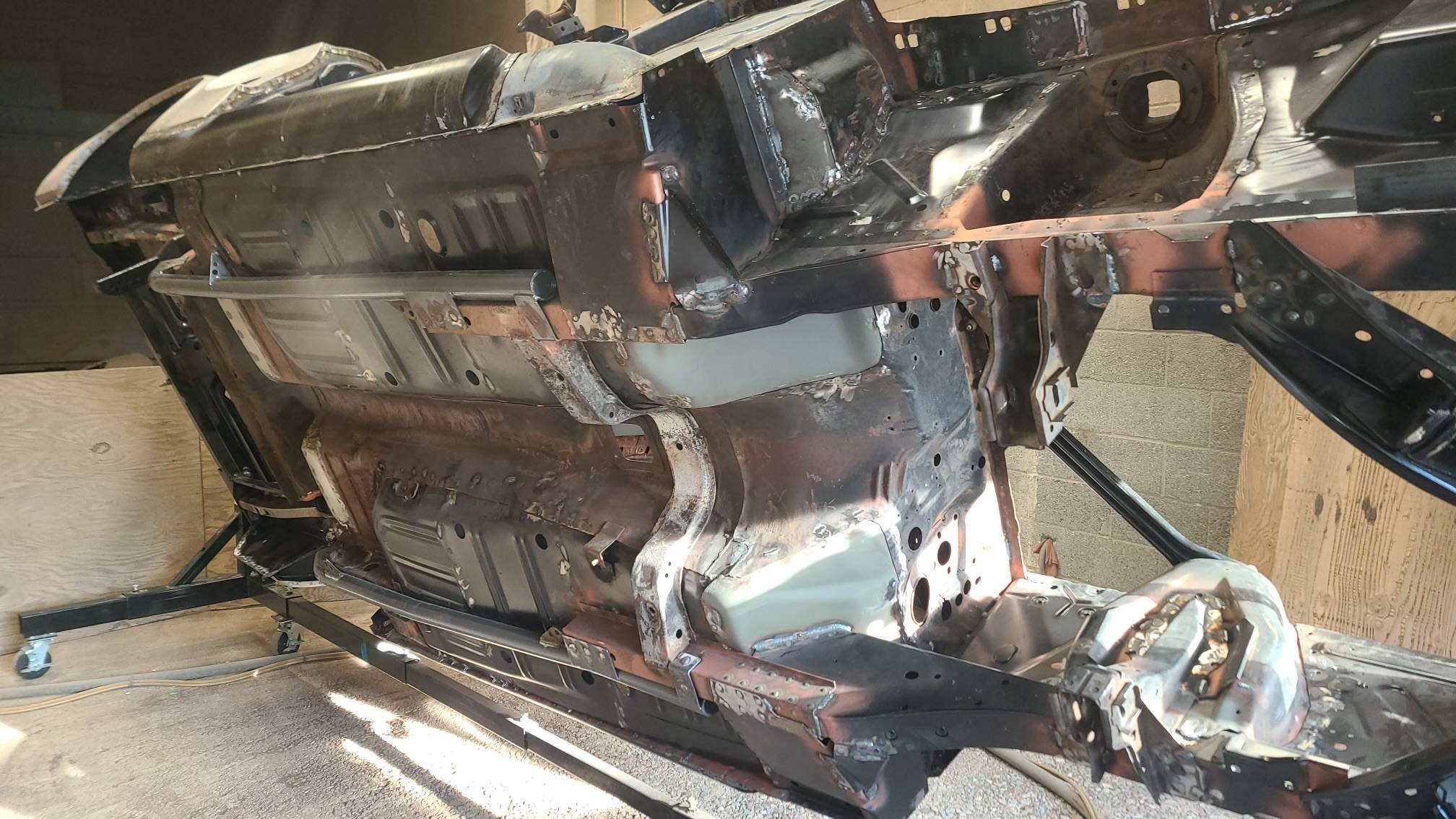

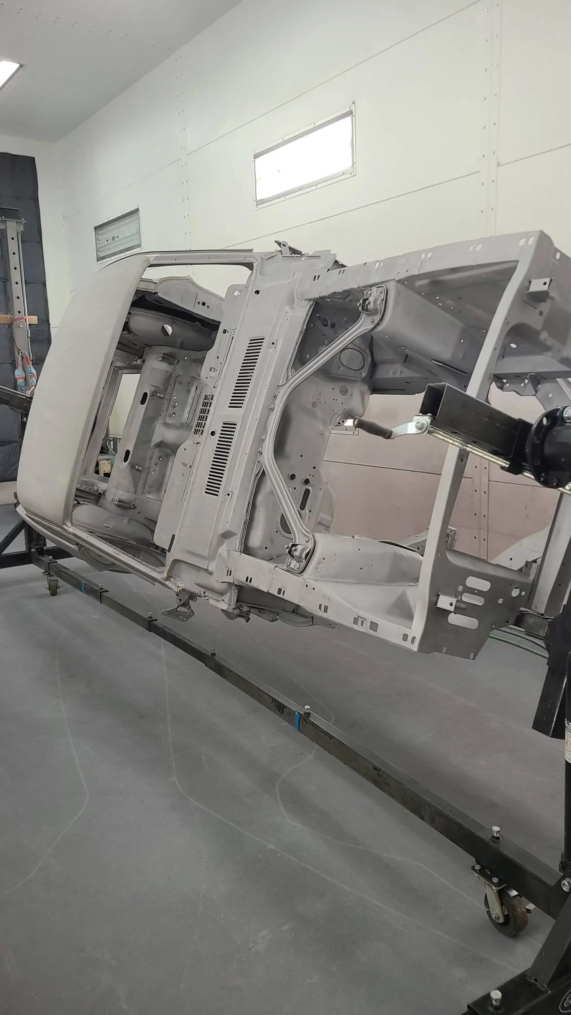

Another pic from blaster. Think he’s doing great job. We may have him do the top coat. It’s coming along great.

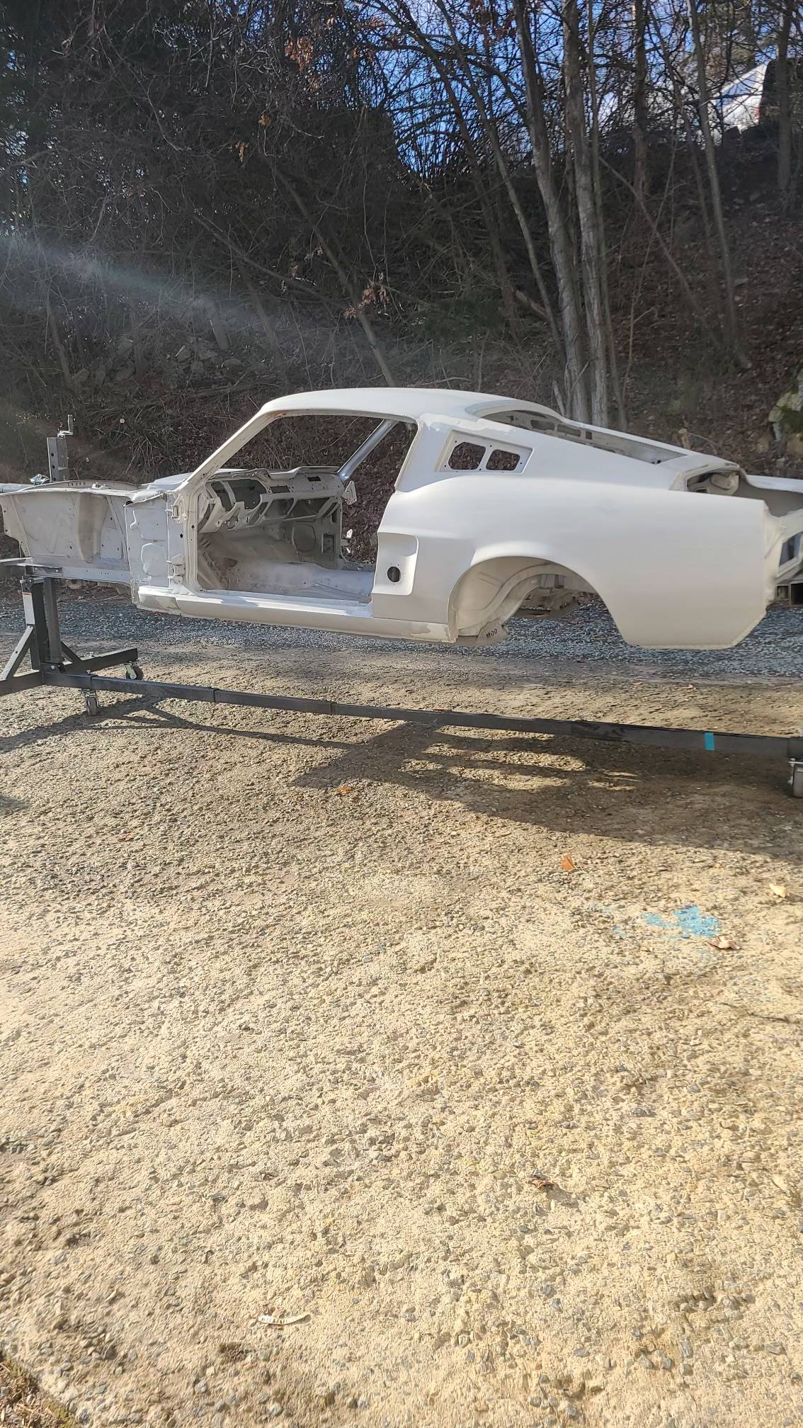

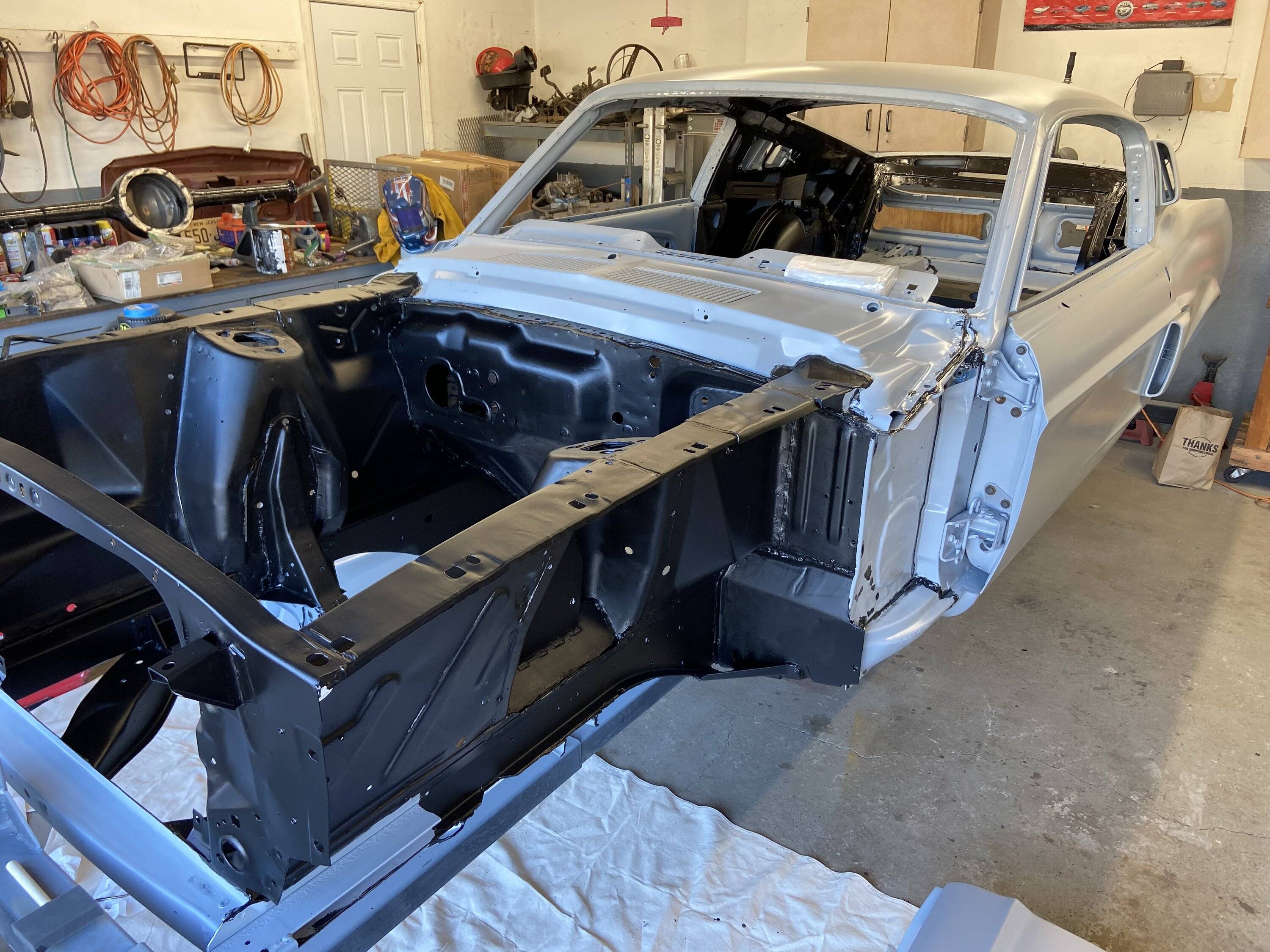

It’s home from blaster! Next phase mechanical….body work and paint in 3 months

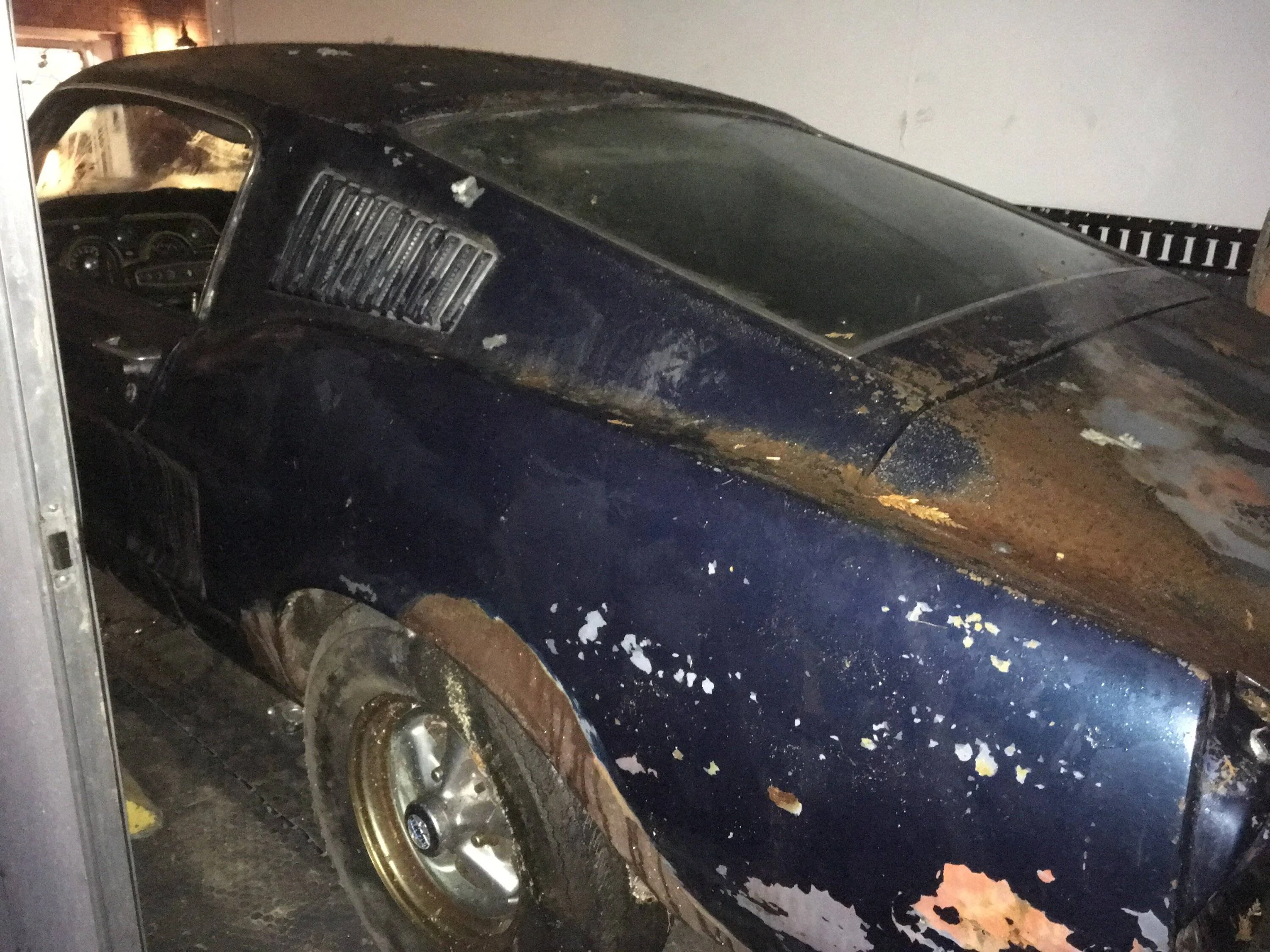

Bob

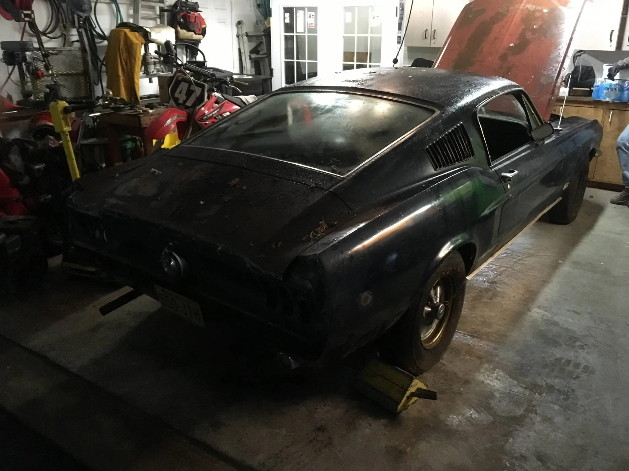

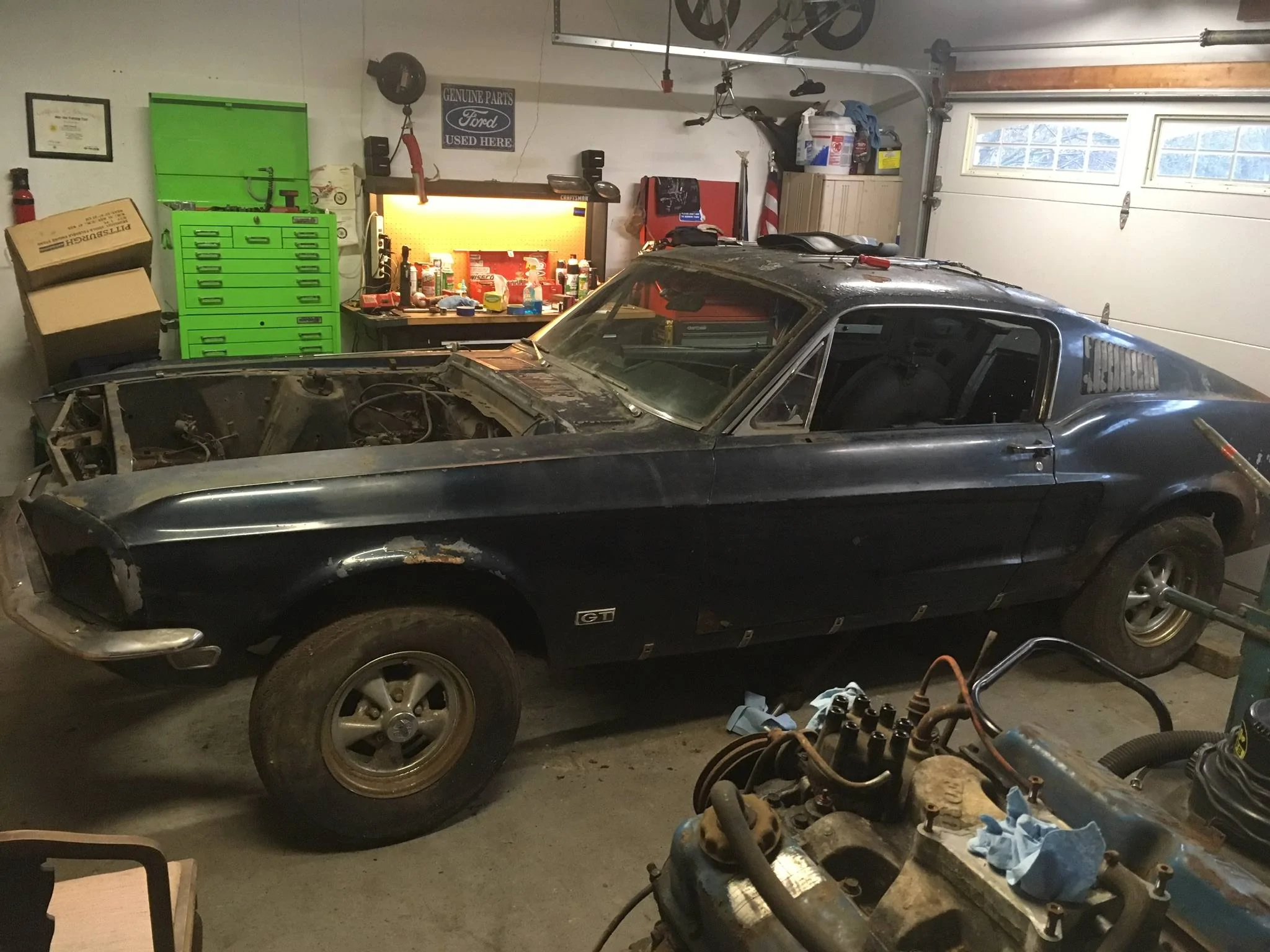

Here’s where we were in Dec 2018

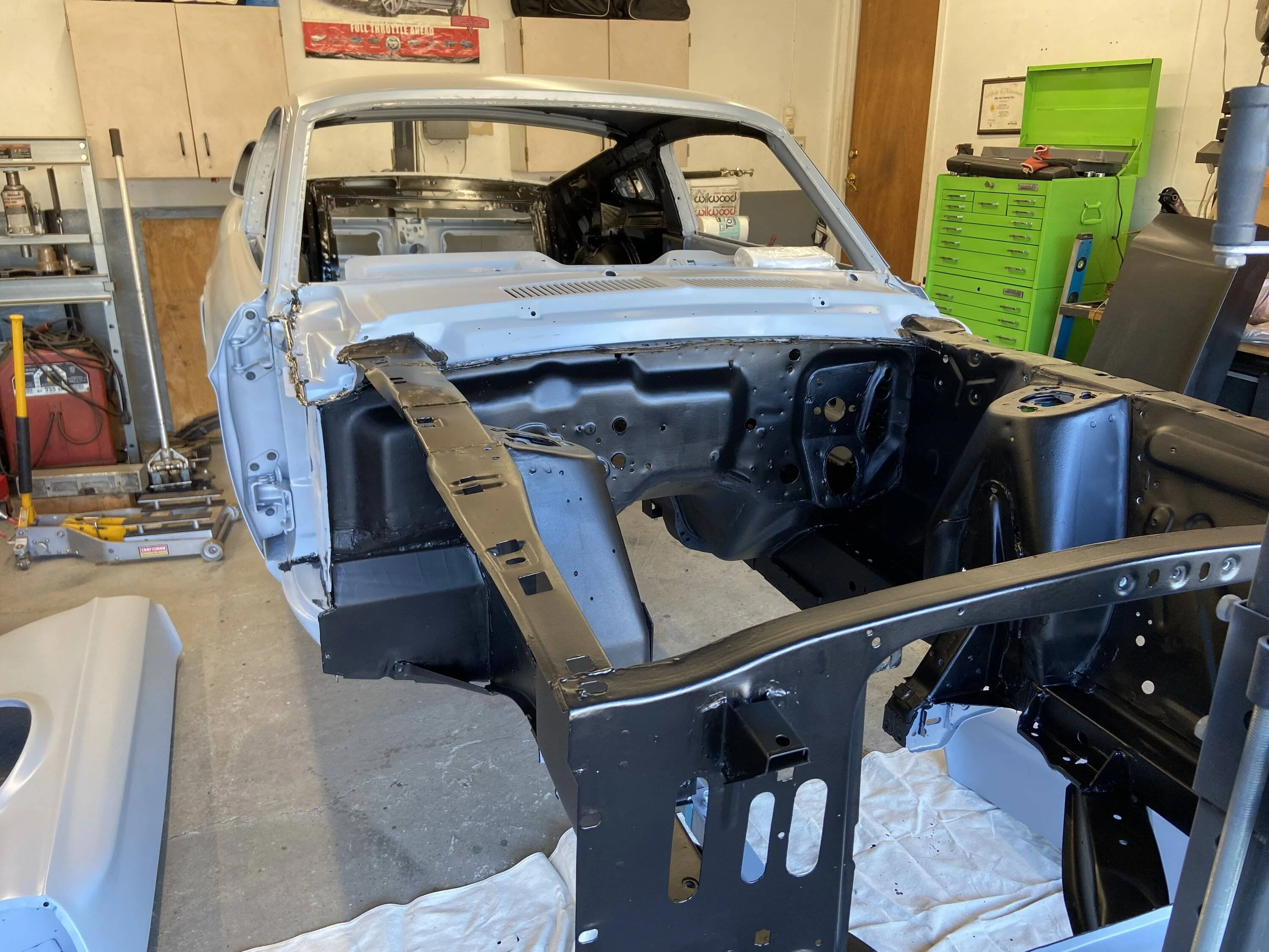

Bob

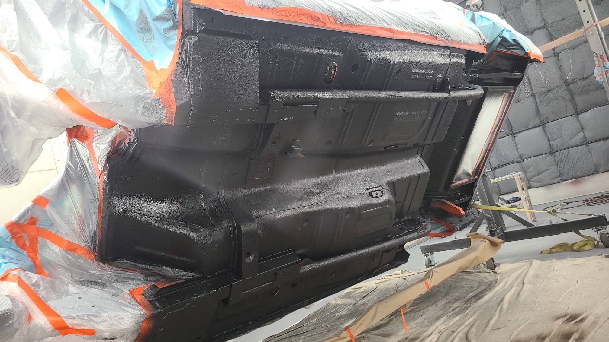

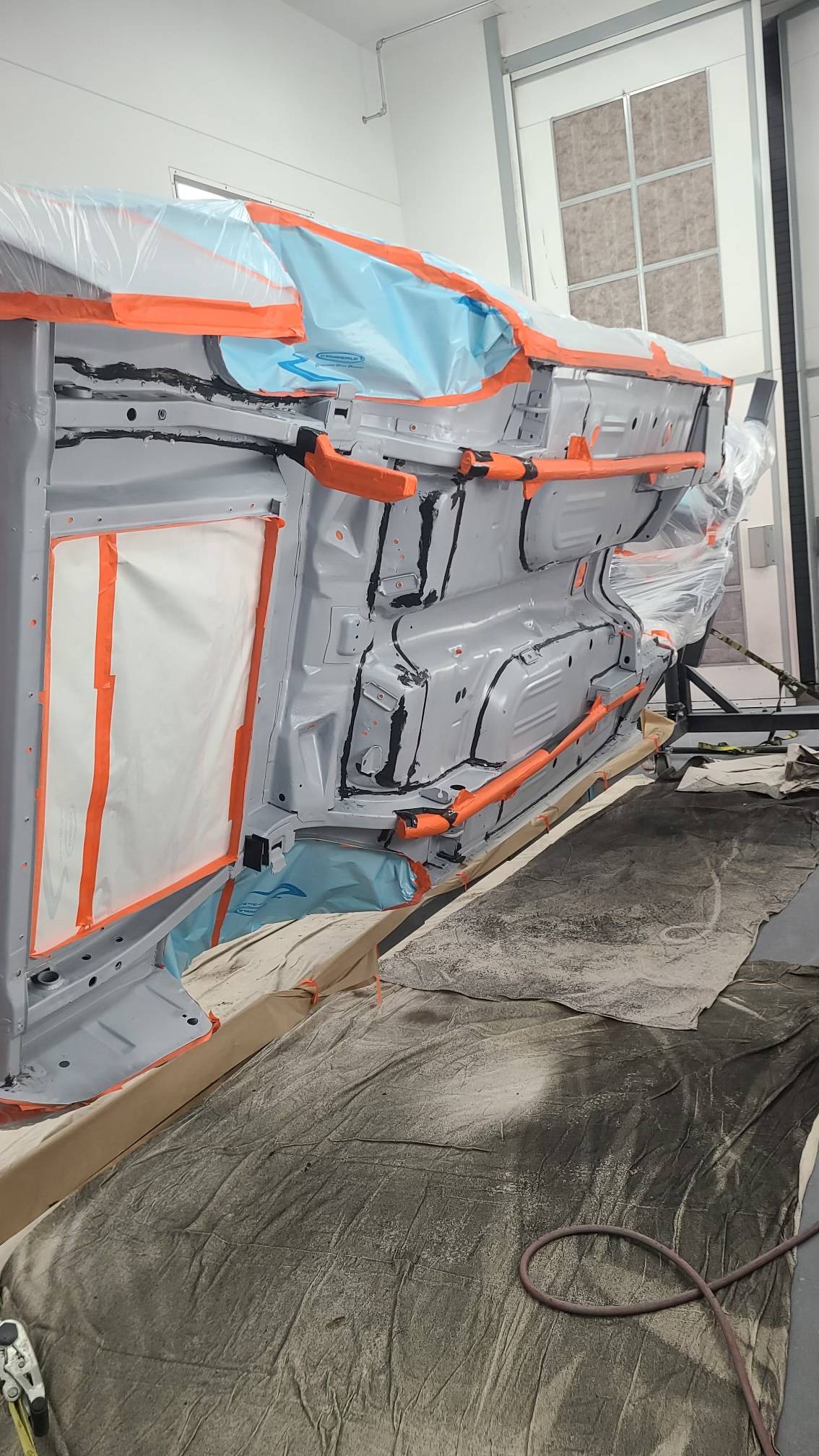

rust inhibitor applied to interior and engine compartment (similar to POR 15)....external seam sealer also applied

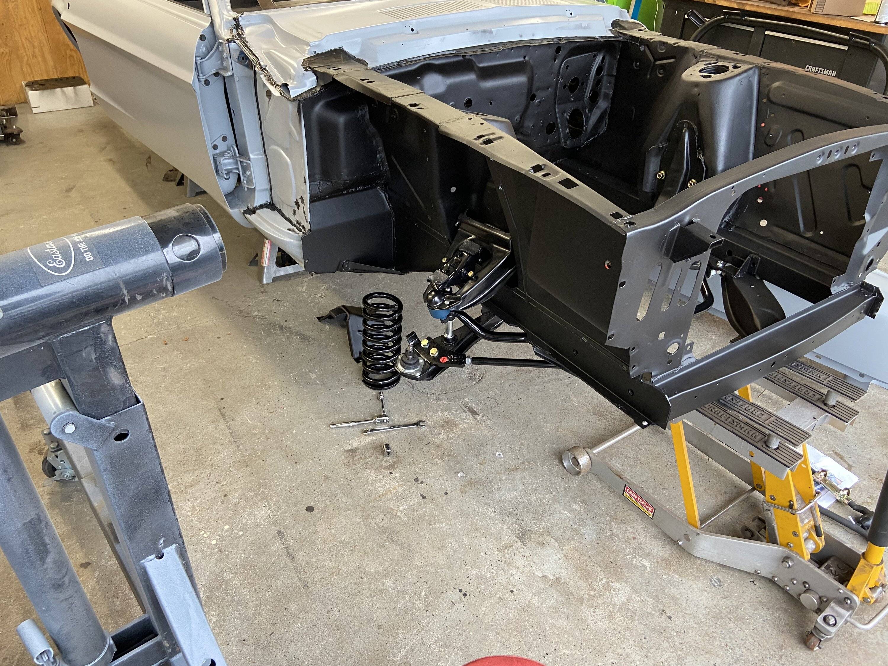

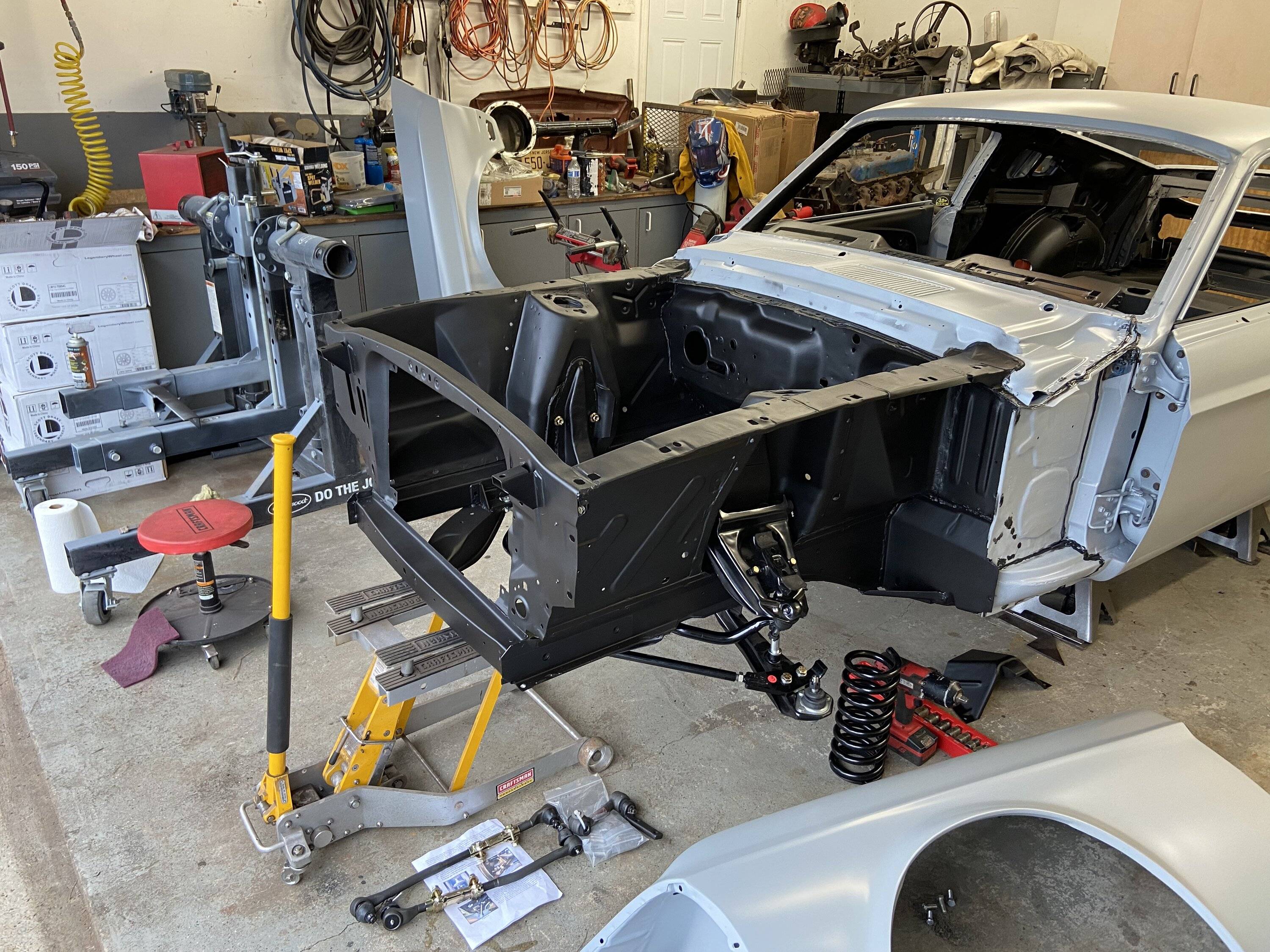

Bob

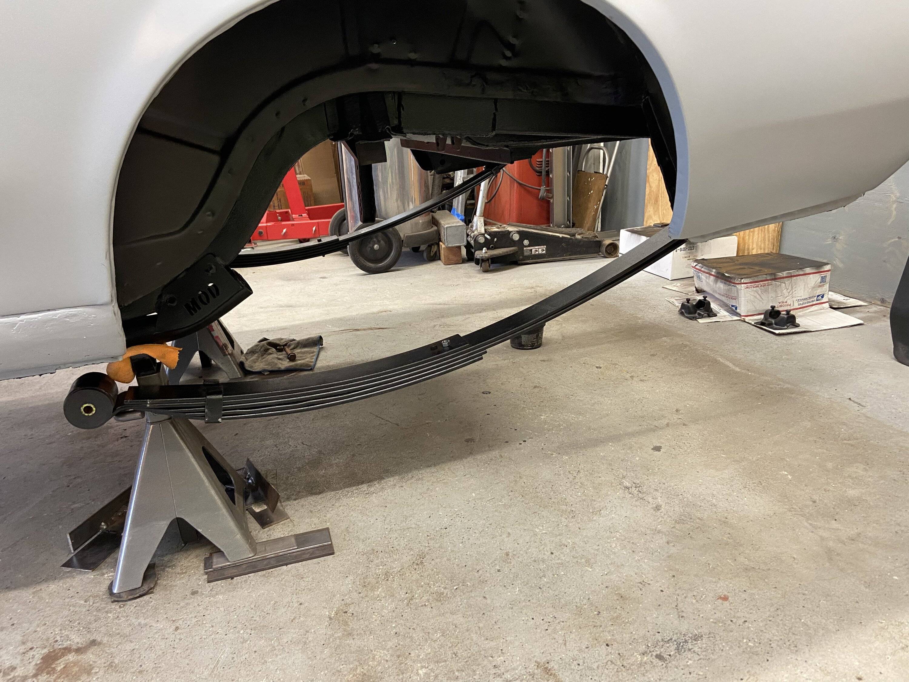

Training wheels are off! Son pulled the rotisserie off yesterday. First time in over a year it’s back on jack stands! He started on suspension but we need new front spindles to go with Wilwood front discs.
